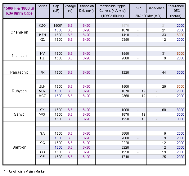

                              wha.. you waking up this old thread..
                              anyway i made this a long time ago, though i never posted them here,
                              Comparison beetwen 5 jap caps and samxon capacitor :

                                Nice, thank you!
