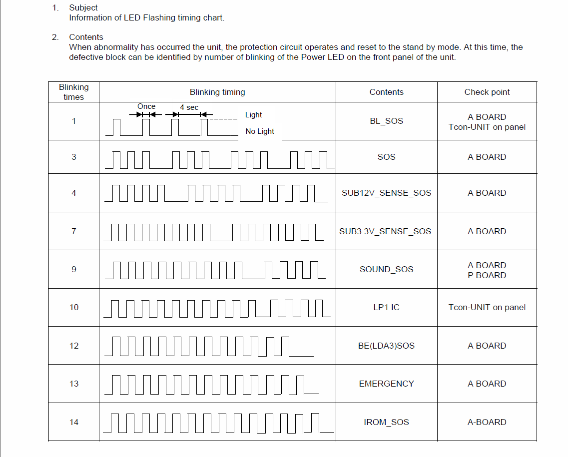

    Hi
    I have this set which keeps turning off once you play a channel and then gets stuck with a flashing red standby
    But it flashes red every 4 seconds
    I can browse the tv menu options fine without switching off
    It will not turn on again with the remote but using the on off switch is fine
    Voltages seem fine but still testing at the moment
    I'm suspecting a backlight issue but just wondering if anyone else has had this fault before

    Re: Panasonic TX-L37dt30B restarting
    Could be firmware is corrupt? stay in menu and turn backlights down really low so you can still see a picture and see if anything changes
