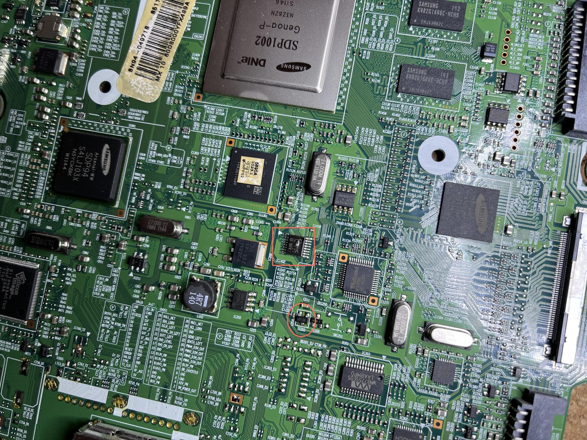

    Hello all,
    I have this TV for 10 years now, it worked with no issues until a week ago when, after turning it ON, it turned itself OFF, after running for ~10 seconds and it gave me the smell of "electric fire"! I unplugged it from power, removed the back cover and found a "fried" chip, IC1402, on the main board. Removed it from the board, and replaced it with a new one from DigiKey.
    Unplugged all the cables connecting the main board to PSU, powered the TV ON by plugging the cable to the power and measured the voltages on the PSU power connector (backlight also lit up), and all checked out.
    Connected the 28 pins power cable to the main board, plugged the power cable and tried to power it ON with no luck. Unplugging the main board from PSU brings the PSU ON, I can hear the relay clicking also and the backlight also turns ON.
    Did a bit more digging on the main board and found that IC203 seems to be shorted between pins 1 & 3. The markings on it reads GH-J2P (or at least this is what I think), and could not find out any information about it using google. My gut feel tells me that might be a voltage regulator, but I am not 100% sure.
    Anyone has any idea what IC this might be!?

    Re: UN60D8000YFXZC Samsung - not powering ON
    is IC1402 ok? looks like something is on there.
    • MariSico
      • Feb 2018
      • 19

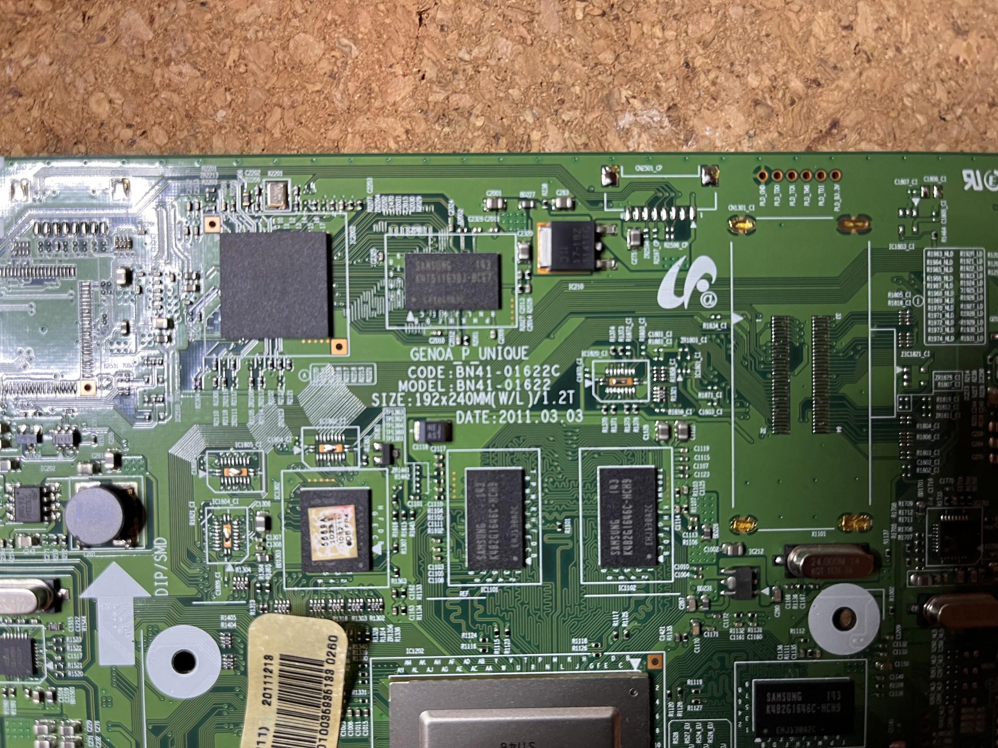

      That is the original IC1402 that I already replaced, I posted it so people could see how it "exploded"! The second picture is to show the main board code and manufacturing date.

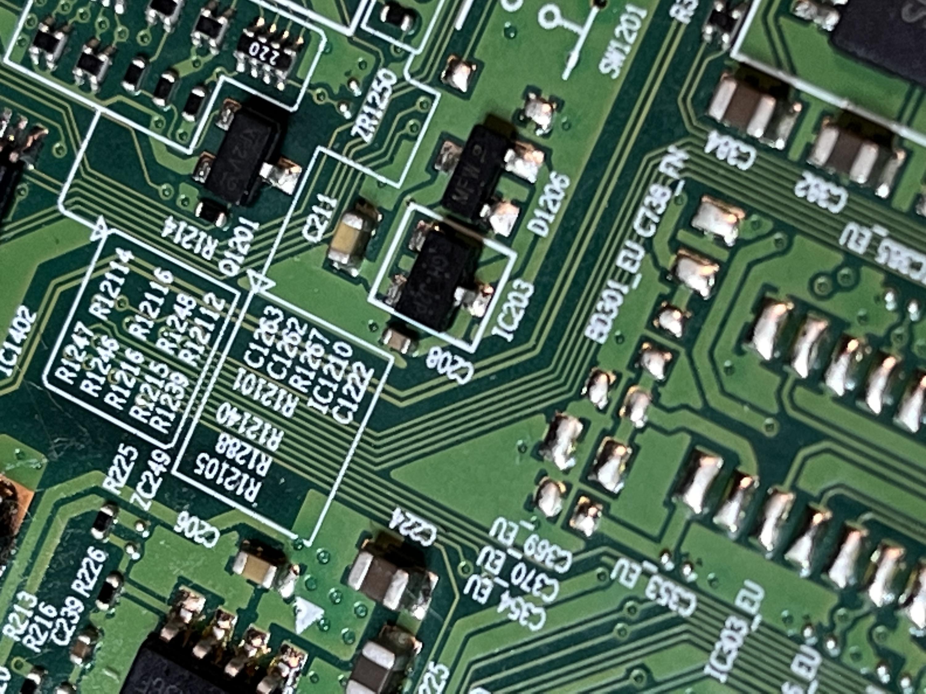

                    Here is a close-up picture of IC203.
                      99% that your micom Weltrend (IC1204) burned out.
                      • lotas
                        • Jan 2016
                        • 4620
                        • Russia
                        IC203 is a 3.3v dc converter that powers the micom, you can unsolder it (IC203) and you will also have a short circuit.
                          Thats why I replaced it.
                          • MariSico
                            • Feb 2018
                            • 19
                            I think I'll unsolder it to see if it is the IC203 that is shorted or the short stays with the board.
                                Here is an update, I have removed IC203 and the short is in the IC203. I checked the board too, no short in the area where IC203 was soldered. IC1204 is already replaced, so now I have to find a suitable replacement for IC203. Any ideas?
                                    IC203 (regulator 3.3v) - you can put S-1206B33-M3T1x or UM15333S (see pinout), if you replaced IC1204 (Weltrend WT61P805), then do not forget that it still needs to be programmed using a programmer.
