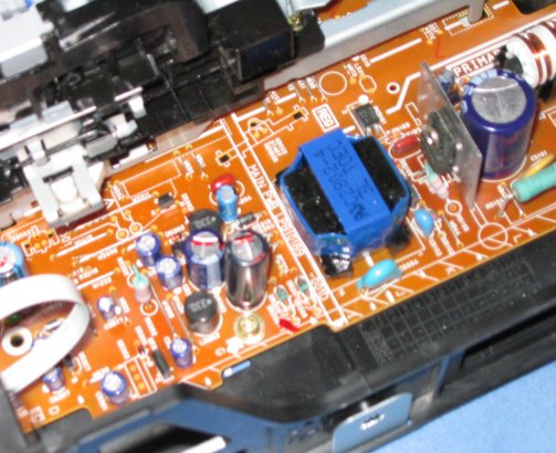

    My VCR recently died - but in the few weeks leading up to complete failure, something very odd was happening. The VCR would power up, then about 1 second later shut off again. If I kept hitting Power when it powered off, it would eventually stay powered on. However, the picture coming through from the TV was badly distorted. It took about 8 minutes to 'warm up' before the picture and sound came on properly. (If I tried to play a tape during that time, it would snap!)
    After that, it took a further 10 minutes before the RF-out would work.
    Right now, it won't power up at all - not even for a split second. When I connect it to mains for the first time, I hear a small 'squeal' from the VCR but nothing else happens.
    Opening it up, I found a capacitor that may possibly be domed, but I'm not sure. It certainly sounds like a capacitor problem - the squeal could be the capacitor trying to charge and not managing. When I get home, I'll edit this post with a picture of the suspect capacitor.

    Check the caps in power supply. If it's old enough, some of them might be dried out without any change in appearance.

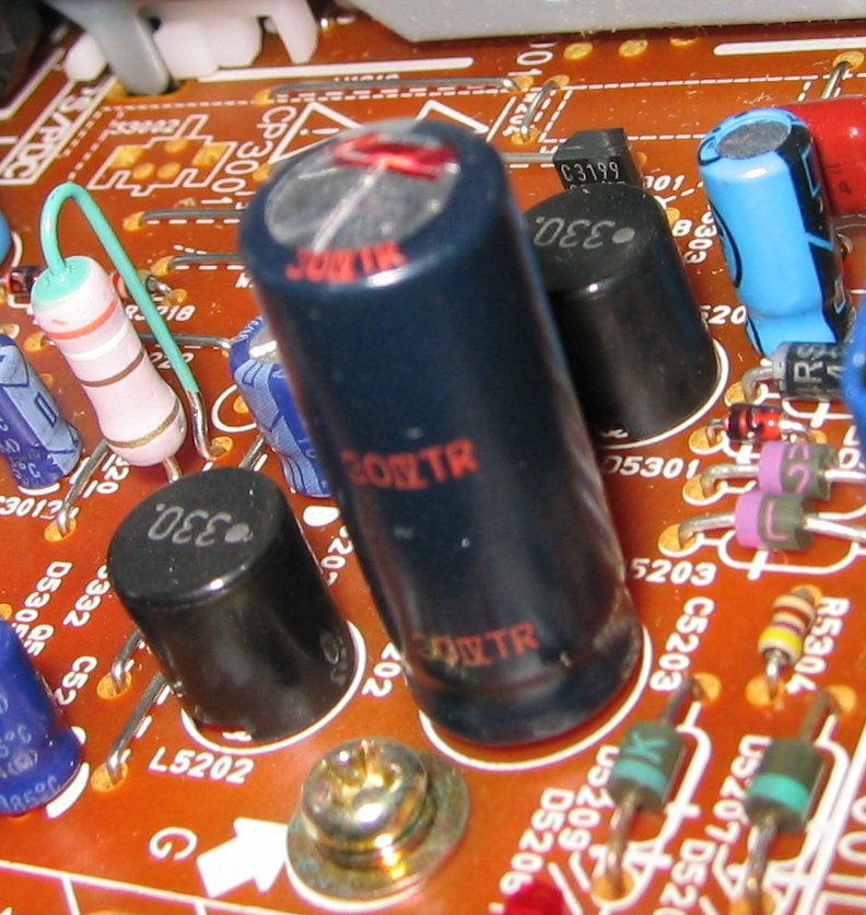

      Here are a couple of pictures of the suspect cap. I would have edited my first post, but I didn't see an 'edit' button anywhere.

        looks like panasonic fc unless fake. a good cap. second photo, on the right, low fat cap. yes another panny fc.
        • arneson
          • Sep 2005
          • 1267
          Re: Bad capacitor in a VCR?
          I would not suspect those caps in that VCR.
          That machine would have other problems instead.

            Is it my eyes, or is that cap bulging slightly at the top in the first pic?
                The top of the cap does look suspicious at least on the photos.

                        From what the pics show , all of the bulging capacitors are due to be replaced specially the larger one , you can check it with an analog ohmmeter to be sure , start with the X1 and go higher on the scale if you don't see the capacitor charging accordingly ( Capacitance rating is relevant ) Some capacitors would take longer to charge . If they are bulging just a little . I would personally replace them . Cheers Ray
