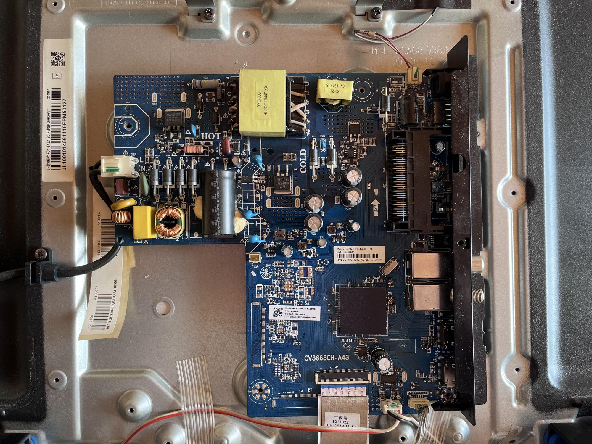

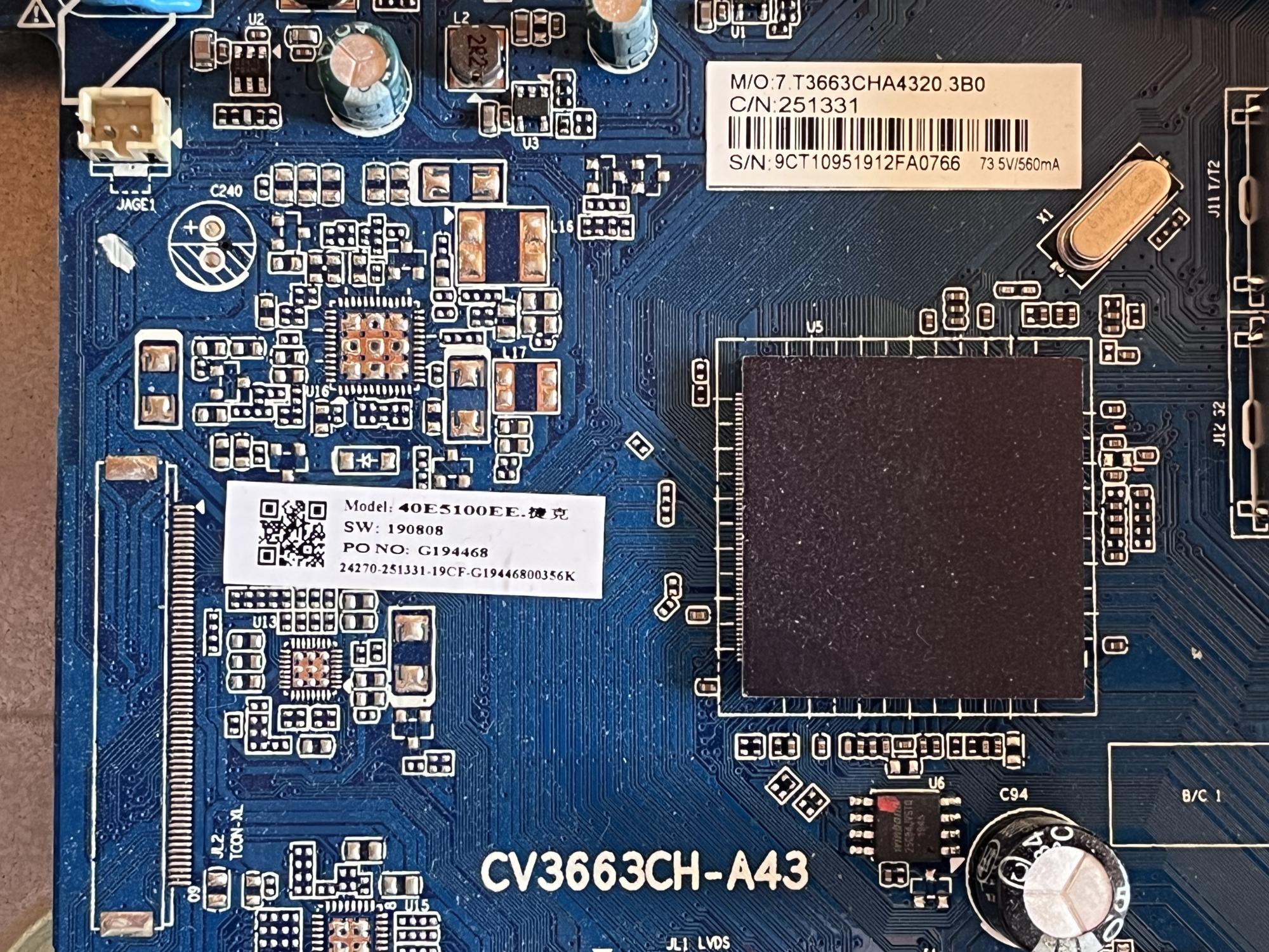

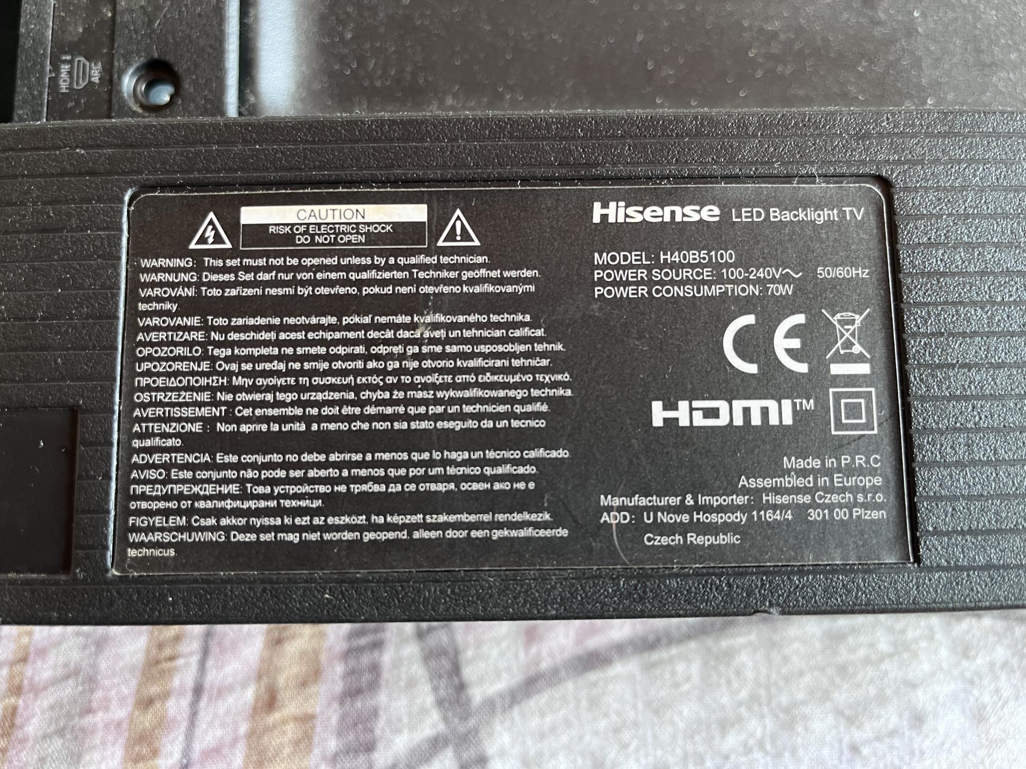

    Anyone have schematics for TV Hisense H40B5100?
    I have one without picture, backlight work.
    There are no broken parts with visual inspection.
    Any advise what can be wrong?

    Re: Hisense H40B5100

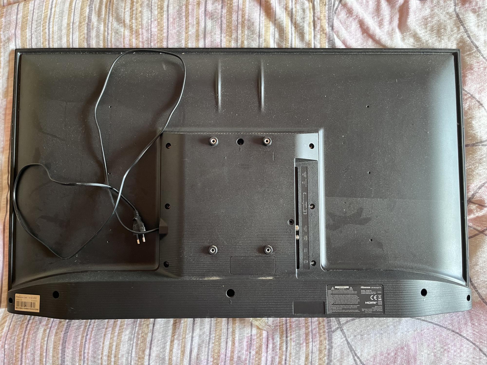

    can you post some clear straight on pictures if each board and one of the whole back as to see how everything is connected.

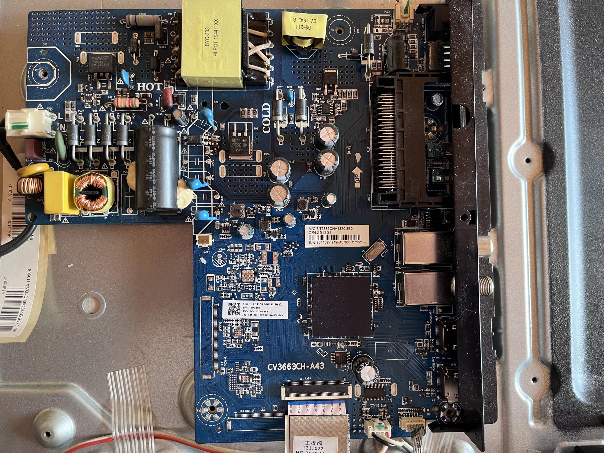

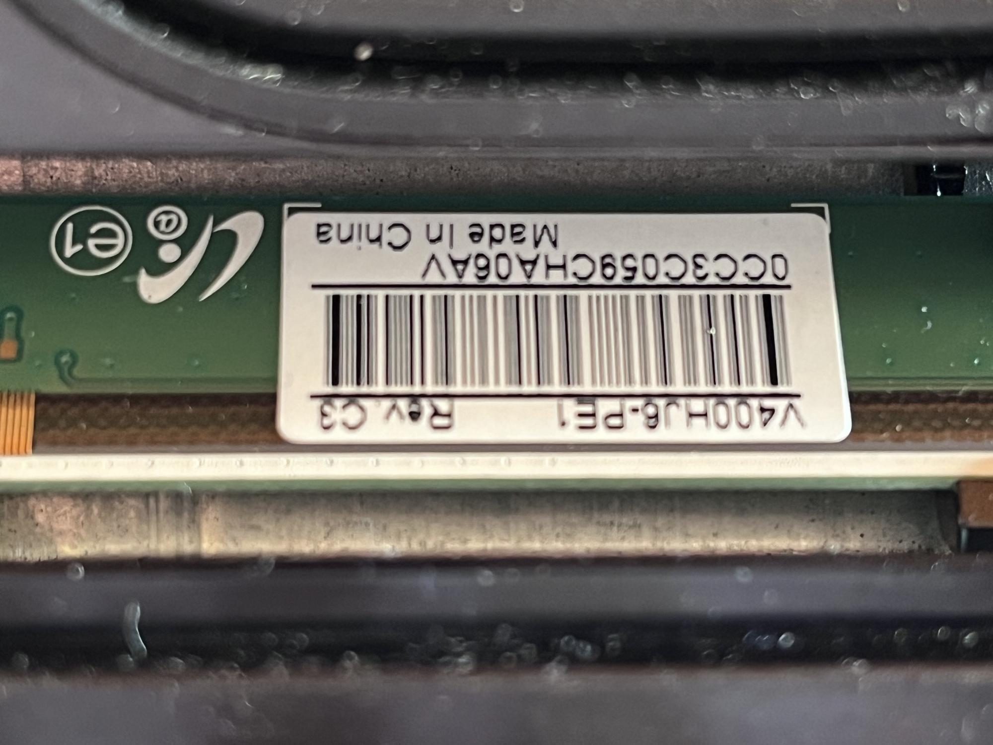

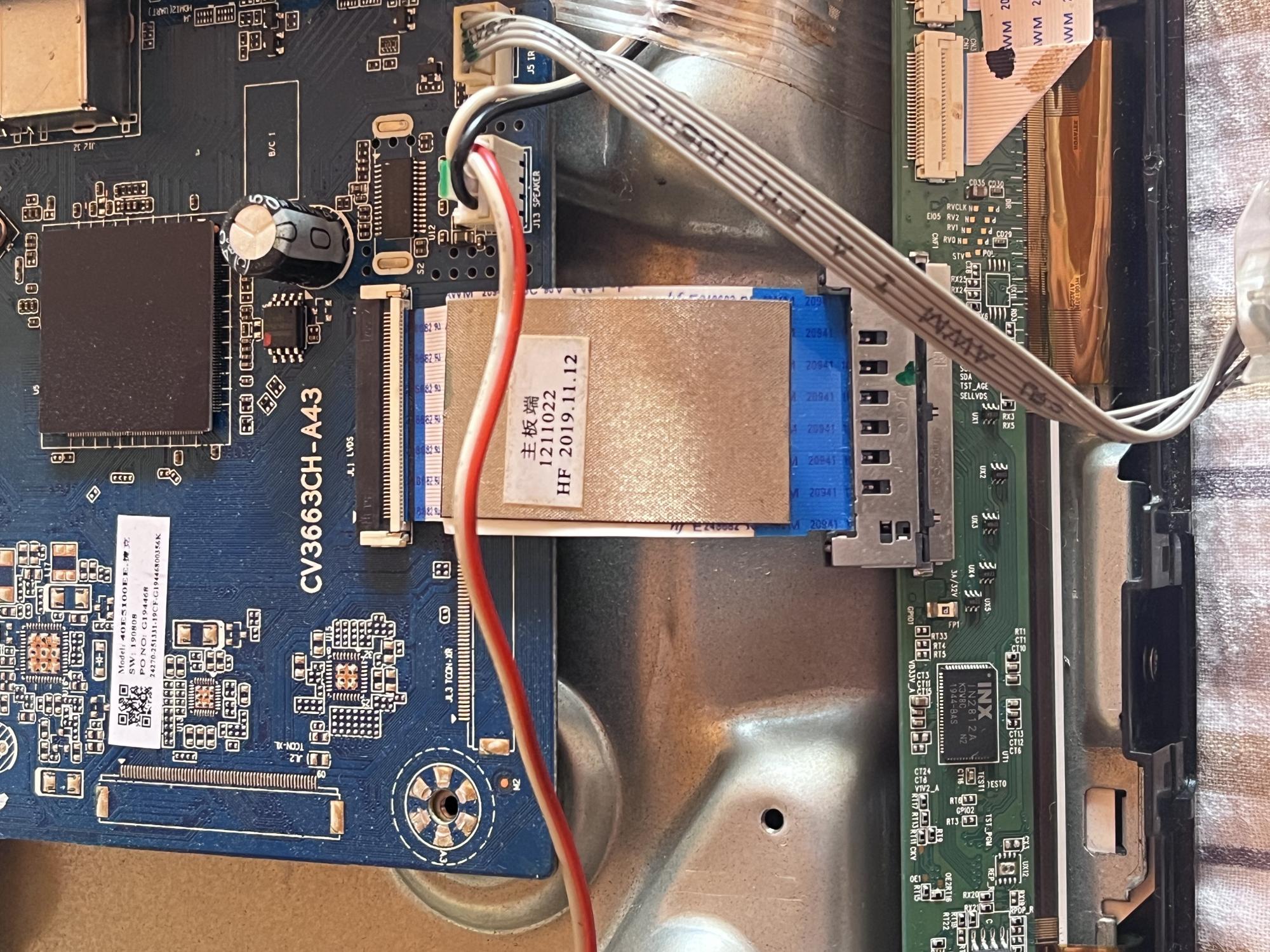

      There are pictures of H40B5100

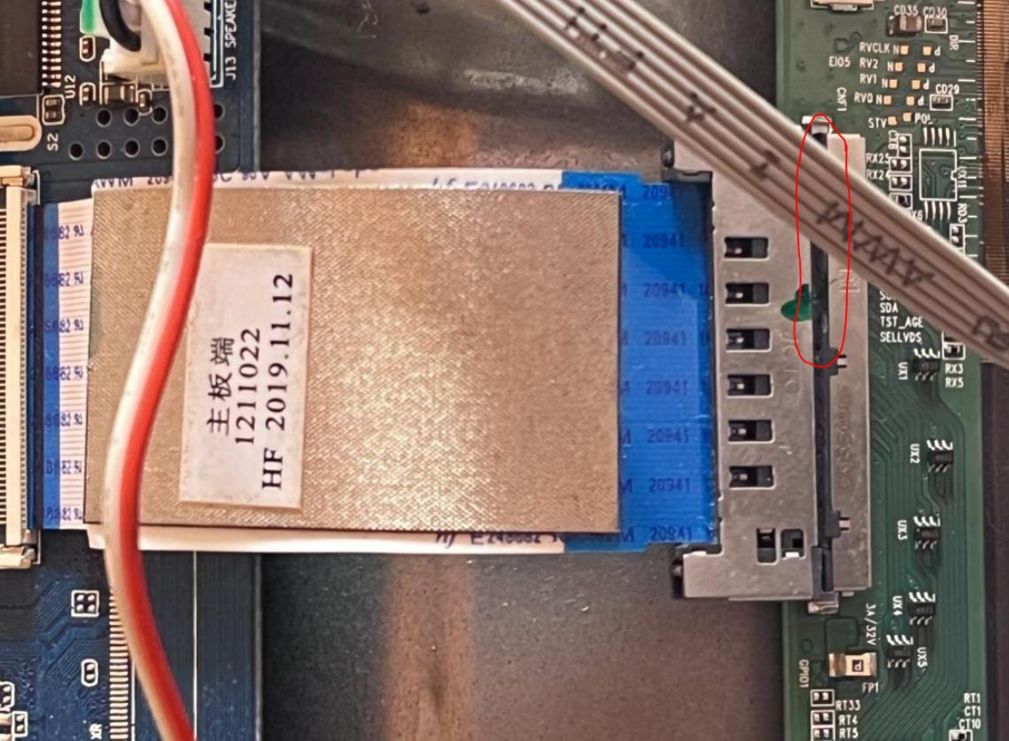

        In my opinion, you have a poorly inserted cable going to the T-con.
          after you check the cable. try to downgrade to J059.. the firmware at this set written on SPI which easy to glitch
