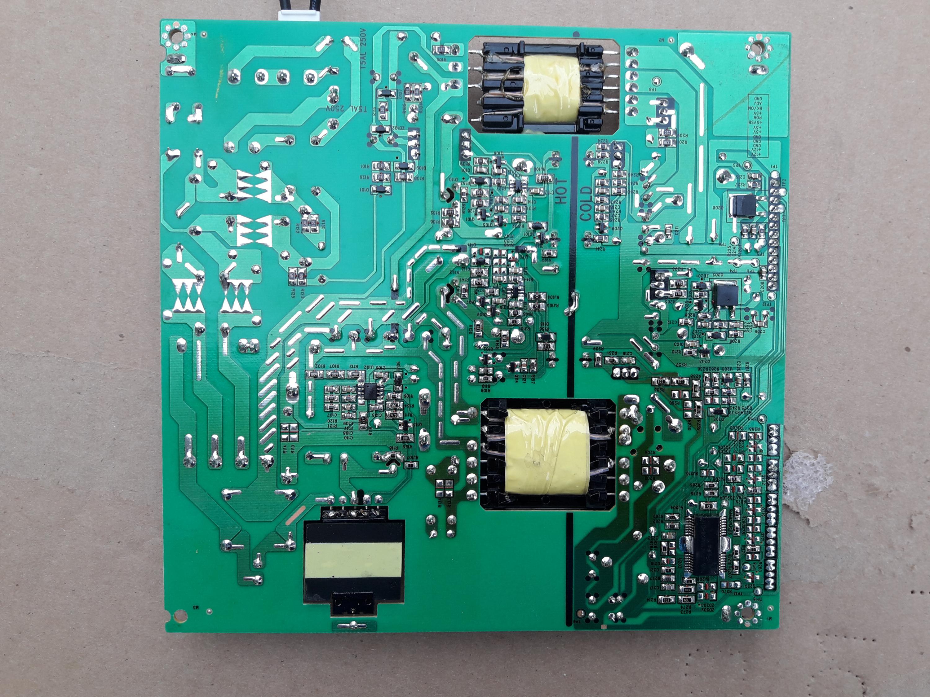

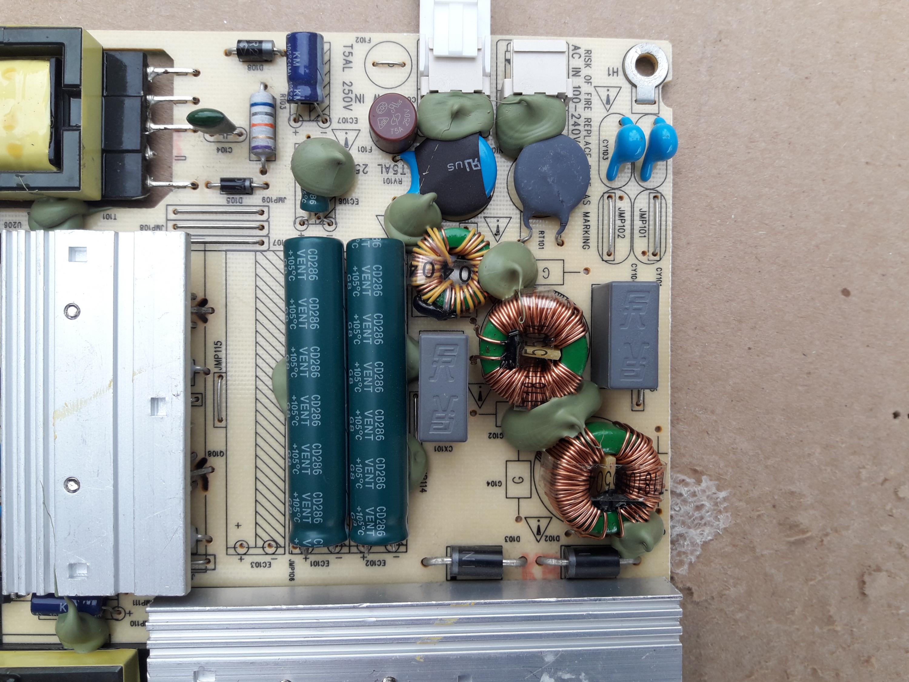

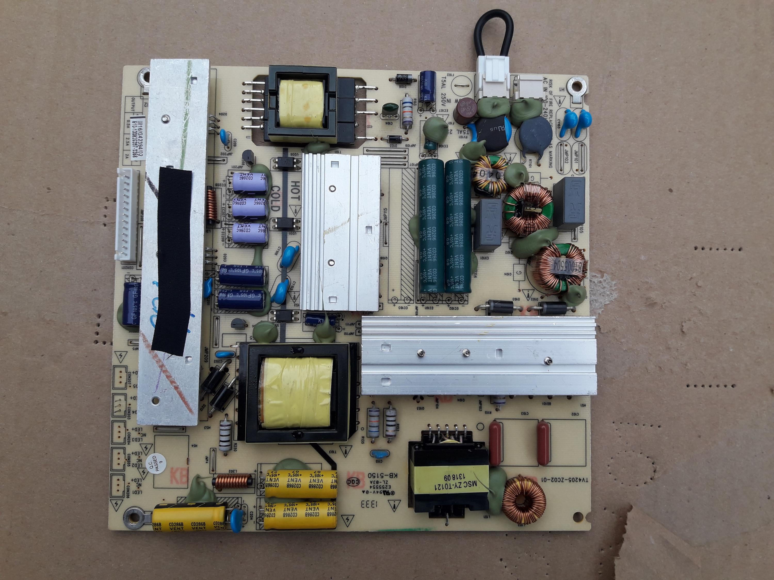

    Tore down this TV to find that all the backlights were working so part of the 1% of cases where there is a bad power supply. I confirmed the TV was producing video by powering the backlight with my LED tester and turning it on. All voltages were good (V STB, 12V) other than zero readings going to the backlight.

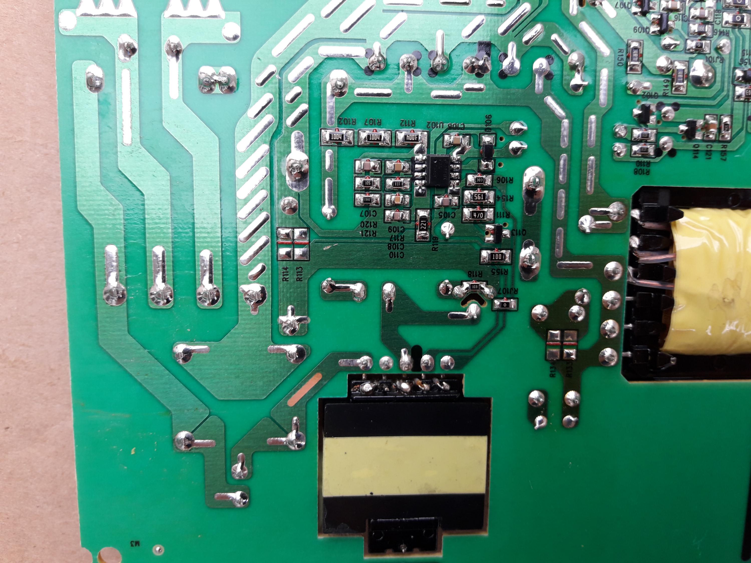

    Found a schematic and the PFC is only used by the backlight controller. Confirmed the BL-ON signal is turning on the optoisolator to enable VCC (20VDC) to the PFC IC FAN7930. PFC cap reads 180VDC in standby and the same when turned on so not boosting. Checked all power diodes and FETS in the PFC and they appear ok. If shorted, they would have likely blown the fuse.

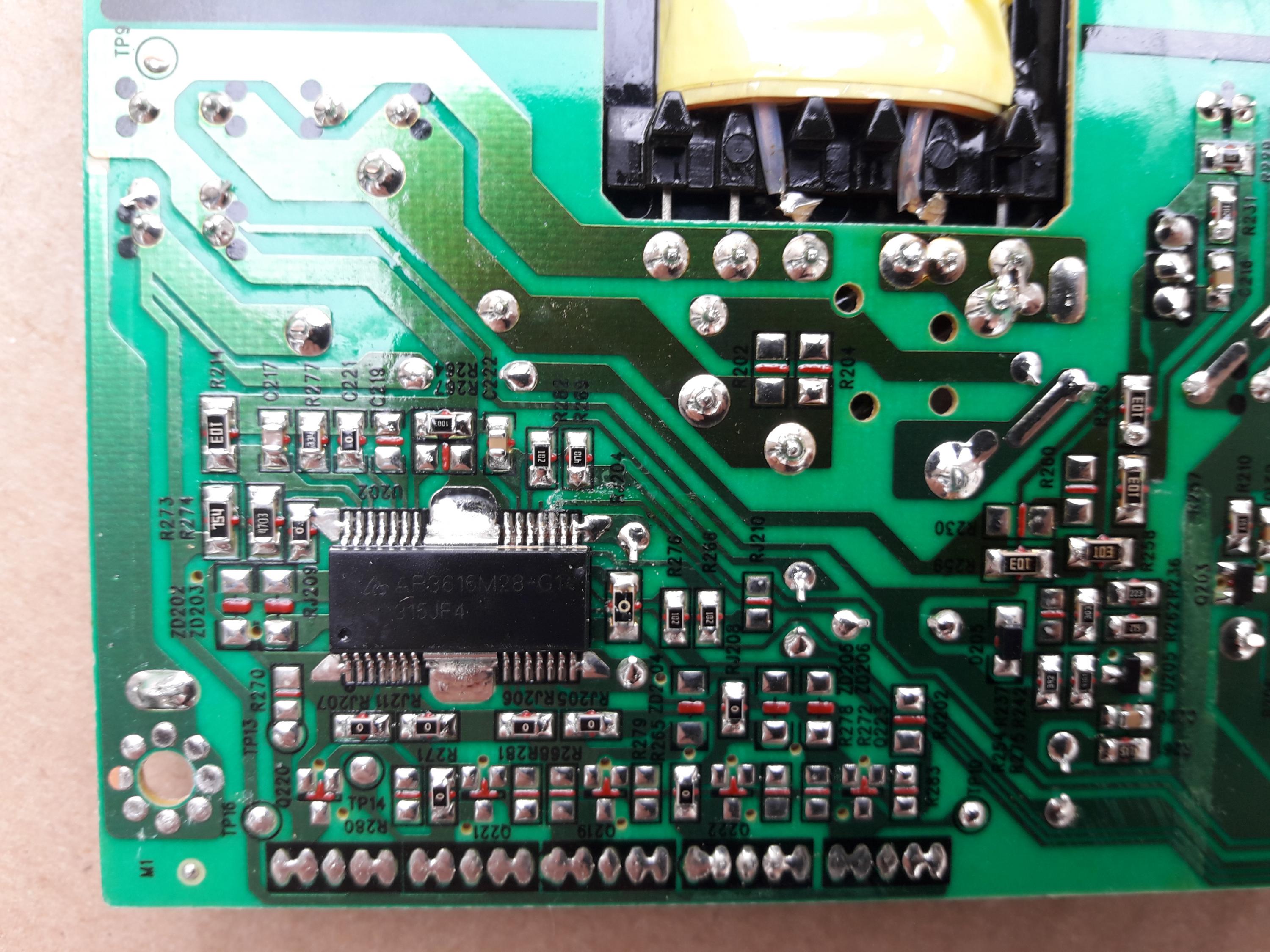

    LED controller is AP3616M28 but not the problem since it is not getting boosted PFC.
    Power supply is TV4205-ZC02-01. There are different configurations depending on the TV size and model. Mine has one connector at CON203 driving a single LED string around 130V. TV is only worth about $40 so not worth buying a new board for it.

    Check R115 to see if it is ok and not open, You could still have a problem with the backlights shutting down the pfc ic via Q114.
    One bad led in the backlight string will shut down the backlight circuit even though the led tester lights them but at a much lower current.
    The pfc boosts the voltage for the main switcher as well, not only the led circuit.
