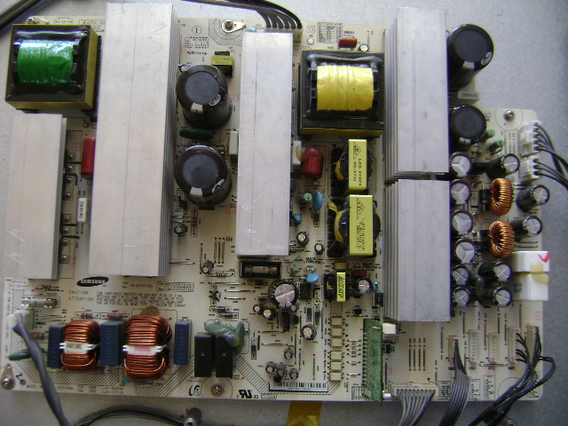

            What we need you to do first is to post clear pictures of the boards. Post as attatchments (see "Manage Attatchments" on posting page).

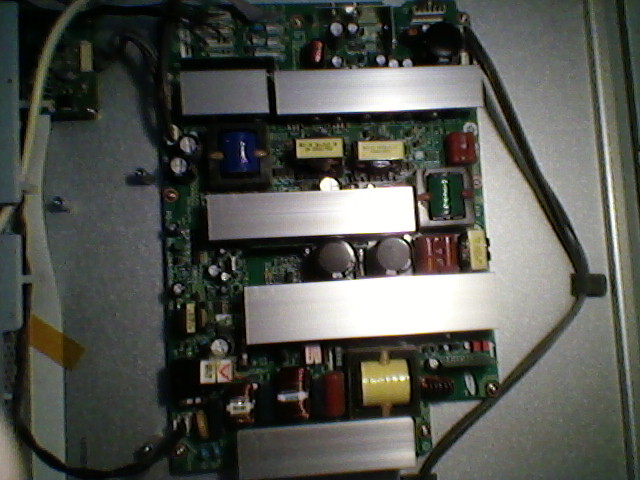

              Here are two pictures of the power board. If a clearer photo is required, i will upload at your request.

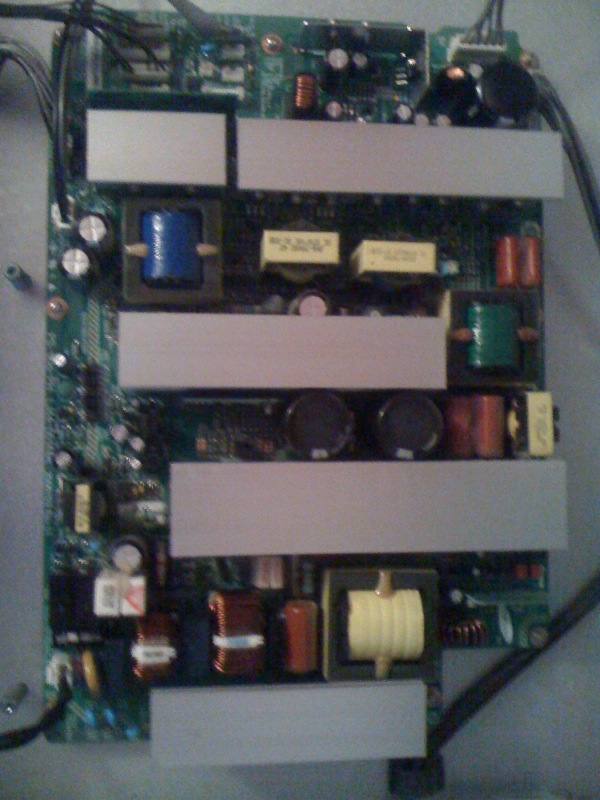

                Re: 50" Philips 50PFP5332D/37 (No Power)
                Here it is in a clearer setting. I took PlainBill's advice on better photography...

                  More information would be helpful. When the power button is pressed, what happens? Nothing, relay clicks?
                  The first thing to check would be the two fuses in the lower right corner of the power supply. You might get lucky and find one of them blown. No, it's not OK to replace it with a piece of wire.
                  Assuming the fuses are good, the next step is to examine the connectors on the left side and bottom. IIRC, these have labels indicating the voltage they supply. The one you are looking for one may be numbered 1M03 or 1M46, and have a pin labeled +5V2stby or something similar. Now put the power supply back into the TV and hook up all the cables. plug in the power cord and check the voltage on the pin you identified above. Measure from the pin to chassis ground (one of the power supply mounting screws is fine). It should read about 5.2 volts.

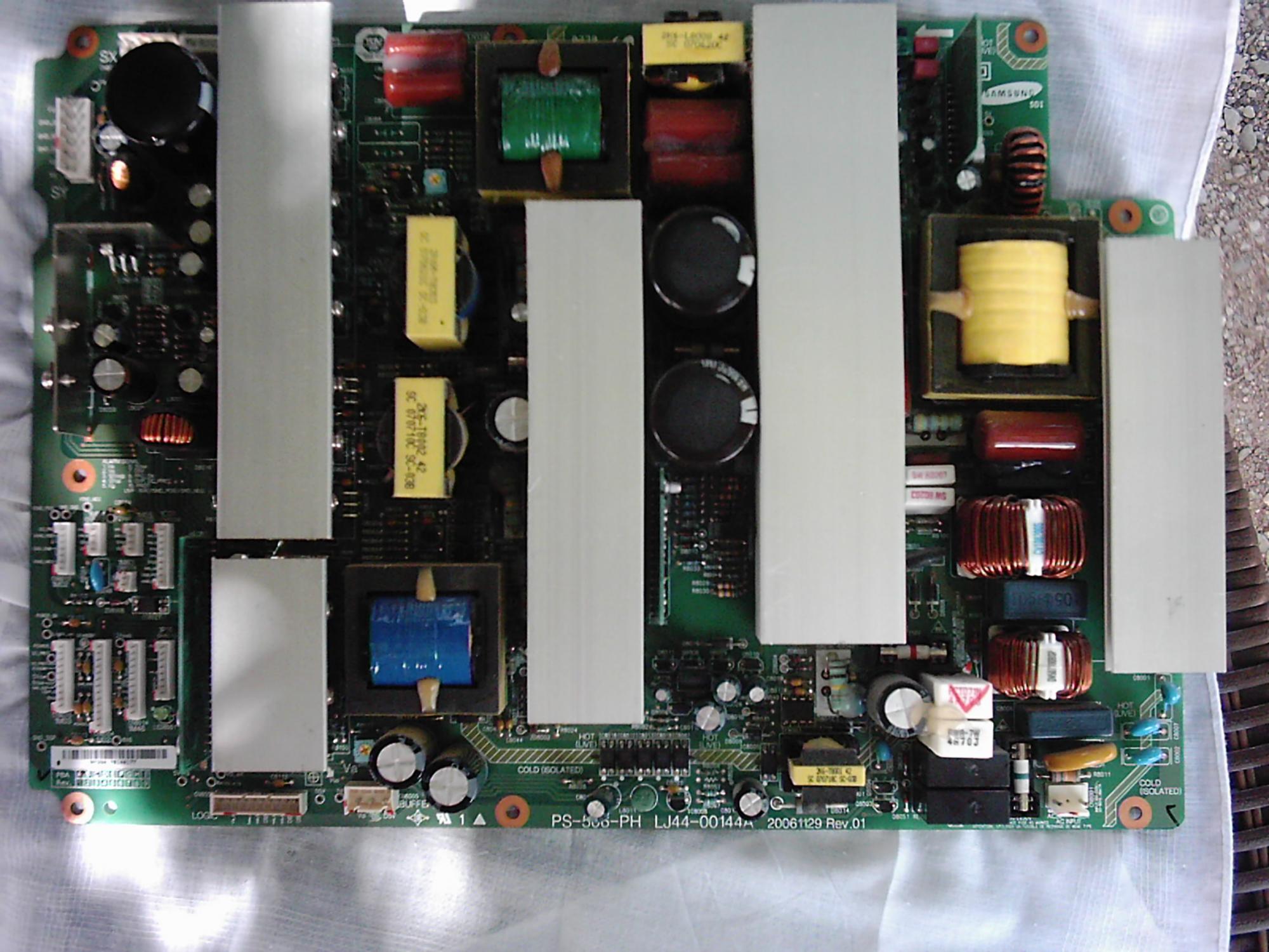

                              I am trying to repair this model for a friend. I notice that my power supply's picture is rather different from the ones posted. So, here is another version of the power supply board....
                              I guess I should note that the board version number is : PS-507-PHN
                              I purchased a rebuilt on eBay. Looking at it, I get the impression that blown capacitors is a common problem. My friend felt happier with the rebuilt, than my repair of the board. I assume that my replacing the obviously 'pregnant caps' would have done just as well... Anyone else have an opinion?
