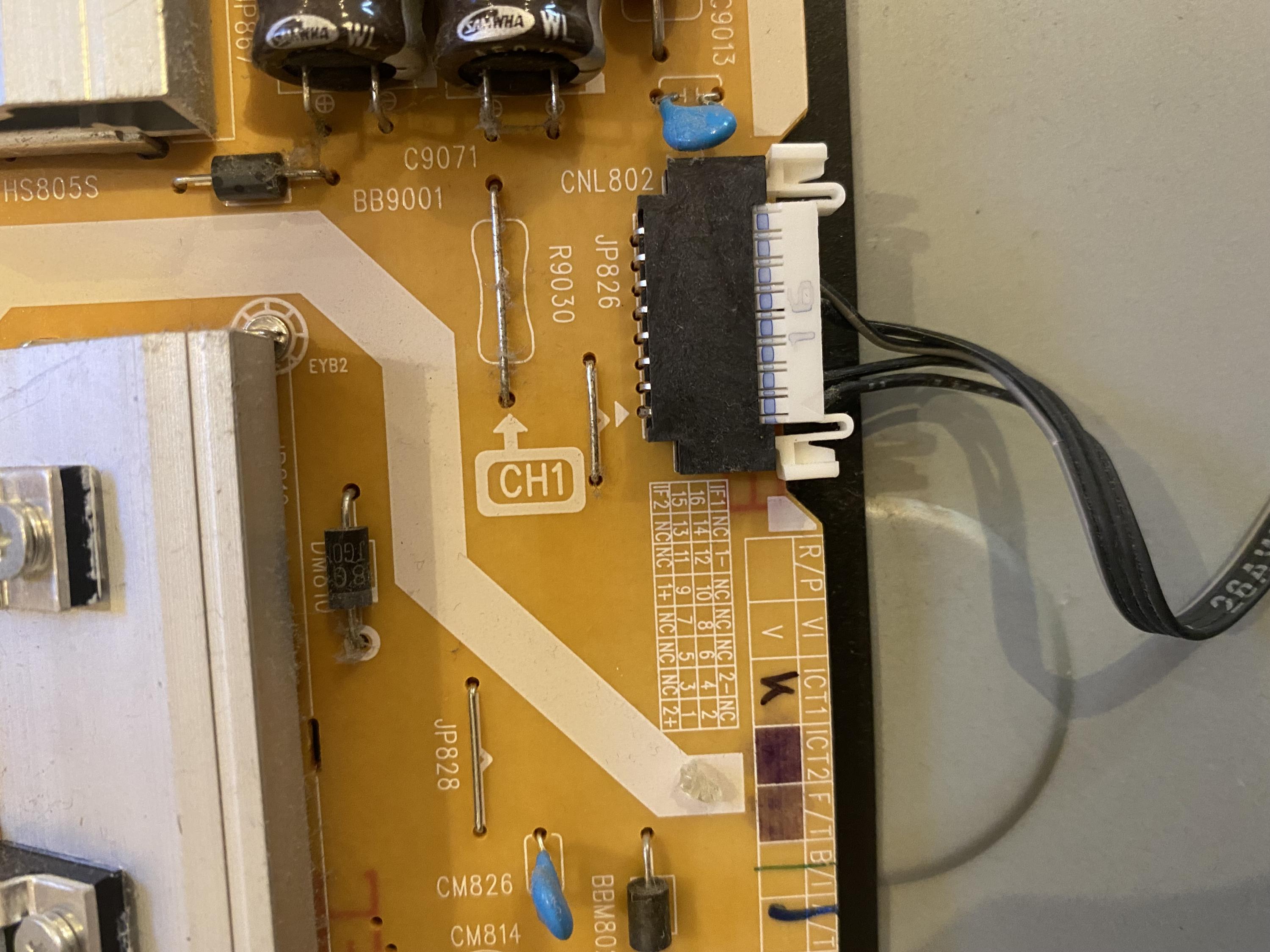

    check ALL voltages on connector, black probe on chassis metal ground, meter set to dc volts, red probe on each pin, check in standby[tv plugged in but not turned on] take note, leaving probes in place power up tv, take note, report both conditions as in, pin 1 off 0 volts on 13 volts etc, do it for every pin, example of testing there: https://www.youtube.com/watch?v=XH9GfkGQX1I

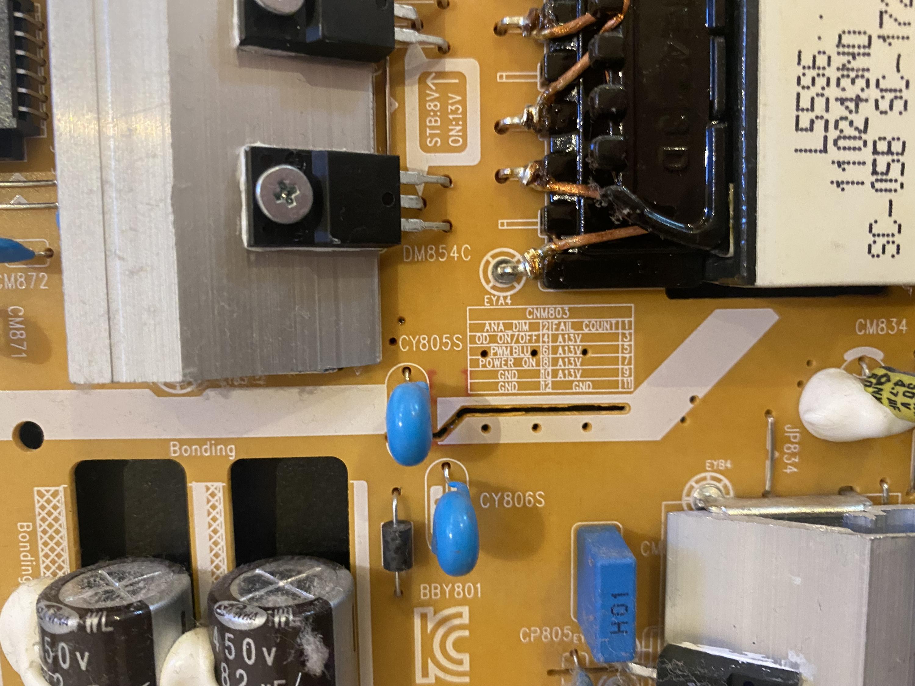

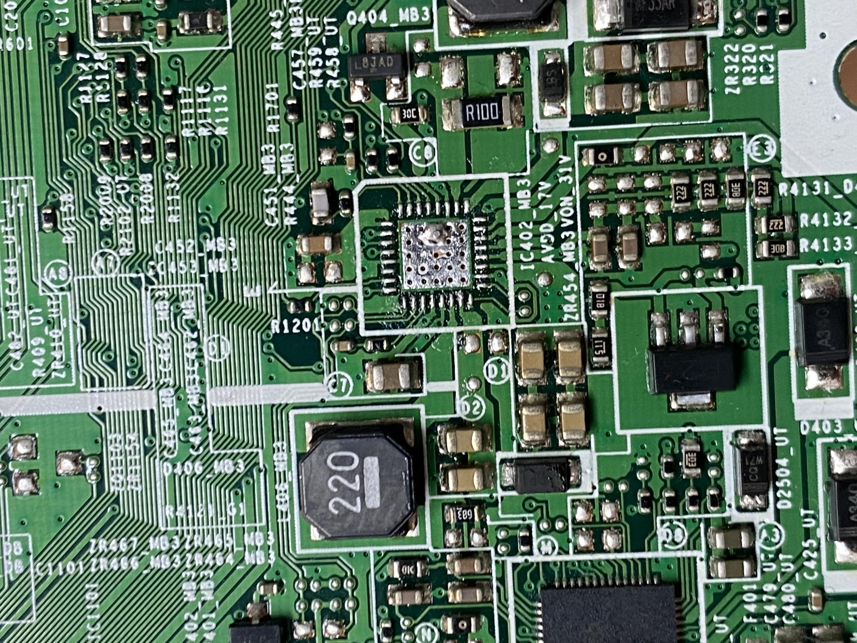

      Ok so here are the voltages and also of a picture i removed the heatsink and found a component that too me look like it is removed... hard to find picture of board without heatsink...
      This is on im not able to turn it off... when i plug it without main board back light is brigther and then get lower.... with main board try to turn it off and play with menu i cant sse and it come bighth and then lower..
      CNL802
      1=267v
      9=222v
      other are NC or negative
      CNM803
      1=0.7V
      2=3.1V
      3=12.82
      4=3.1V
      5=12.82V
      6=0.32V
      7=12.82V
      8=3.3V
      9=12.82
      10=GND
      11=GND
      12=GND

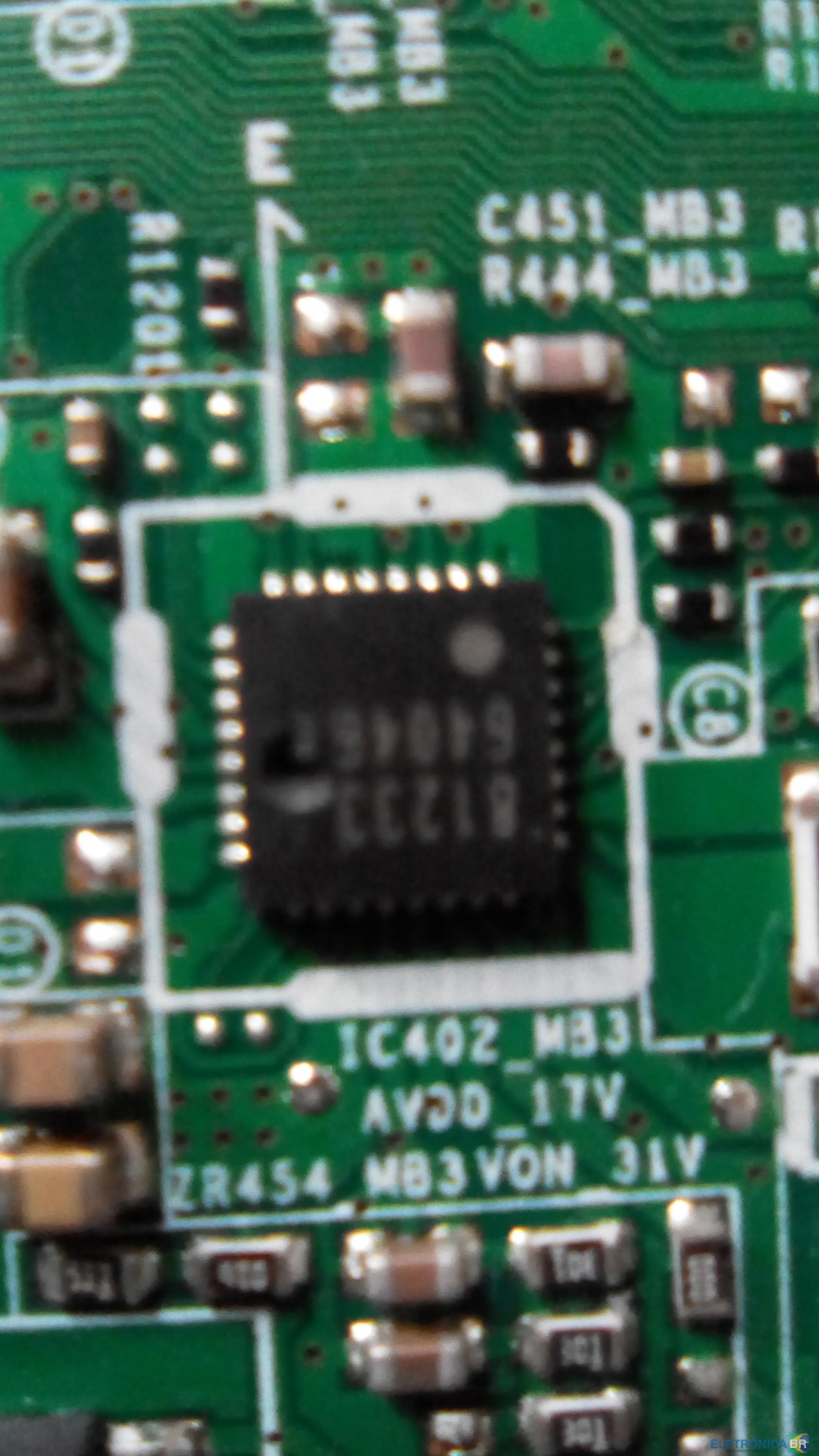

        Re: Samsung UN55KU6290FXZC no picture but backlight work
        Yes, you are missing the IC402 chip (BM81233MUV).
                        This chip does not just burn out, but it burns out from a panel malfunction (something is shorting the power output of this chip, it can be VGH ....).
                            Look carefully at all the thin loops on the matrix where the decoders are located, if there are any burnouts on them.
                              ok so i tested from pin 18 vgh and it is shorted to gnd... i looked aroung and there is an inductor L406 that is shorted to gnd on all 4 pin so i guess this is not normal?
                              DRP pin 14 is also shorted to gnd
                              this is with board out of tv
                                L406 and should be on GND (look at its pinout on the board).
                                Maybe you are lucky, ceramic capacitors can also short on the VGH signal.
                                    ok so i was all wrong google showed me a completly different part when i did my seach so i was on the wrong led and now it is impossible to find this part datasheet
