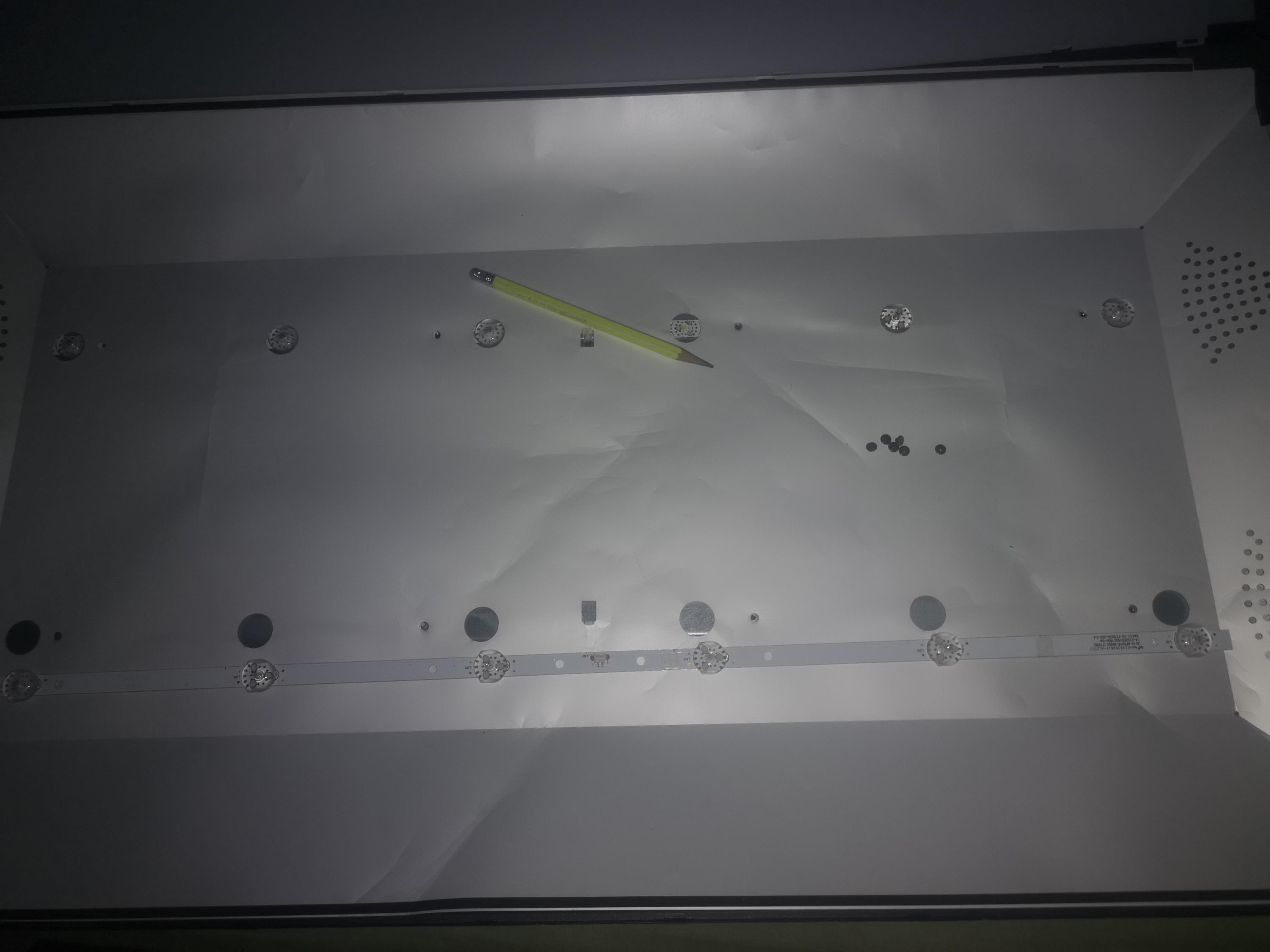

    Hie everyone.
    I have an Ecco 32 inch led tv with backlights problem. It's using 2 led strips of 6 leds each. The connector from the power supply board is in the middle of the strip.Does this means they are one set of three is in parallel with the the other. I have 7.6 V on the power supply and on the connector it's labeled 18v.
    Also how do I test each strip and individual led
    I have attached a Pic of the led strip. The tv is Ecco Led TV, model no. LH32
    Please help

    Re: Testing backlight led strips
    Do you have a LED tester? If not get one from Screen Vision in Industria West JHB.
    011-2471300
