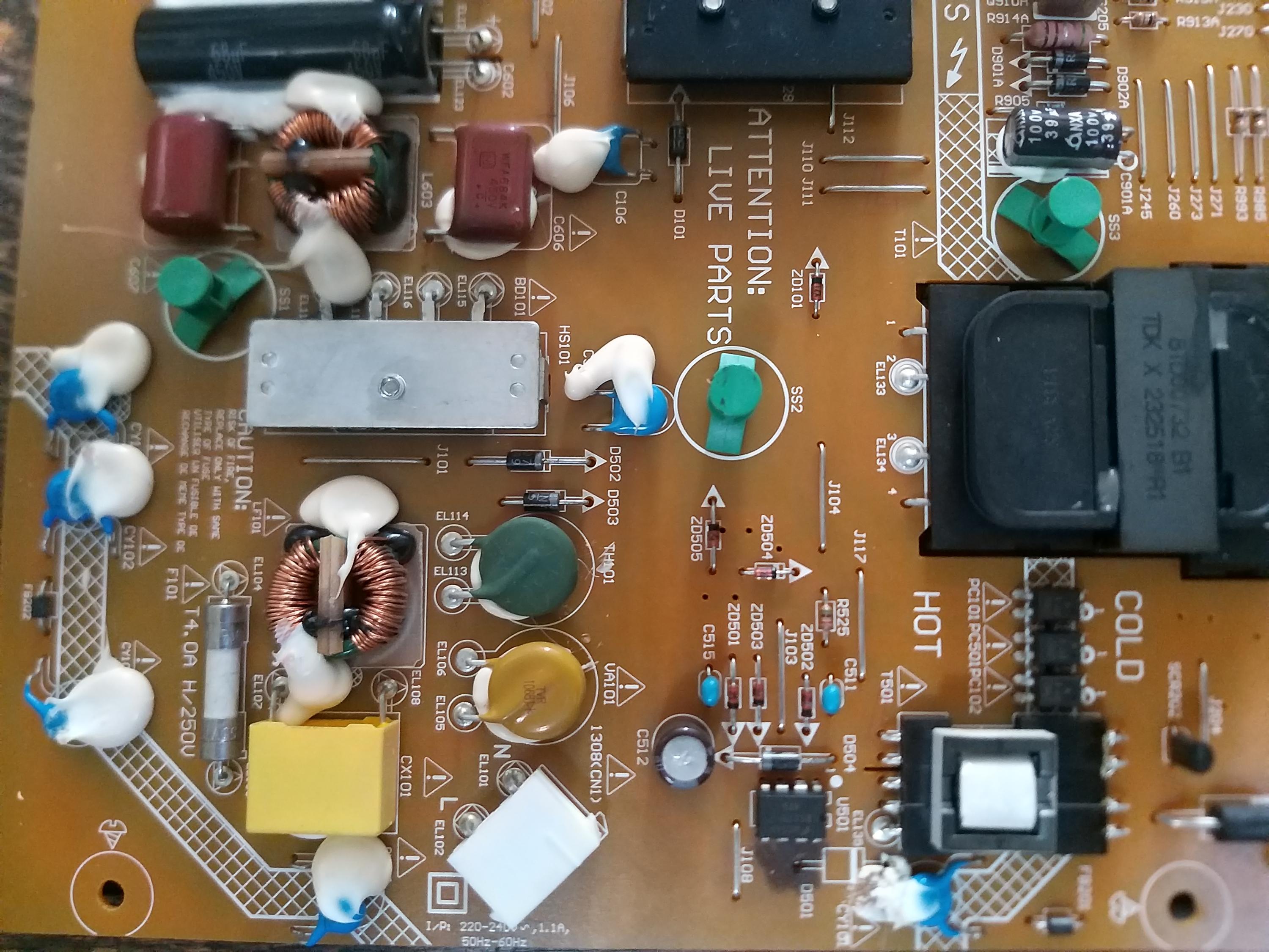

PHILIPS 40PFL7007 TV DEAD. D501 testing SHORT on DMM
  • vikivng
    • Feb 2019
    • 228
    • uk

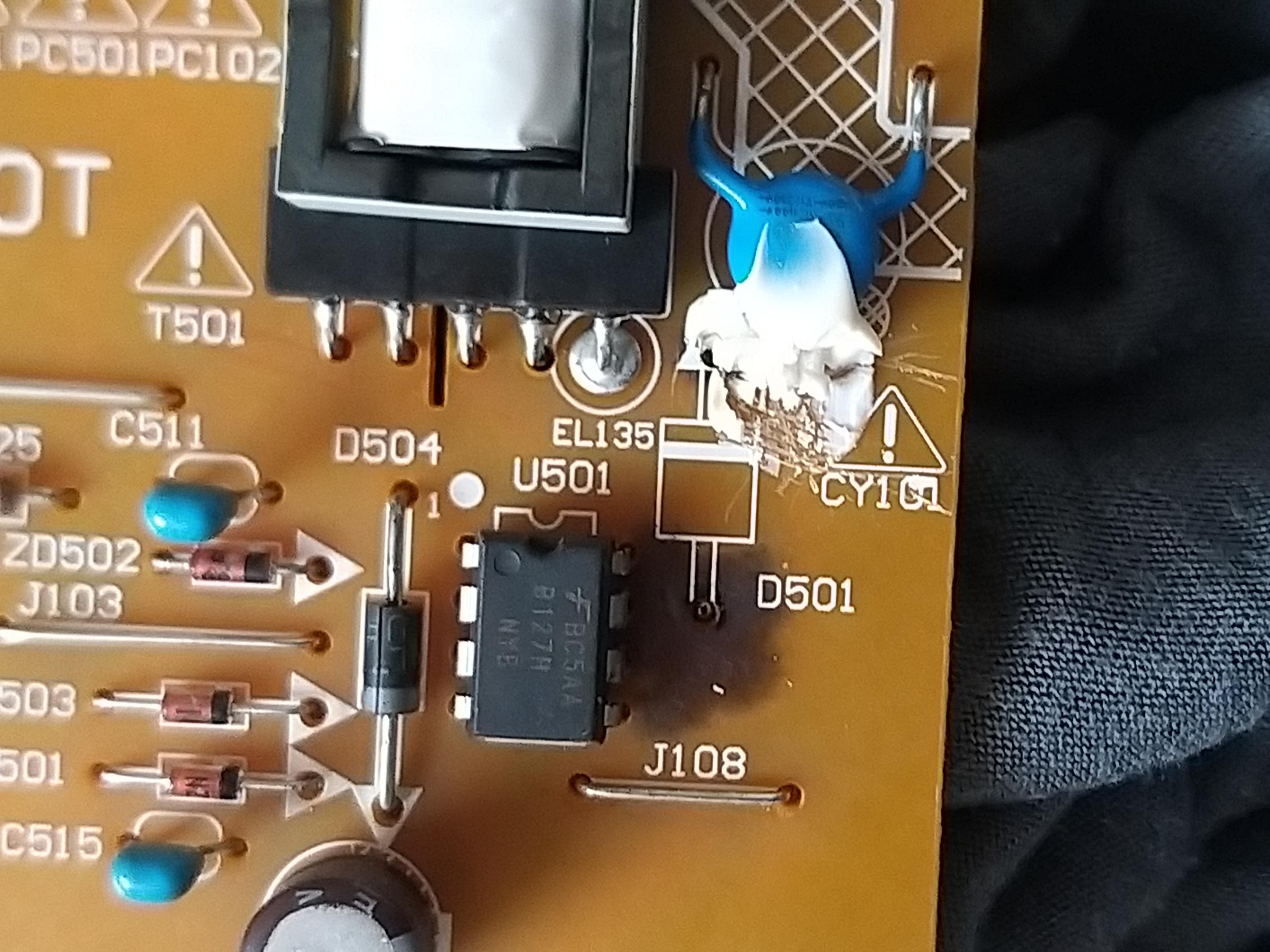

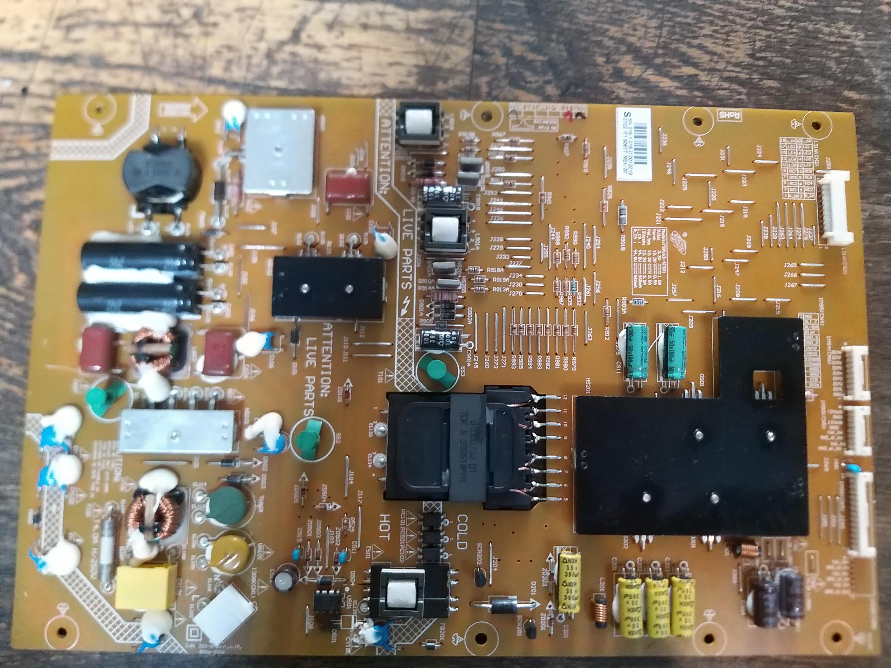

    Hi guys pls can someone help with this set..
    Tv doesnt not power on.
    No standby light.
    There is a burn mark by the leg of D501 diode.
    The diode tests short in both directions.
    I have been reading this usually means the diode is faulty? As normally would be open.
    I have not yet taken voltages since this is obviously short I would like to replace it.
    Can someone help me with a substitute for this diode since it seems not to be the standard type?

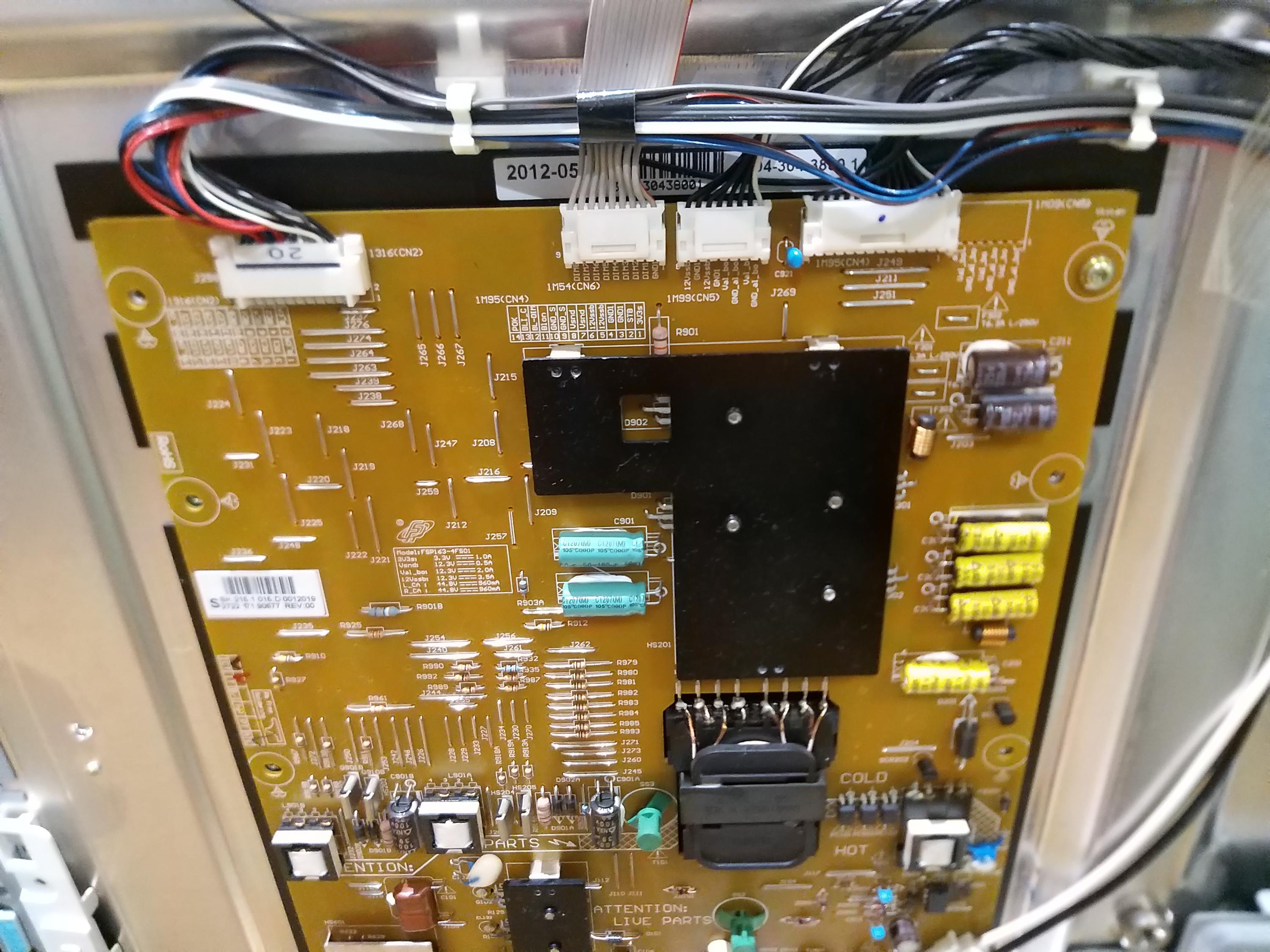

    Re: PHILIPS 40PFL7007 TV DEAD. D501 testing SHORT on DMM
    Another pic showing where diode was removed from.

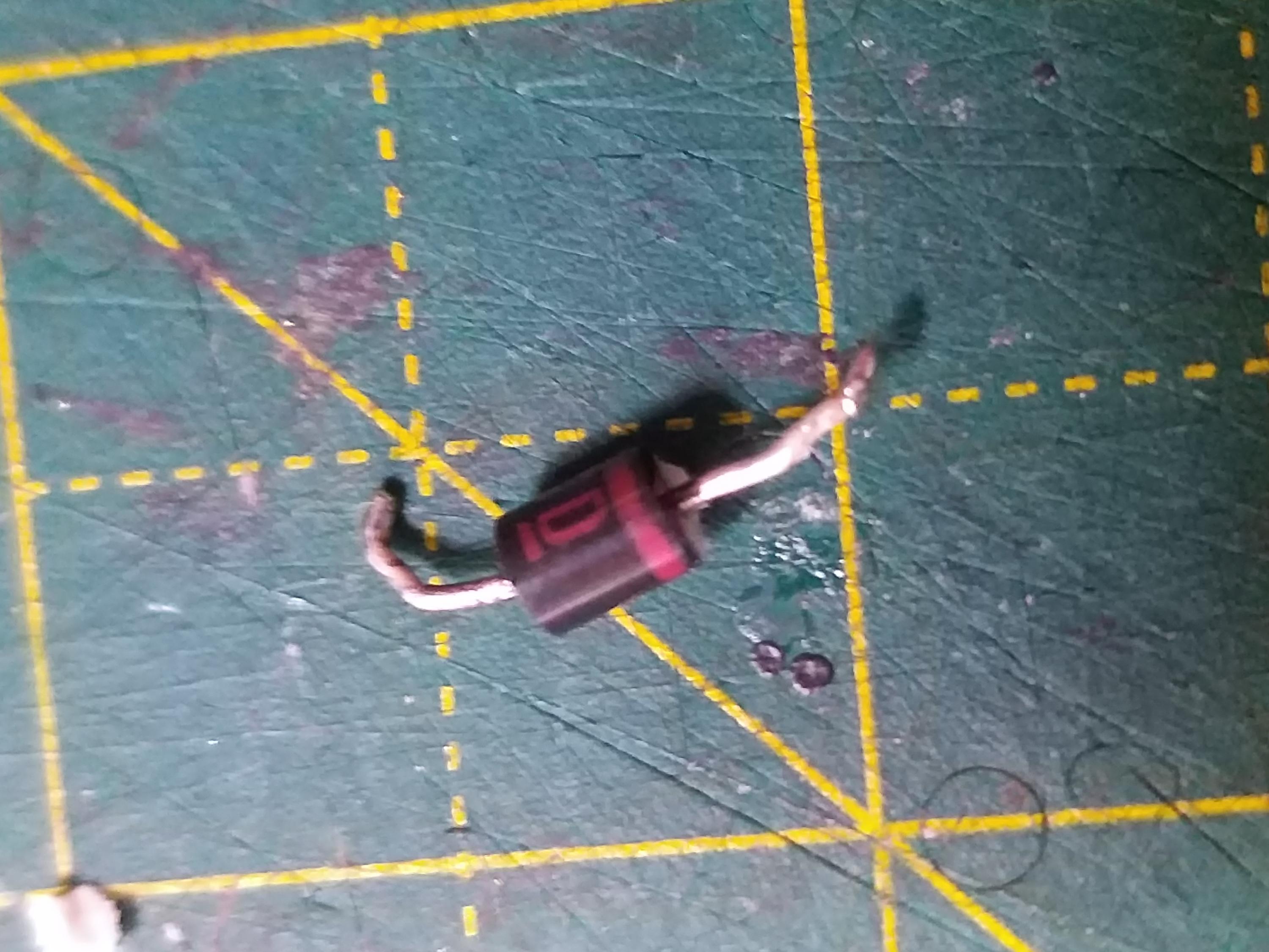

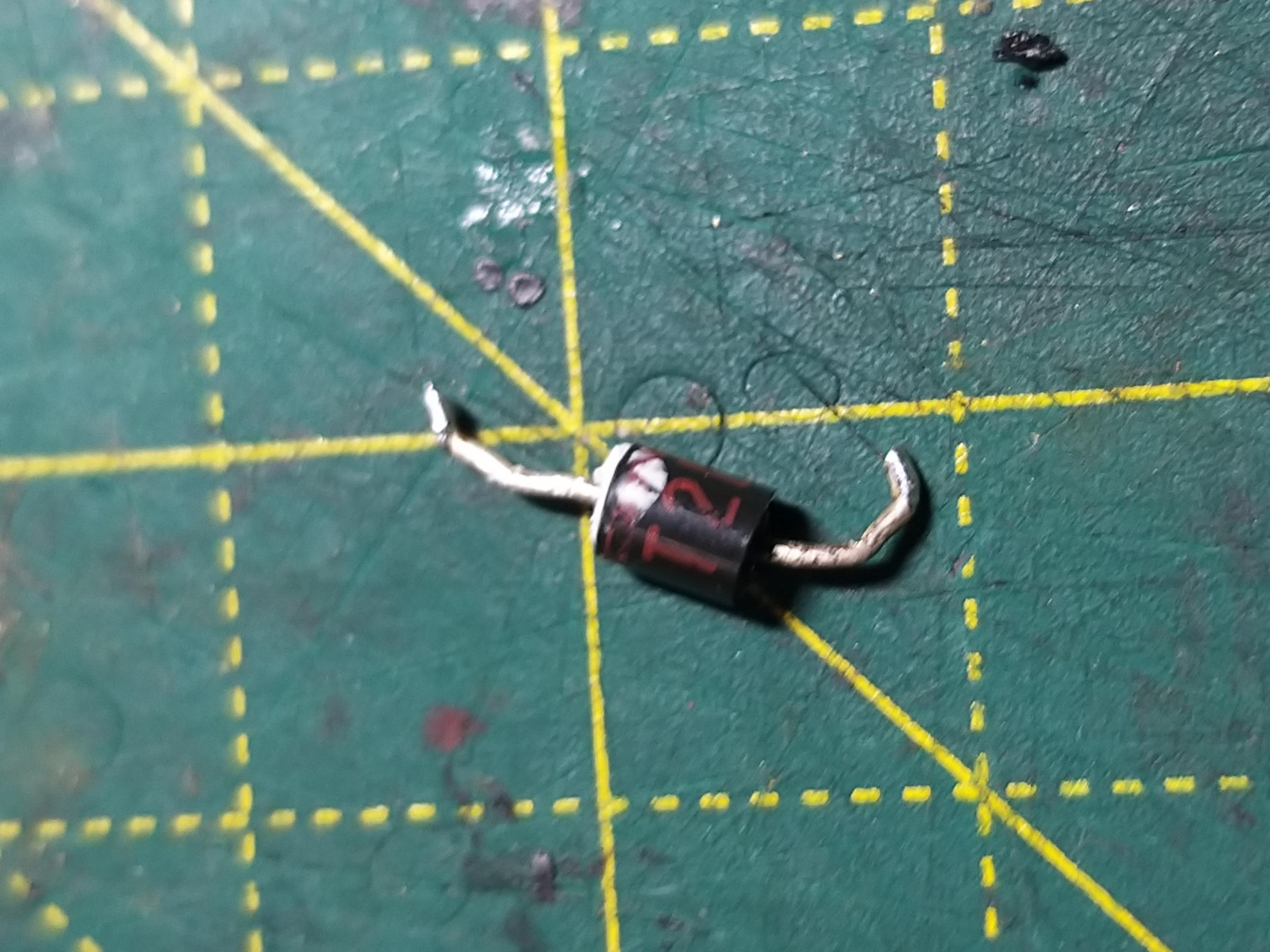

      yep its bad, look at the diode what are all the letters and numbers on it?
      • vikivng
        • Feb 2019
        • 228
        • uk
        Hi there,,many thnx for the quick reply
        Markings are T2D 1D

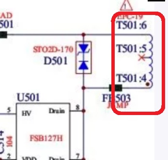

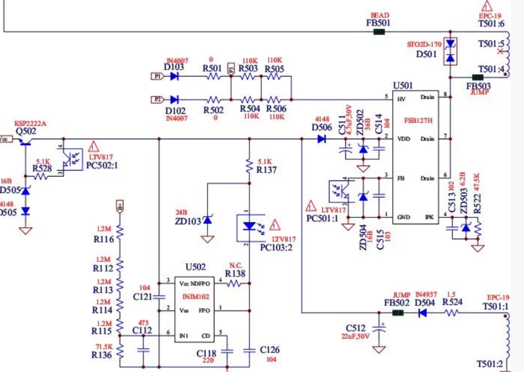

          D501 - st02d-170
          • petehall347
            • Jan 2015
            • 4439
            • United Kingdom
            Sidac / Uni-directional Thyristor (G1V Series)
            surge protector
                The diode is not faulty, you also measure the transformer if the diode is still on the pcb. This measurement error is very often made with these power supplies. Measure the diode from the circuit or measure the standby voltage, if it is present then that part is working properly

                  i think he measured it out of circuit.
                    Hi sorry didnt see these replies..Yes just to confirm (before I purchase the part as I am still searching for a UK source with less than extortionate postage)
                    I get a beep in both directions in continuity mode.
                    I am pretty sure this shouldnt be the case..?? Pls confirm this guys..thnx
                    Out of circuit.!
                      YES, diode is shorted, bad, no good.
                                is this in reply of:
                                So did you measure diode or diode location?
                                And what about the main fuse?
                                What about: "measure the standby voltage", with diode in place?
                                  Hi ,thnx for the replies.
                                  I have been caught up doing other things so only now can I reply.
                                  The main fuse is good which seems strange.

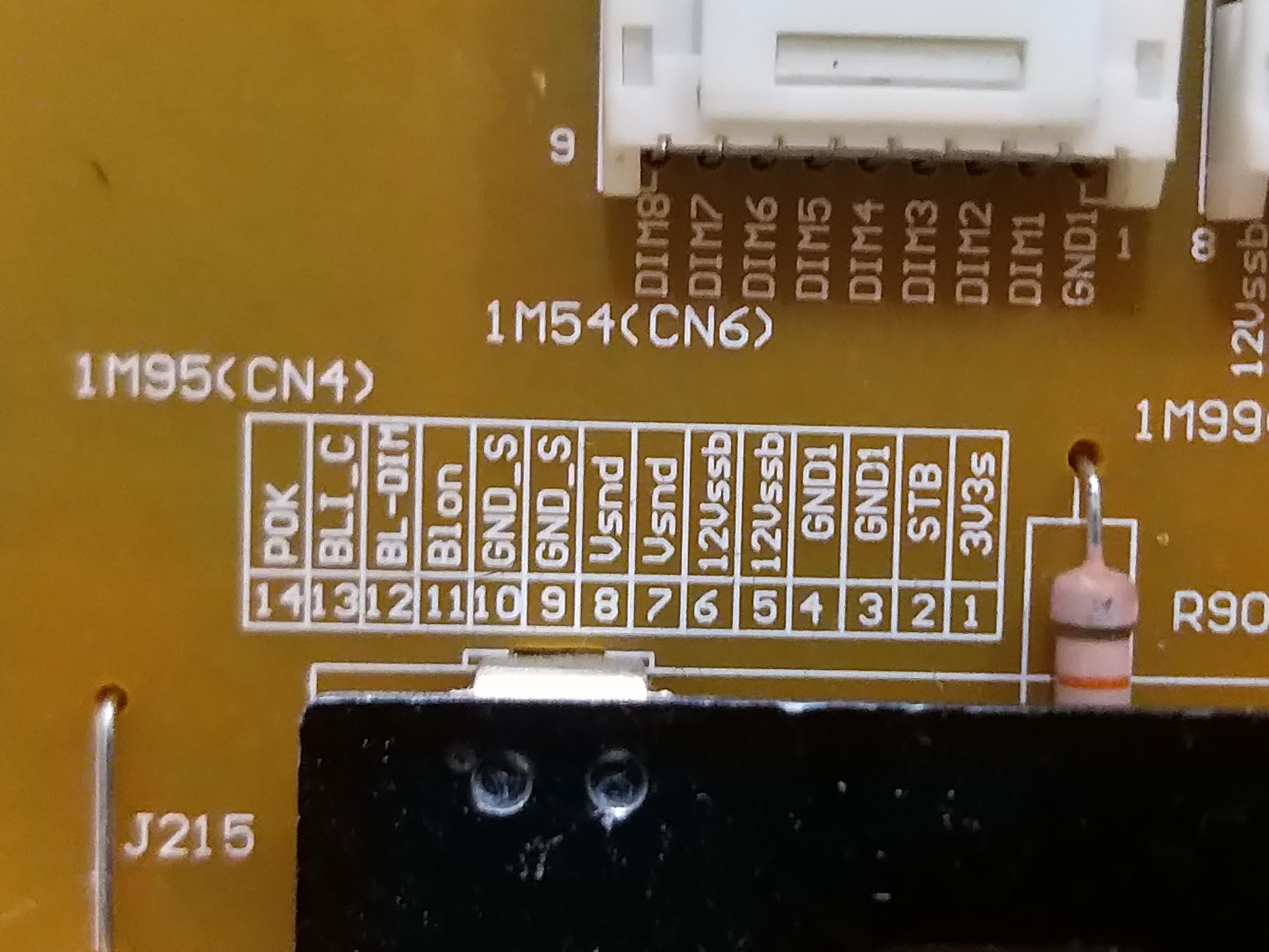

                                  Anyway I have taken voltages with diode still out (it should be safe to turn on the set without this diode for a short time since the diode is for protection?)
                                  Anyway here are the voltages on the psu connector to main board
                                  1= 3.3v
                                  2= 3.1v (yes I now get standby. 2 blinks)
                                  Pins 3-12= 0v
                                  14= 0.4v
                                  Main cap gives me 399v across the legs

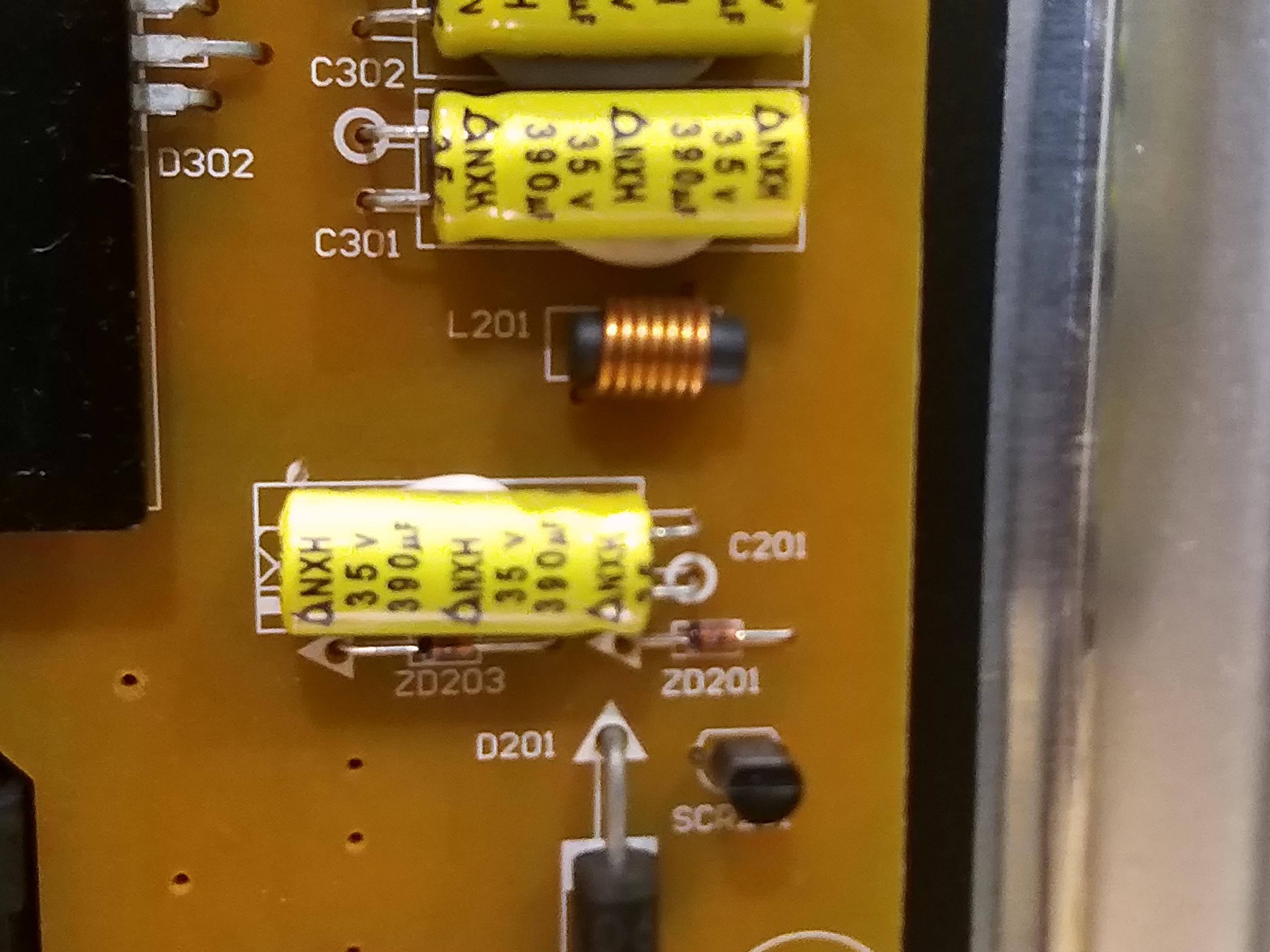

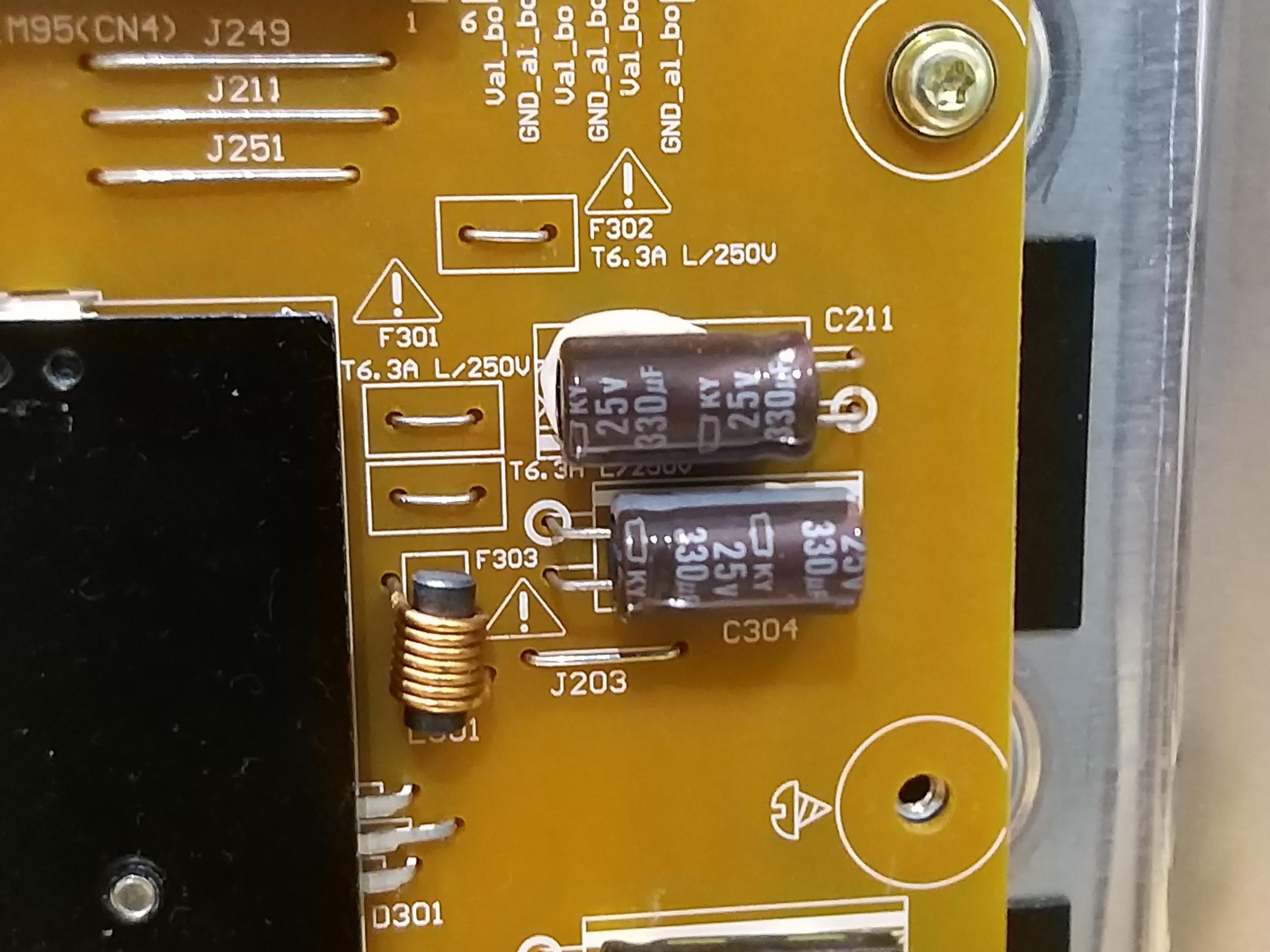

                                  C211=3.3v
                                  C201=3.3v
                                  I will measure diode location later today and update. Also voltages with diode put back on the board.

                                        if you keep the test point on the main board, SDM , shorted to ground and insert the tv plug in the mains, then wait some minutes , does the status led blinks? does it make 5long 3 short?
