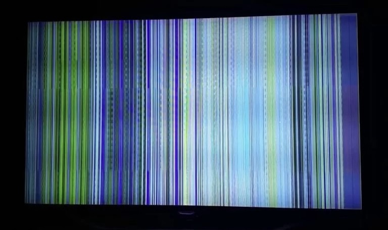

    Hi, I'm working on a Hisense 58R6009 with a bad T-Con board. InnoLux T-Con board model MACDJ4050 (BVLC0A6AH394104PB00001). The LCD screen was displaying only washed out vertical lines.
    The main chip, an INX IN8208A EN2, was heating a lot. The only replacement I found is an IN8208A N2.
    After replacement the chip doesn't heat as before, but now I'm stuck with a completely black screen.
    My question is: Is the IN8208A N2 compatible with the IN8208A EN2?
    Thanks.

              There's no way to open a thread for a video defect without making some picture of the screen.. my opinion..
              • Yanleb
                • May 2017
                • 102
                Re: Hisense 58R6009 T-Con board shorted chip
                Yeah you are right. Don't forget that my initial question was about compatibility of the two chips. Here is a picture of my problem.
                And what about my question? Do you know why cutting lines between the T-Con board and the LCD panel makes them work again?
                  already seen this behaviour, seems to me is the main processor, but to be sure try to press main processor and see if lines go away, there is something also on YouTube. I don't think chips are compatible. And on repl. tcon the main chip is still heating too much? Does it prevents to keep a finger on it?

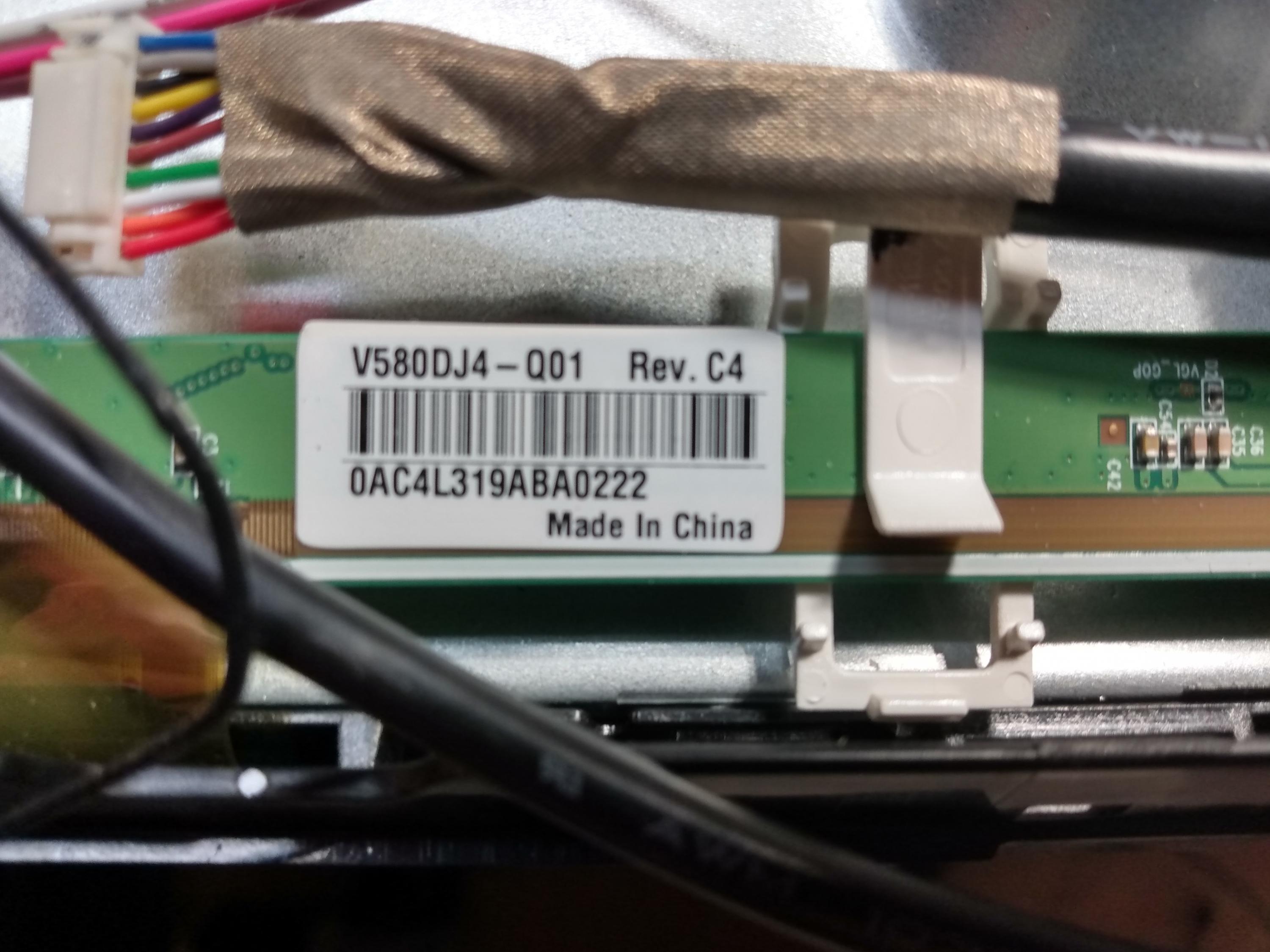

                    Hi all. I returned working on this TV set after leaving it on the side for 5 weeks. When I powered it ON I saw smoke coming from one of the COF. And yeah, short on the 1.8 volt line. The panel is now trash.
                    I've ripped off the flex cable from its board to remove the short and it restored the 1.8 volt line. Still no picture. Using a 200MHz scope I see no activity at all going to the LVDS cable. I tried with the T-Con board disconnected from the panel, and with the T-Con board disconnected from the main board. Still no signal on the LVDS cable.
                    I've tried to find the datasheet for the LCD panel. It is a V580DJ4-Q01 Rev. C4 by Innolux. One website has the datasheets:
                    https://www.panelook.com/V580DJ4-Q01...ter_35850.html
                    But you have to be member to download it. Guys, where are you finding that kind of information? I'm most interested to know if there's any kind of feedback or error report from the T-Con board to the main board. I suspect that the main processor doesn't even try to send a signal.
                    I properly reballed the processor. Actually, a reball, not a reflow. Still the same problem. Even if the LCD panel is trash I want to actually make sure that the main board is good before reselling it.
                    Thanks in advance for your help.

                        • Yanleb
                          • May 2017
                          • 102
                          A Main Board Tester. This is an interesting device. I didn't know it exists.
                          I've already disconnected the flat cable going from the T-Con board to the shorted side of the panel. Still no picture.
                          As I said, the main board doesn't send a signal to the T-Con Board through the LVDS cable. Even with the LVDS cable disconnected between the main board and the T-Con board I don't see any kind of signal using my 200MHz oscilloscope.
                          I wanted to know if there's any kind of error reporting or feedback from the T-Con board to the main board. This would explain why the main board doesn't output any signal if it is seeing an error coming from the T-Con board.
                          I do have sound, but no picture at all. No LVDS signal.
                          There's a few (not many) Innolux documents. Here is one. It is not the right one for my LCD panel (as I said, I found the right one but I need an account to download). Do you see any any pin carrying a signal FROM the T-Con board TO the main board?
