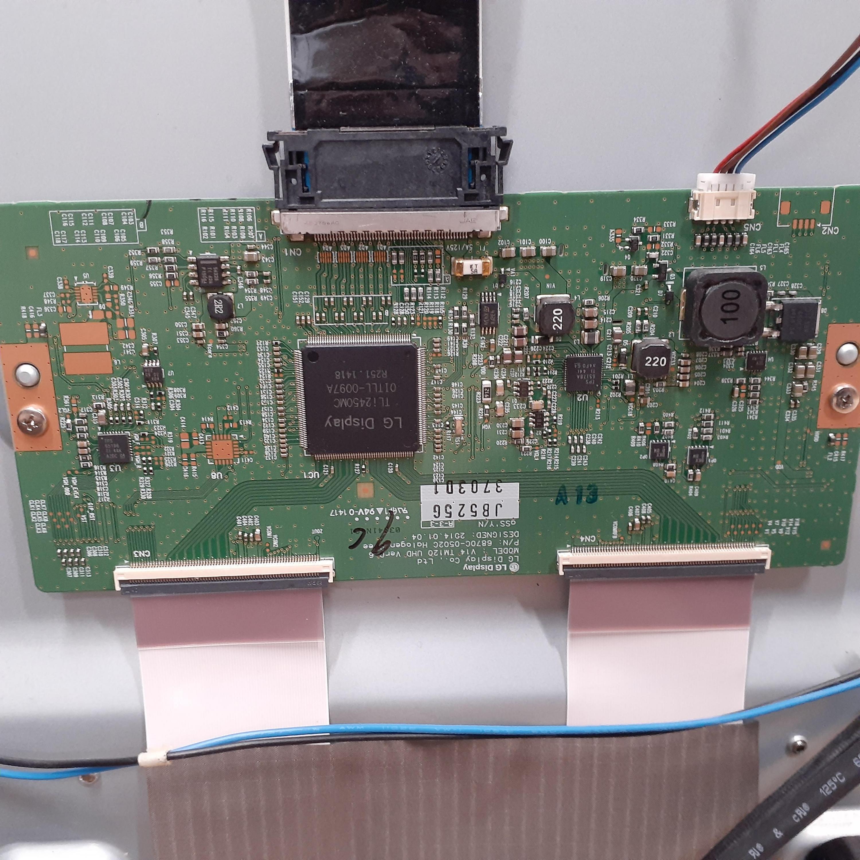

    Hi, I have problem with this LG model 55UB8500, it have no picture,I check voltage in Power Supply , all the voltages 24 volts 12 volts, 3.5 volts are there, when I push power ON, it have Red led on main board it stays red no blinking, on the power supply board when I put Power ON on connector P 802 LED + it have 48 volts on connector P 802 Led+ 48 volts, could you tell me what I have to check now?

                                  one of those, hey guys look into your magic 8 ball and tell me what's wrong with my tv. This is tv troubleshooting, tests need to be done promptly, as instructed and pictures can speed it up IMMENSELY, if I get a fighter I lose interest very quickly.
                                  • Fripacks
                                    • Jun 2021
                                    • 59
                                    Re: LG 55UB8500 no picture.
                                    That's photo of TCON , I don't have schematic of the tv

                                        Why are you giving picture of t-con? You said you have no voltage going to t-con. Thus you need to look on main board and find where you are losing the 12v.
