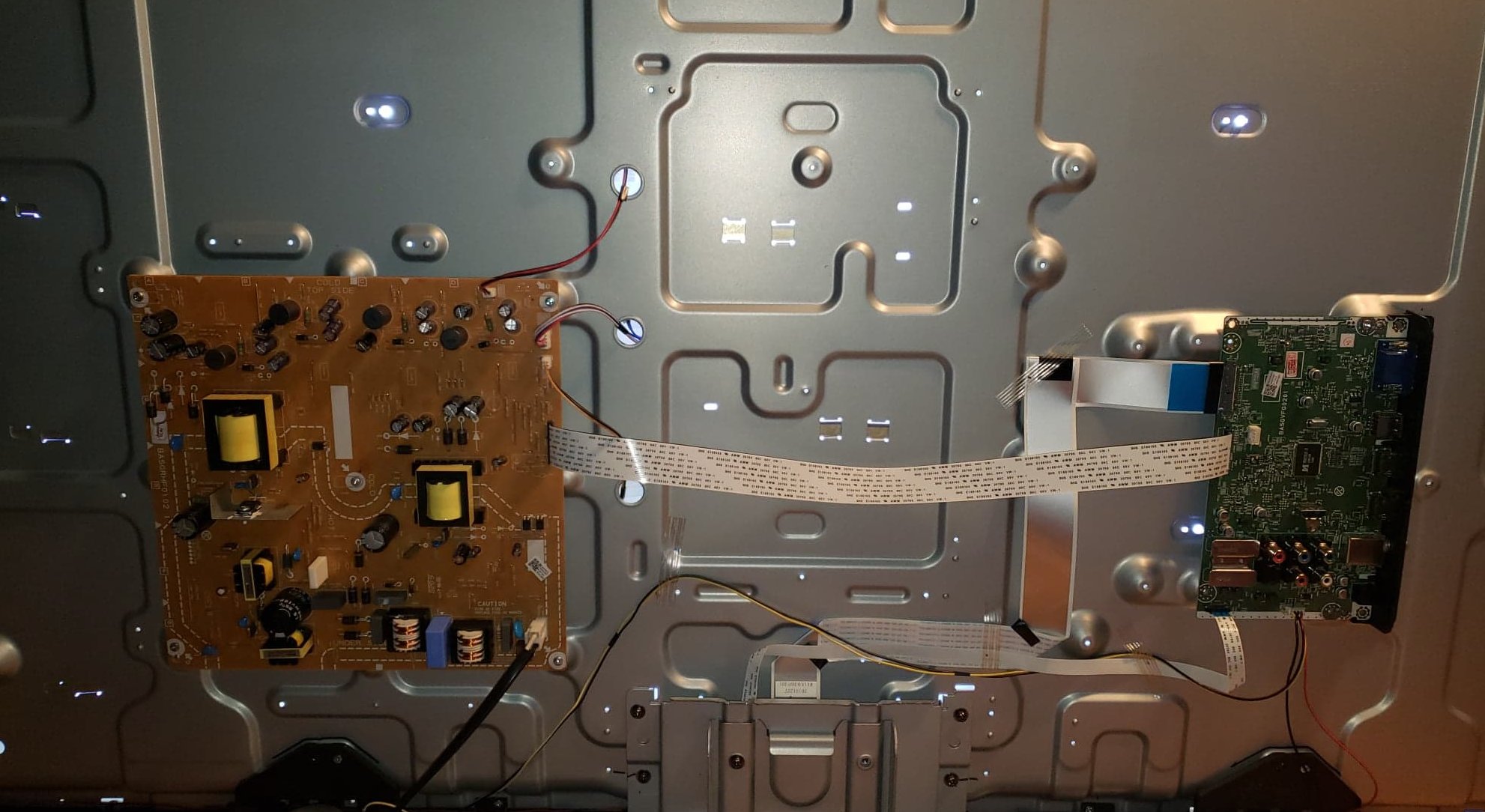

    I have Sanyo 55" TV that randomly shuts off..
    Sometimes it will stay on for 5mins or so, sometimes it shuts off after a min or two...
    When it DOES stay on, it works fine...
    All things being equal, would it be more likely a POWER Board issue or a MAIN Board issue???
    Thanx in advance...

    Re: FUNAI/SANYO FW55D25F Shuts Down Randomly
    Flips coin. Backlights. Not much to go on here.
      maybe check all the solder joints on powerboard, inspect cable from powerboard to mainboard for burn marks or a bad wire, see if wiggling makes a difference, could be an iffy cap on powerboard.
          Is the backlight shutting off or the TV? What happens when you turn down the backlight level?
            Thanx for all the replies...
            I have been out of the game for a while.. A bad LED strip did not occur to me.. Thanx..
            The whole TV shuts down.. Not just a backlight shutdown..
            If it's an LED Array replacement, I can just forget about it.. I don't have the time nor the space to tackle one of those... And they ain't fun to begin with...
            I am thinking a Power PCB replacement is going to be my best bet...
              Update...
              Got a replacement PSU board..
              Now it only comes on for a second or two and then shuts down..
              Assuming the part I got was good, it's now looking like an LED STRIP problem..
              Sound about right??
