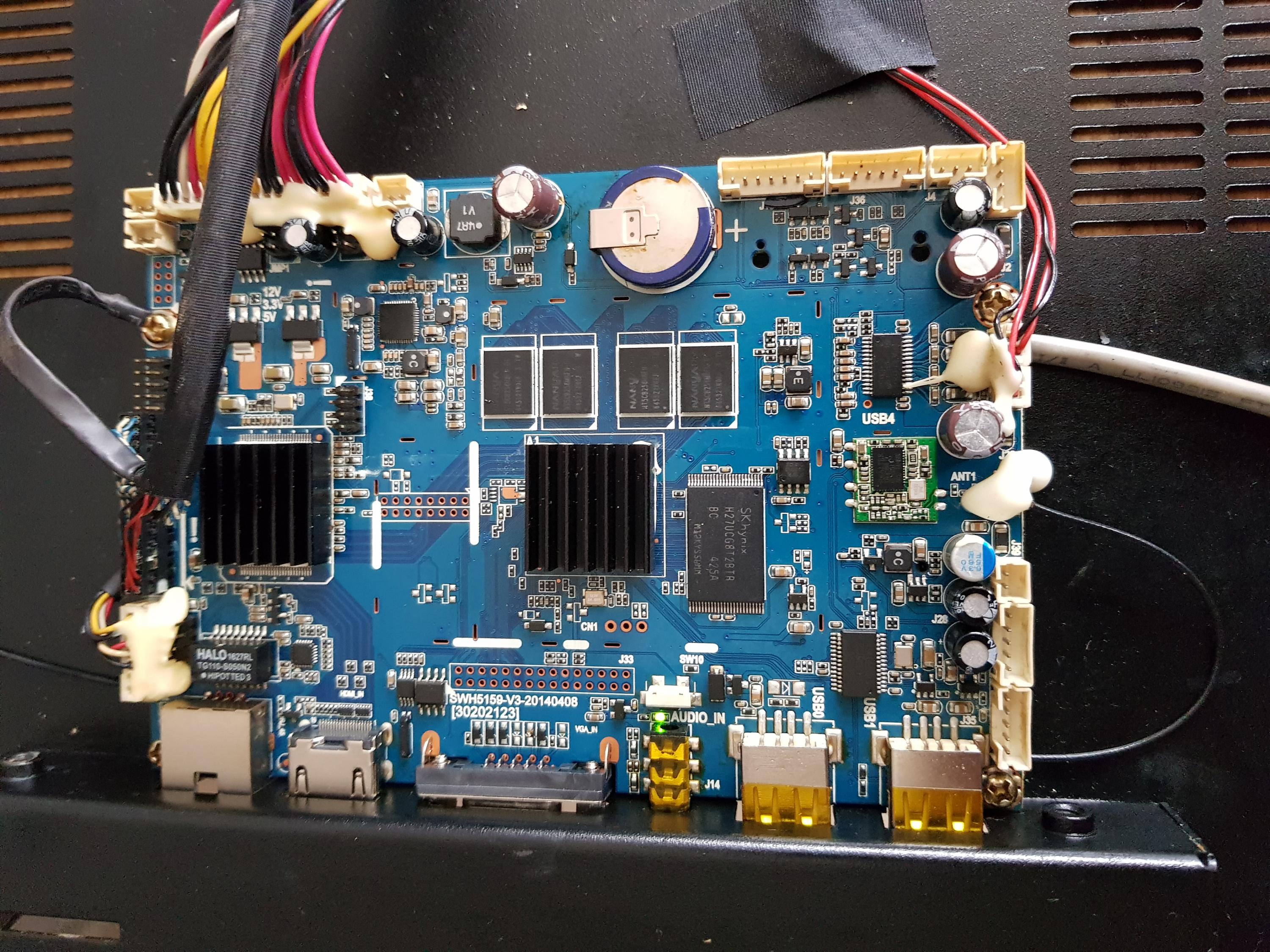

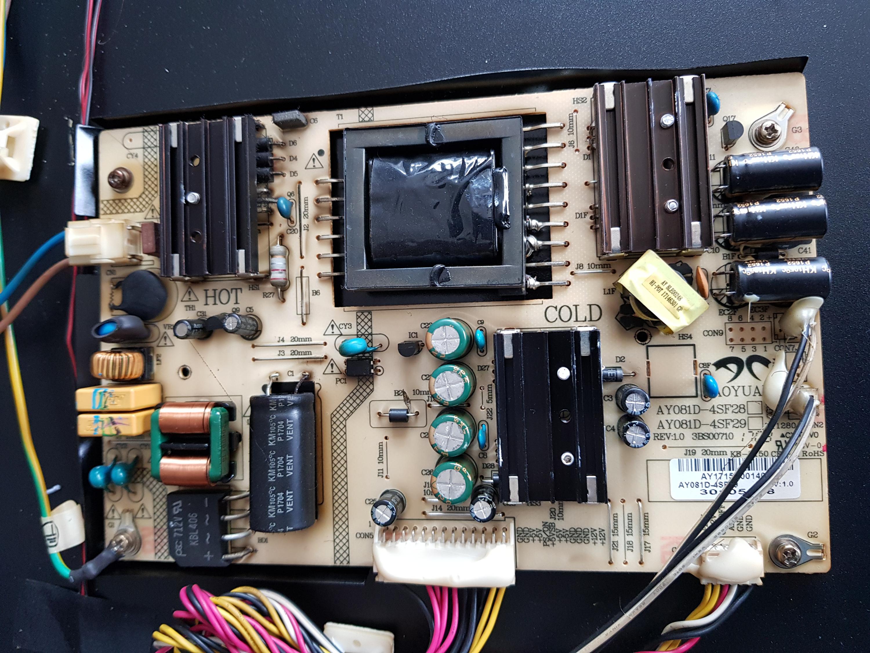

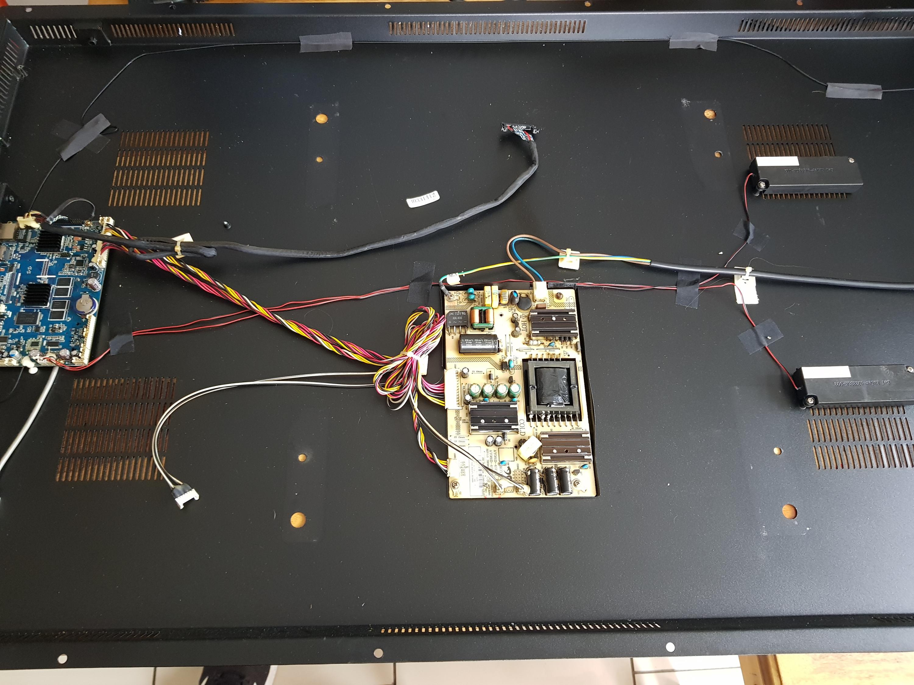

    Hi
    This is a tv monitor which has no standby
    Fuses look also good so I need a bit of help please
    Voltages
    Con5
    Gnd
    Gnd
    +5v =5.0v
    +5v =5.0v
    Ps/on =4.1v
    +5vsb = 5.0v
    +5v =5.0v
    +5v =5.0v
    Gnd
    Gnd
    Gnd
    +12v =13.3v
    +12v =13.3v
    Con3
    +12v =13.3v
    +12v =13.3v
    On/off =0.00v
    Adj=5.0v
    Led backlight voltage
    +76.1v -0.00
    +76.1v -0.00
    Main cap is 323v

    Re: PF43hd6 no standby
    No standby or no backlights?
    • sordids999
      • May 2013
      • 2149
      • uk
      Sorry no standby light or backlights
      TV just seems totally dead
        If I jump ps/on and 5v I get voltages
        +12v go to 11.8v
        Ps/on goes to 4.8v
          So mainboard not sending signal to turn on.
              Have you checked mainboard voltages? Try heating up your processor to see if TV will turn on?
