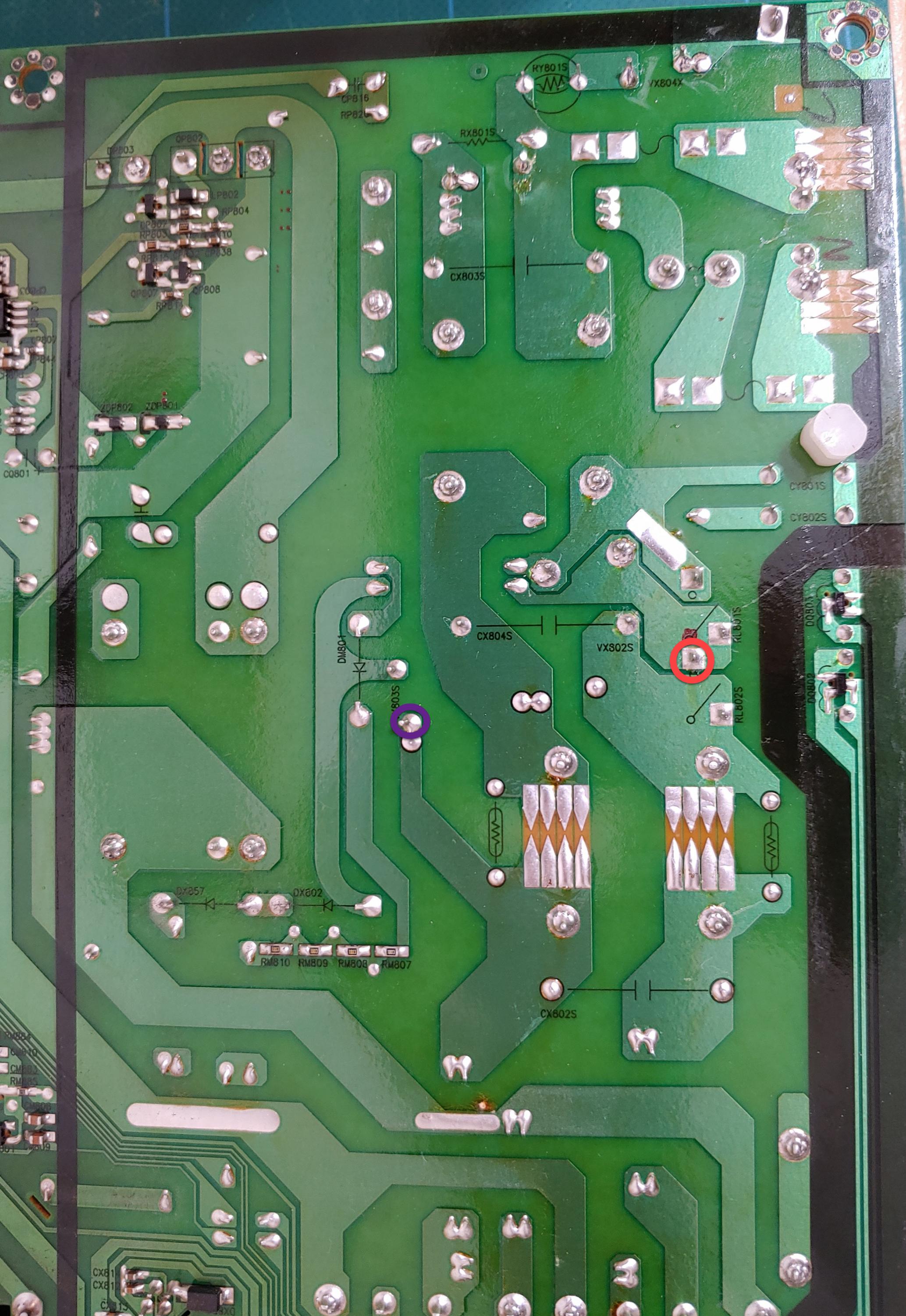

    I was given this TV because it wouldn't power up. Tested for standby voltage and confirmed nothing was there. The fuse was on the load side was dead, so I replaced it with another 10A 250V slow blow fuse. Plugged in the TV and then the neutral fuse blew. Me being an idiot though, well maybe the fuses were just old and bad. Replaced it and plugged in again, and this time they both blew.
    So then I watched this video and started testing continuity along the primary side of the power supply https://www.youtube.com/watch?v=cWN71R8R94E

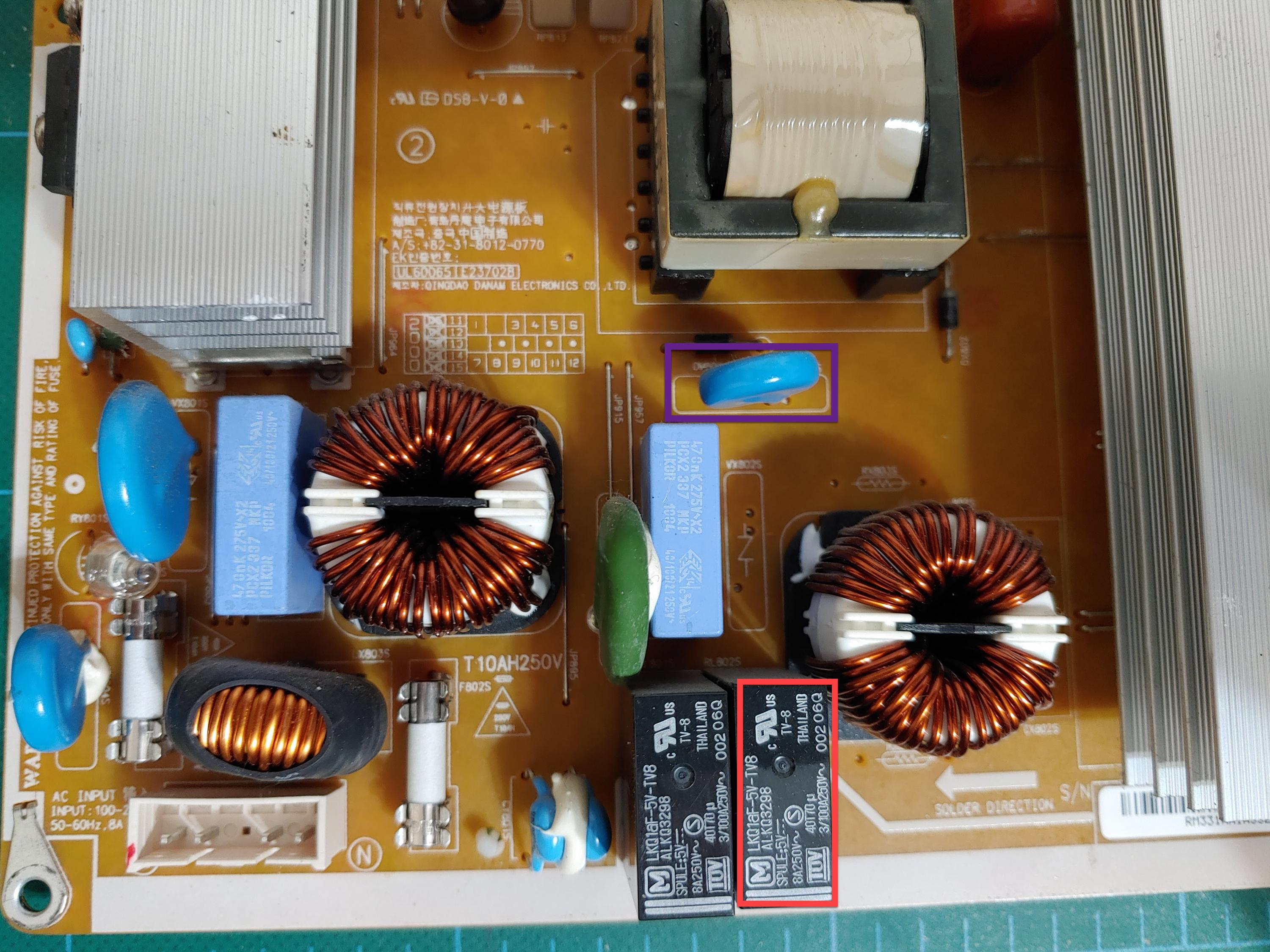

    On the load side I make it all the way to the second lkq1af-5v-tv8 power relay and then I don't get continuity any further. (Red square on the front red circle on the back picture)
    On the neutral side I make it all the way to what I think is an MOV before I no longer have continuity from the neutral side of the plug. I believe this is to be expected and using the other side of the MOV I am able to test forward. Is that right? (Purple square on the front and purple circle on the back picture)
    Is my problem the lkq1af-5v-tv8 and can I just replace it, or is that likely more a symptom, and I'll need to replace it and keep testing? Or am I way off entirely?

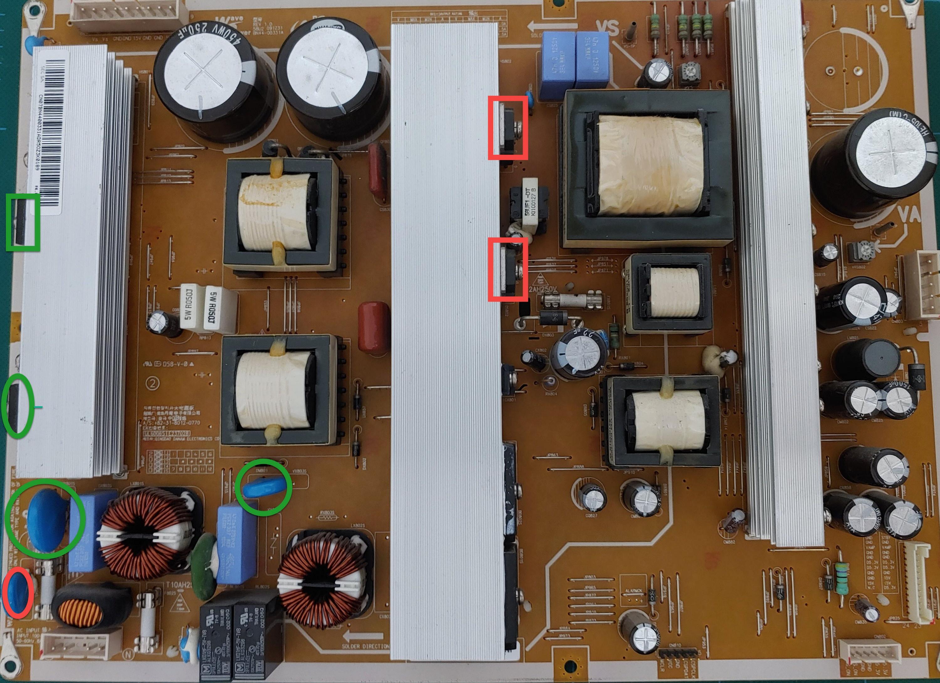

            Sorry for the delay R_J. The two mosfets QS802 and QS804 part FQA 24N50 are both definitely bad. The other two QP802 and QP804 part 20N60C3 are okay.
            It looks like there are actually 3 MOVs on this board. VX801S and VX803S both measure 2M ohms. However VX804S I got nothing out of, so I take it that's dead too.
            Attached picture has the working parts in green and the dead parts in red for visual reference.

                What do you mean "However VX804S I got nothing out of" what where you expecting to get out of it? If the are not shorted or cracked, they are very likely good and your problem is with the mosfets and possibly there gate drive circuits. Check the two resistors and one diode in the gate circuits of both mosfets, Each gate is driven by a drive transformer so the drive ic should be ok.
                when checking these two you are measuring other components in the circuit, not so with vx804s

                  Hey thanks for getting back to me so quickly. I saw online a quick test for MOVs is to see if they have a high resistance. The other two did give me a high resistance, but I got 0L when I tried to measure VX804S. Visually it looks okay.

                        Additional context for anyone that finds this later, the relay lkq1af-5v-tv8 wasn't actually shorted. I was just being an idiot and didn't test it out of circuit when it seemed broken. Once I did that I realized it was fine.
                        The MOV VX804S was also not physically damaged, but because I got no resistance reading out of it I thought it was bad and ordered a replacement. The replacement gave me the same result. I've since learned that's not a valid way to test an MOV and that they are almost impossible to fail without visibly being damaged like R_J pointed out.
