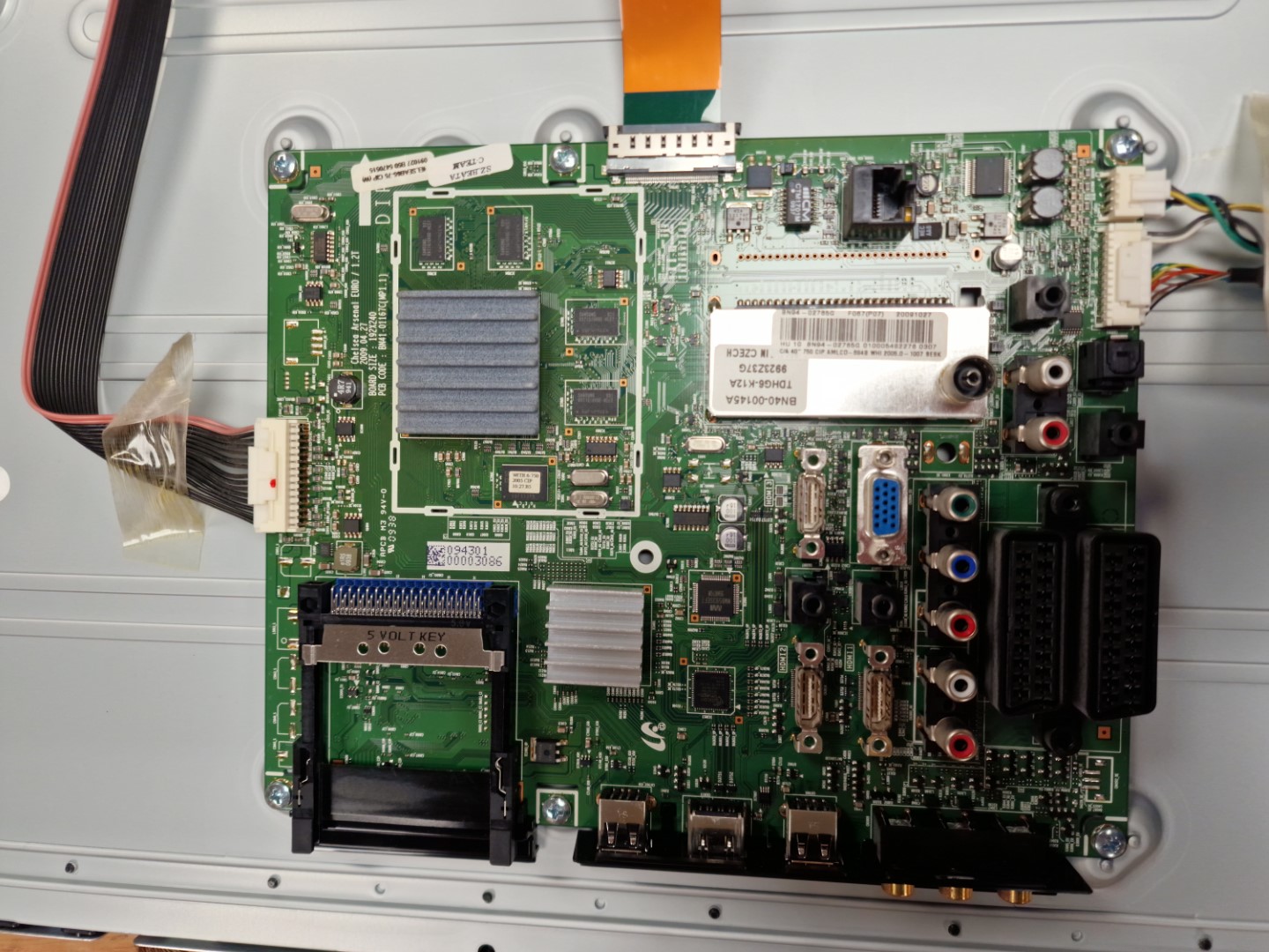

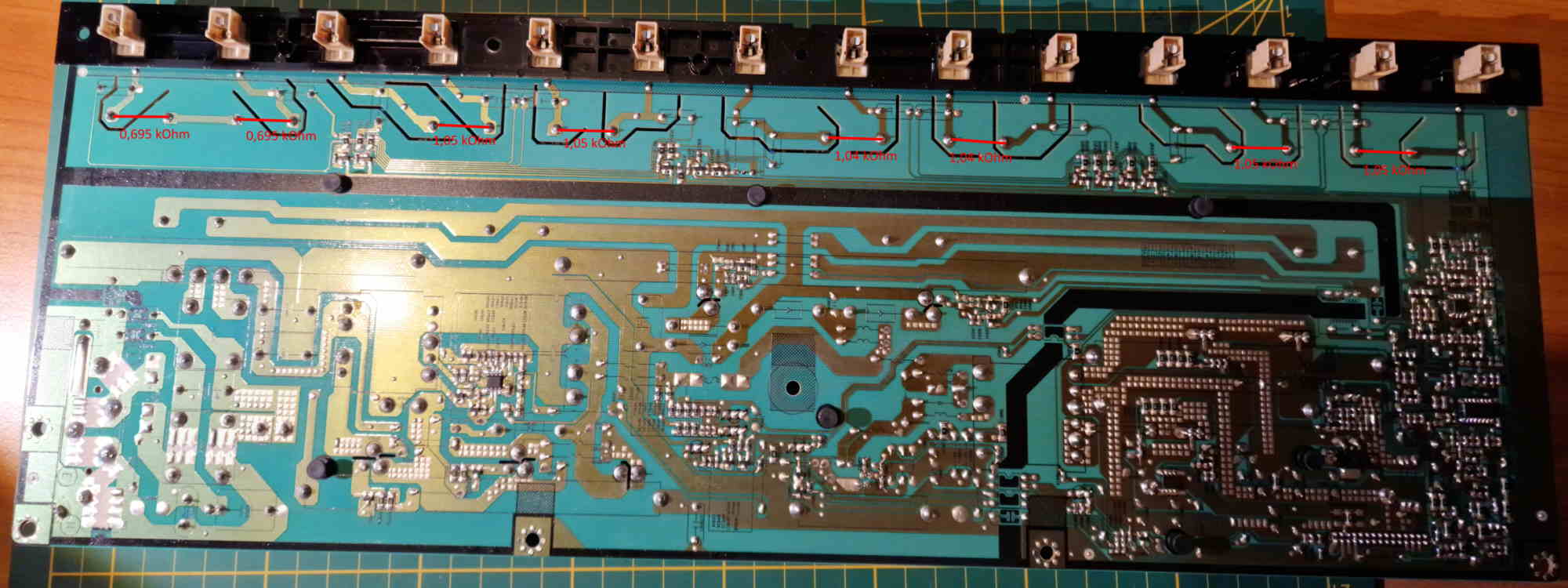

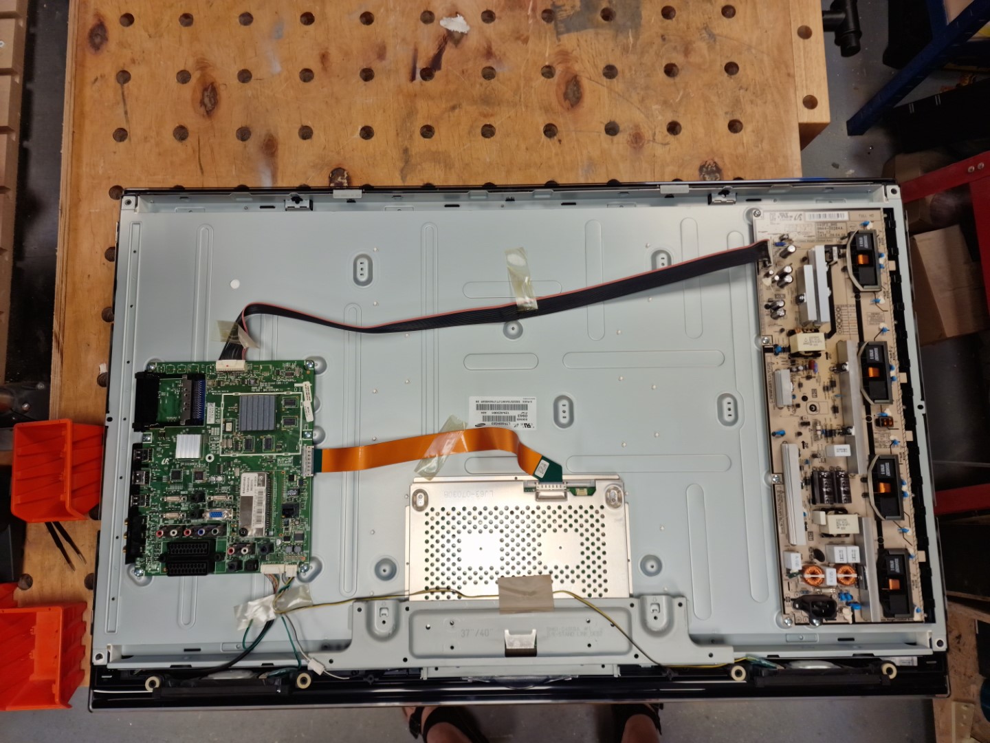

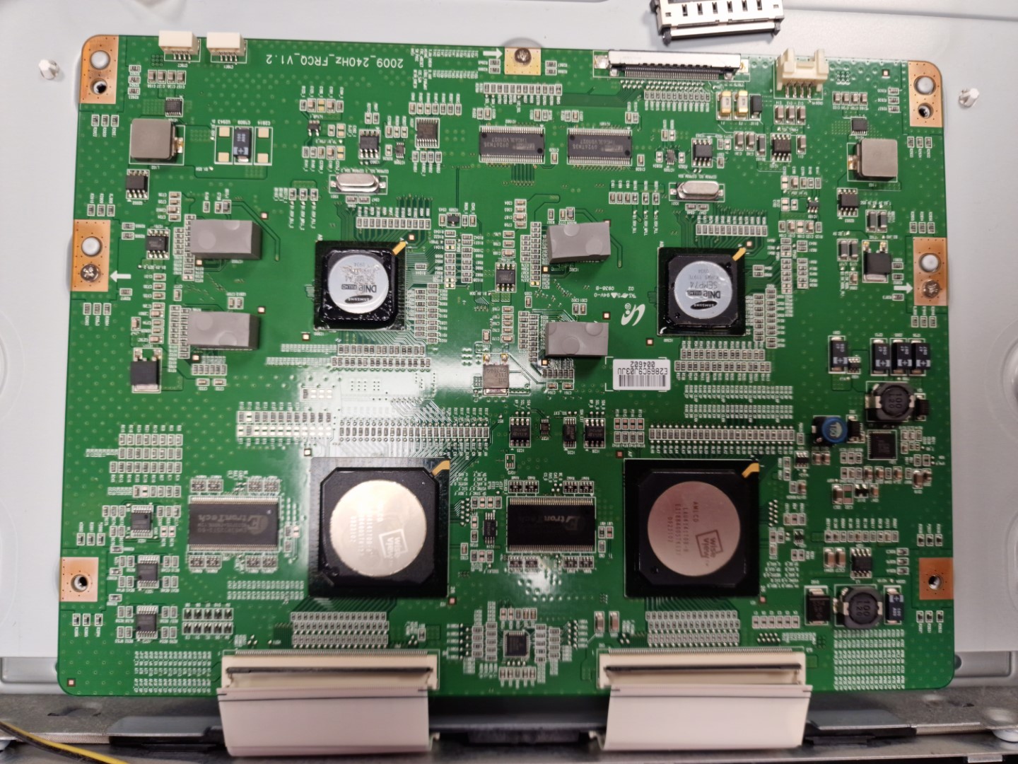

    Hello dear Badcaps gurus,
    I was hoping someone could help me on my fault finding missing.
    I saved an old, "broken" TV that my parents wanted to throw out from the recycler as I´m a strong believer in fixing stuff instead of throwing it out.
    The patient is a Samsung LE40B750.
    The symptom is "screen going dark after a while". The sound is still fine when it occurs.
    Its not the signal source. First tests show its the backlight that dies. If I use a strong flashlight I can see the picture.
    The time till it turns dark is not constant. It seems to be temperature related. If the TV was off for a while it might run normally for a couple of hours. If it has been on/connected to power for some time it might go dark after a couple of seconds.
    Turning it off and on, without disconnecting the power cable, will solve the issue for a few seconds before it reoccurs.
    Visual inspection of all boards didn´t reveal any blown capacitors, burned spots, or anything else that, at least with my limited knowledge, would look obviously broken.
    I did some research in the forum first of course and apparently some similar issues with this model where fixed by cutting JP852.
    I cant seem to find it on my powerboard however. My powerboard is a H40F2_9HS BN44-00284A in Rev 1.2 so I assume this fix was probably for a different revision.
    I attached pictures of the boards. Maybe someone has a good idea?
    Many thanks in advance for anyone willing to help.

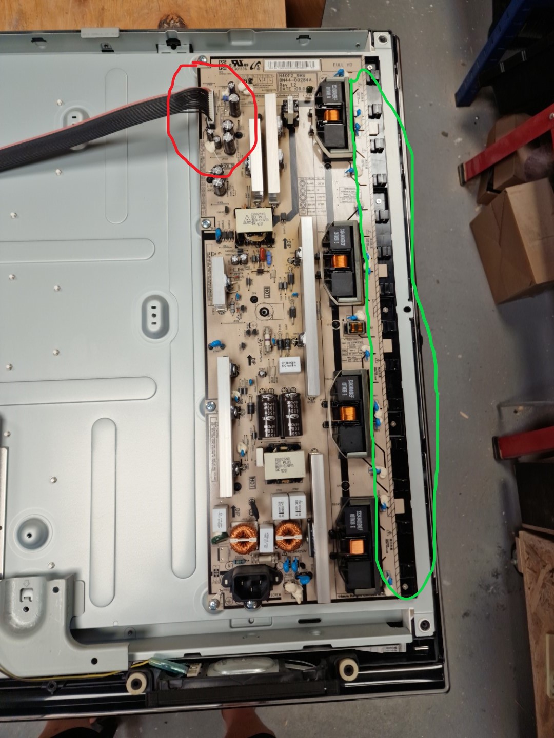

          I couldn´t figure out where the CCFL is getting its power from. Is it through those 2 ribbon cables too?
          • yokoono
            • Apr 2010
            • 486
            Re: Samsung LE40B750 backlight dies after a while
            Red: power / main command
            Green: CCFL power supply.

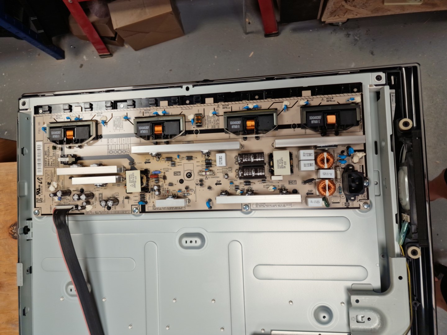

              Check the resistance of the ccfl transormers. Three of them are the same and the bottom one is slightly different windings resistance. Check the high voltage blue caps on the right of the BN44-00264 combined psu and inverter to the right of the ccfl transformers as well (examine them carefully), as apparently they can also fail. Also update the firmware on the main board as well as I have found issues with the LE40B450 that would sporadically reboot during operation and I would imagine the boards look to be very similar.
              • Fusion_de
                • Jun 2022
                • 11
                I removed the power board and did the measurements you suggested. Please see the measurements in my picture.
                The transformers behave as you predicted, I couldn´t find any datasheet or something to suggest if these are the values they should have.
                As to the high voltage caps, not sure on how to test them? My DMM isn´t really reporting anything for these. 0 Ohms and a minuscule capacity measurement on all of them.
                All measurements were done with everything still in circuit. Not sure if this is messing things up or not.

                              oh dear! You may well have broken or damaged the ccfl tubes by removing the combined inverter psu! The unit is removed by removing the mounting screws and then sliding unit to the left about 2cm. It then comes out from the plastic insulators that connect to your ccfl tubes. You have likely damaged the ends of the ccfl tubes.
                              The fact that it is taking longer to go off means that is most likely failure of one or more of the ccfl tubes as a result of lowering brightness. Going out so no time to write now.
