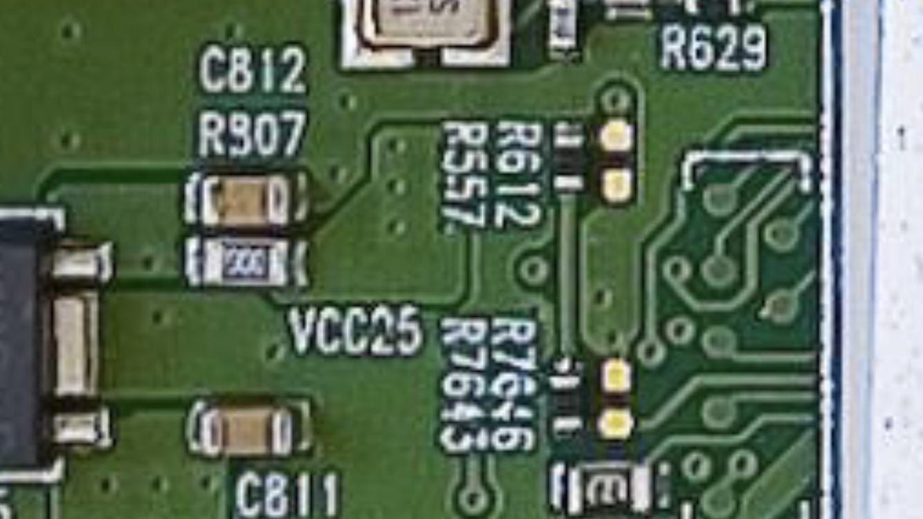

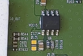

        On the T-con board, check the voltage at the control points designated V15/ V25, etc.

          You need to check t-con voltages and data lines. But I would suggest getting a new t-con.

                        Dont play any more with ribbons... you will damage them. take out the white heat sink of the MB Soc. and tell which type MT or MS.. also you have several Fuse on MB which are with F marked.. need to check them all with yours DMM, also remove the WIFI usb from MB and do hard reset again..

                          I am pretty sure it's T-Con.
