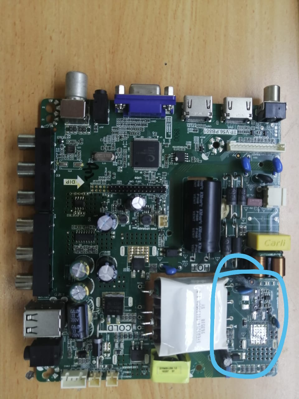

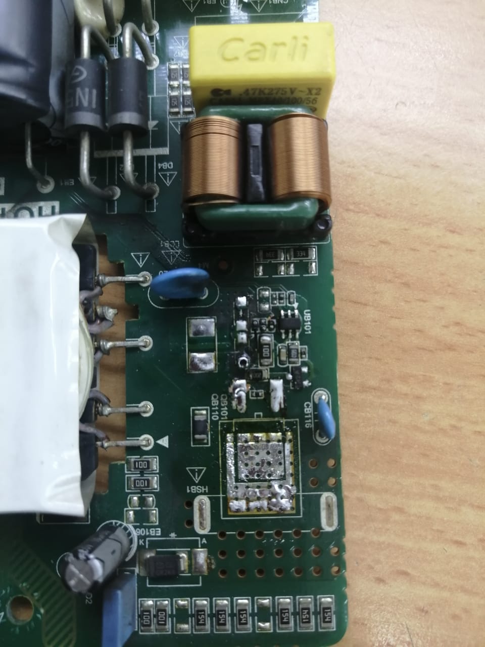

    hello please if any one have like this board please send me missing parts details and values to repair my board , since some one try to repair and didn't solder back damaged parts.
    thx.

    Re: Tp.v56.pb801
    how about a good picture of the whole board and some of where the missing parts are suppose to be.

      Re: Tp.v56.pb801
      below you can find whole pcb picture with missing and burnt parts marked

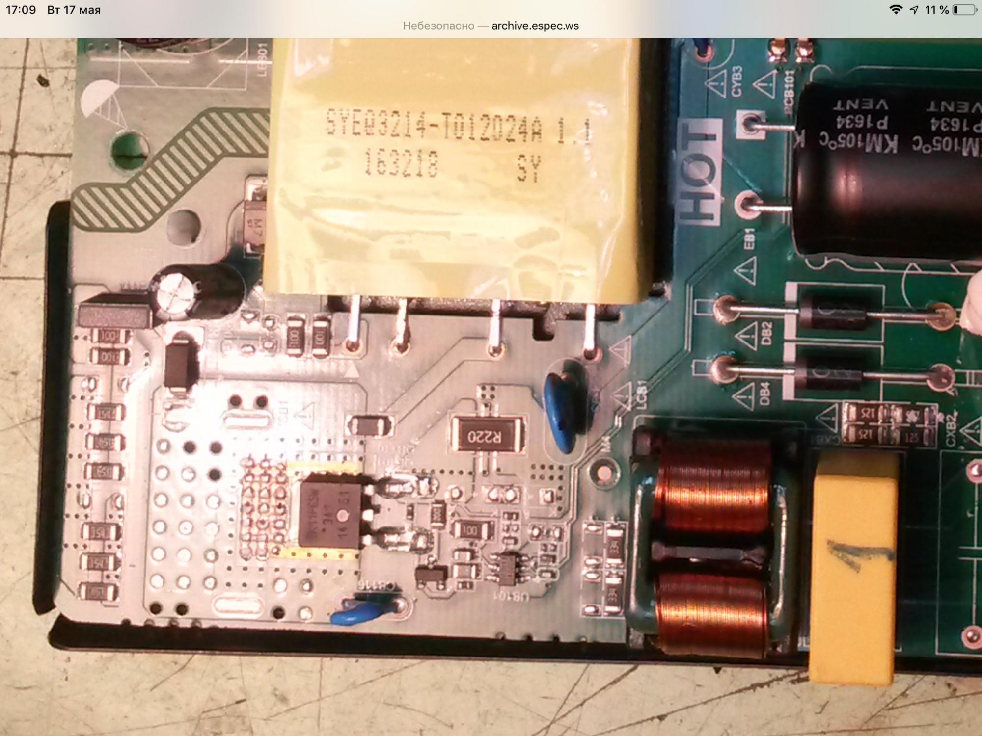

        Re: Tp.v56.pb801
        https://www.aliexpress.com/item/3256...apt=4itemAdapt

            Re: Tp.v56.pb801
            I think Dskall has the best solution there.

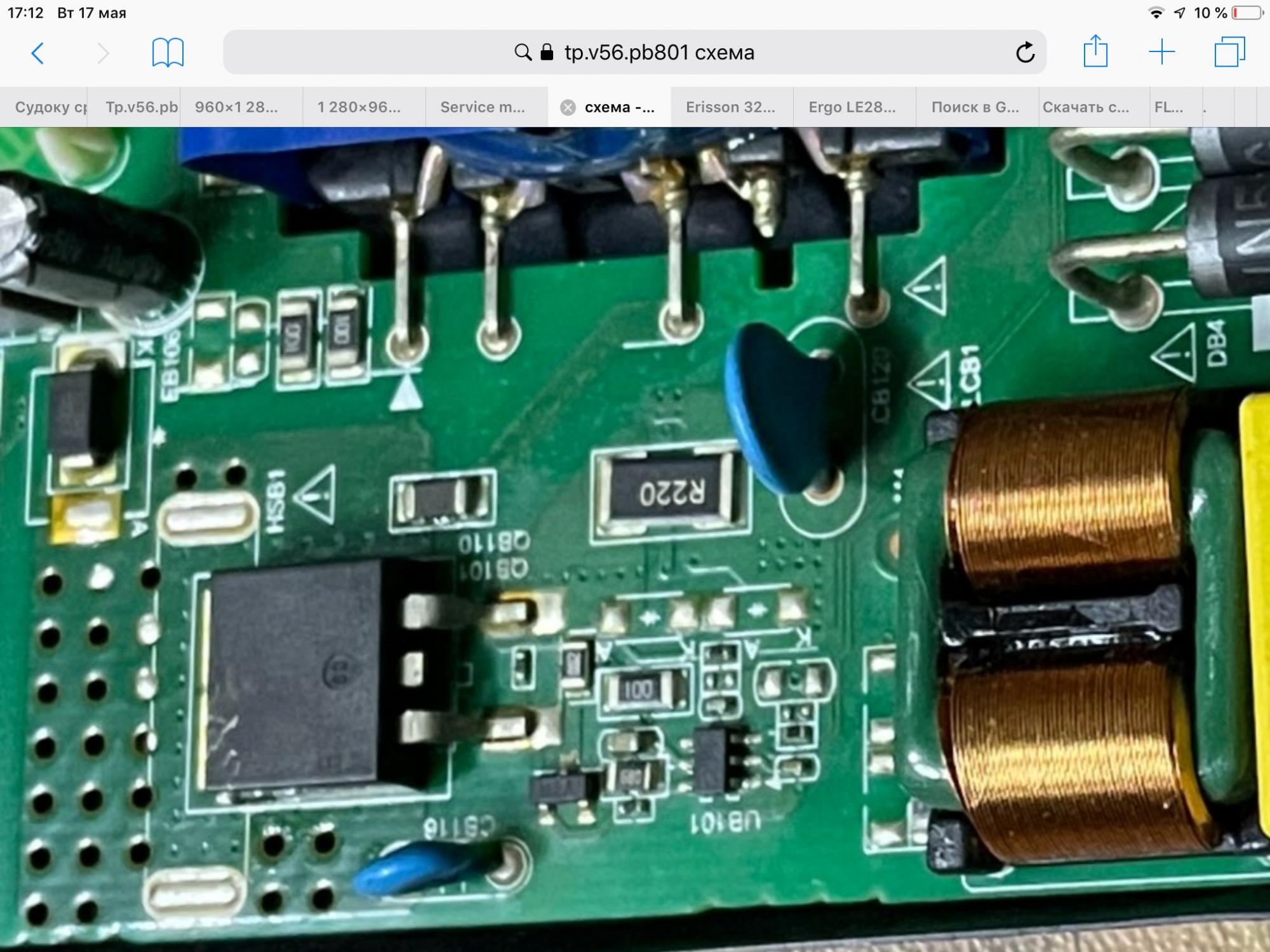

              Re: Tp.v56.pb801
              MOSFET- TK11P65W or TK14G65W
              Sot23-6 - OB2273?

                Re: Tp.v56.pb801
                Sot23-6 - OB2273?
                thank you dear , power problem solved som how but know have another problem it power one for 1 second give logo then goes black screen but ligt still green

                  Re: Tp.v56.pb801
                  FULL model number of tv?

                    Re: Tp.v56.pb801
                    Check if the backlight may be faulty
