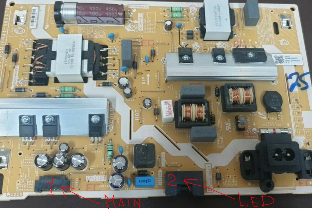

samsung tv ue43ru7400u dark screen problem help

    READ READ post #18 DO TEST.

      Re: samsung tv ue43ru7400u dark screen problem help
      Hi this a edge lit Tv can i still do that test in #18 thanks for your help
        Yes.
          easy test, make sure the tv is unplugged from power, unhook cable from powerboard to mainboard, plug power cord into powerboard, plug into outlet,
          see if backlights come on and stay on, always make cable connections with tv unplugged from power to avoid and errant surges that could happen.
            ok thanks i wiil give it a go
              Hi there is only one power lead coming from the powerboard and its going to the mainboard so when i disconnect the lead there is no power going to anythink
                Why only one, you have two cables connected 1 - main, 2 - led.
                  If that doesn't work, you can monitor led voltage. If voltage is stable, then it's probably not backlights.

                    #29
                    it's cnm801 connector, unhook the cable at that connector to try that test.

                      #30
                      the power comes from the power cord that you plug back into the powerboard.
