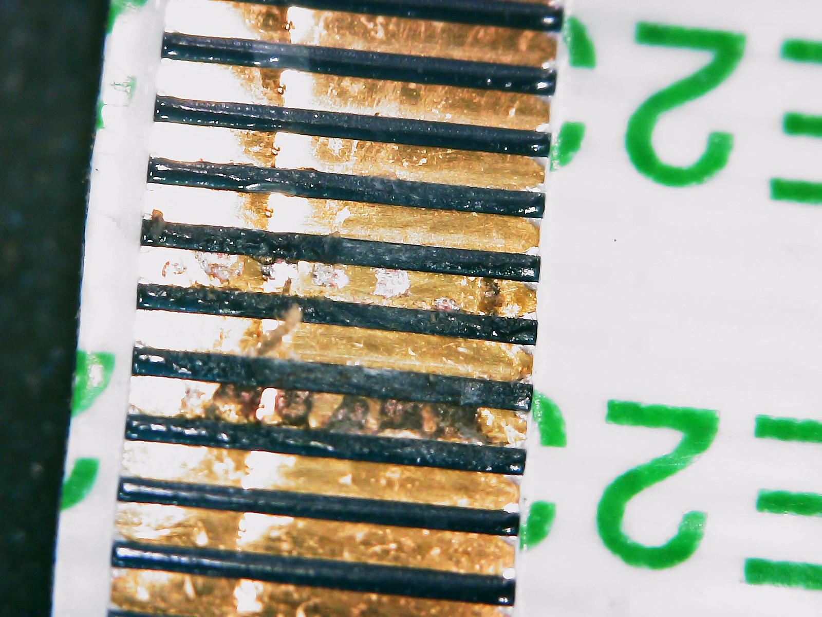

    Originally posted by mrsith View Post
    Closeups attached, does it look like it? I'm afraid I know the answer but...is that it with this panel then? No chances and no point to waste more time?
    this is not the first time i saw.. for me always when the issue related to image bezel out and check screen rand.
    your photos cant bring to us any further idea.. but your eyes and your fanatsy could help.. the most importand the Golden thin film the 2 lines vcc and gnd should connected if there are some where broken.

          Close inspection of the ribbon connectors - they look absolutely fine, seems like every pin is soldered solid.

                      Not sure if I understand you well but when looking for shorts, I did disconnect the panel from T-Con. I'll give it a try with different TCon then, but my hope to fix this set went down to almost 0 now.

                                    This burn happened on 6703. I only.checked the Tcon on 6162 and went back to assembling 6703. The moment I realised what happened I didn't plug the ribbon back in, in fact I didn't turn the TV back on at all. Cleared the ribbon with IPA and carefully scratched burnt marks from the pin.
                                    I'm guessi g something on 6162 is causing Tcon(s) to short, questions are:
                                    a) what exactly failed on 6703 (seems like the burnt pin is VGH_EVEN),
                                    b) is this only Tcon that failed, or did the damsge go further
                                    c) will the set be alive again with new Tcon installed or upon finding and fixing issue with this one?

                                      good guestiones.. tell first this burn at ribbon which side of the panel the defect one ( gray ) or the white one.. also from which side did this burn on T-con socket or panel socket?
                                        #59
                                        Re: Philips 55PUS6262 no picture
                                        It burned on the panel side, T-con side looks okay. When it happened I had the good side connected, the burnt side is the side that's whitish/greyish when connected alone.

                                          so 6162 panel make short to this issue and possible damaged 6703 t-con.
                                          you need to start with 6162 panel buffer boards.... 6703 t-con and the other need to take one on the table and start with R check and fets on it if you find the fault you can find the same or close to 6162 t-con.
                                          6162 never turn it on unless you are sure 100% all panel buffer boards parts are fine.. you can use external supply to simulated VGH VCC etc.
                                          edit: it could be the ribbon burned from start and you didn't noticed..
