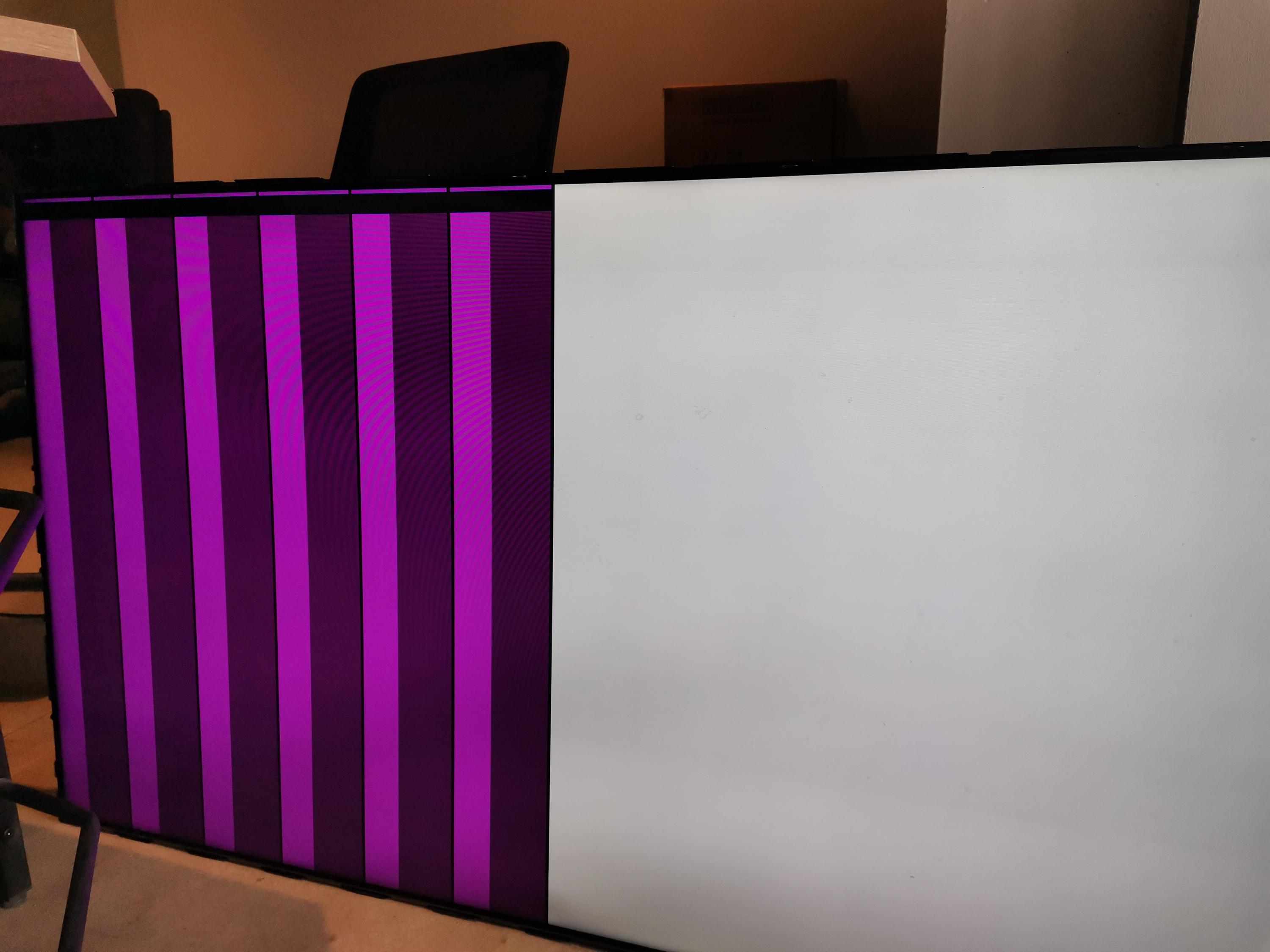

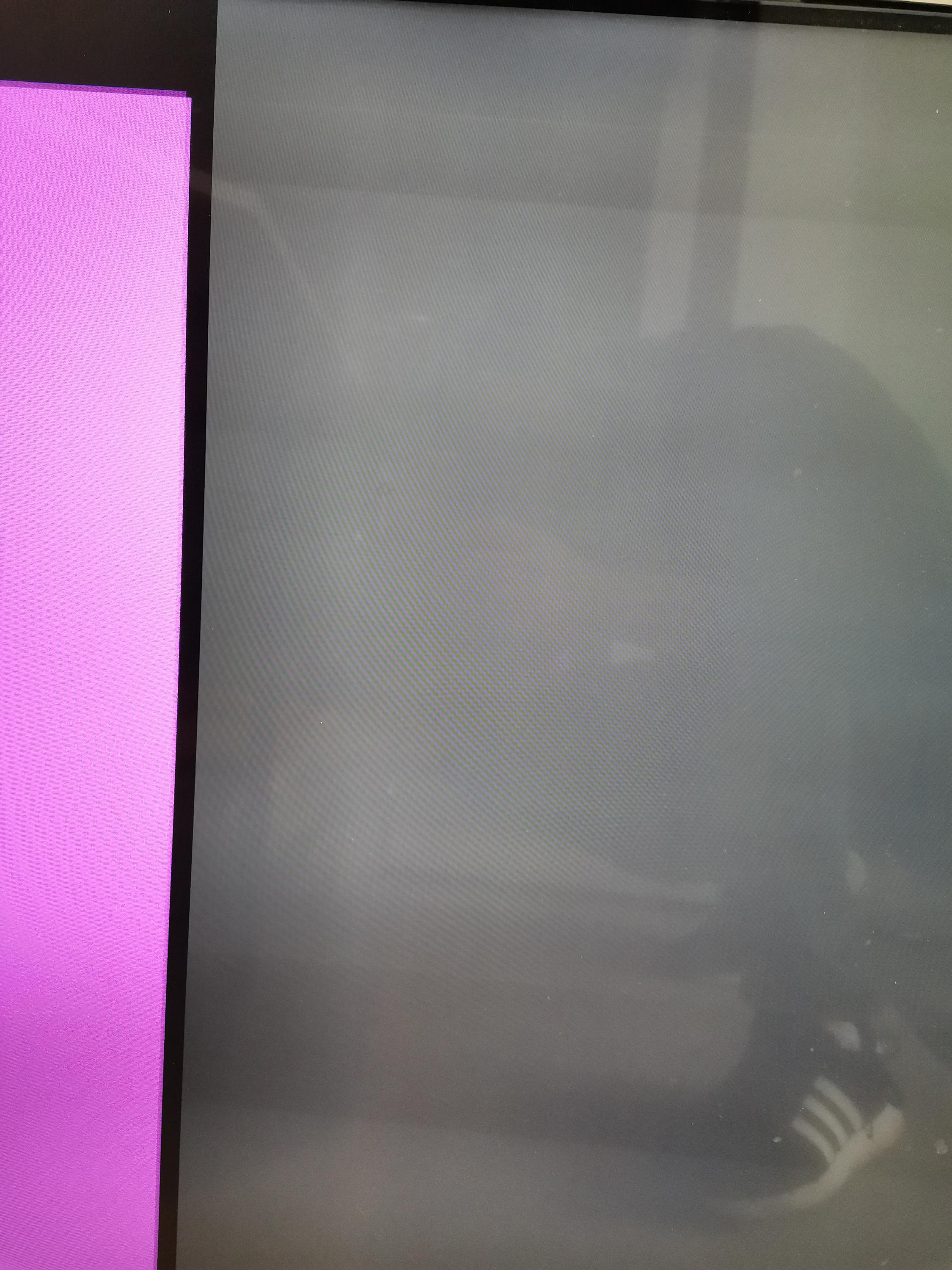

                          The ribbon cables were suspected at the beginning and replaced with T-Con. Tried downgrading, flashing went succesfullu but didn't help.
                          At the moment there isn't much to show. Both LVDS connected = no picture, left disconnected - left side white, right side completely black, right disconnected - right side white, left side shows normal picture.
                          As stated in previous posts, I am getting purplish/pinkish artifacts, sometimes with picture disappearing, with just good side connected. Rhe artifacts react to me pressing down the middle of LVDS connector, panel side. They seem to react on pressing the T-Con side LVDS connector, but not as much as panel-side. I'll try to post photo of this phenomenon in a minute or two.
                          Becore I replaced the shorted capacitor, powering the TV with only bad side connected gave no picture at all, now the disconnected part is white.
                          EDIT: photos posted. After playing a while with the TCon side connector - to get the half picture OK for a photo - I have noticed that the previously white part of the screen started to slowly fade to grey, then to black, with some.darker areas on it. Also some of the artifacts seemed to slightly affect the disconnected area as well.

                              I did check the panel carefully and haven't noticed any cracks, chips or other damage. Just some stains cleaned up with IPA.
                              There are only 2 panel boards. If I press on the tape in the middle, there is no effect, just pressing the LVDS connector makes the picture ok. No idea how it got stabilised earlier.
                              Originally (as far as I can remember from ad pics) this TV had half of the screen whitish with some artifacts on the other side. Went from this to no picture literally before my eyes when seller turned it on for me.
                              I'll ask this question again: is it anyhow possible that the original, fixed already short fried something on both old and new t-con boards? I mean is there any point in getting another one to test?

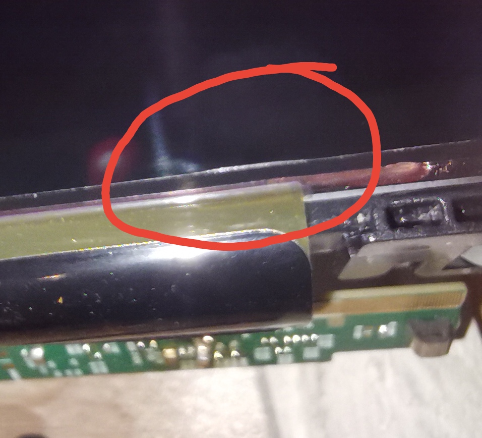

                                    What places I meant I pressed - marked with X, red X is THE spot, however if I press on blue x the picture clears as well, it's just more difficult here and requires more force. By pressing the tape in the middle I meant pressing it against chassis or my own finger, not on the connectors, just the tape itself.
                                    I had one more look around the panel, and at the end of the bad side it looks like some kind of laminate isn't 100% perfectly glued? Not easy to explain and even more difficult to capture on picture but I tried.

                                      here are your issue.
                                      1- about bad image on left side.. you need to fix the ribbon cable corectly .. you may need to clean the socket from any rest of perviouse danaged ribbon cable pins contact.
                                      2- thislaminate at the rand on the right side under it you have thin film which had rail vcc + and GND. any cut off of one or both lines at it the display will not produce image when both ribbon connected.. as the T-COn will cut off.

                                        Closeups attached, does it look like it? I'm afraid I know the answer but...is that it with this panel then? No chances and no point to waste more time?
