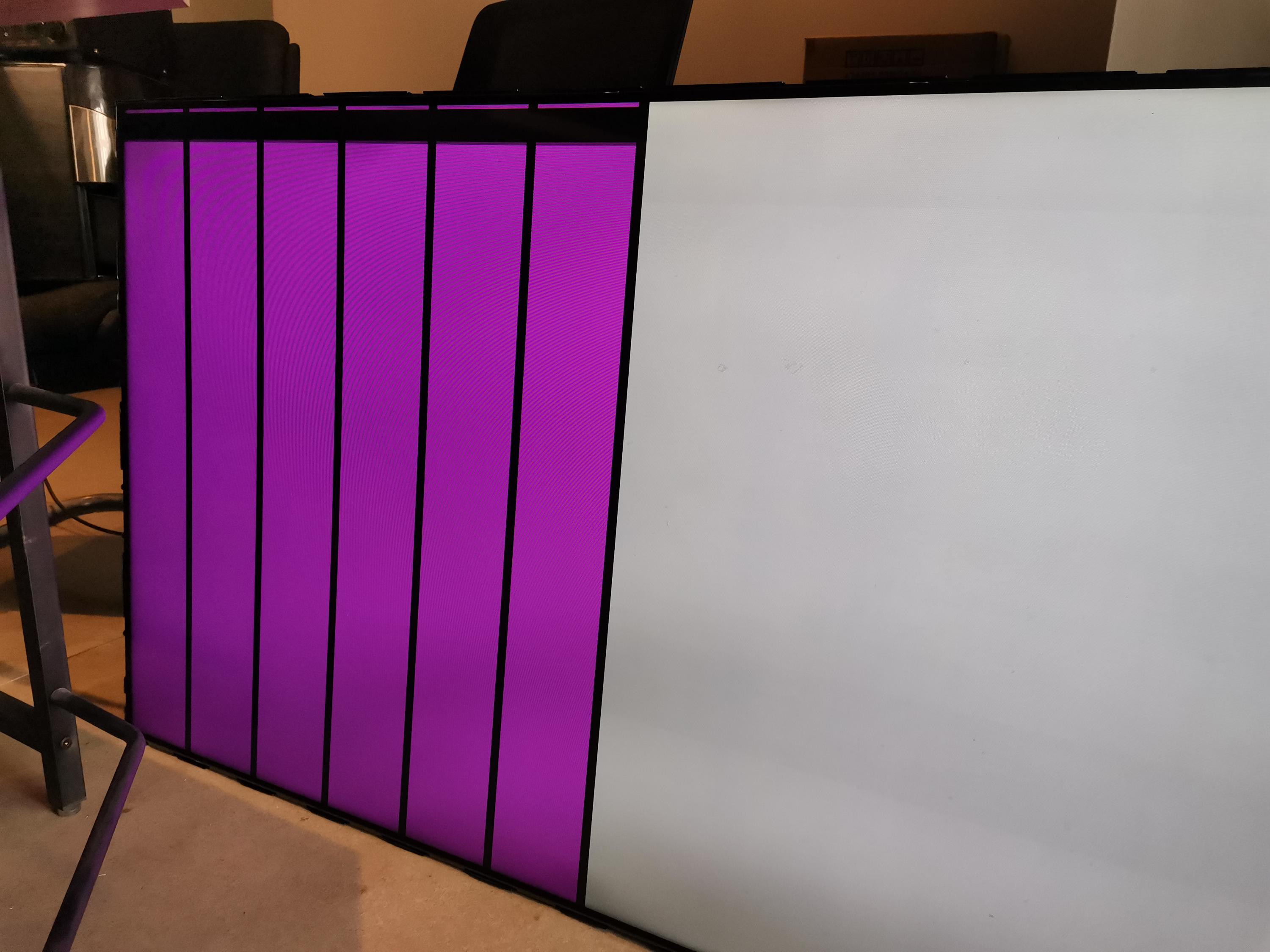

                          At the moment there isn't much to show. Both LVDS connected = no picture, left disconnected - left side white, right side completely black, right disconnected - right side white, left side shows normal picture.
                          As stated in previous posts, I am getting purplish/pinkish artifacts, sometimes with picture disappearing, with just good side connected. Rhe artifacts react to me pressing down the middle of LVDS connector, panel side. They seem to react on pressing the T-Con side LVDS connector, but not as much as panel-side. I'll try to post photo of this phenomenon in a minute or two.
                          Becore I replaced the shorted capacitor, powering the TV with only bad side connected gave no picture at all, now the disconnected part is white.
                          EDIT: photos posted. After playing a while with the TCon side connector - to get the half picture OK for a photo - I have noticed that the previously white part of the screen started to slowly fade to grey, then to black, with some.darker areas on it. Also some of the artifacts seemed to slightly affect the disconnected area as well.

                            take out the bezel of the screen and inspect the rand glass of the panel carefully if there any broken.. also if your Panel buffer boards on each side where of 2 parts and there U ribbon cable connect them , disconnect to see if you get display 3/4 screen
                            BTW if you get back the result as same to this photo.. stop playing with ribboon cable to avoid damage them again

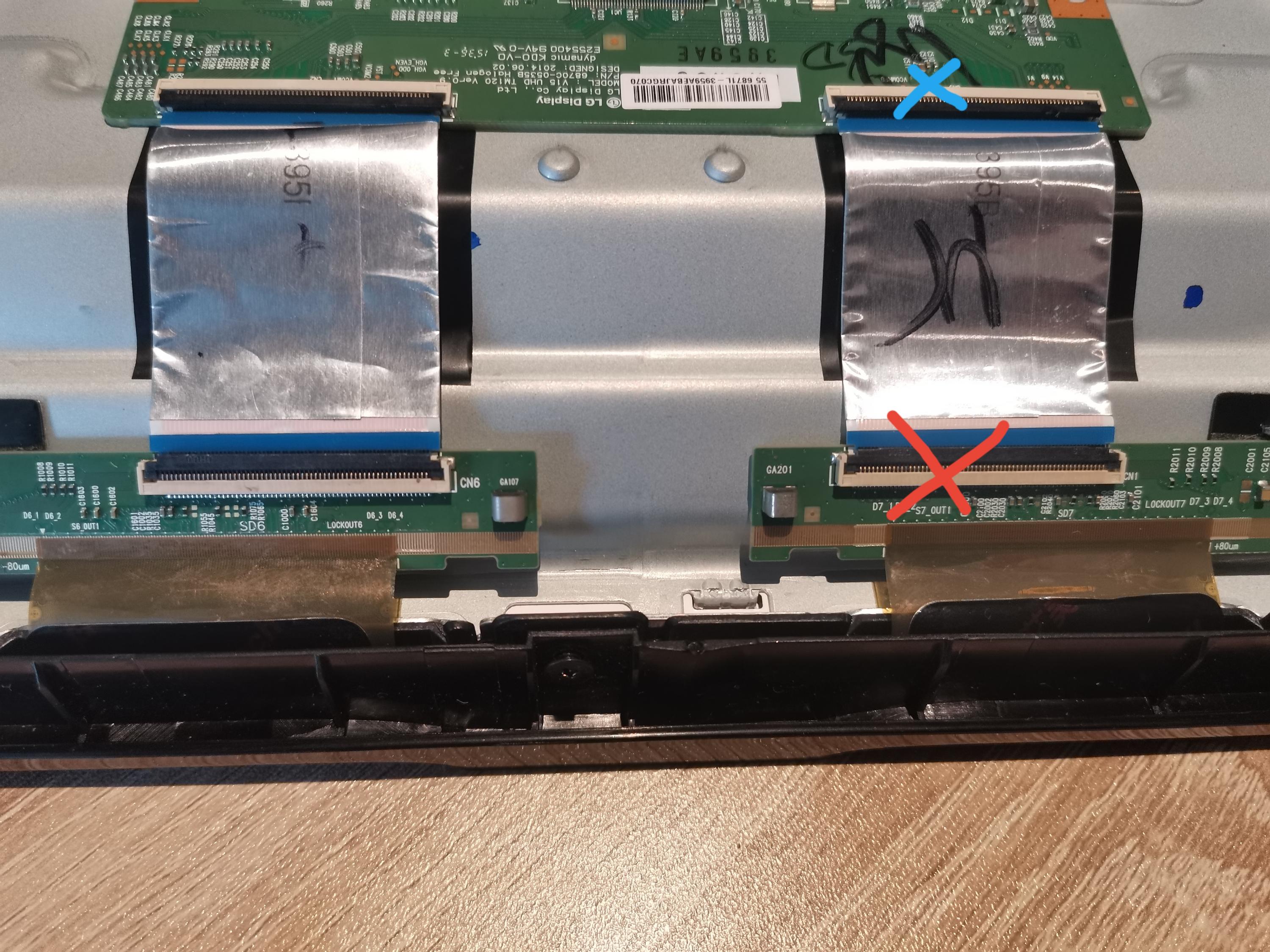

                              There are only 2 panel boards. If I press on the tape in the middle, there is no effect, just pressing the LVDS connector makes the picture ok. No idea how it got stabilised earlier.

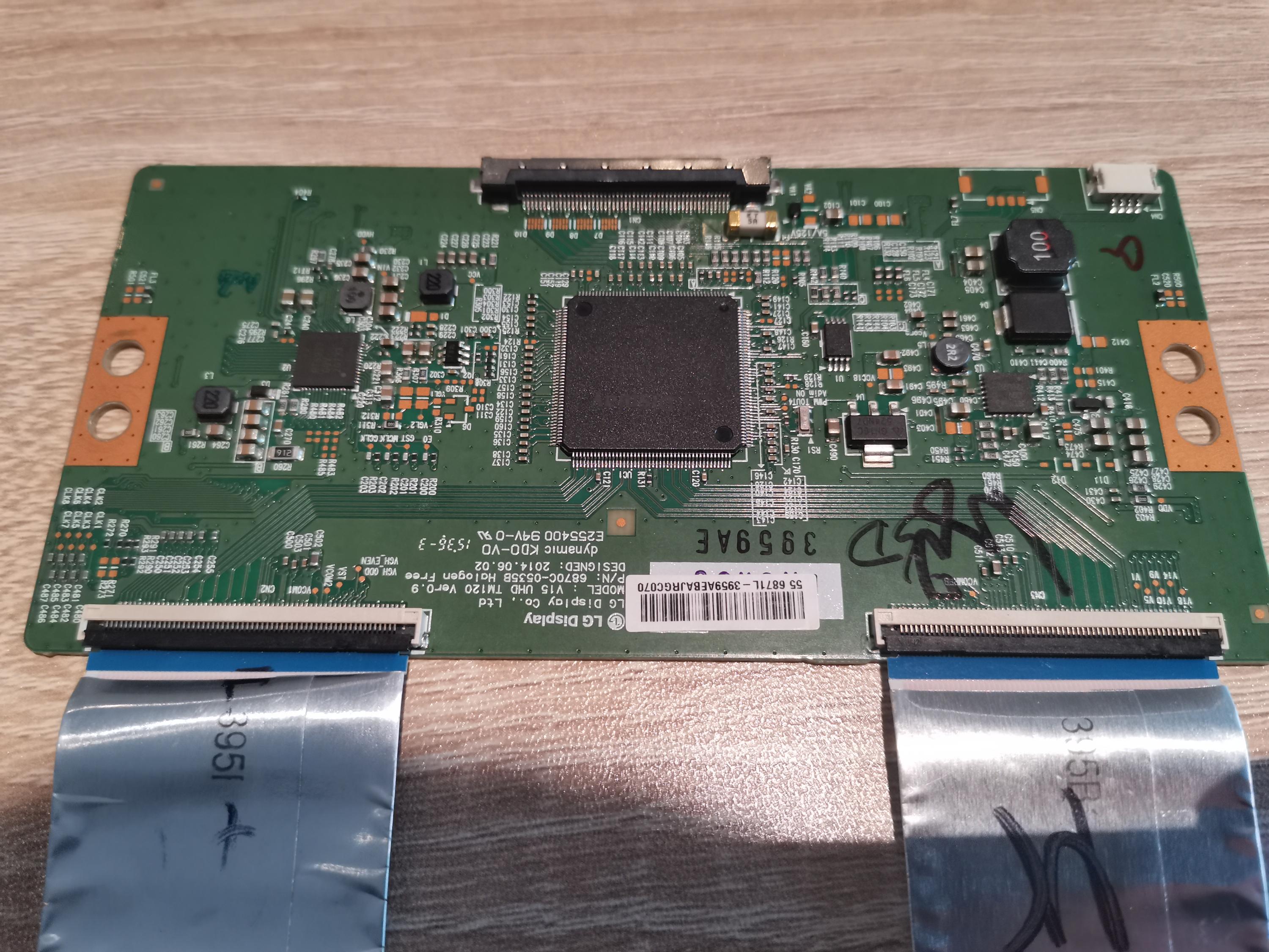

                                1- what do you meen with ( If I press on the tape in the middle ) ?? can you show us this Type ? it may the U ribbon i mentioned before !!
                                2- the LVDS socket... at your first post you put 2 photos on T-CON this one & this one which the LVDS socket had unusuall ( black or brocken )at Pin 9 close to VCC 12V.(F1)??
                                  Yes, I see that, now you point it out.

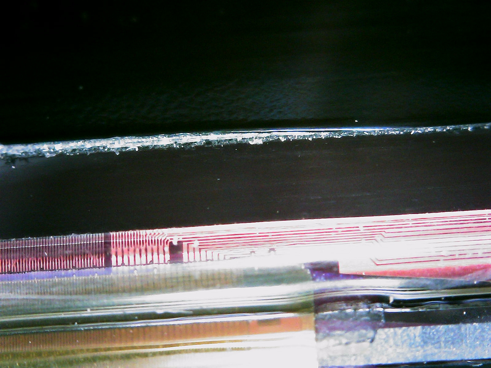

                                    That's some good eye for the detail there! Unfortunately that was just a piece of dirt. Closeup pic attached.

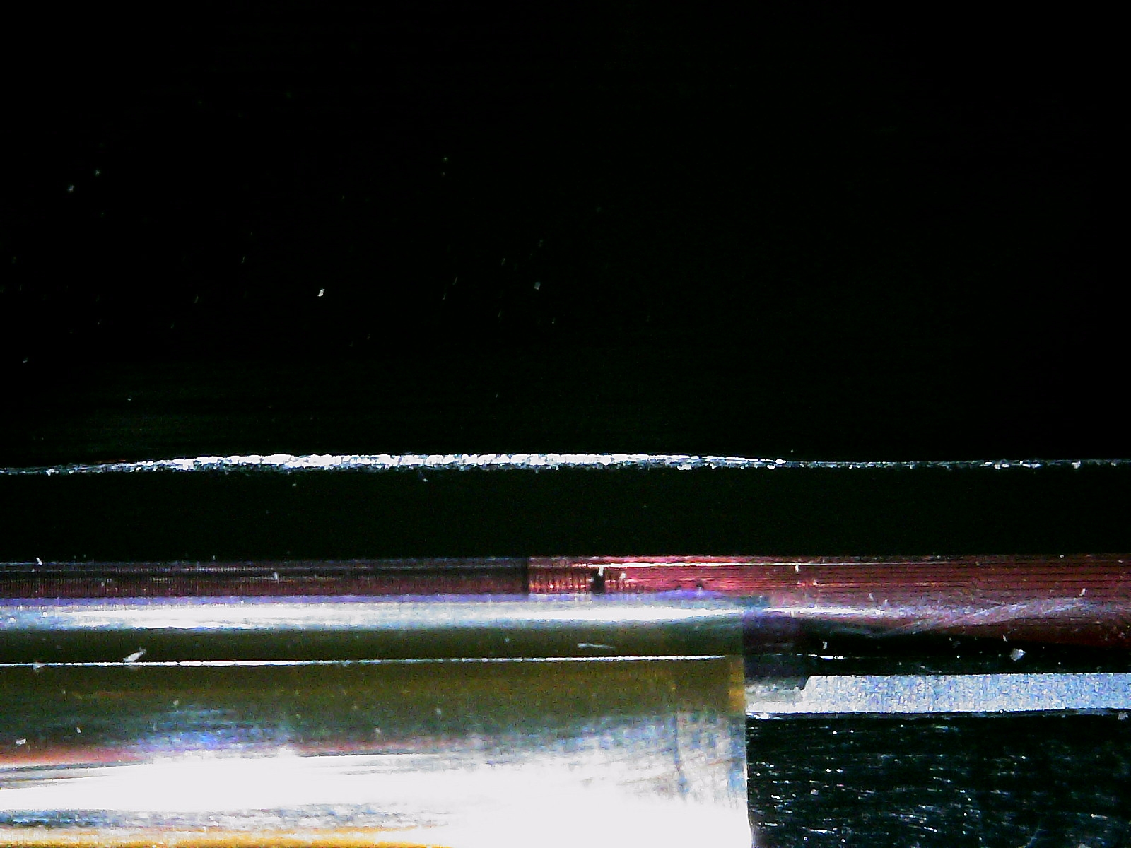

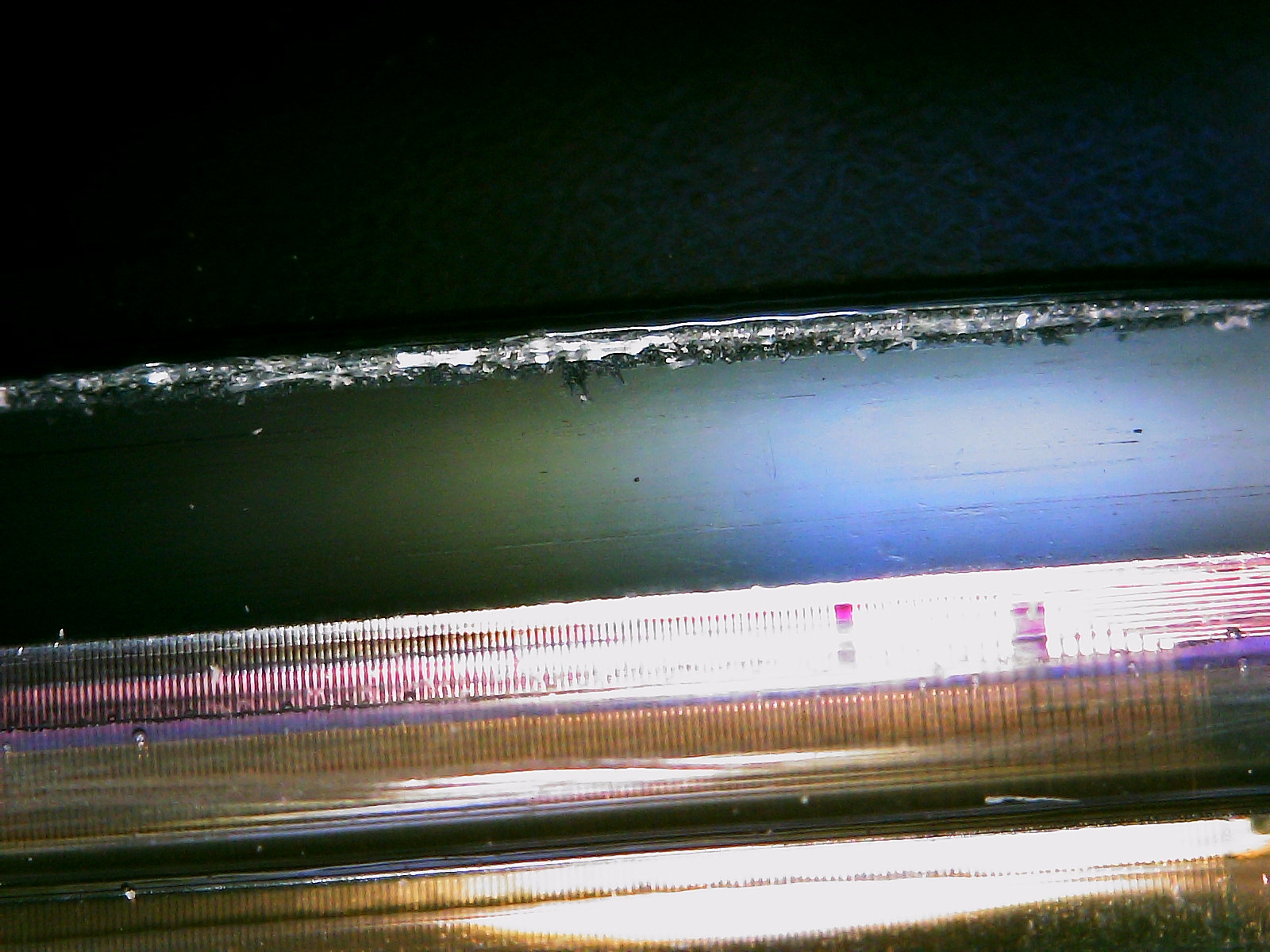

                                    What places I meant I pressed - marked with X, red X is THE spot, however if I press on blue x the picture clears as well, it's just more difficult here and requires more force. By pressing the tape in the middle I meant pressing it against chassis or my own finger, not on the connectors, just the tape itself.
                                    I had one more look around the panel, and at the end of the bad side it looks like some kind of laminate isn't 100% perfectly glued? Not easy to explain and even more difficult to capture on picture but I tried.

                                      here are your issue.
                                      1- about bad image on left side.. you need to fix the ribbon cable corectly .. you may need to clean the socket from any rest of perviouse danaged ribbon cable pins contact.
                                      2- thislaminate at the rand on the right side under it you have thin film which had rail vcc + and GND. any cut off of one or both lines at it the display will not produce image when both ribbon connected.. as the T-COn will cut off.
                                        #39
                                        Re: Philips 55PUS6262 no picture
                                        Closeups attached, does it look like it? I'm afraid I know the answer but...is that it with this panel then? No chances and no point to waste more time?

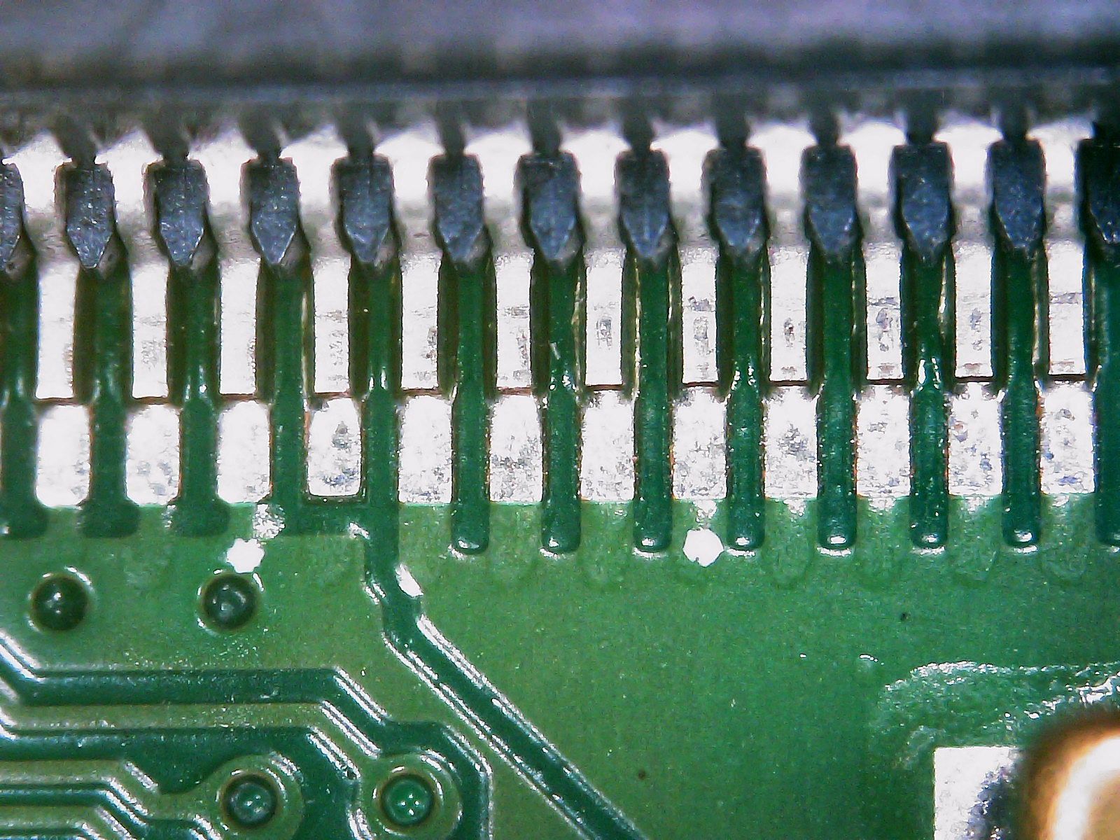

                                          and you closely inspected the solder joints on the connector on the tcon side that ribbon cable connects to?
