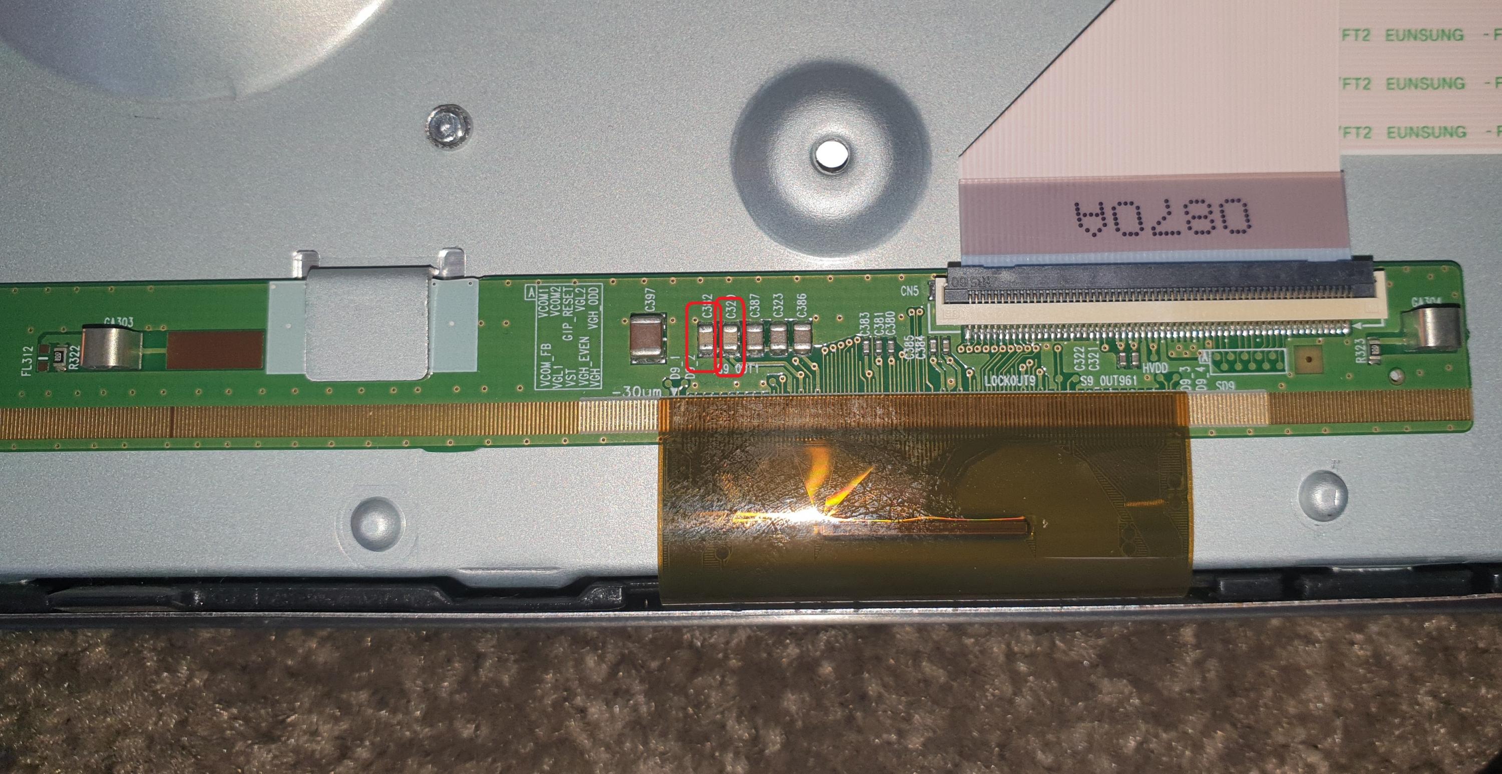

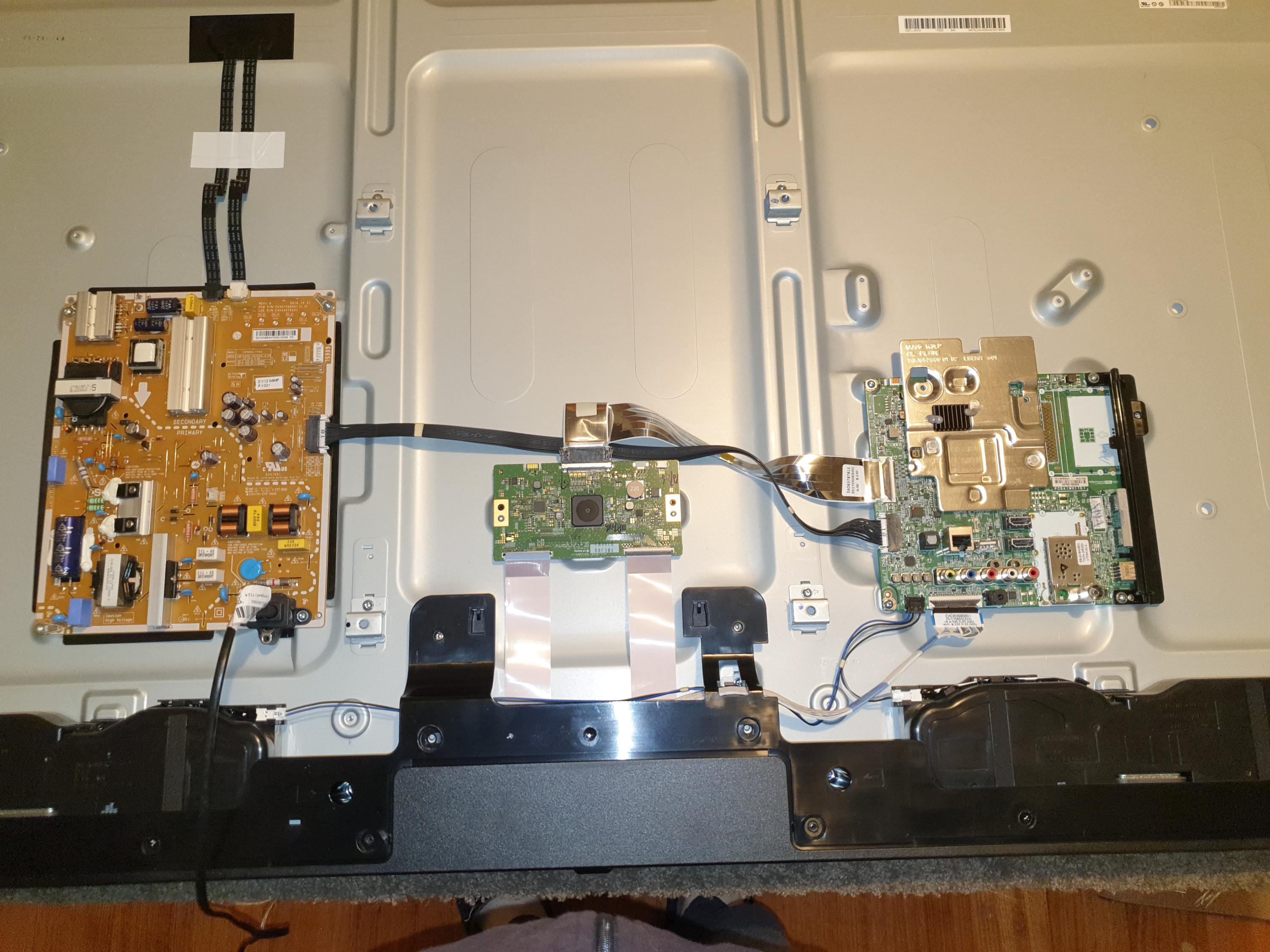

    65UJ654T Backlight but no image
    As titled, just backlight and sound on.
    I disconnect right side TCON LVDS and half screen is white other half just blank. If I reconnect it and disconnect other LVDS whole screen is blank like how I started. Does this mean bad panel?
  • nubinator
    • Jan 2012
    • 37
    Re: 65UJ654T Backlight but no image

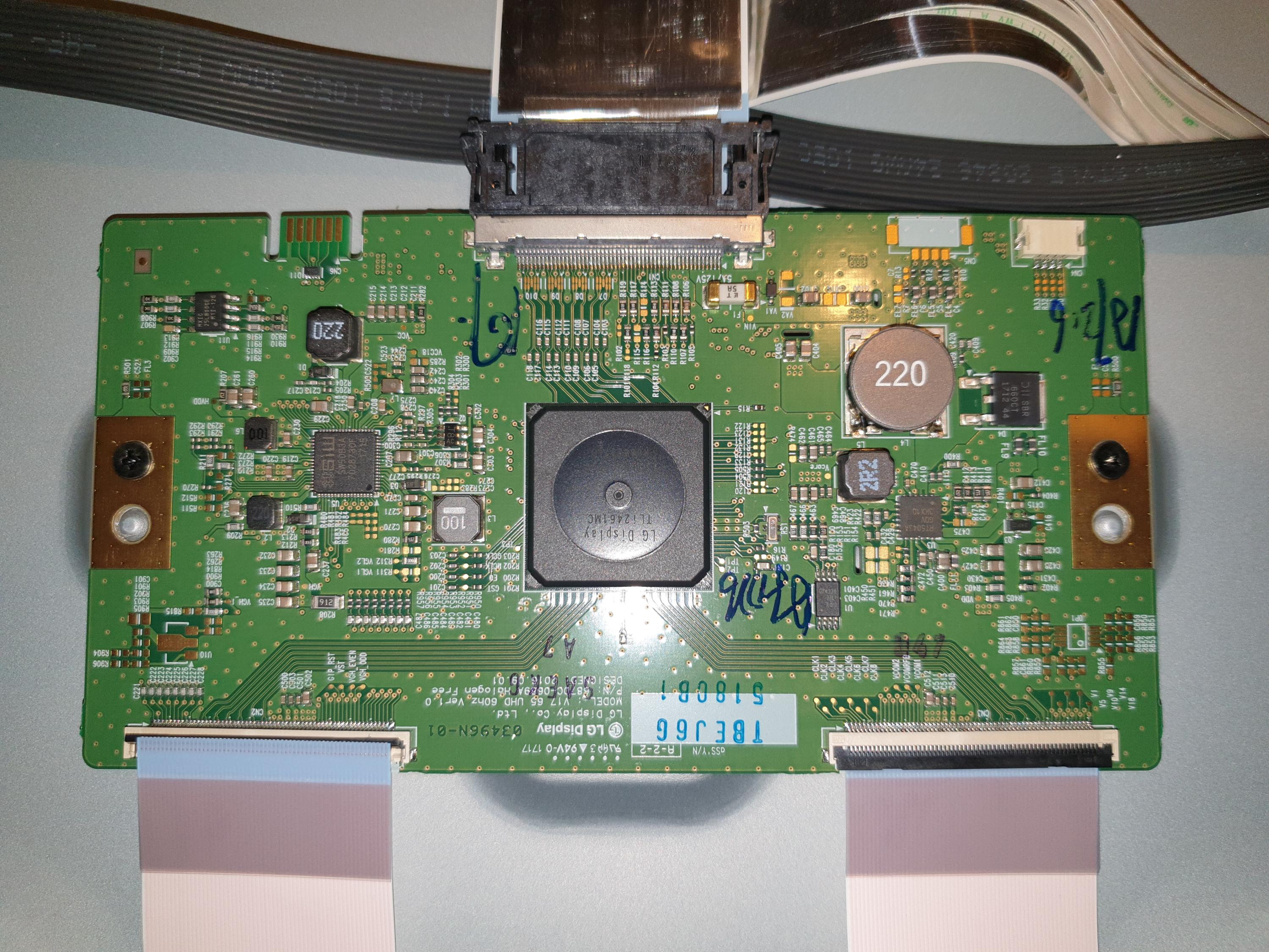

    I added pics and took some reading from test points on TCON
    When right side LVDS connected I get
    VIN 13v
    VCC 0.8v
    VGH 0v
    With just left side or no LVDS cables connected
    VIN 13v
    VCC 3.3v
    VGH 28v
    Either way I still get no image on screen. How do I differentiate between bad panel or bad TCON?

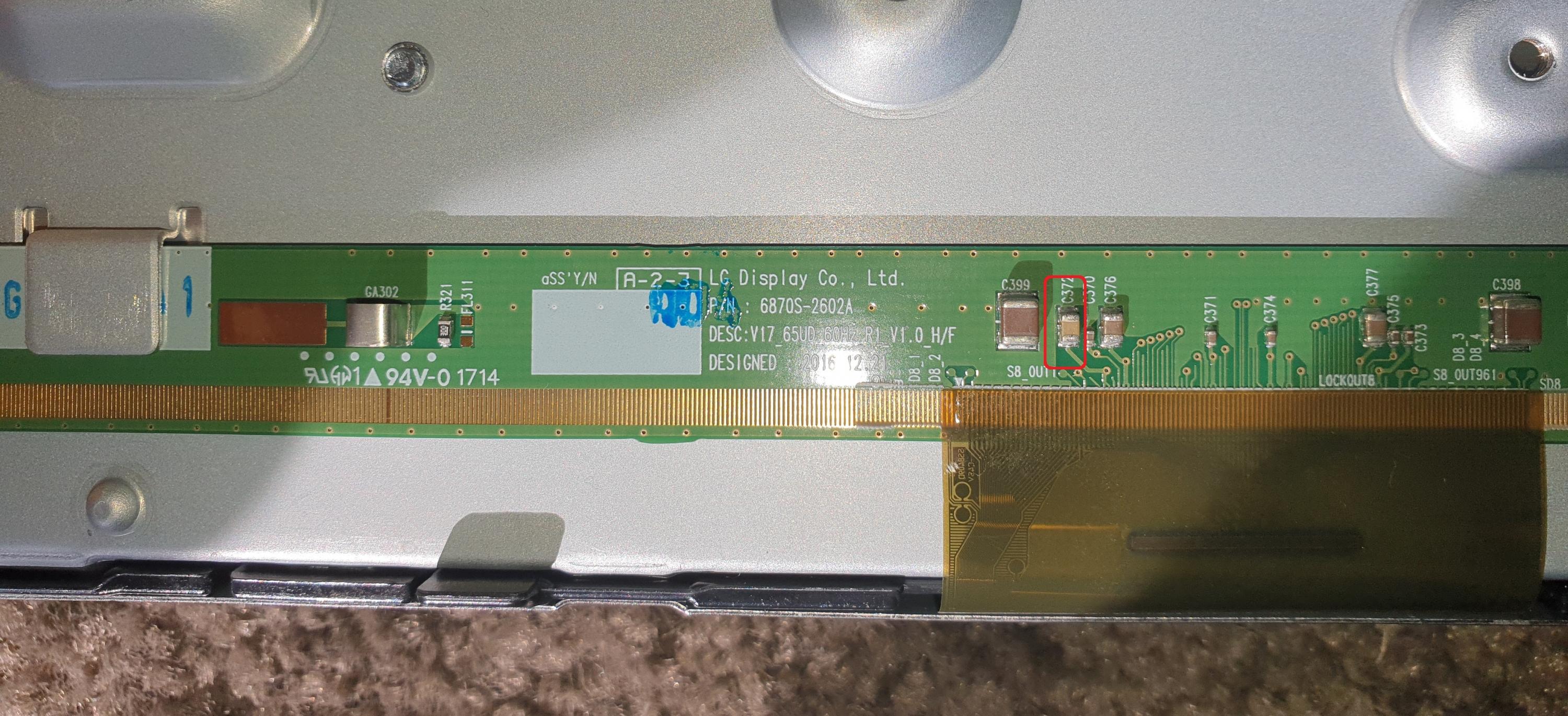

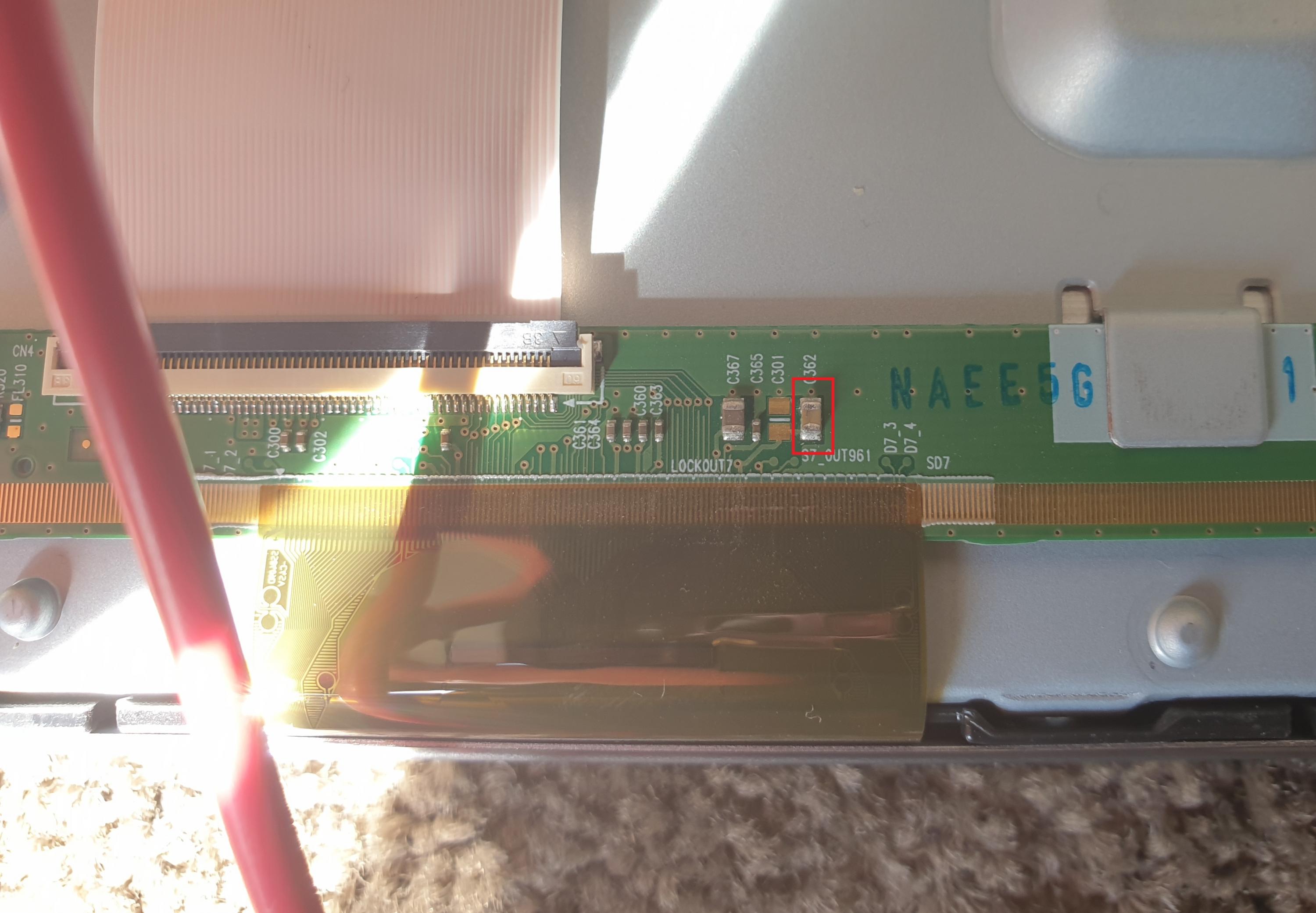

        I tried but always getting low voltages on TCON when right cable connected. I then looked at the panel boards and getting shorts on some of the caps on right side and none on the left. Could bad capacitors be the problem or this just indicative of bad panel? I highlighted the shorted caps in the pics
          If neither side is providing an image, it is worth trying to replace the tcon board. Maybe find a seller that takes returns.

            wow I took the 4 caps off the panel board that were showing short I tried without replacing them and now i got full display and seems to be working fine? what do those caps do? it was only c320 that was actually bad and i ripped up a couple of pads trying to desolder the little things
              ok, if short is gone, then it was just a bad cap, I should have said check the caps first. I would replace the bad cap. Maybe look on youtube for pad repair or a similar solution.
                    Thanks luckily It was only ground pads I lifted so was able to just bridge to adjacent cap.
