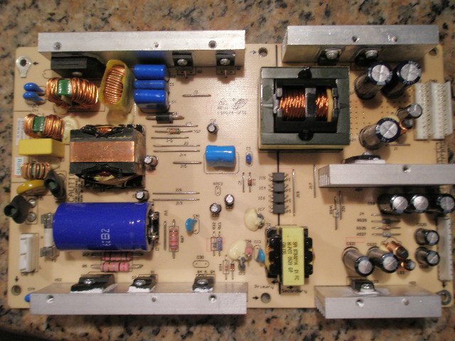

    The power supply on this ViewSonic TV appears to have some bad caps. When trying to turn the TV on I get nothing. There are 4 Capxon caps with swollen tops that appear bad, but I would like to change them all. I have dealt with Digikey before but would like to know if the site sells an equivalent replacement and what the shipping options would be. Below is a list of what I would like to replace. If someone would be kind enough to give me their opinion as to what they would recommend to use for replacement, I would greatly appreciate it!
    All are Capxon caps:
    Qty-3 680uf 25v KF105°c C618 vent
    Oty-2 1500uf 16v KF105°c C618 vent
    Oty-2 220uf 25v KF105°c C616 vent
    Thank you very much in advance for any assistance you might be able to provide.

    If you are going to recap them "all", I count 16 caps on the entire board. Please provide the dimensions of all the caps because 3 or 4 them might be a tight fit side by side. Also, you don't want caps that are too tall and then you can't put the shield back on them.
    Mouser.com, Badcaps.net are 2 other options.
    Panasonic, Rubycon, and United Chemi-con are the ones recommended most be forum members.

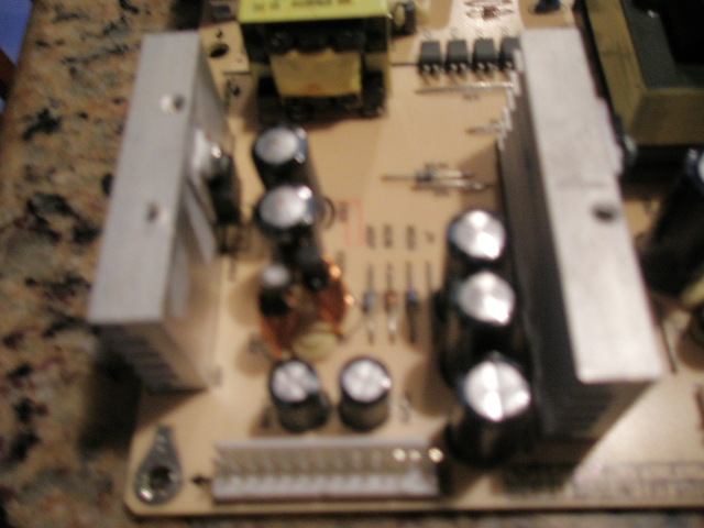

      You only need to replace all the Crapxon capacitors in the secondary side. There are 11 total. I would use Panasonic FM caps from Digikey.
      Just watch the height and the diameter (typically 10mm for the larger ones).

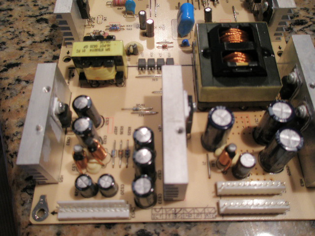

        Forgot to give the sizes. Lucky13, I am going to replace the Capxon caps for now and here are the sizes:
        Qty-3 680uf 25v KF105°c C618 vent Size: 10mm round, 21mm high
        Oty-2 1500uf 16v KF105°c C618 vent Size: 10mm round, 21mm high
        Oty-2 220uf 25v KF105°c C616 vent Size: 8mm round, 12mm high

          Also replace all (i count 5) small capacitors on the primary side.
          These often dry up as well and cause startup problems in the future, plus its not much work to replace.
          Capxon KF can be replaced with United Chemi-Con KY or LXY series, Rubycon ZL, ZLH, Nichicon PW, Panasonic FC, FK or FM series.
          What type is the large blue capacitor? If its Capxon, i usually replace it too, had enough faulty ones by now.

                          I think I got this all figured out, seeing as there are only one set of ripple current and lead spacing choices, it looks like the correct set of items are:
                          http://search.digikey.com/scripts/Dk...name=P12390-ND
                          0.67 ea.
                          http://search.digikey.com/scripts/Dk...name=P12368-ND
                          0.85 each
                          http://search.digikey.com/scripts/Dk...name=P12383-ND
                          0.45 ea.

                                Swapped out the 3) 680uF and 2) 1500uf caps and it works like a champ. I haven't soldered in 25 years and didn't know if I could pull it off, but soldering this board was a breeze. I hope I can get another 5 years out of this monitor.
                                Bob

                                  This thread is still helping people. I just saved my TV by replacing the 7 caps listed by TXPilot69. Had a heck of a time melting the solder to remove the old ones, but soldering in the new ones was a snap. Thanks.
                                    Re: ViewSonic N3760w LCD with bad caps
                                    Last week I ordered the list of seven capacitors as listed by TXpilot69, and installed them on Saturday. Now the TV comes on immediately after hitting the power button, just as it did when it was new. I'm my wife's hero, again. Thanks for your help solving what was an aggravating problem.
