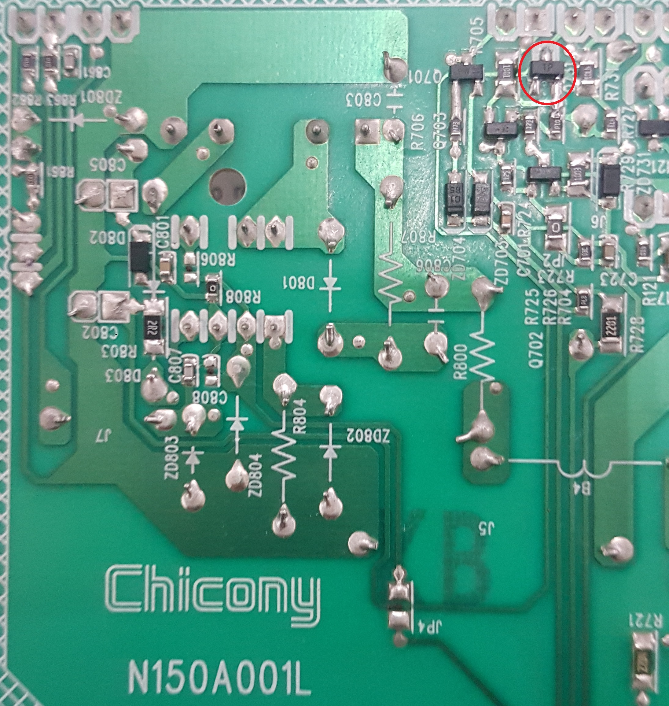

    Found the problem the transistor marked in the picture was short between base-emitter, replaced it and all is working ok.

      good work, so its primary the signal receiver from the second opto which receive from pin 11 the power on.
