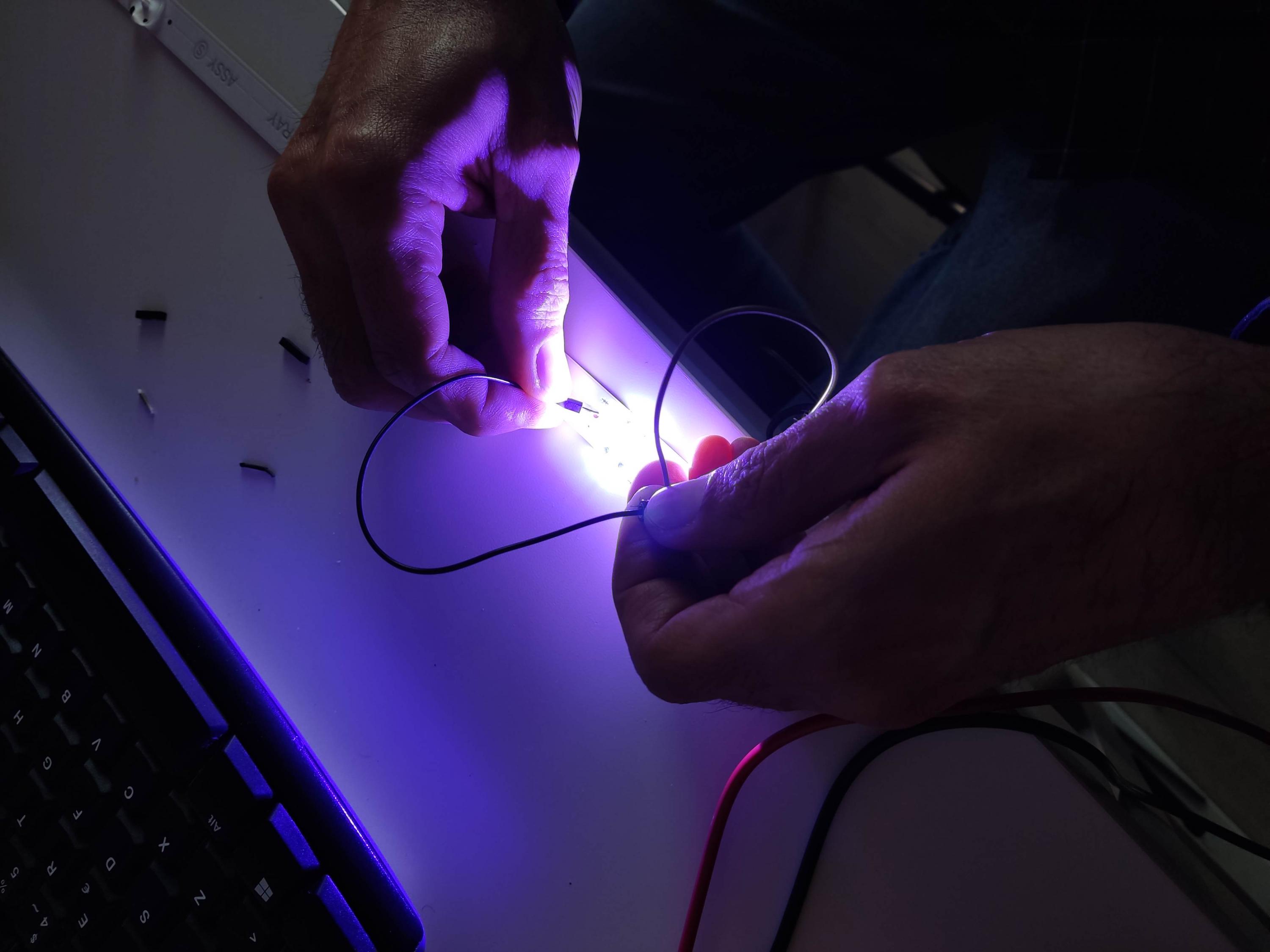

              Re: LG 32LJ610V with the blue tint of death. LED replacing...
              Ok I found it IS the led strip itself. I applied some DC power to each individual LED in both strips and they show completly BLUE.
              See attached photo.
              Any advise on specific strip to buy? Or just any that shows 32LJ61 on it and comes in a set of 2 x 5 leds each?
                As long as they match your strip numbers.

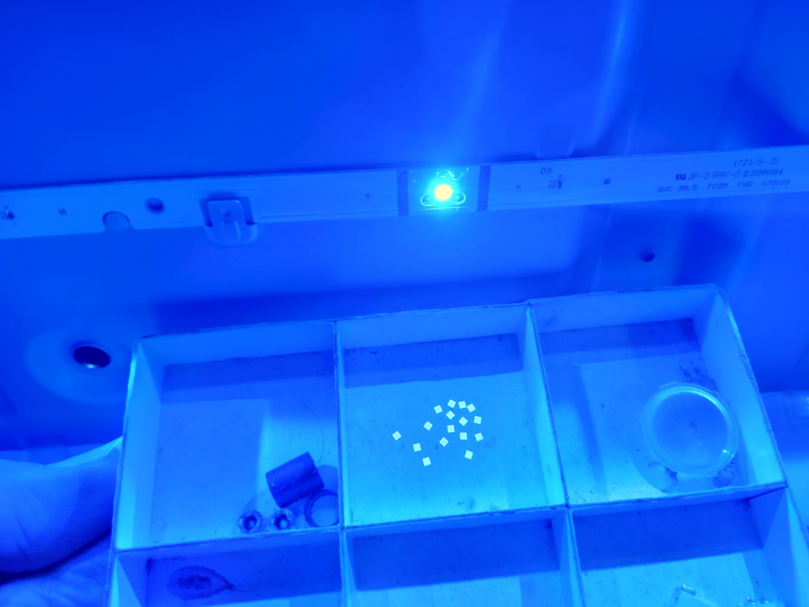

                              Originally posted by angelos
                              The layer on top is phosphor that filters the blue led light into white. Apparently all led's are blue emitting diodes. Its the phosphor that changes it to white. In your case due to overuse the pgosphor has disintegrated so you now se the blue.
                              Never thought about this, but today I’ve opened a Samsung UE40J5200AWXXC with bluish backlight. The first surprise is to find some LED totally blue, while others are still perfectly valid white. When looking carefuly, I’ve found several yellowish tiny squares (about 1.5mm side) fallen inside the backlight chassis. These squares glow white when exposed to blue LED light, and if I put one of these squares in front of the blue LED, it turns white! So, in this case, the failure is simply that these phosphor "filters" fall off from the LED, because the LED has always been blue.
                              Actually, they’re not "filters". You could filter white light to obtain another color, because white contains all other colors, but you cannot filter blue light to obtain white. Blue light from the LED stimulates phosphor to glow white. Well, it actually glows yellow and adds up to the blue light that passes through, resulting in white light.
                              In attached image we can see the raw blue LED and the fallen glowing phosphor caps.
