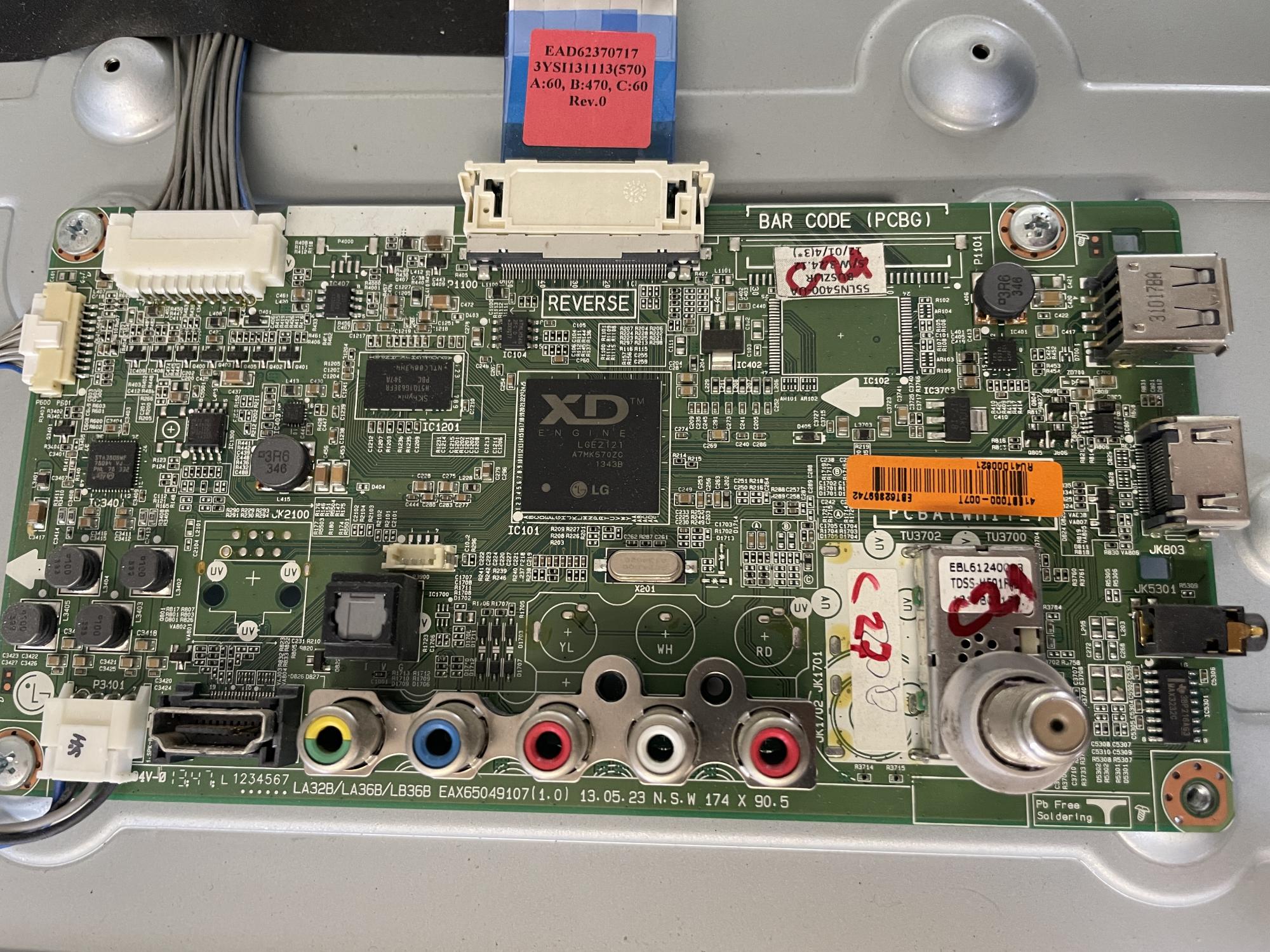

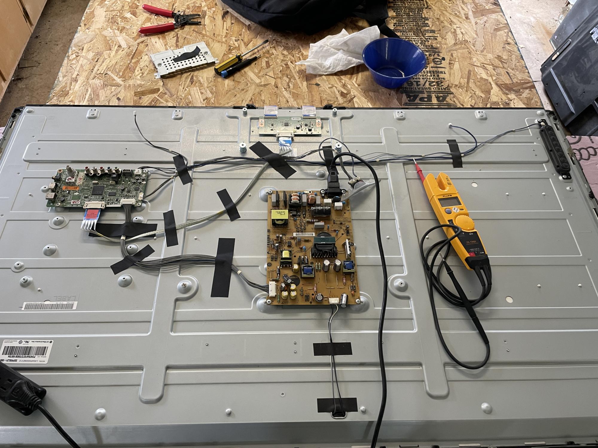

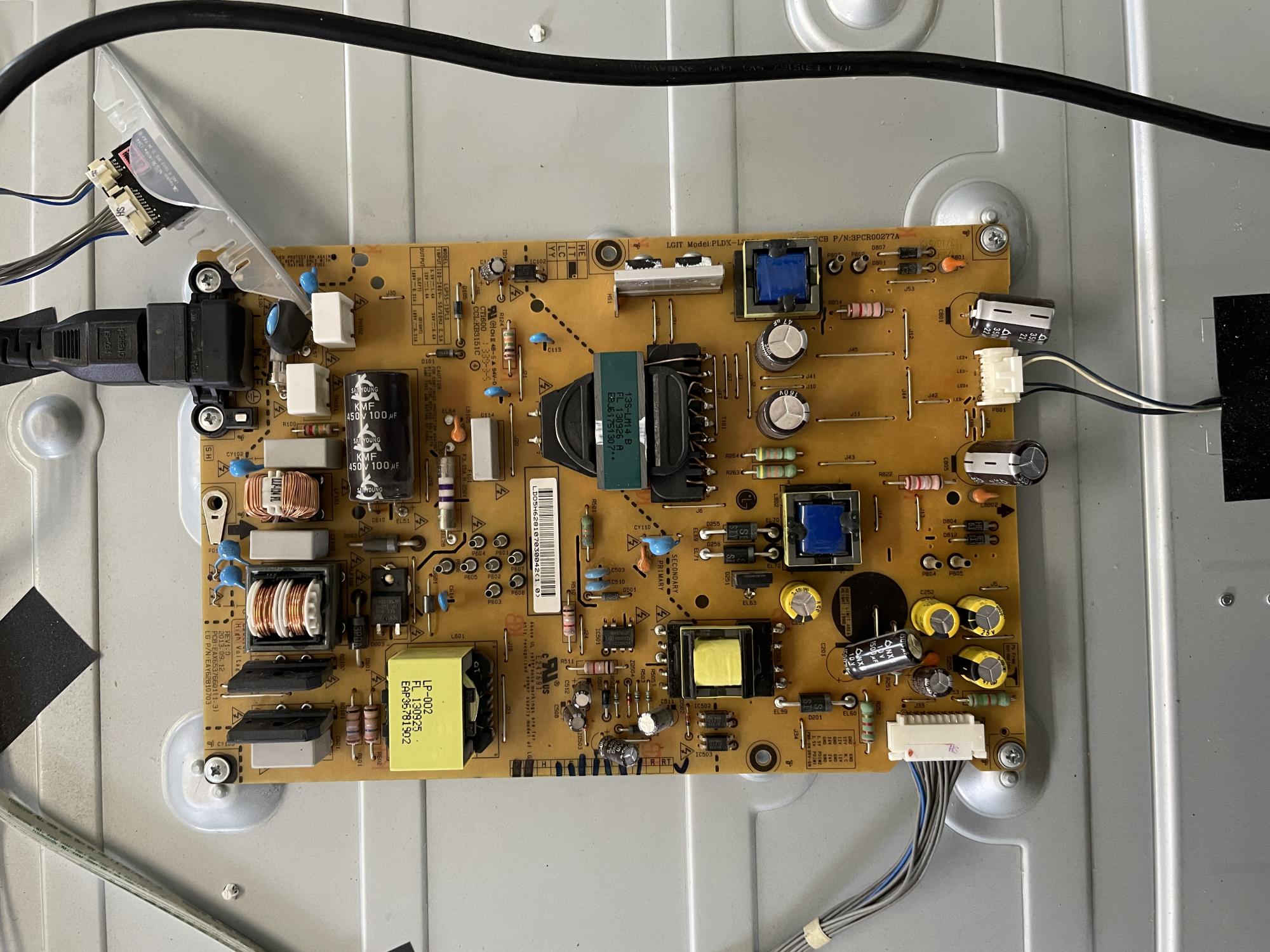

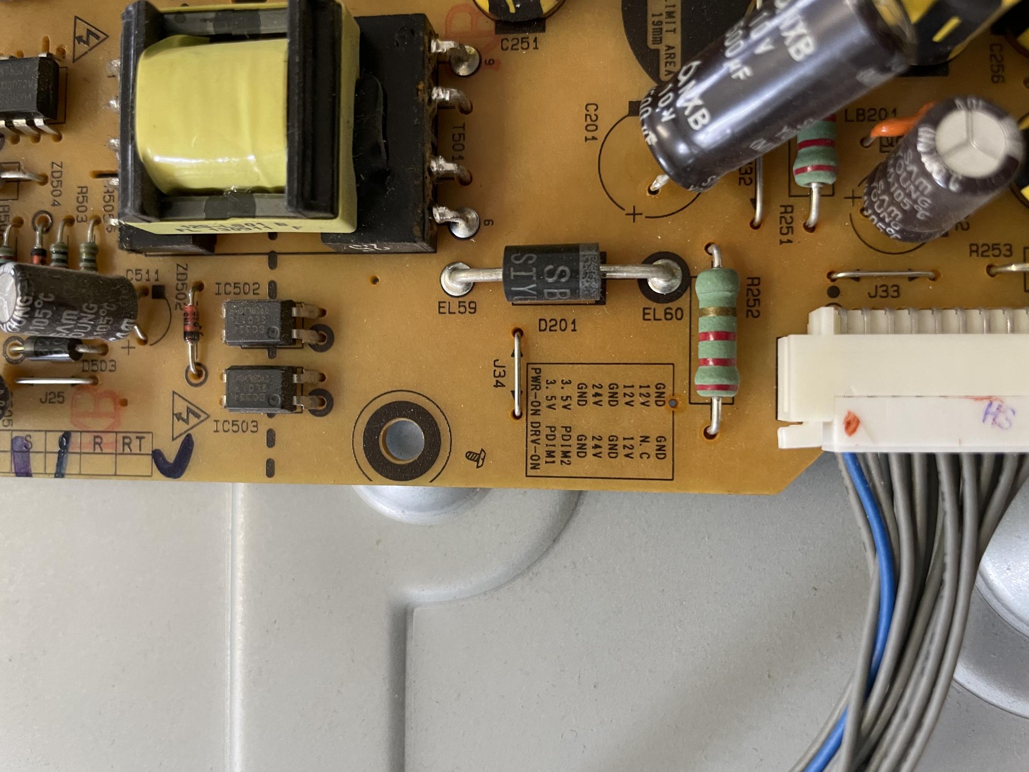

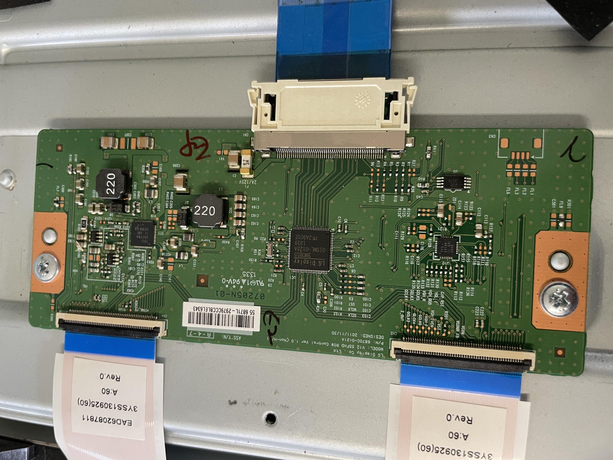

    Hey guys, been a while since I've been in here but had some spare time to troubleshoot a tv that has had an issue for a bit. I initially assumed I had bad LEDs and tore the set down to test. LEDs all lit up and seemed fine using my tester. Reassembled and went to troubleshooting boards. PS board has all correct voltages across the outputs. Not really sure what to test in the main board… I did check the fuse on the T-con and it has continuity but no voltage tested to chassis ground. Am I wrong in my assumption the main board has failed somewhere? Shouldn't the Tcon board have 12v dc?

    I forgot to mention. Power button changes nothing on my voltages. Tv is always in power on state when plugged in. This has mostly been main board in the past for me. I found one off eBay for $15 so I’m gonna go ahead and give it a shot.

        I have a set coming in today or tomorrow….. I may wait til main board comes in anyways as one of the hdmi ports are jacked up. I think my output voltage was around 110v dc for the backlights when testing to chassis ground. Hoping I don't have to replace the LEDs but I'll have them if I need to. They all looked pretty darn good when testing though.

                Is there a point that i can check for fluctuation? I checked the PSU output and it was a steady 116vdc. Hopeful DHL can get off their rump and get me some LED's in the next day or two. I'm ready to be done with this set already.
