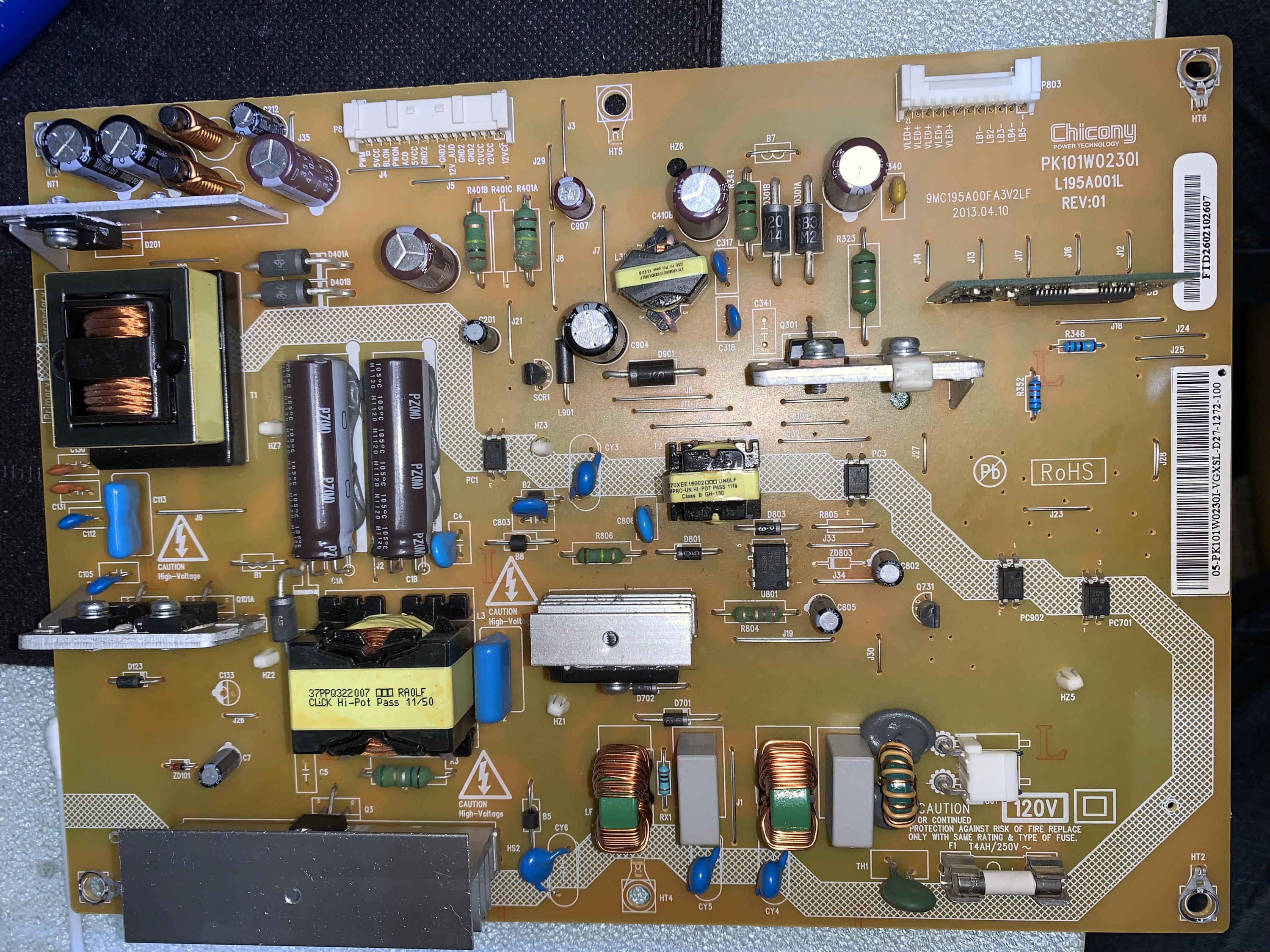

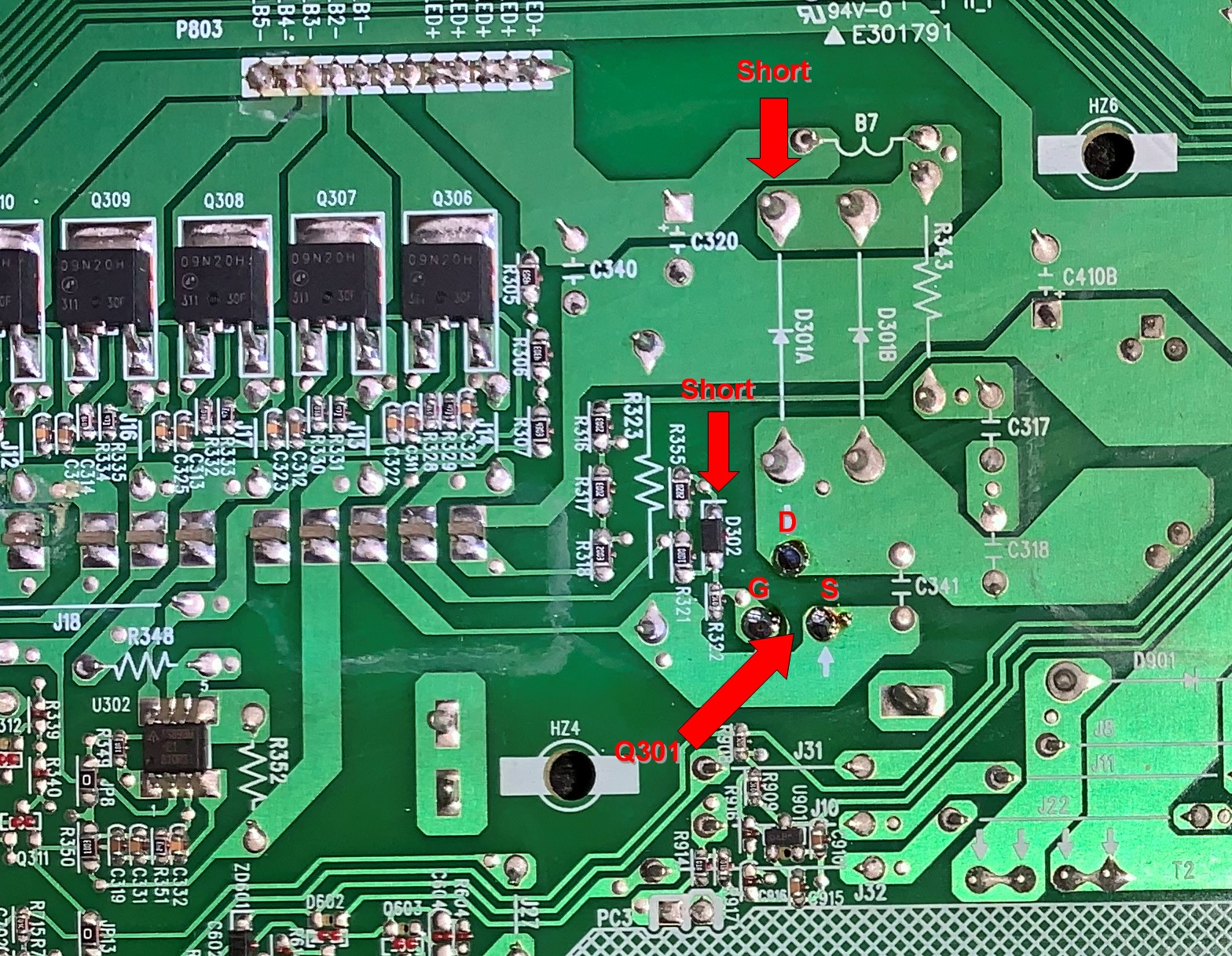

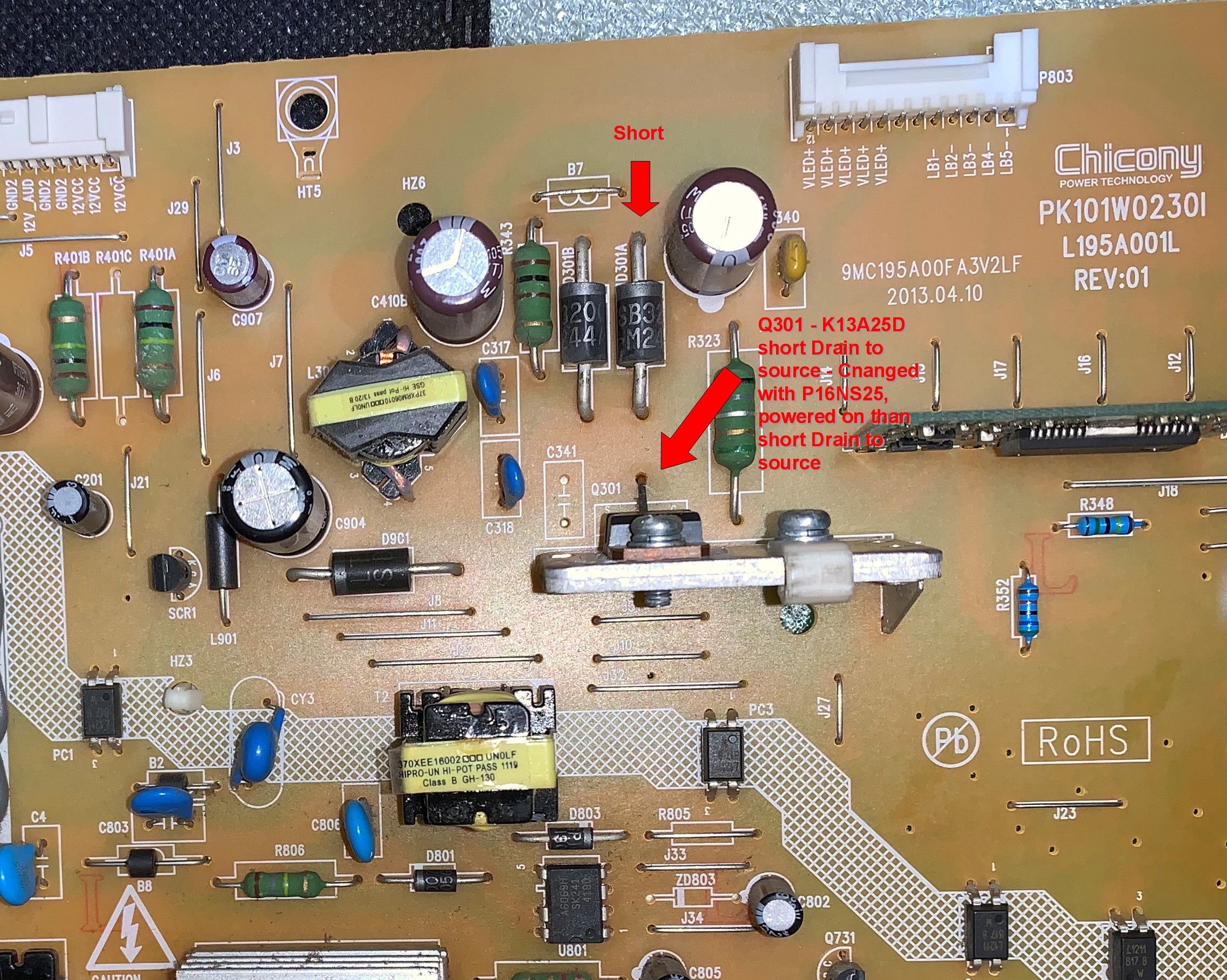

    Need some help in diagnosing all the ripple effects of a failing Mosfet Q301, which originally was a K13A25D which was shorted Drain to Source.
    I replaced it with a P16NS25 which had about the same specs, and the TV powered on for a few seconds, but dropped dead again and Q301 was again short on Drain to Source.
    So started looking at some other components (after removing the shorted Q301) and found diode D301A shorted (took it out of circuit because both D301A and D301B were shorted in circuit, but it turns out D301B is good.
    On the other side (backside) tested the gate components, and found the D302 shorted in circuit.
    So am not sure what else I could check, should I take D302 out of circuit to test it, and what do you think could be my problem? I checked all the led strips with a led tester and they are all fine. Thank you for your help and if you have any questions, don't hesitate to bud in!

                  D302 actually reads 20ohms, because the 2 resistors in parallell (R355 and R321) are 2R20 (R355) and 10R0 (R321), so I think this is ok. What do you think?

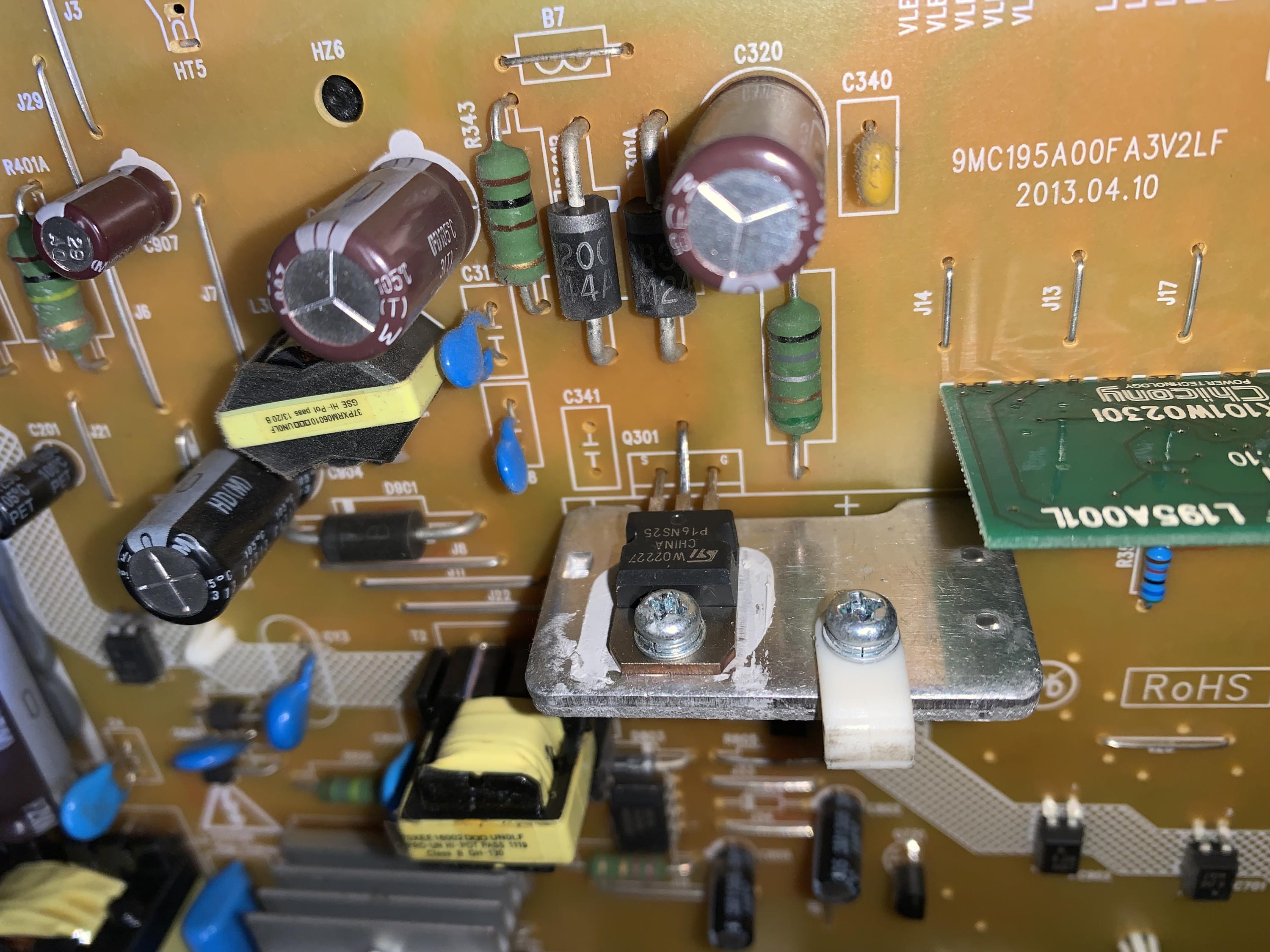

                        Nope that didn't work. TV turned on for approx 4-5 seconds, then off. Q301 drain to source is short and replaced D301a is also back with a short.
                        What should I check now? I've removed the shorted Q301 and D301a.
                        D301B is fine??
                        Tks!
                        • rddube
                          Aspiring Expert
                          • Jun 2013
                          • 950
                          Re: Toshiba 58L1350UC short on Q301 Drain to source
                          Note that I replaced D301A which was a VSB3200 which I didn't have with a SB3B0 which seem to have the same specs. But maybe I fumbled there?

                                  I don't think the SB3B0 is fast enough for the high frequency circuit, that's why it shorted.

                                        If the drive for Q301 is ok from the drive circuit, and the backlight leds are not bad, It should be ok.
                                        Digikey says SR5200-TP is an alternative.
                                        If only the one diode shorted when they are in parallel, I suspect the diode itself was the problem. unless the other one is totally open.
