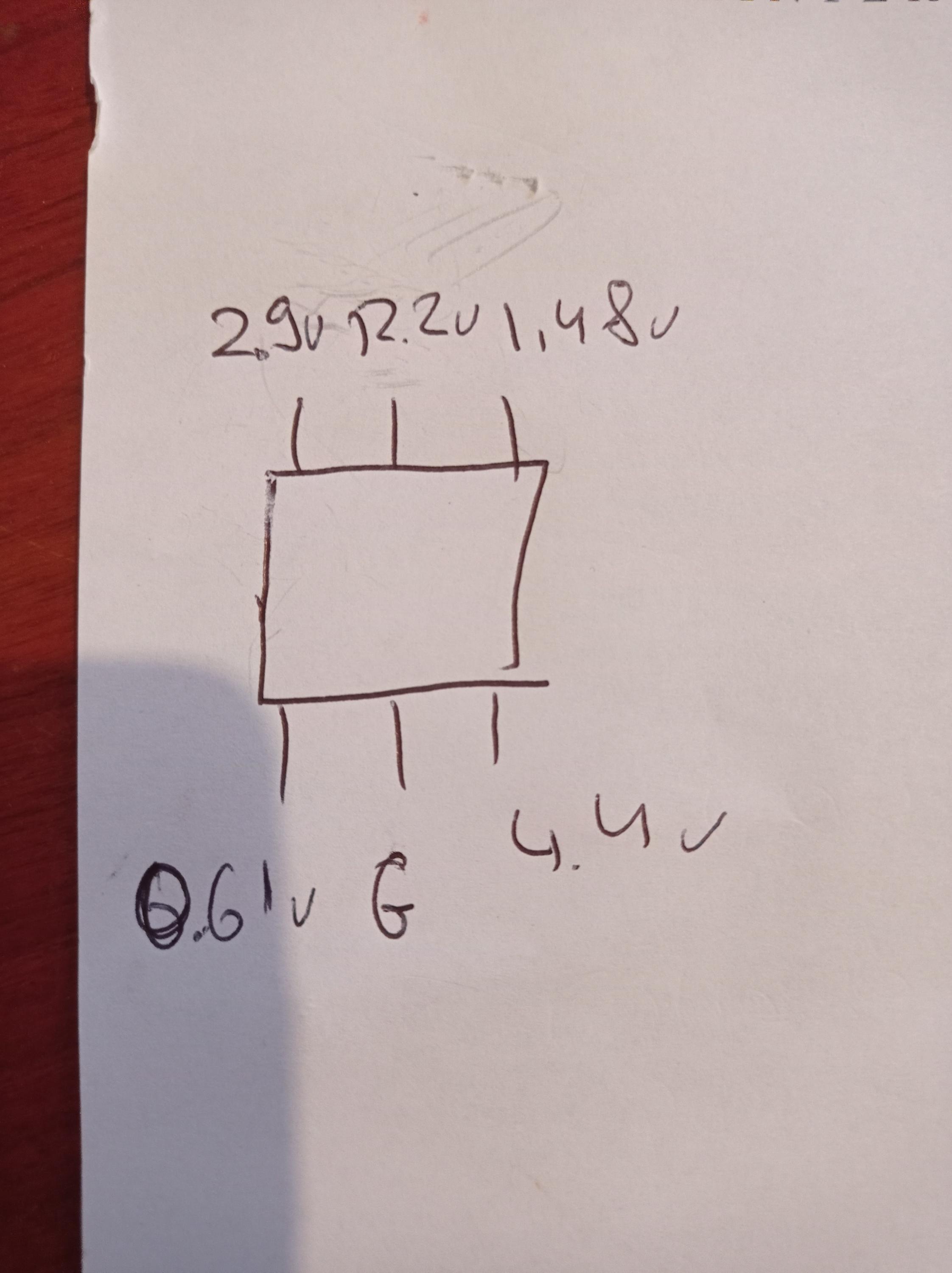

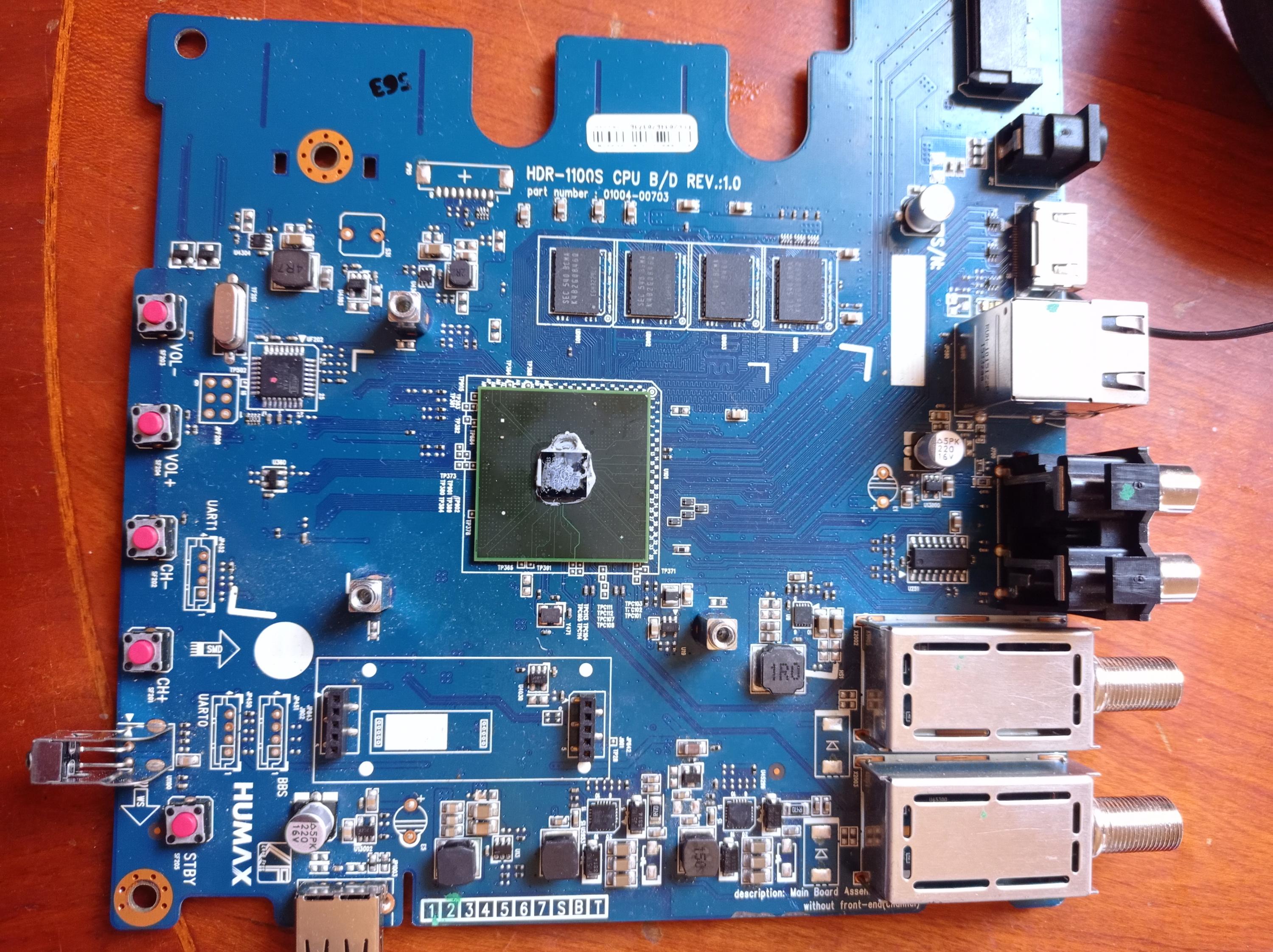

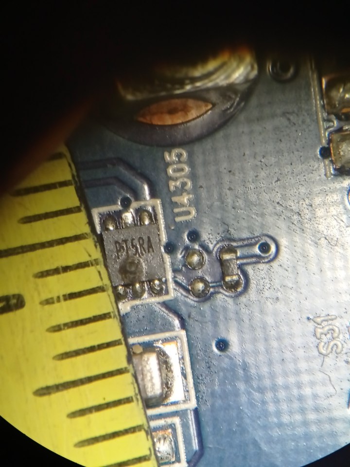

    Hello, Im trying myself in electronics repair, with zero knowledge :-)
    I have Humax sat receiver HDR - 1100S it won't power on. I found short on part ML5ED been advised that it was dc dc converter SY8113 (ordered on AliExpress and waiting for delivery)
    And when been measuring voltages on the board I shorted contacts in another part �� and hoping someone will help me to identify that part. PT5RA its 2mm x 2mm size
    See attached pictures
    Thanks in advance.

    Re: Humax sat receiver HDR - 1100S Help identify part.
    Bottom side picture.
    Anyone know what this is, is this some sort of MOSFET?

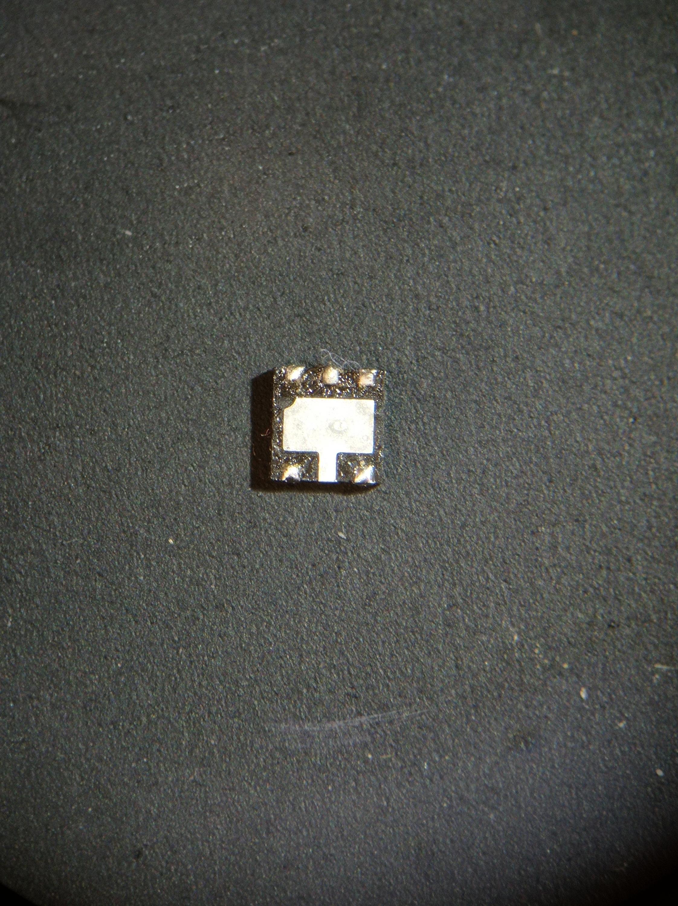

      I can't find much, it does seem to be a case type U-DFN2020-6 (type J)
      any idea how it is used in the circuit?
        Thanks very much for your reply.

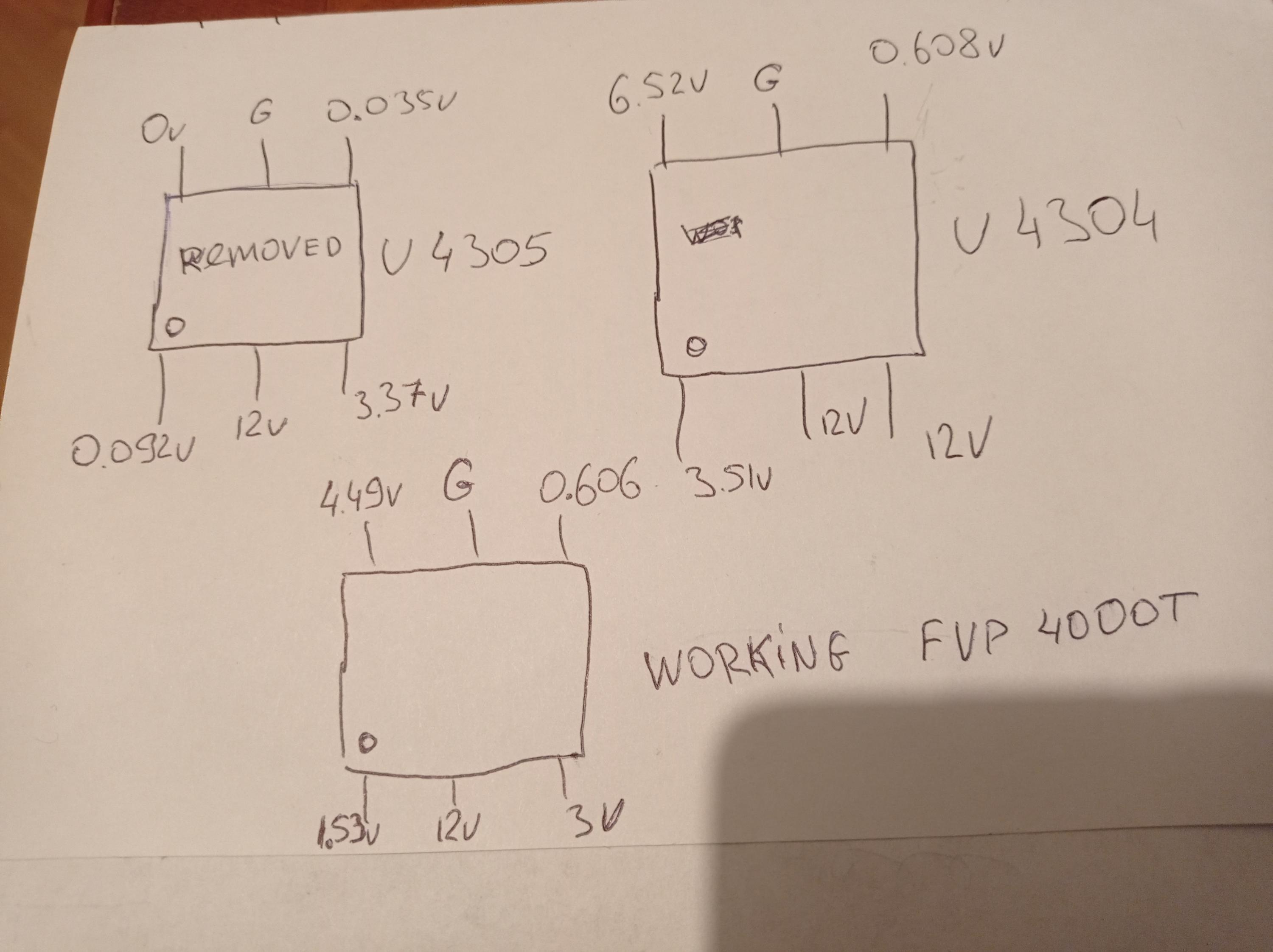

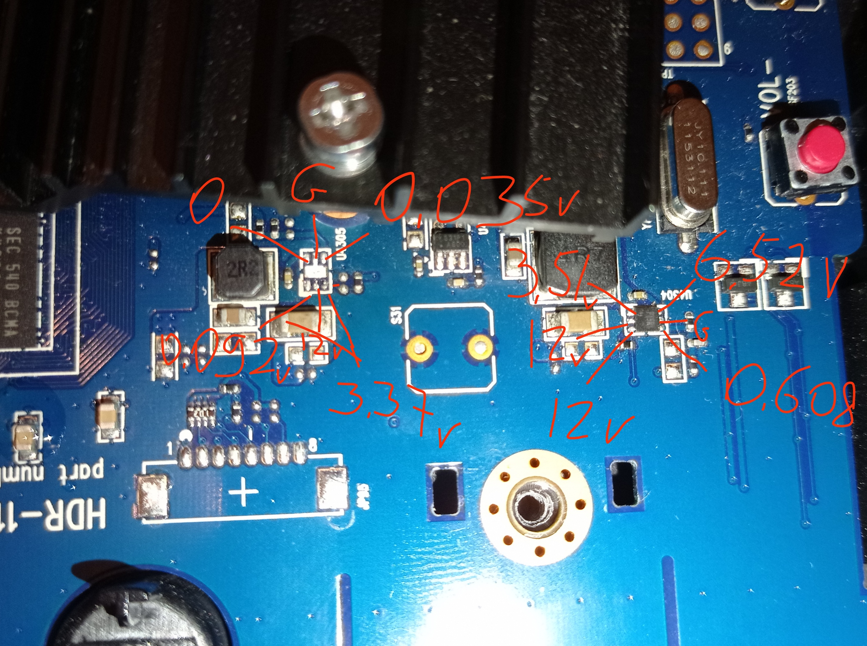

        This receiver has two of them on the circuit board, same number (PT5RA) on the board marked as U4304 and U4305
        I removed U4305 because I shorted pin 1 with pin 2 and it burned hole in it.
        On U4305 (removed) voltage is:
        Pin1 0.092v
        Pin2 12v
        Pin3 3.37v
        Pin4 about 0.500v when starting measuring voltage drops to 0v
        Pin5 Groung
        Pin6. 0.035v
        On the U4304 (second one on the board)
        Pin1 3.51v
        Pin2 12v
        Pin3 12V
        Pin4 6.52v
        Pin5 Groung
        Pin6 0.608v

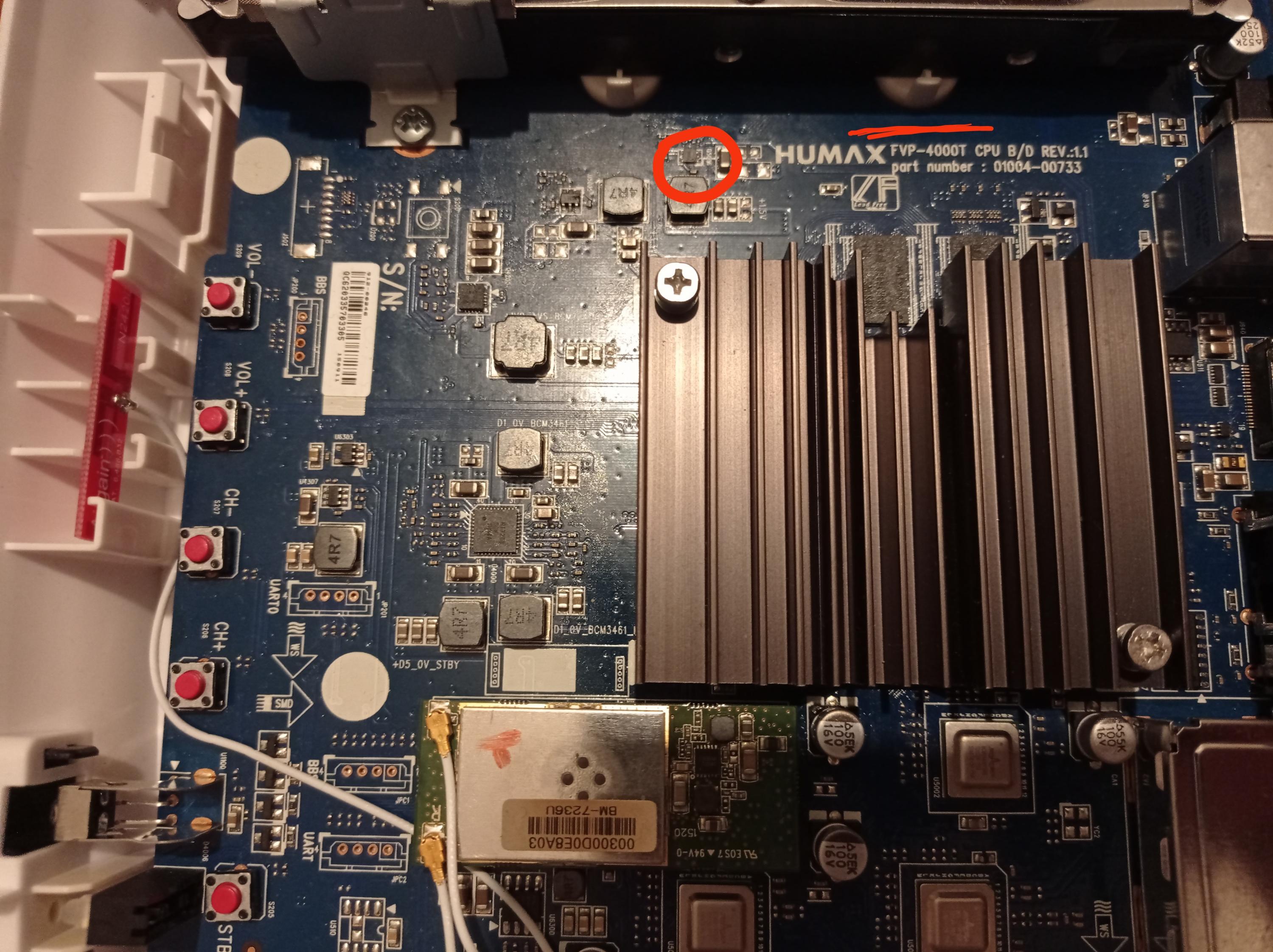

        I also have working humax FVP-4000T Freeview receiver
        Its similar board inside, but not the same.
        It has same looking chip but instead of PT5RA its PT5OA and only one chip(satellite receiver has 2)
        Voltage on FVP4000T is: (switched on and on standby same voltage)
        Pin1 1.53v
        Pin2 12v
        Pin3 3v
        Pin4 4.49v
        Pin5 Groung
        Pin6 0.606v
        I will also attach pictures.
        Thanks in advance
          It looks like the part number is PT5xx where xx is a date code. They seem to be a buck regulator ic, so not just a mosfet.
            Thanks for your reply R J

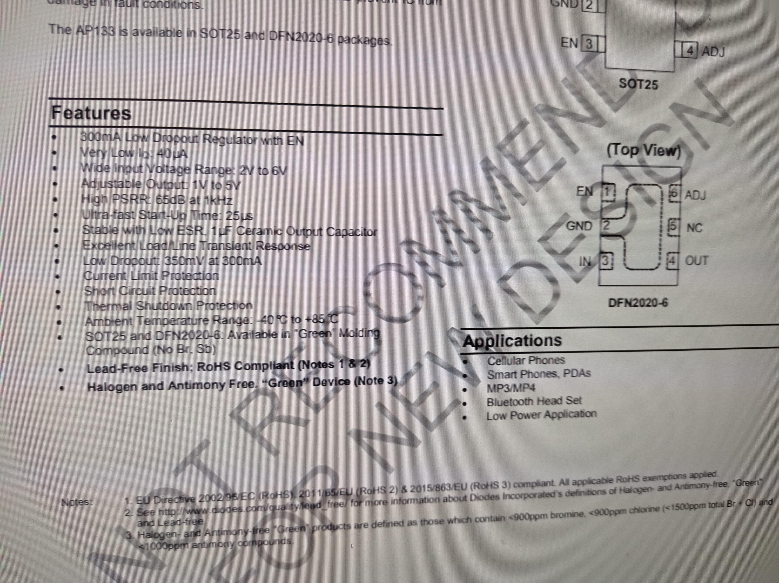

            I found AP133 in DFN2020-6 package but its for 2v to 6v
            I need for 12v.
            I emailed Diodes to see if they have any alternative for me.
