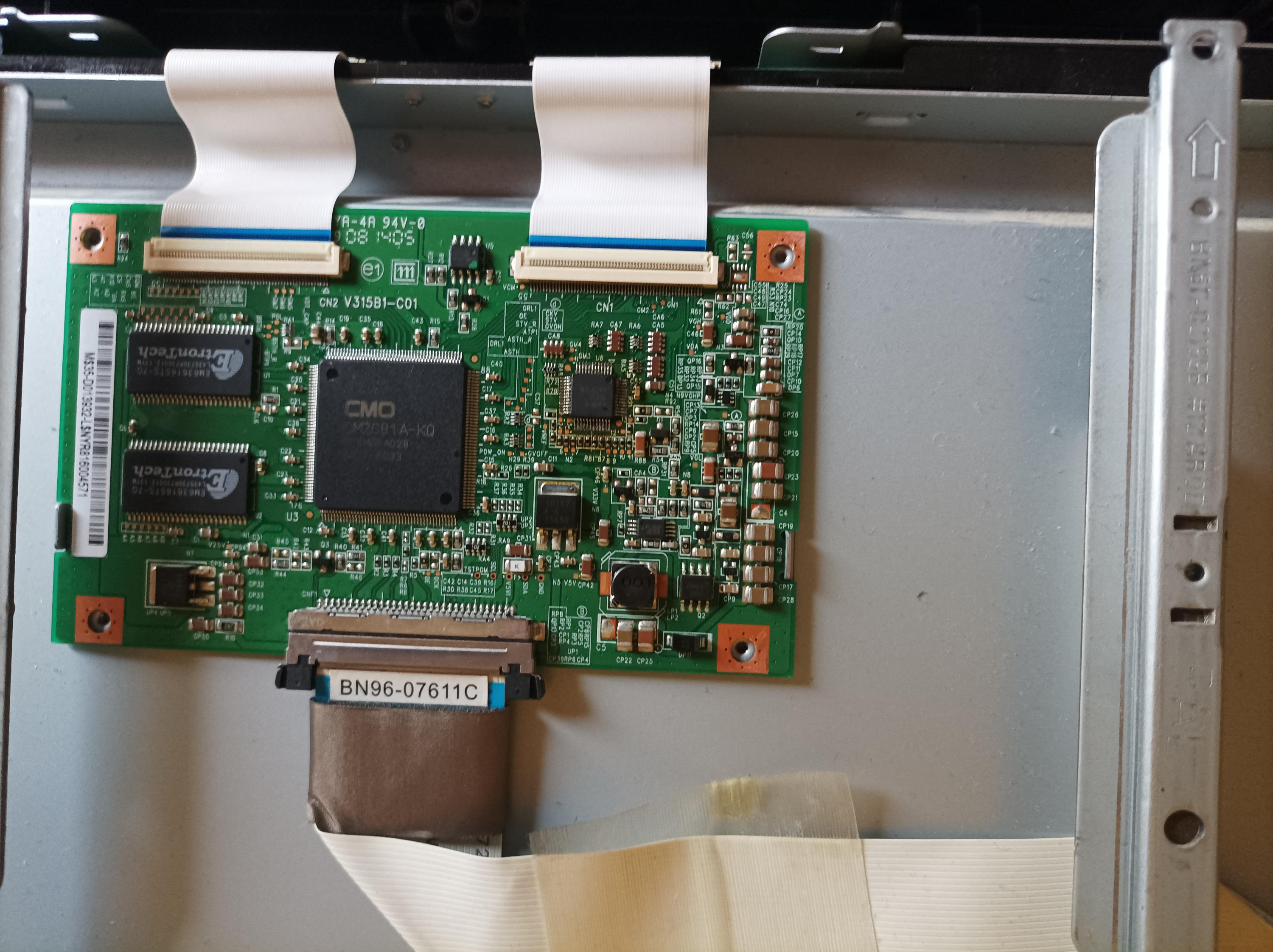

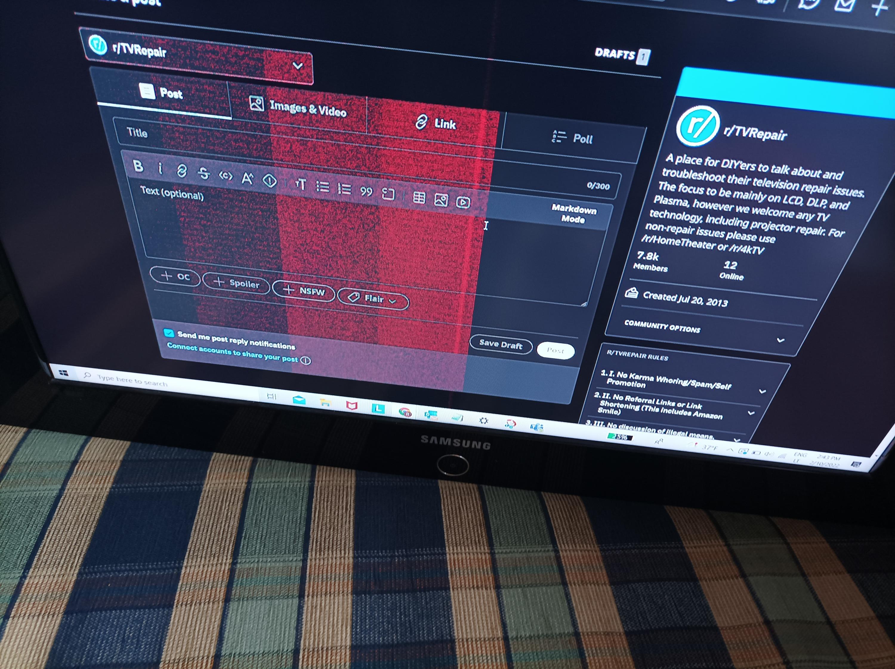

    I came here for help with a passion project I've been trying to do. I want to repair a not so new samsung LCD TV.
    My journey began with this tv showing distorted colours, they just weren't right, so I did a lot of googling and voltage measuring, to find out that it was probably the doing of a faulty capacitor and the AS15-G chip on my tcon board.
    After replacing the two parts with new ones I turn on the tv and half of it is working perfectly and the other half has a red tint and red lines, so continued googling brought me to try and clean the connectors from the tcon to the other parts of the tv, but it didnt help. Then I tried switching the cables places to see if it's the wires, nothing changed and I am out of ideas what to do for the time being.
    I hope someone here can help me, some photos are attached if more are needed feel free to ask

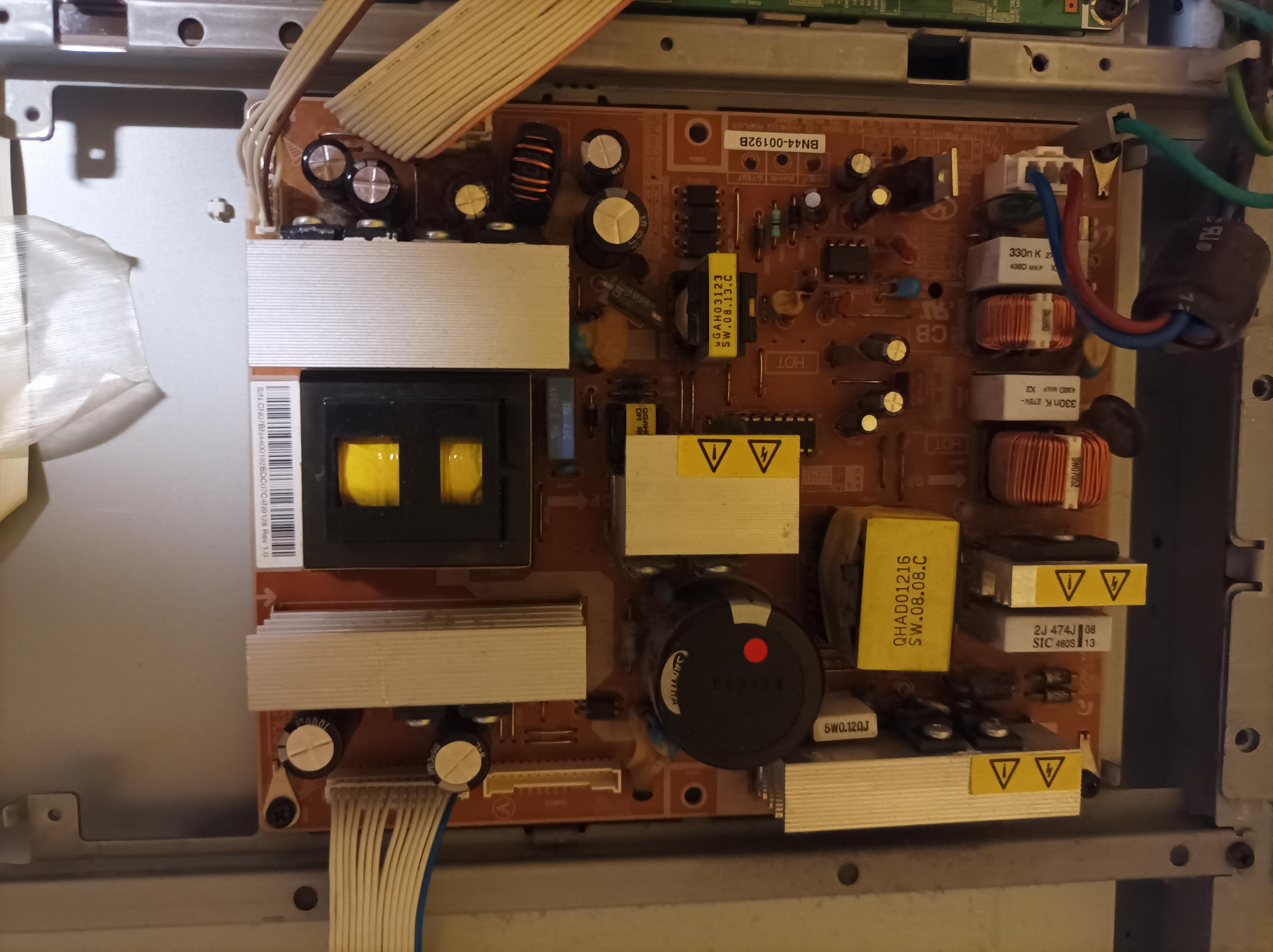

    Re: Trying to fix LCD samsung tv, half screen with red tint
    which cap on T-CON ?? normally only AS15-G chip replacment enough.
    you got now new issue so the caps could not fault or the chip need to rework.

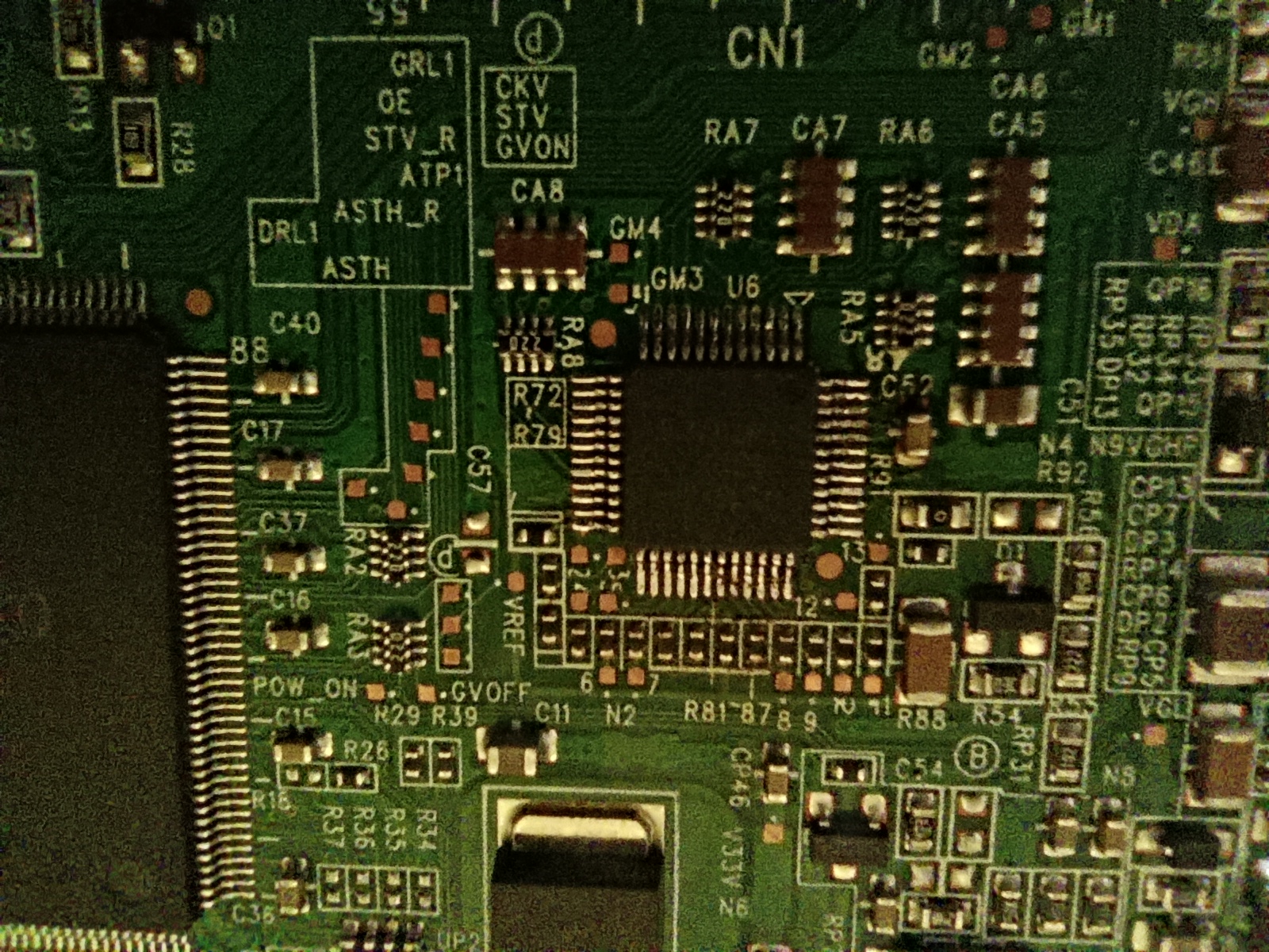

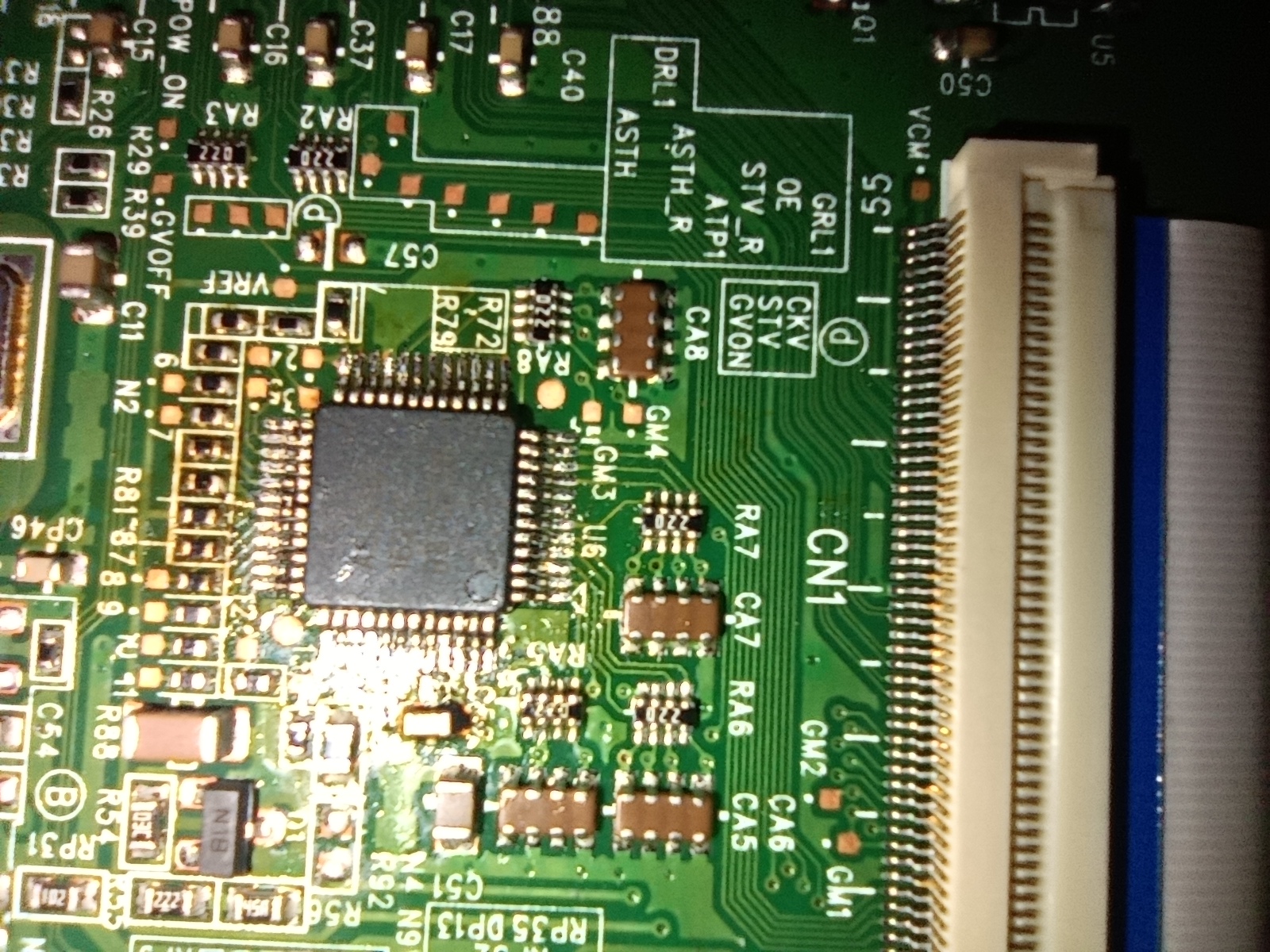

      Can we get a close up of chip you replaced?
        Oh no a faulty capacitor was on a different part of the tv. I only replaced the chip on the tcon. Sorry that i did not make that clear.
          This is the replacement chip, best photos I could manage with something this small
            Don't think it's a chip problem. I would examine all areas around where you worked for any missing damaged misaligned parts. And concentrate on the side that has the problem. Inspect all ribbon cable connections for damage on connector.
              Wonder if they sent you a defective AS15 or it got damaged somehow. But I do like that color, I'll take a Porsche 911 in that color, no new crap, whaletail only.
                      Before replacement the issue was that the whole screen was solarized, after replacement only half the screen stayed solarized. I bought the chip on ebay from germany to specificly avoid this problem.
                        To be clear here. I have never seen a gamma chip cause half a screen to be polarized. But I learn something every day. I would say that it is most likely a problem that came from working on it. So I was suggesting you inspect everything closely. If you don't find anything else then through process of elimination would be a bad or poorly soldered chip. Also what was the capacitor that was changed?

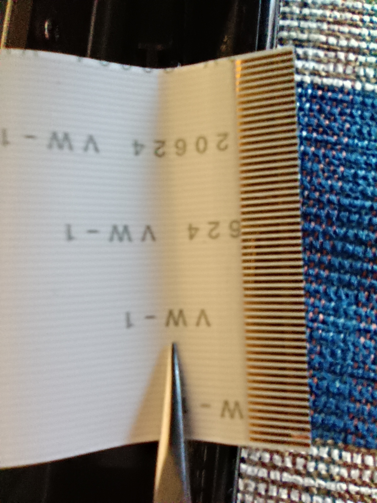

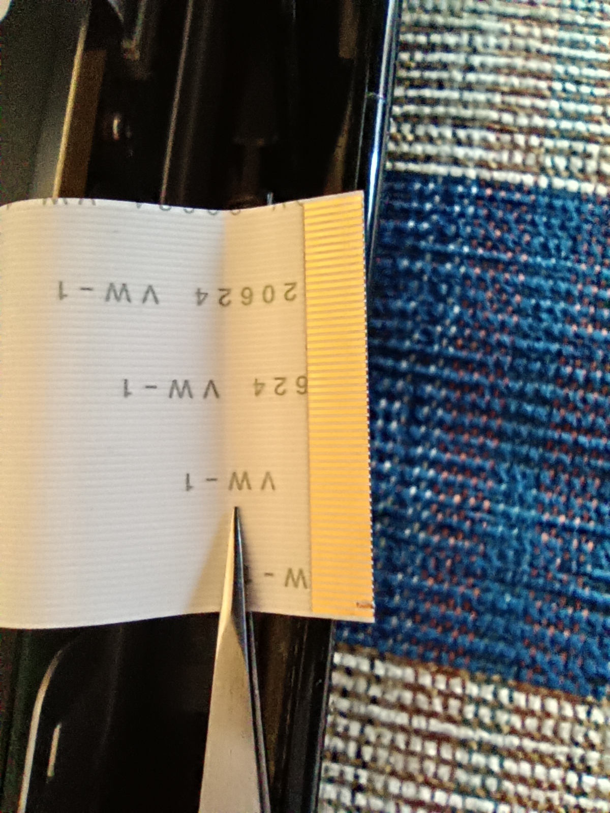

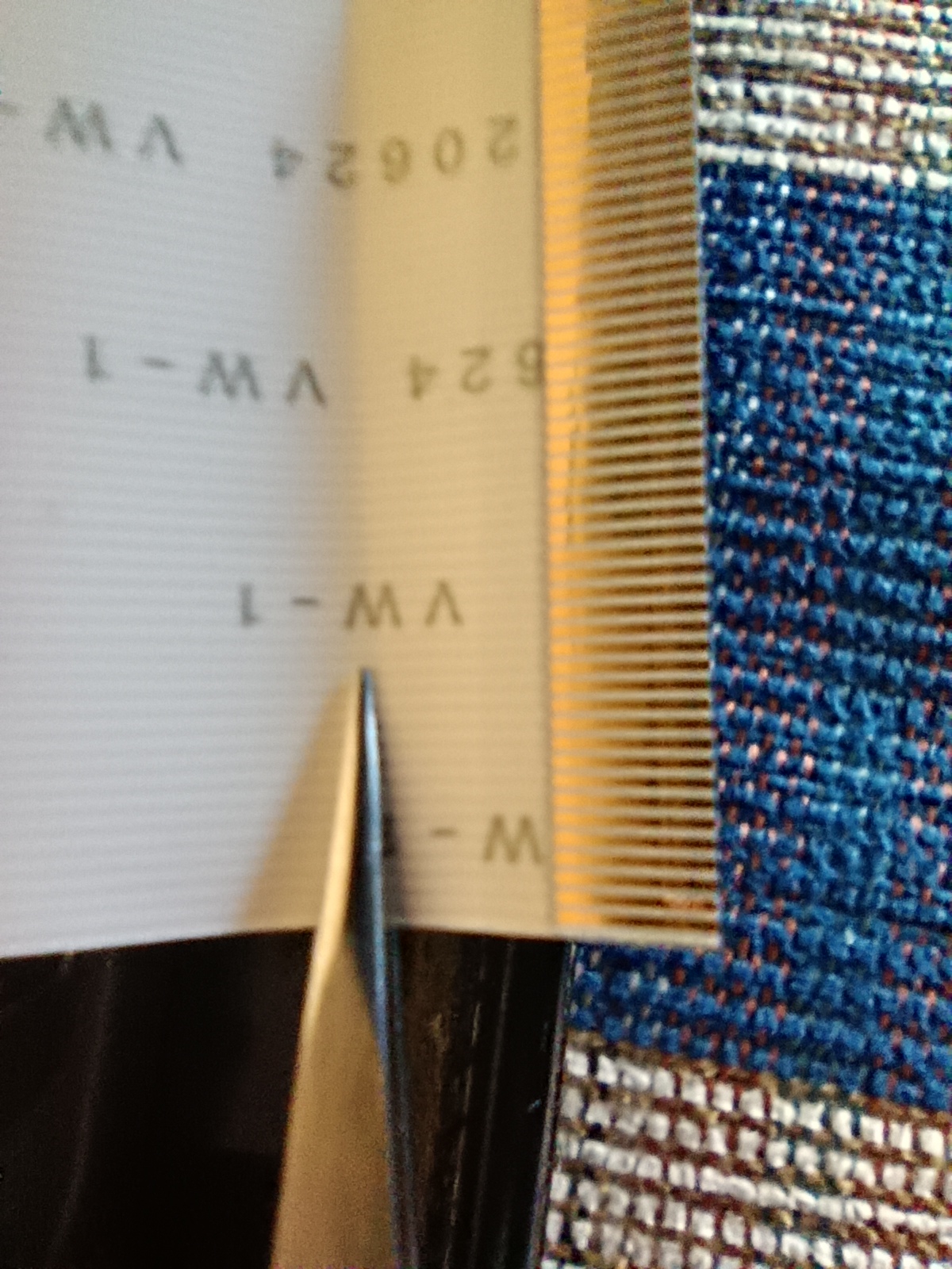

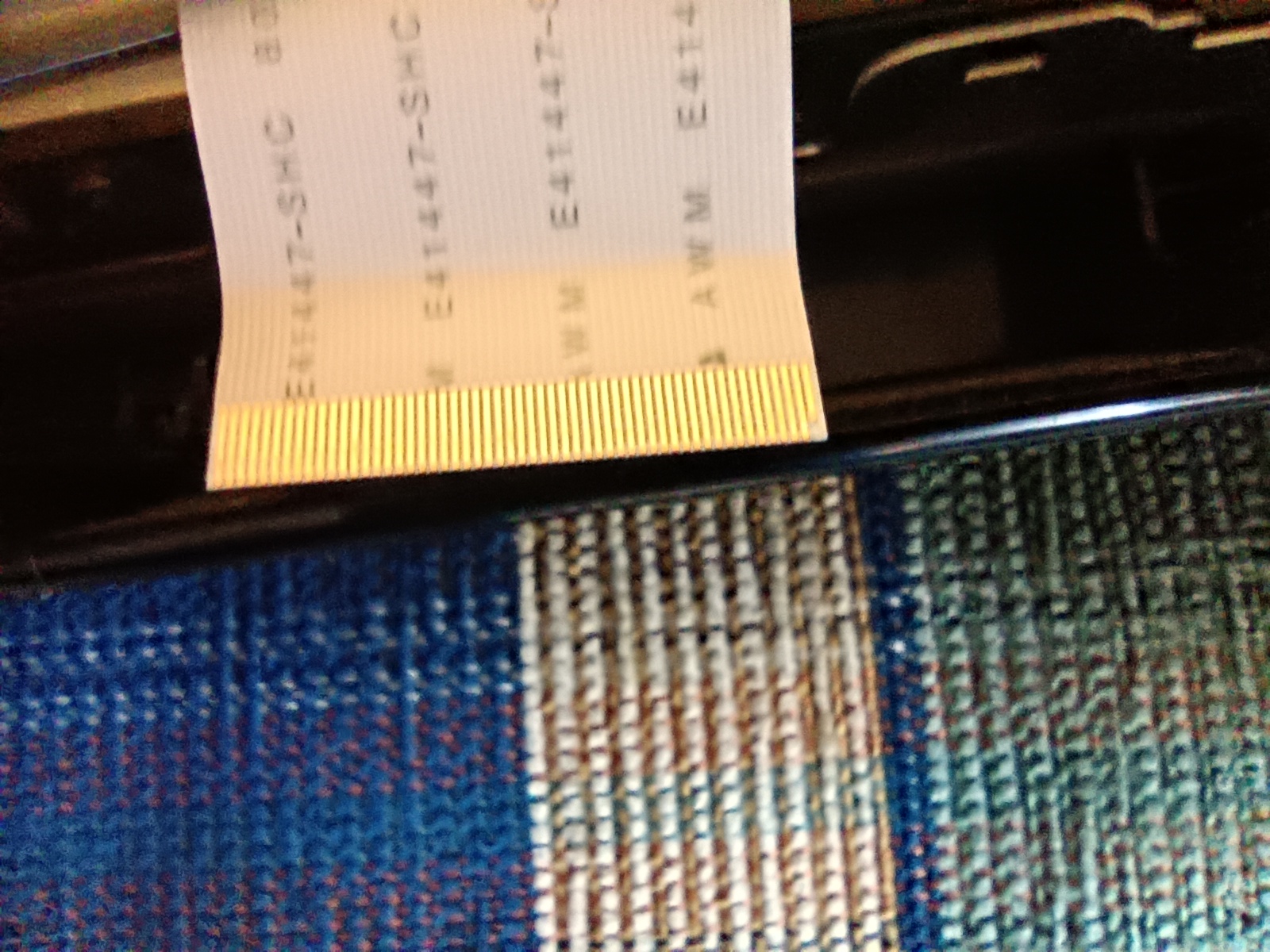

                            Ok so I looked at the ribbon cabbles more closely and did see something, two of the cables where damaged here are pictures. However I have suspision that I did this while trying to figure out what was wrong because it would be weird to me that because of these two connections half the screen is solarized. The cabble with damage on the right side is on the right side of the tv. I changed the capacitor on this board which one I cannot check right now and will only be able to do it on sunday evening/monday morning. I am starting to think about replacing the chip again...
                            • nomoresonys
                              • Jan 2013
                              • 12331
                              • U.S.
                              Well i have no confidence in those ribbon cables any more, replace both of them.
                                If cap you changed is on power board, that would have no effect on this problem. On the cables you can trim the ends a small amount.
                                  Can I actually just cut the of the damaged end and it will be ok?
                                  And a side note, how to search for a ribon cabble? Like should I just write the numbers and letters on my ribbon cables or do other parametres need to be specified?
                                  • dskall
                                    • Oct 2016
                                    • 2905
                                    • usa
                                    https://www.youtube.com/watch?v=ULwU...Repairs%26Mods
                                    • petehall347
                                      • Jan 2015
                                      • 4450
                                      • United Kingdom
                                      just cut off to good connections with sharp scissors
                                        Cut off the ends, nothing changed. Any other suggestions apart from replacing the chip again?
