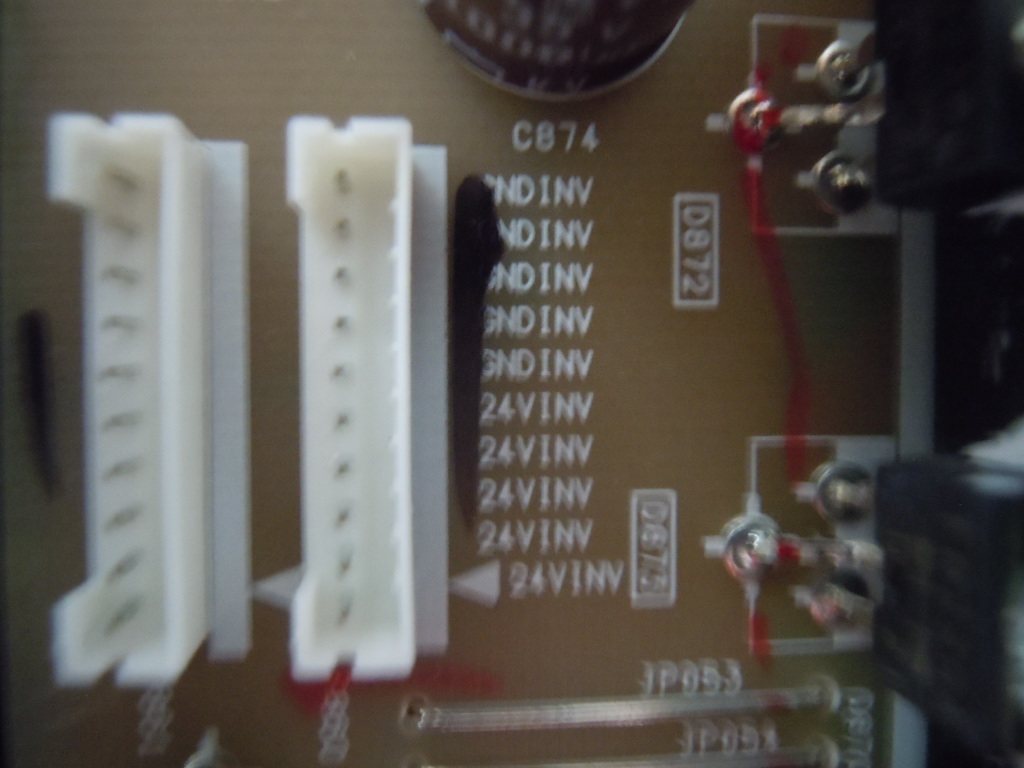

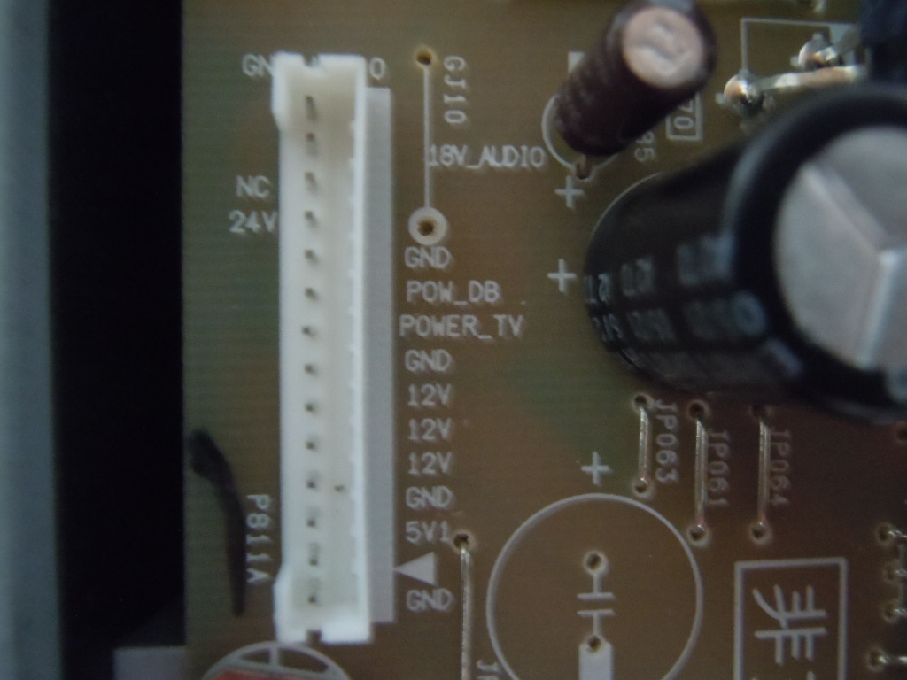

              Re: Toshiba 42RV530U Won't Startup
              Doesn't look like power_tv is your control from mainboard. Not familiar with these markings. It maybe just going to standby after a short time.
              Can we get pictures of your connector markings?

                        Ha. So, when I was pulling the cables off to take pictures of the connectors, I discovered a pin named "24v" that was hiding behind the wire bundle. So, my mistake, I do have 24v at that pin, in fact, 24.5v. I have it when I first plug in the TV or when I press the power button to turn the TV on. And it acts in the same manner as the 12v pins in that it slowly decays to 0v in about 10 minutes when power is turned off (or automatically shutoff by the TV). The pins that I never have 24v on are the ones going to the inverters (even if the inverters are disconnected) - those are ones I have been reporting 0v. Sorry for the confusion.
                        Here are pics of the power board pins.

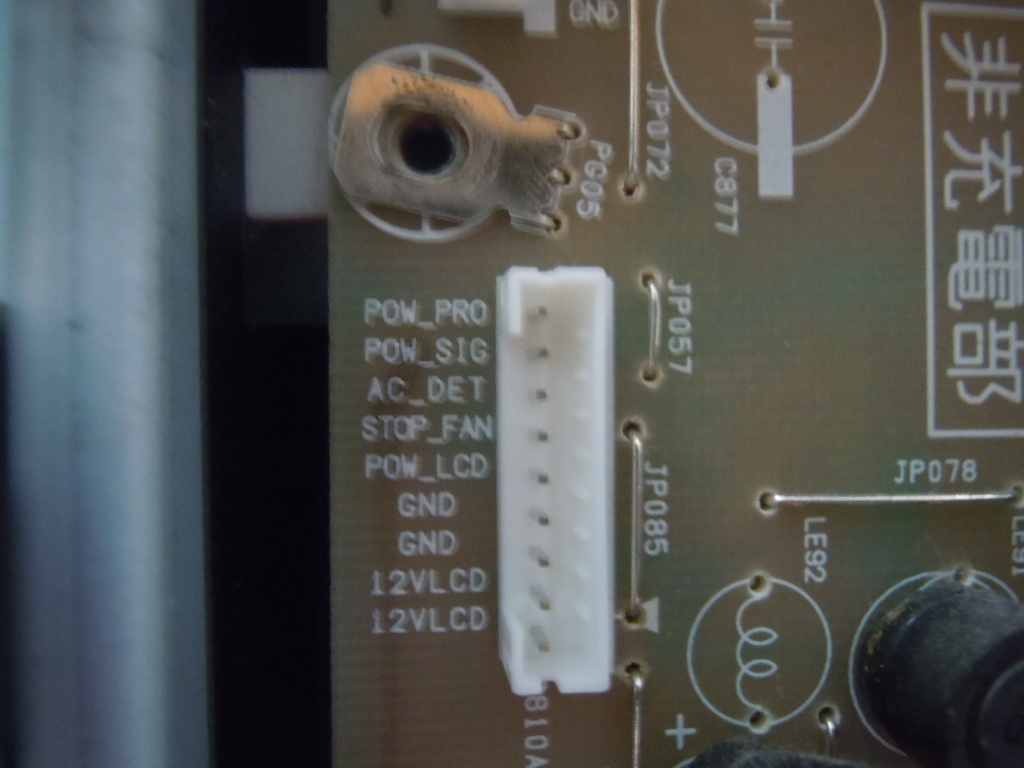

                          You could be right - there is a pin called "Pow_Sig", but I never see voltage on it. See pics.

                            The +24v for the inverter is controlled by the mosfet Q8880, This is turned on by the POWER_SIG (needs to he high +3~5v) There is however a protection circuit that may shut this signal down
                            Do you have 12VLCD on P810? if not try disconnecting the lvds cable to the t-con board and see if the 24VINV comes up

                              No voltage at 12VLCD. I disconnected the t-con cable and still no voltage at 24INV.
                              I wonder if there is a problem with the main board then if it is supposed to be sending the POWER_SIG signal? I still have the blinking yellow led happening at the front of the TV, so maybe it isn't "initializing" correctly (if that's the correct term). It's definitely sending the POWER_TV signal but not sure what that does (beside turn on the 24v/12v transformer).
