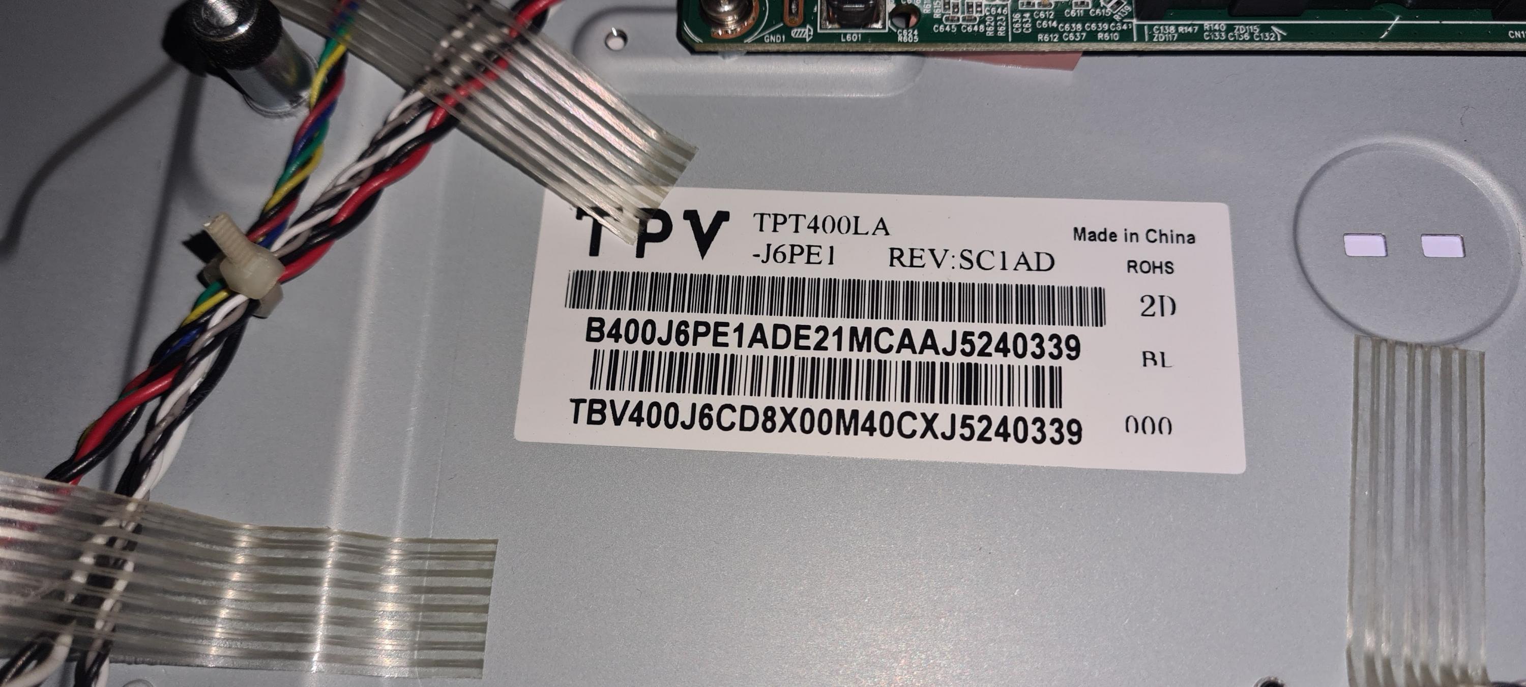

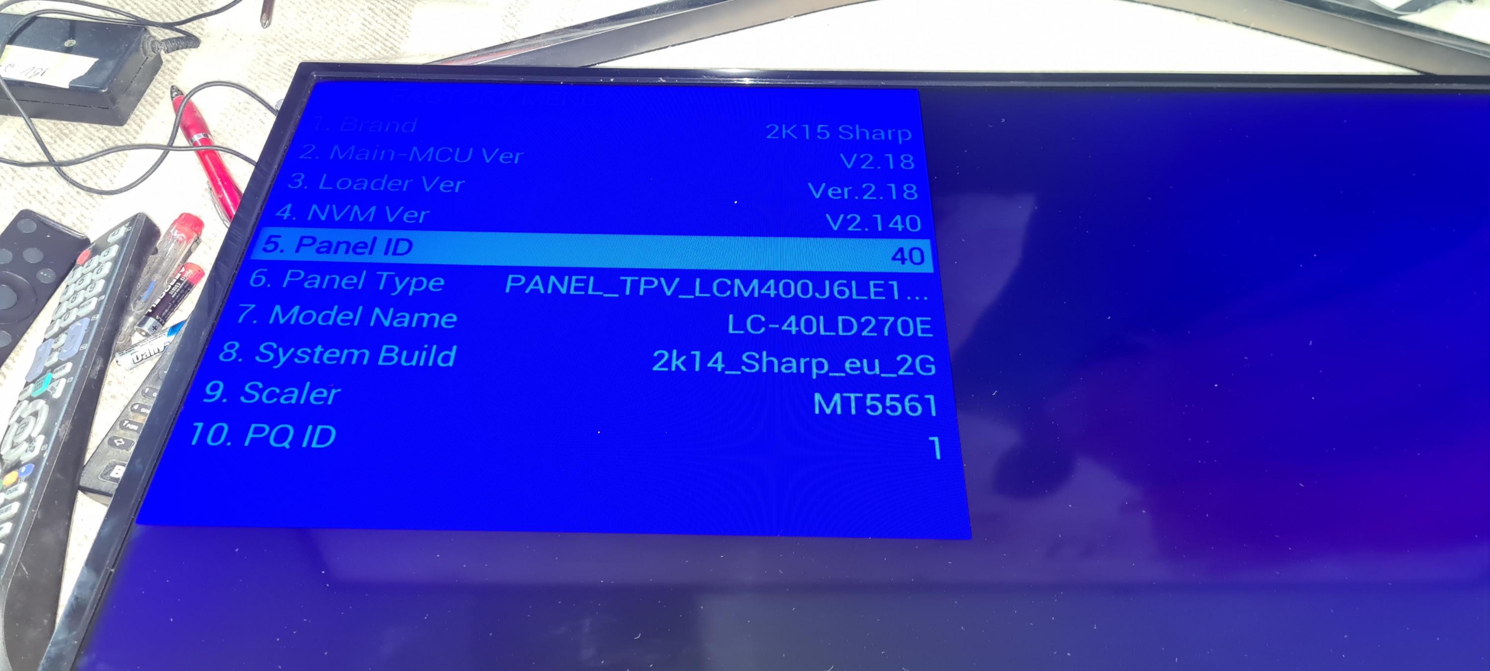

    Have this set with bluish content even OSD. I have tried factory reset from service mode using MENU > 1999 > PRE PR
    but same.
    Main board: 715G6826-M02-000-004K
    Any help please?

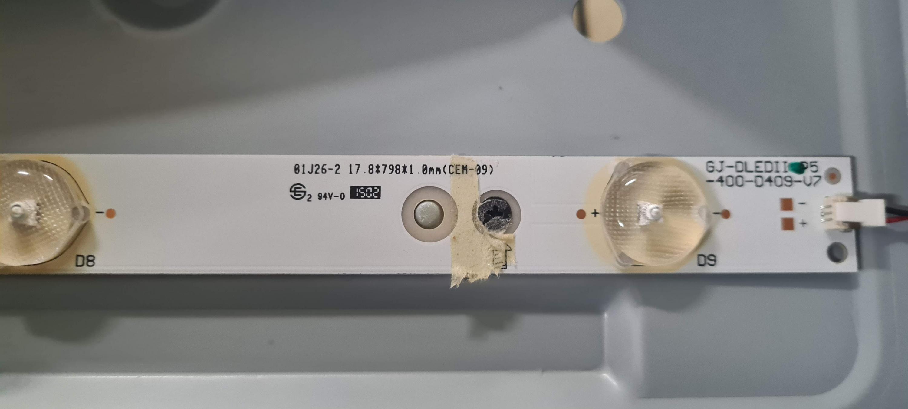

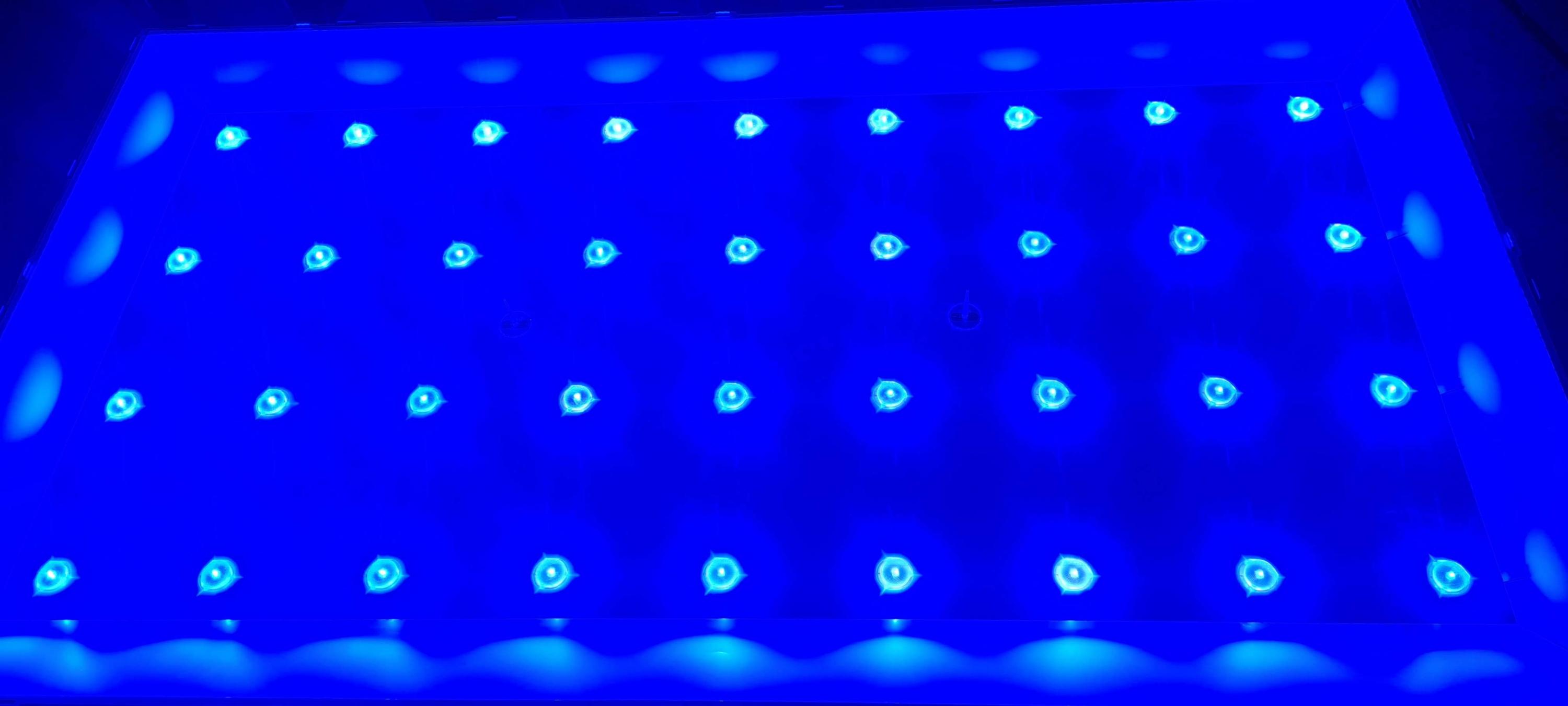

    Don't know if this is your issue but here's a recent thread with blue tinted screen: https://www.badcaps.net/forum/showthread.php?t=102700
    • alltvrepairs
      • Jan 2014
      • 211
      • Malta
      Re: Sharp LC-40LD270E bluish picture
      Yes defenitely LED problem... It is quite obvious. Cannot see why I didn't notice the backlights even from the back probably was too focused on the software issue.
      Client refused to repair. So I am going to try repairing as spare TV to lend to customers
