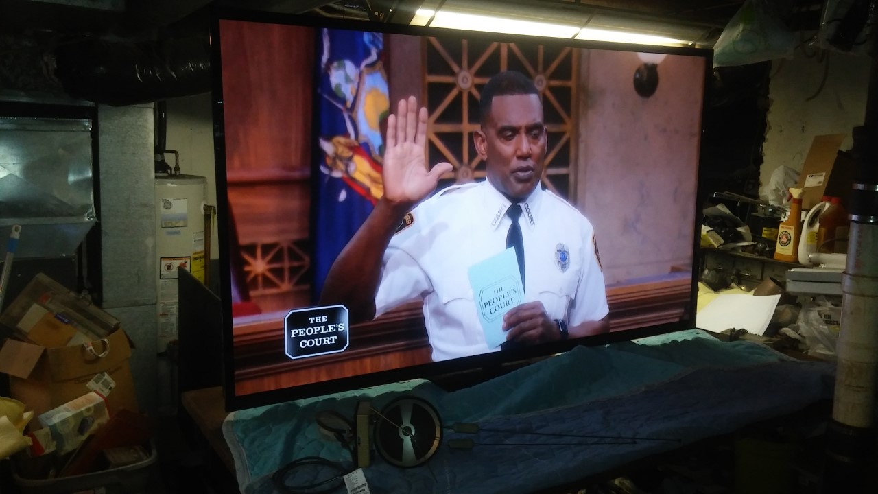

    After a long time sitting on side burner I decided to start working on this set again. I read the other threads on this model and found that my t-con was bad so I ordered the replacement mosfet and replaced it but the tcon still has no power at big silver cap. The tcon does have 16.9 volts at the fuse and at the component marked 100(coil?). Any ideas on what else could be fried on this board?
    Also I put a tcon from a e601i and the tv powers up with a picture however I read on one of the threads that the tcons from the E601(ZC) is different than the E701(ZH). Does anyone know what the differences are and if this tcon will ruin anything if I run the tv with it. I only had it running for a short time with it to check the panel then shut it off. Thanks

                    Update; it was an inaccurate meter, I tried another meter and the voltage was around 12v. I also found a bad solder joint on the tcon that I replaced the mosfet and that seems to work now. The set is working but with the main board from a 60"(E601i)set. The main board for this set(E701i) doesnt seem to be working, it did have red light blinking at the optical input but that has stopped. Is there any way to check and repair these boards?
