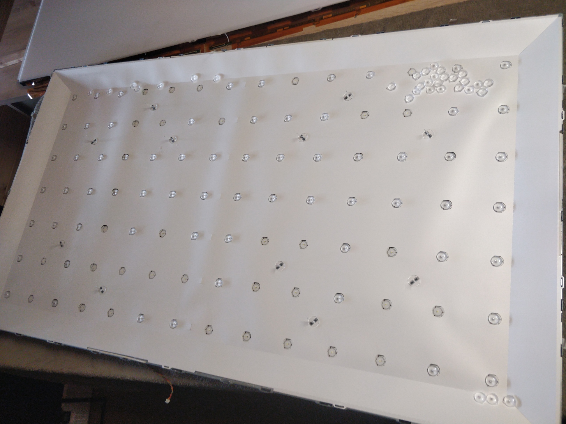

    Hello everyone!
    I need some help with identifying the LED SMD types on this TV's backlight strips.
    Two strips showing very little dim light, so I want to solder new LED SMD's on those, but I'm not sure which size of SMD's I need to order.
    I tried to find LEDs for this TV model, but I only found complete strips which are expensive:
    https://www.ebay.com/itm/274433220409
    Based on the pictures it's 3V 3535 or maybe 3528 LEDs?
    Like these:
    https://www.banggood.com/50PCS-High-...N&rmmds=search
    I want to make sure I order the correct LEDs but sadly I don't have phisical access to the TV at the moment so I can't identify it further.
    Thanks in advance!

    Desolder. Look at pads. Big pad and small pad polarity. Measure dimensions.

      I have a strip from a different Philips TV here and they are 3535, however the bit that lights is smaller than your banggood listing. Having the wrong shape/size could possibly cause an extra glow on the screen due to the lens shape.

        before 4 weeks i got Philips, with bad led.. i found 2 are burned.. they were with out zener diode.. i just have from other tv brand same as 3V with out zener diode cut them and stick them at the defect one.
        you have circle test point between each LED on the strip with them you can test which one defect.

                You can get them on AliExpress or cut up a strip to use.

                    It doesn't matter what the size is. Only the voltage. You are not putting them on the original pads.
