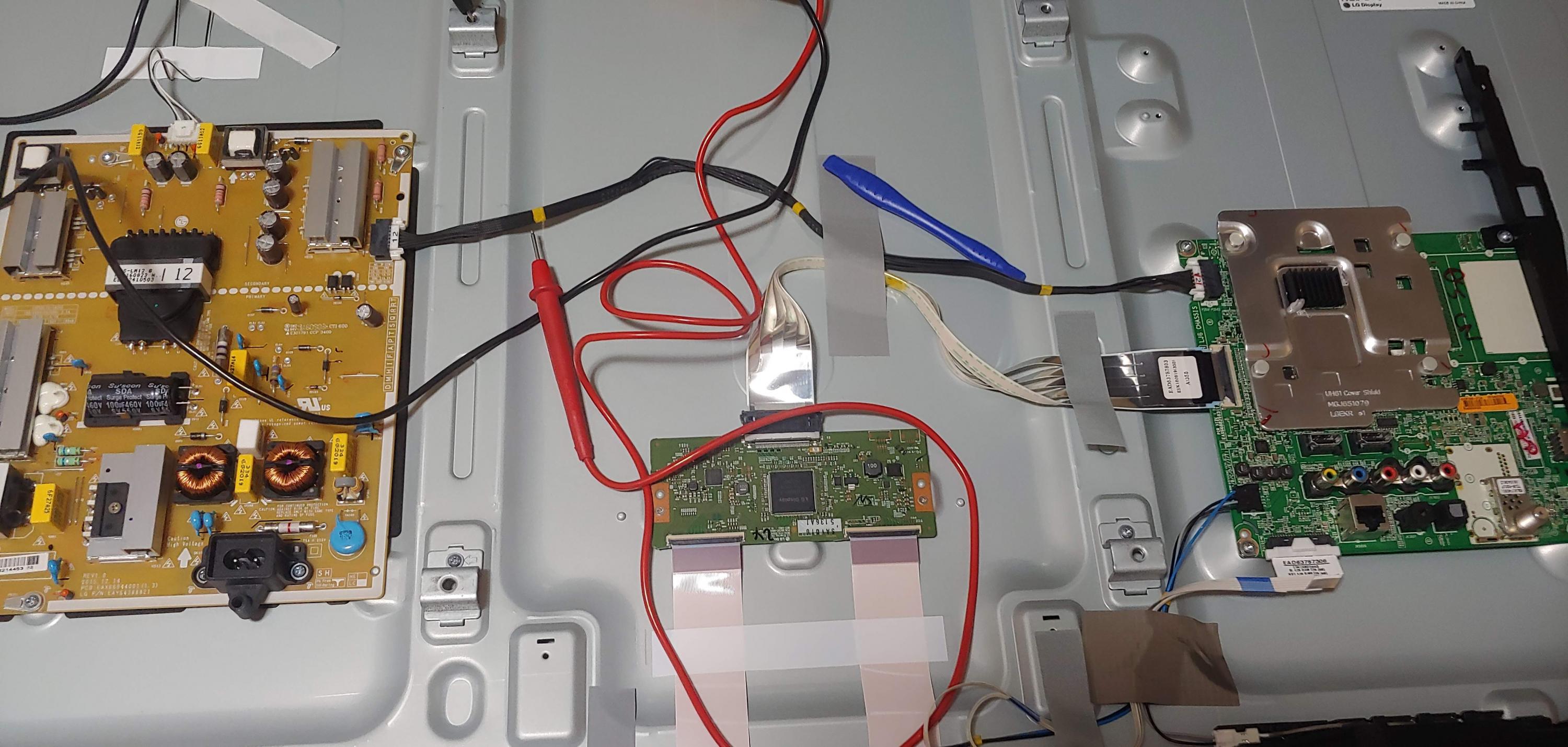

    Hey everyone I have a set here that shows 0 signs of life no light no backlight nothing. I checked the psu and its outputting 3.5v and the leds are working fine as well tested with led tester. Main psu fuse is good as well so I'm starting to think it may be the mainboard actually but I'm not sure can you guys help me out here?
  • diif
    • Feb 2014
    • 6978
    • England
    Re: lg-55UH6090-UF DEAD NO STANBY LGHT
    Measure all the voltages at the connector, there is a legend giving their description.
      Yes all the voltages are fine on the psu standby is like 3.5v and when the led cord is unplugged it gets 177 v when I plug the connector back in the led voltage is back to 0.
        Now it seems to be getting 8v out of the 3.3v line? I'm a little confused at the moment. why would it be getting 8 v when it should be 3.3? Tell me I'm not crazy I hope the board readout is 3.3 but now it looks like 13.2?

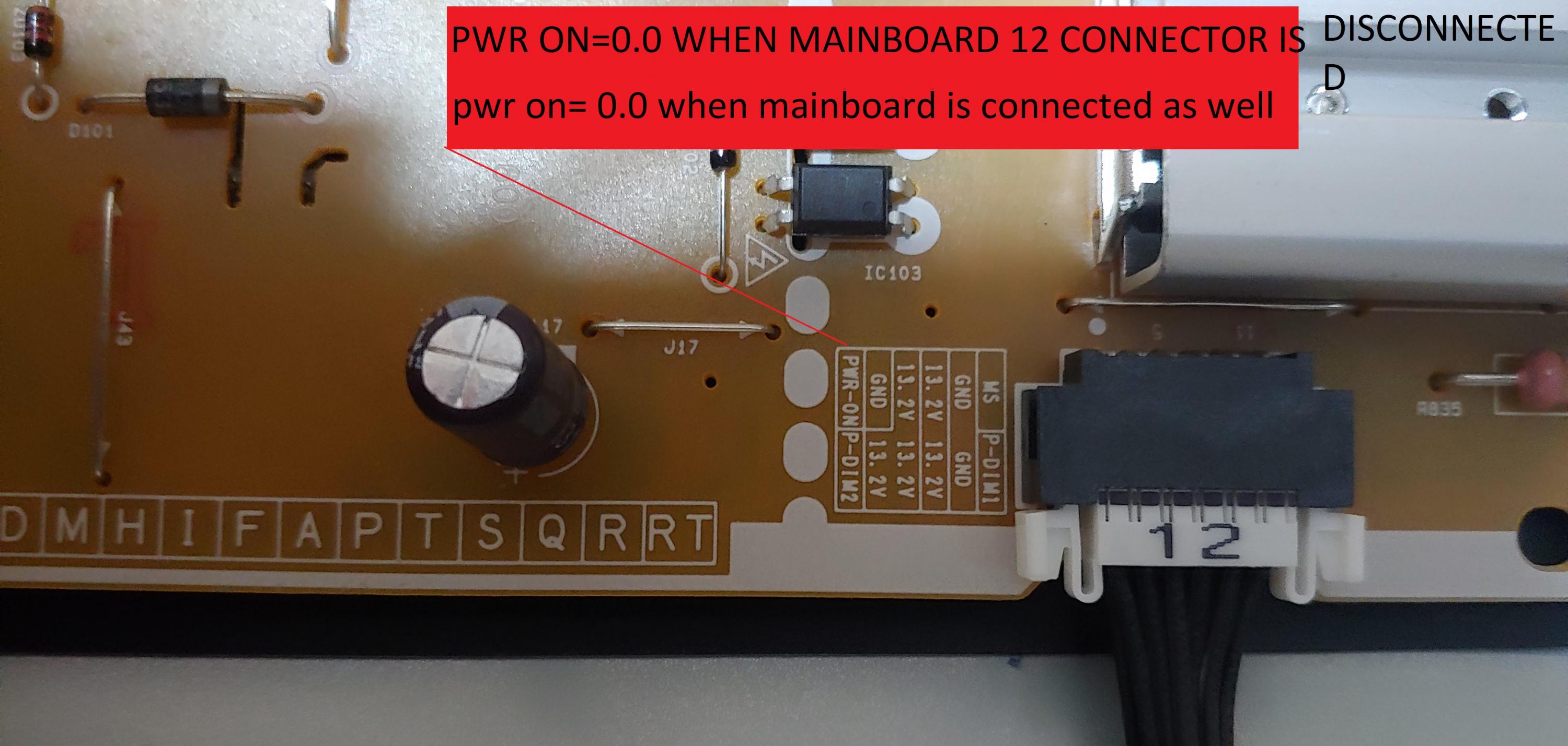

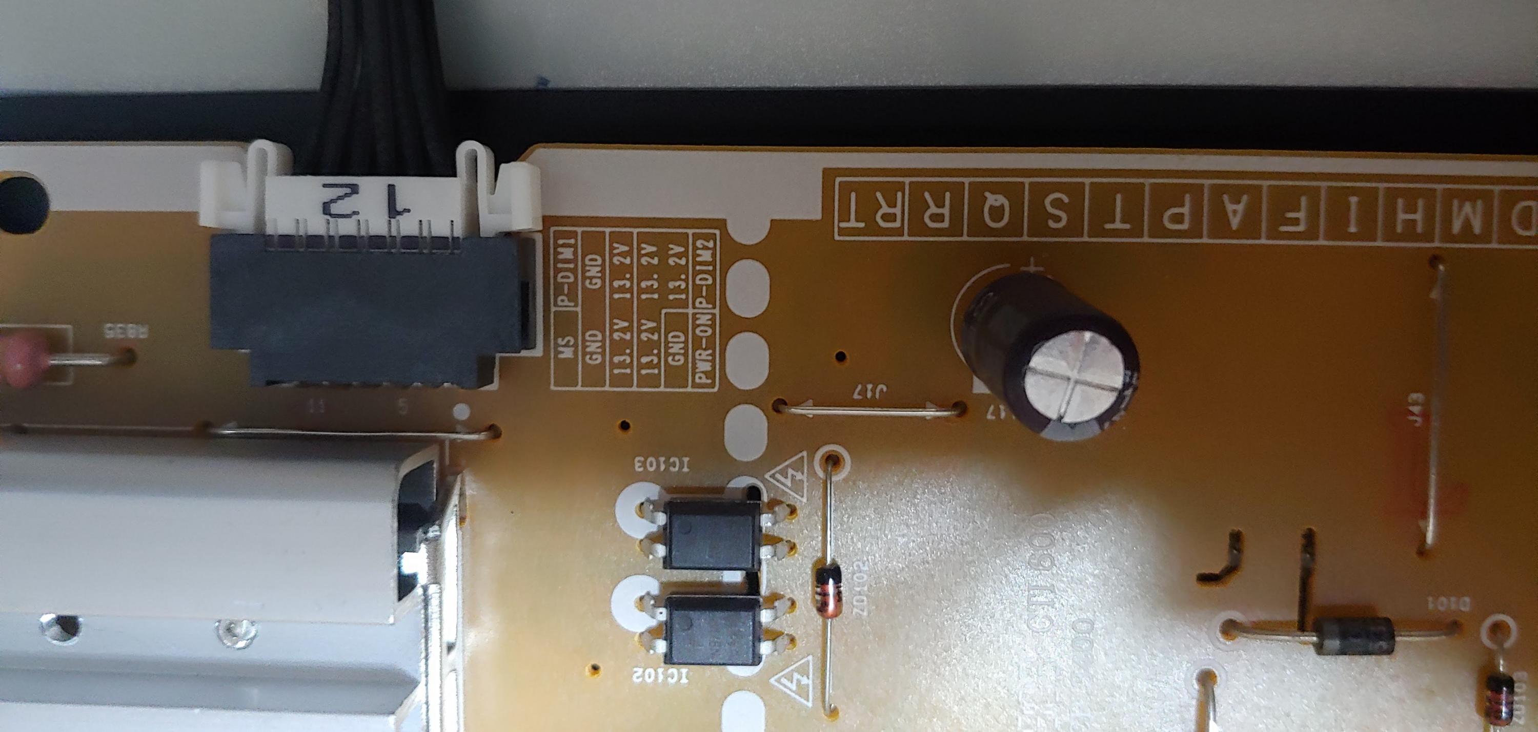

                Mainboard disconnected 8volts boys. How do I test for the psw_on signal? I don't even get the red standby light on the tv like the motherboard is getting power.
                    With main connected you should get a change in voltage at psw_on when you push the power button.
                      So its 0.0 with it unplugged the mainboard and 0.0 with the mainboard power connected as well no difference as well as pushing power button made no difference.
                            Pwr_on is 0v. So you need to supply it with around 3v

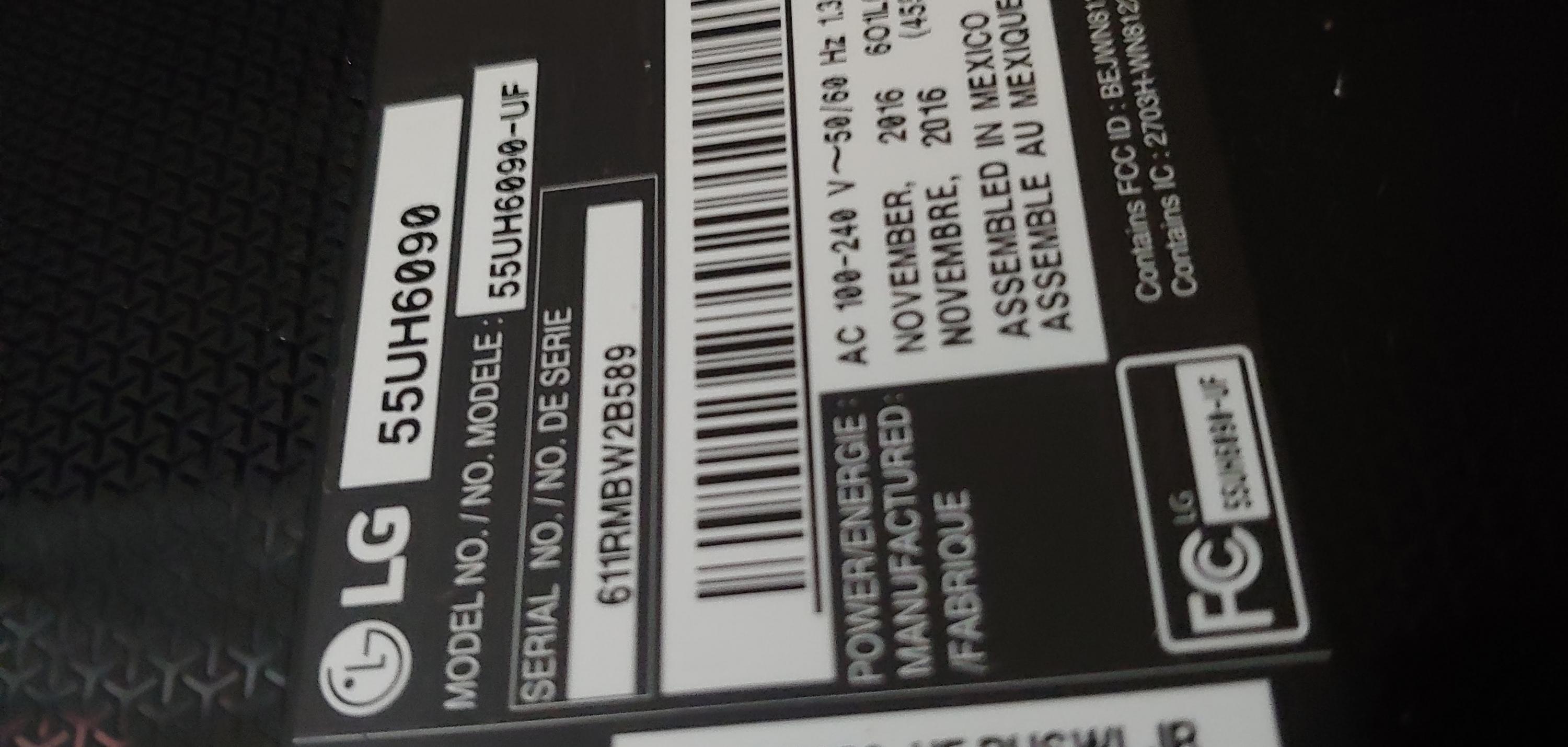

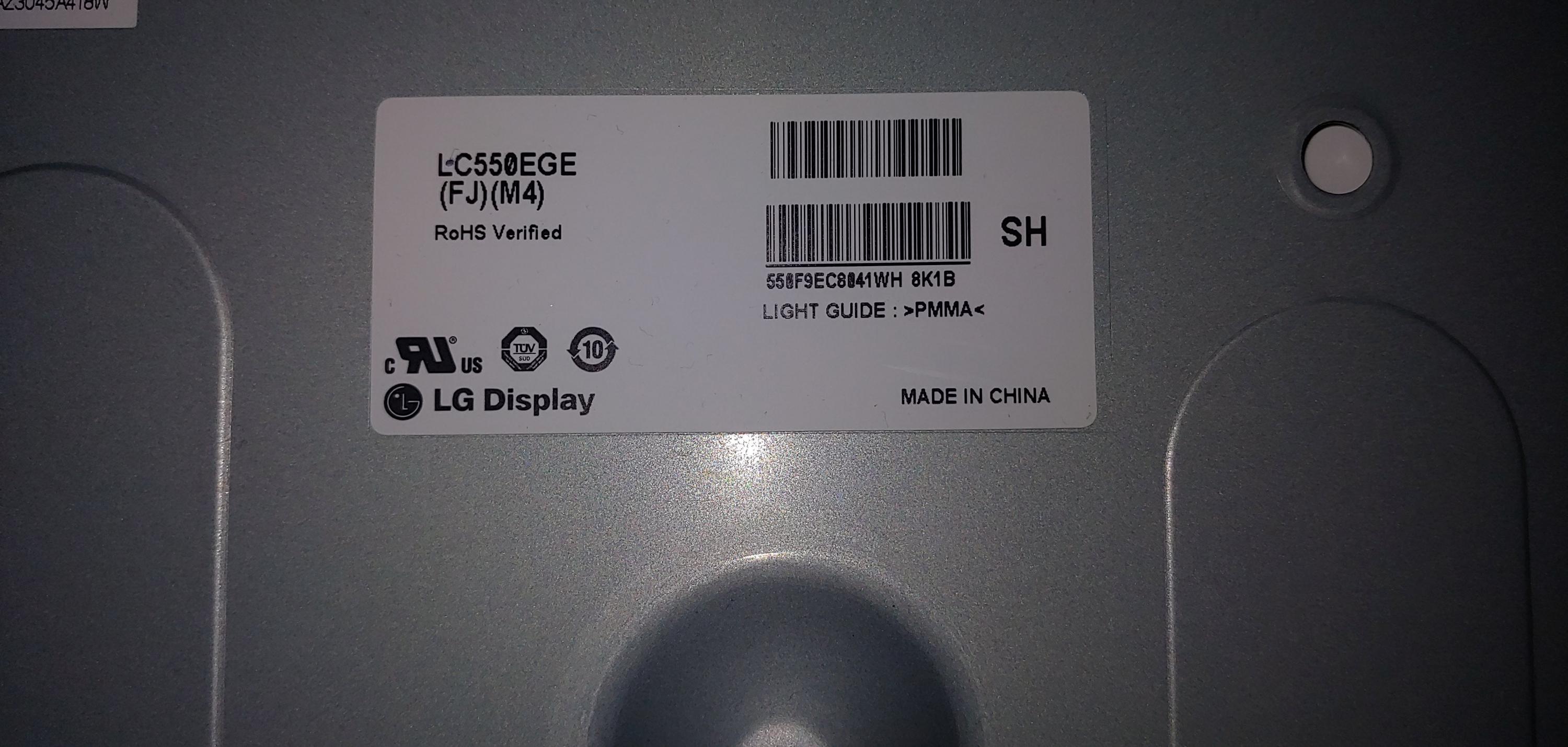

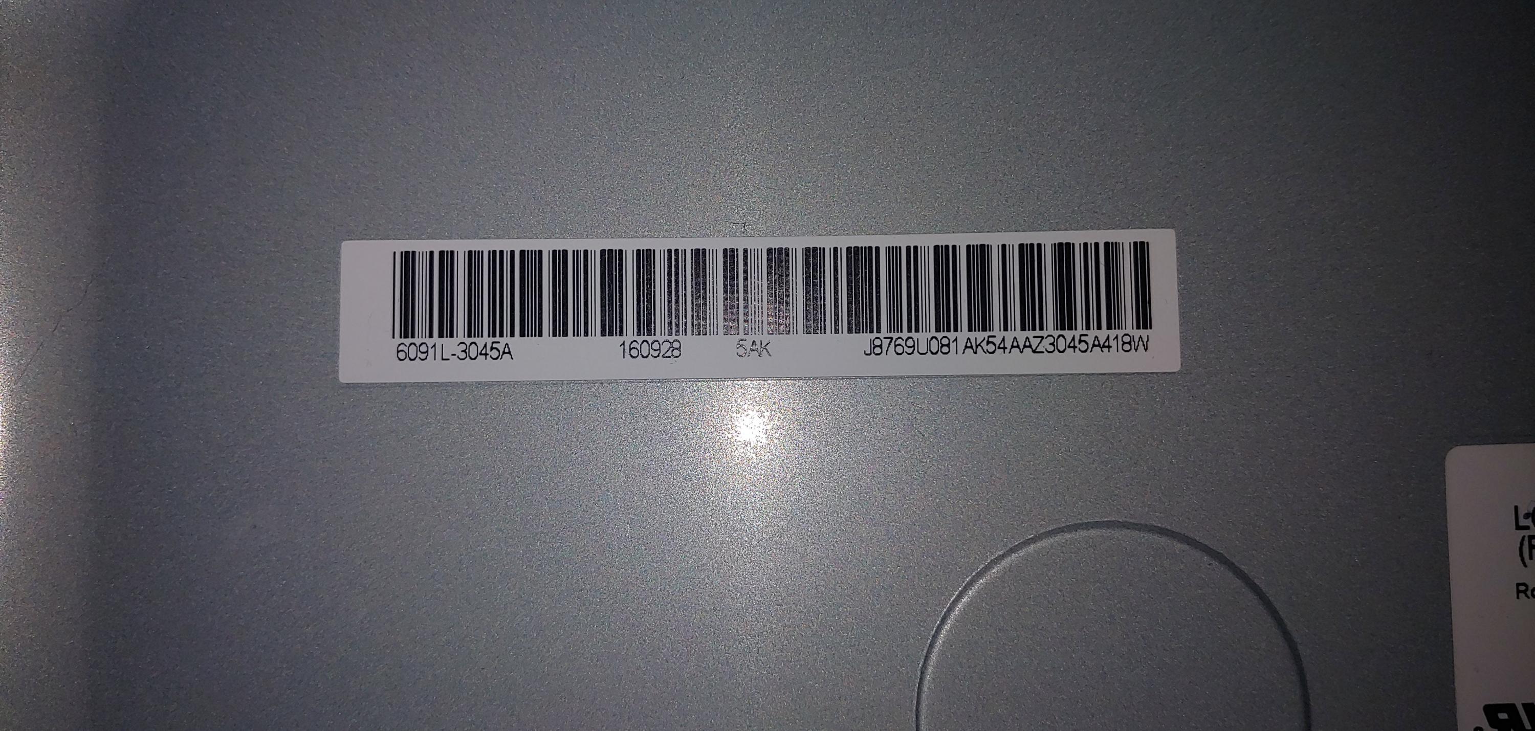

                                Here's The issue I have the led panel # in the pictures can you guys tell me what number will get me a new led strip on ebay instead of taking the panel apart first?
                                • diif
                                  • Feb 2014
                                  • 6978
                                  • England
                                  Sticking the model number of the TV into ebay or Aliexpress will show you that there are two strips.
                                    I bought some led strips 6916L-2318A so I will give you guys an update when those arrive.
