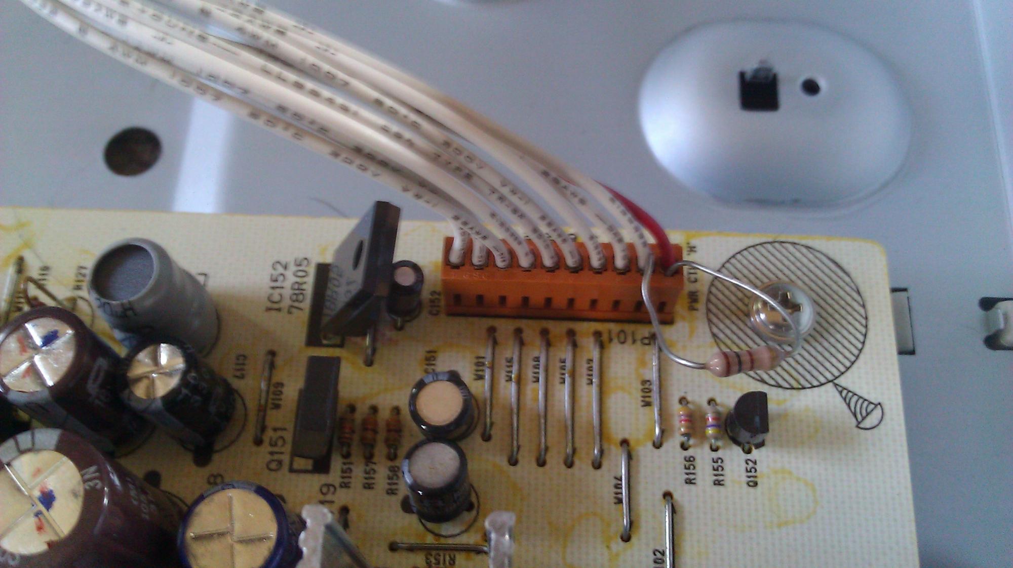

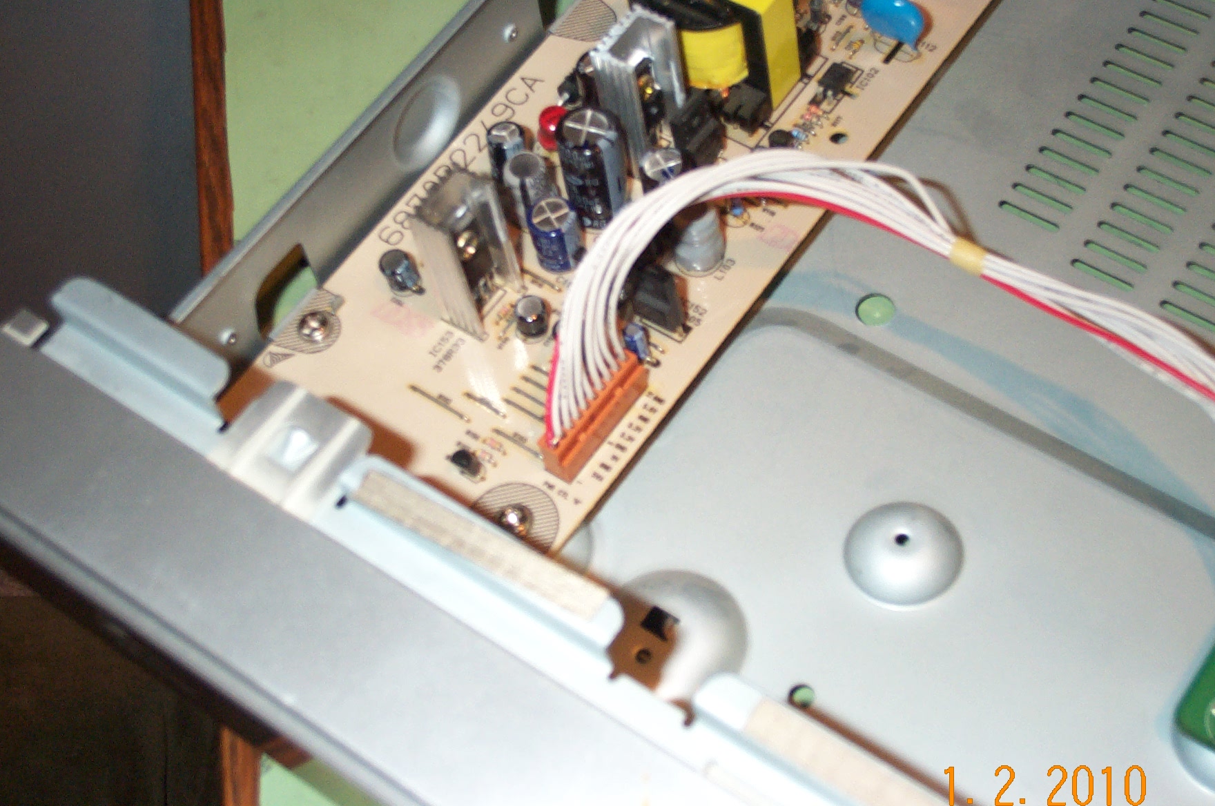

    If you have a Zenith HDV 420 HD STB and all you have is the red standby light which will not turn green, this is the workaround. Jumper the red wire going between the power board and the main board to the gray wire right next to it.
    The limitation of this fix is that if you ever hit the power button, you will have to pull the plug and plug it back in before it will give you the green light again.

    I am curious what the red and gray wires you have jumped together are labelled as on the powerboard. I can't make it out from the picture. I don't want to jump to any conclusions without understanding why this "fixes" the problem but it may not be such a good idea to override any safety features that have been designed into this tv.

      It is actually a set top box to be used with HDTVs that don't have an HD tuner built in. This workaround is just tying 5V or whatever into the "wakeup" wire. I don't recall what exactly they are labled. I think it has more to do with energy saving than with safety. I think this prevents the power supply from going into energy saving mode and shutting down certain power circuits.

                    This worked perfectly for me. My HDV420 won't turn on either and replacement boxes are expensive. I used a small resistor that I had around the house to make the jumper. Picture attached.

                      Thanks for the feedback Scotcho. You are smarter than me to use a current limiting resistor for safety instead of a jumper.

                                  Thank you gfgray and Scotcho! This worked for me. Thanks for the pictures, they really helped.
