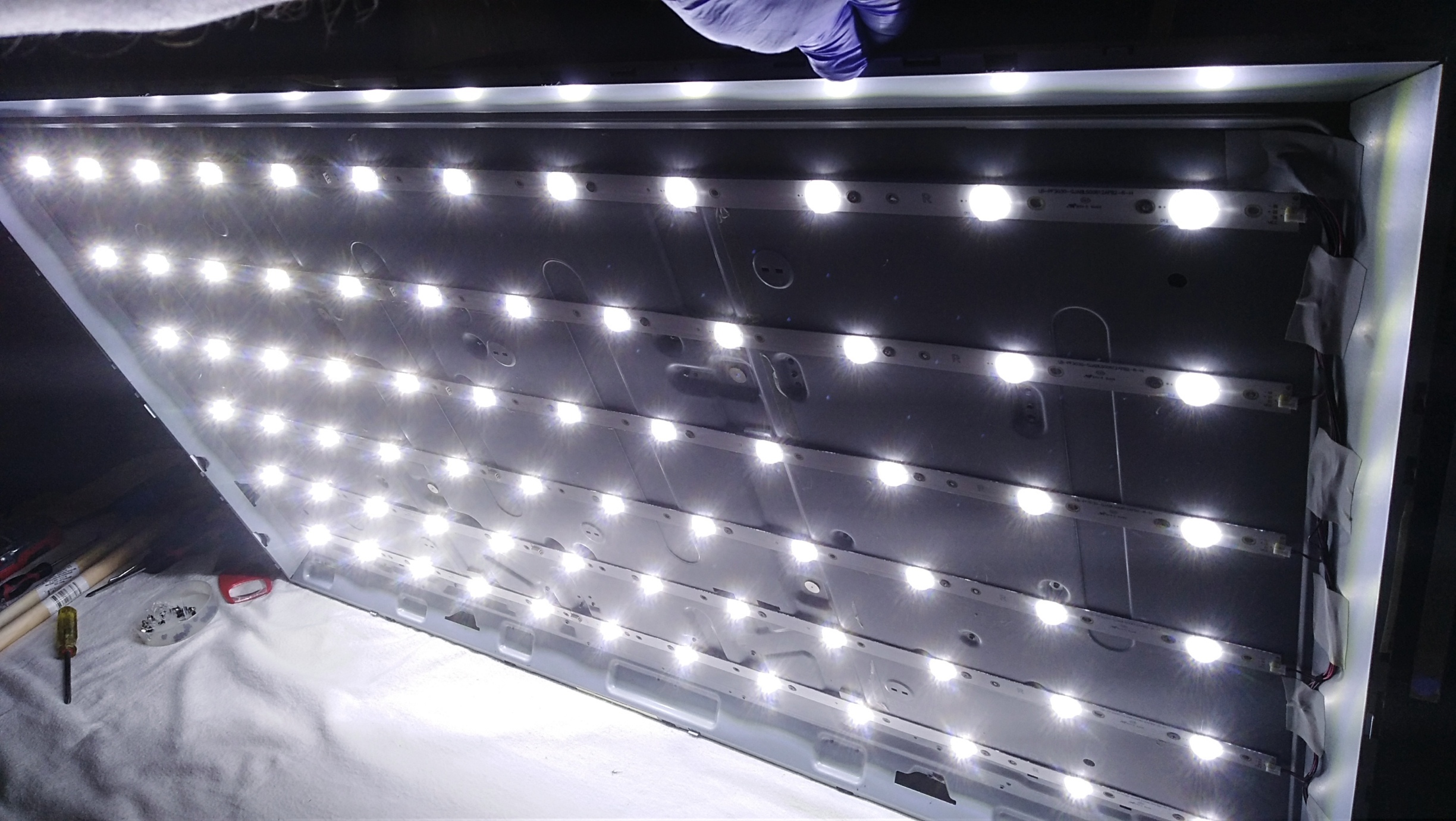

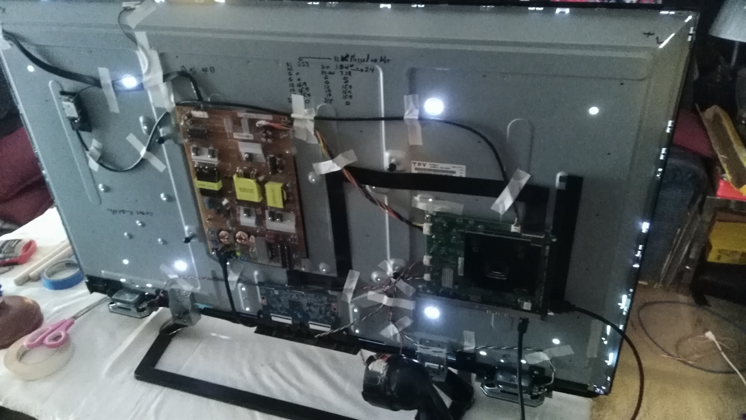

    Plug to AC, small blue power indicator light at center bottom illuminates. Only using flashlight test, Insignia emblem in center of screen for 90 seconds and then nothing. Power button pressed and still using flashlight screen test, the entire Roku, 4K menu is shown. Never does the back light show any light., even in dark room.
    Boards are these: https://www.shopjimmy.com/insignia-n...-1182036900530
    wifi unplugged

    Backlight issues are 99% the backlights themselves. If they fail open circuit, then you won't get a flash. Best tool for troubleshooting is a LED tester.

          The thing that bothers me is that D8616 and D8614 heat sink is stone cold and so is the heat sink for Q9103. Pls zoom the SJ pics referenced and advise.

            Let's put it this way... I have had 30 or 40 of that Model come through my place and 100% of them had burnt out Leds. Confirm yours with LED tester?

                With backlight failures, it is best to replace all the strips with new. Looks like they are available for you model and not too expensive. All the LEDs have wear and they will eventually fail. Just had a Sharp 50LB come back almost at the two year mark with the bad LEDs replaced with used strips and the backlight turned down.

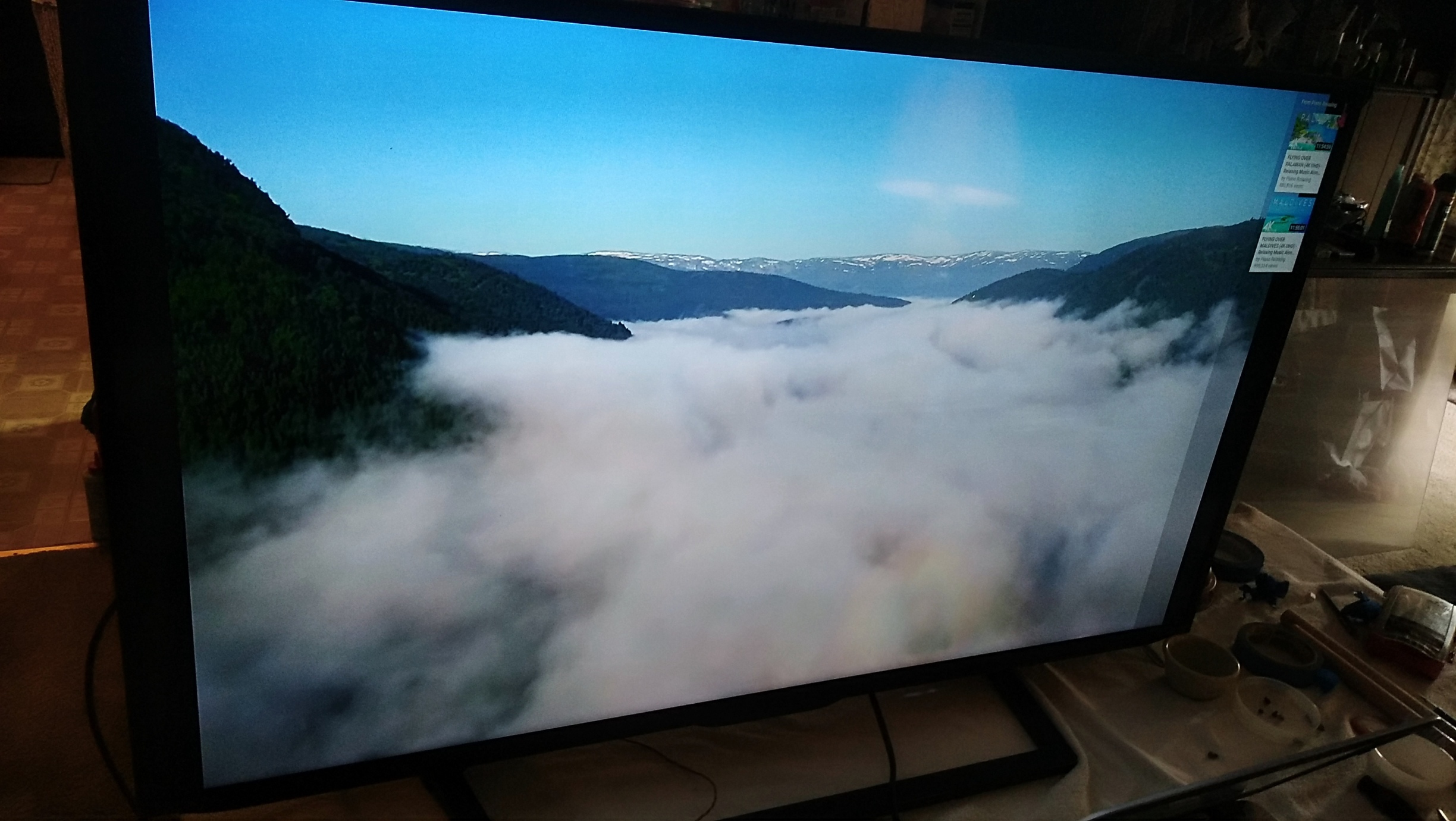

                          Got all new backlights from Aliexpress for $26.03, installed and works perfect. Mark as finished. https://www.aliexpress.com/item/1005...3da24c4dCboxKg

                              Yeah I thought about that and for less than $27 I decided to replace ALL the whole strips at the same time with these new ones and forget the hassle of doing individual ones, especially since the old ones were likely to fail soon too.
