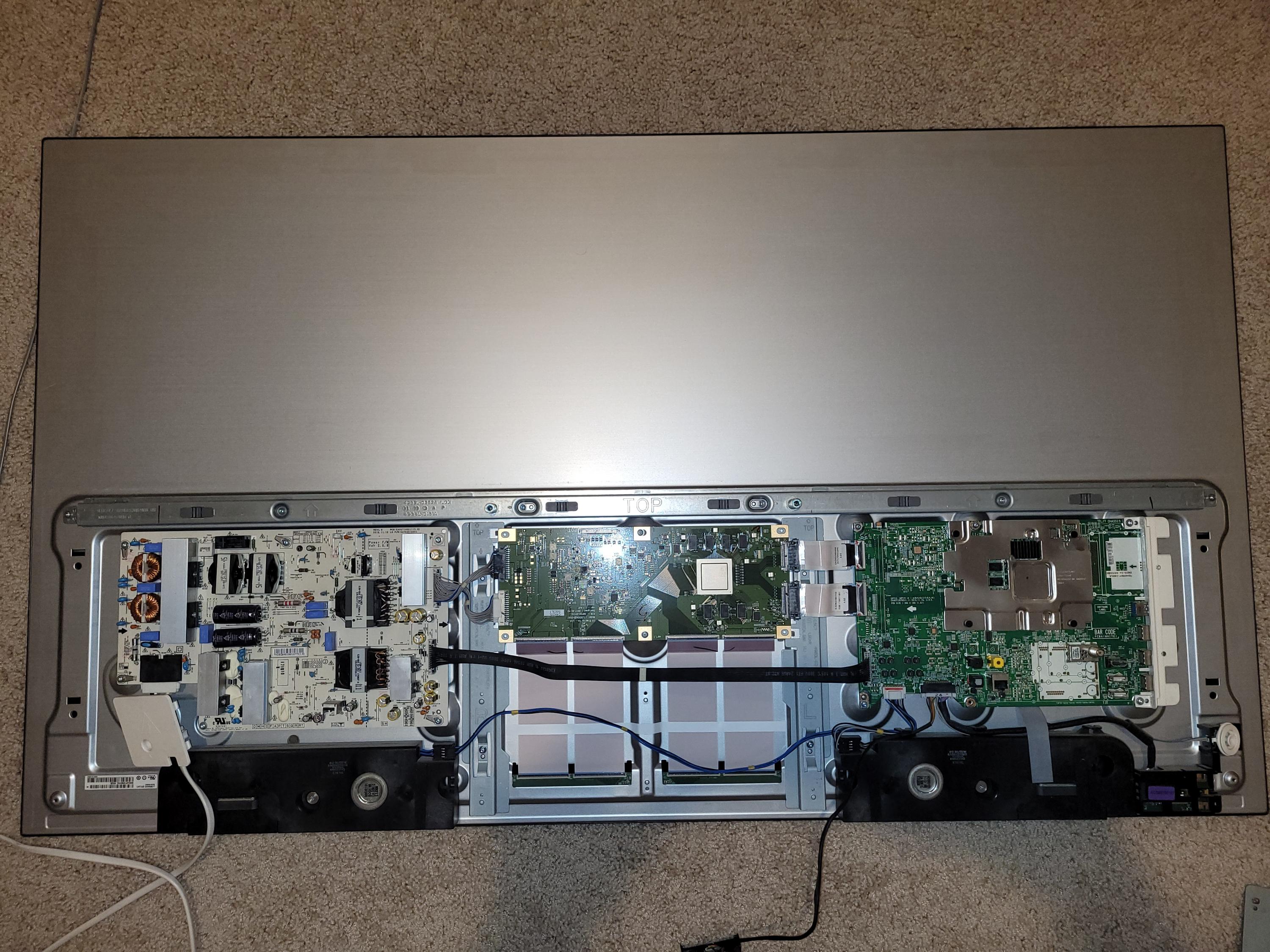

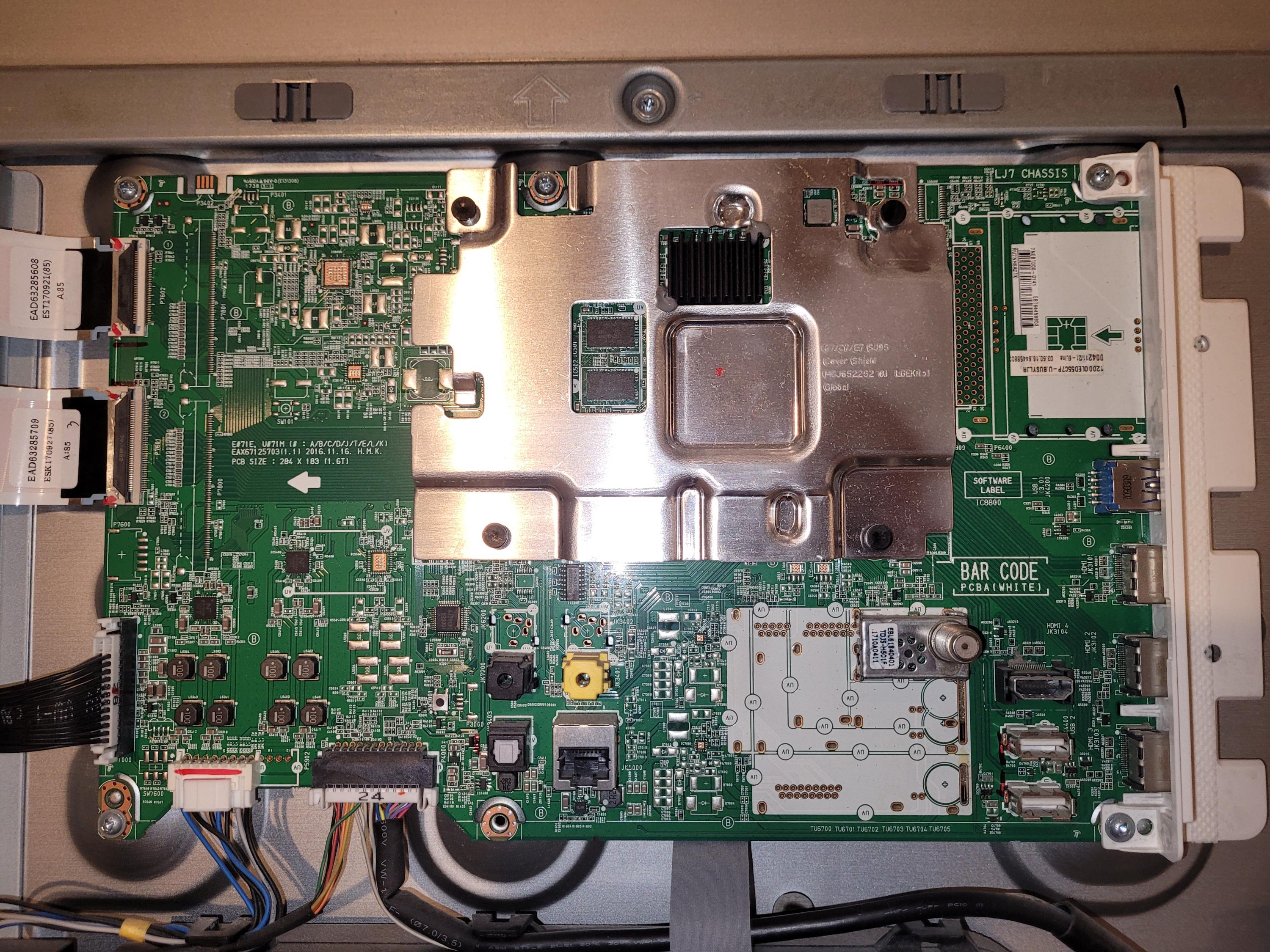

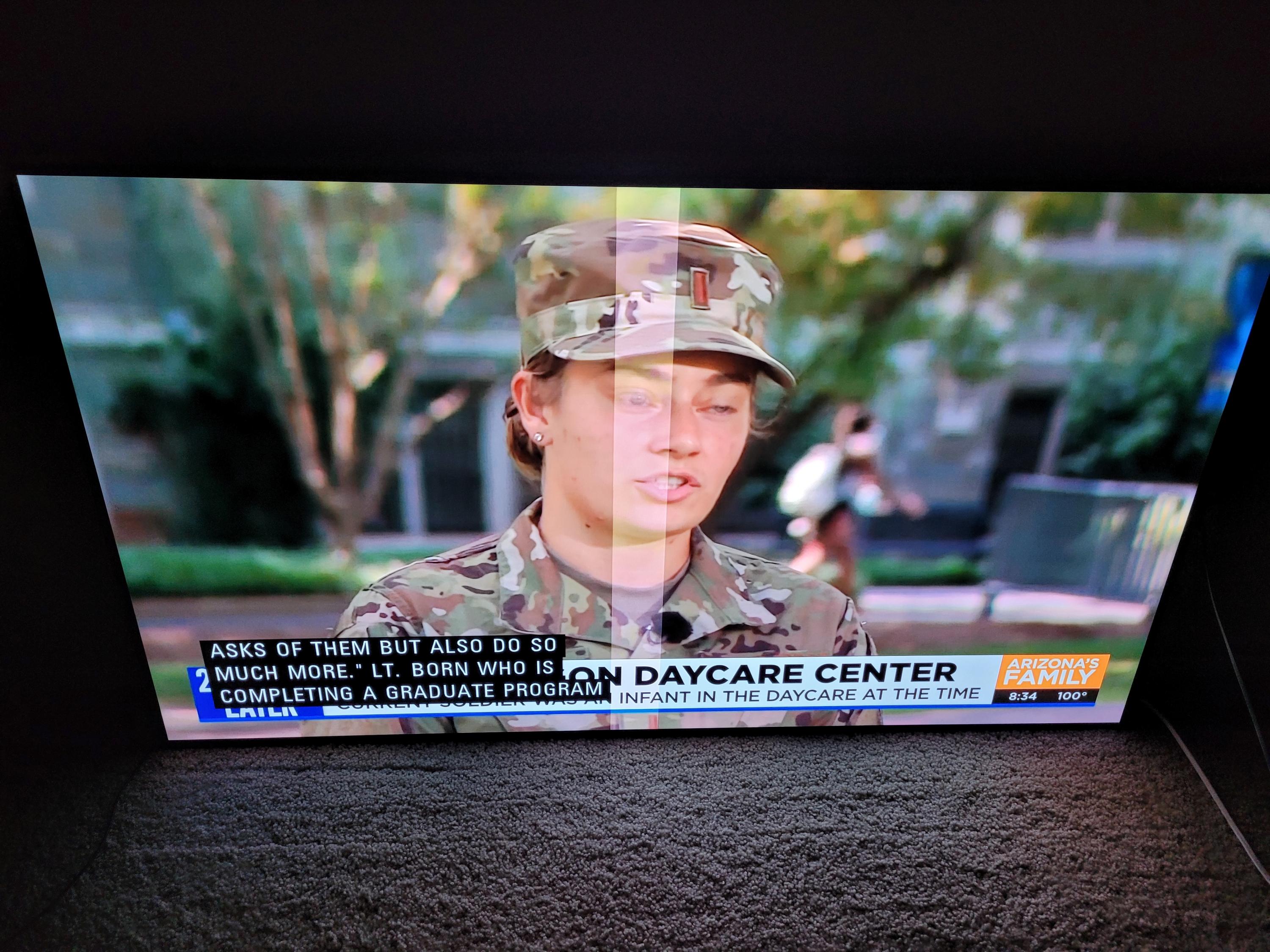

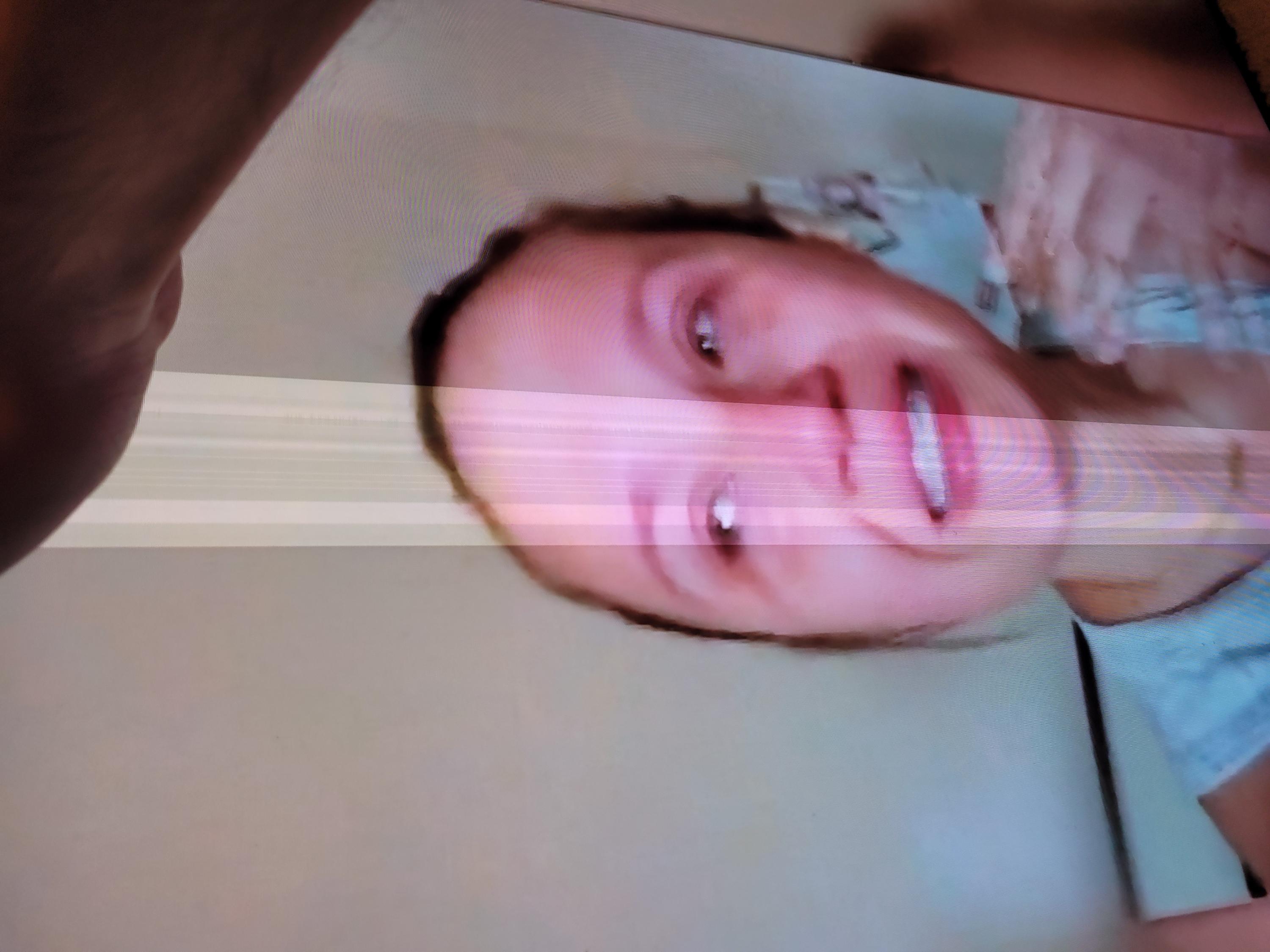

    Hi All!
    I have this LG OLED55C7P. Someone gave it to me stating that it would no longer turn on. I plugged it in and it turned on right away, ran it for a while and everything looked good. Gave it to a client of mine and that same day he said after watching it for an hour it shut off, so I had him bring it back. Now, it has a vertical white bar (see pics) and will randomly shut off - sometimes after an hour or two, sometimes after a few minutes, sometimes after a few seconds. I noticed that initially the white bar appeared solid, but now it looks streaky.
    Looking for help with diagnosis. Do you think it's a bad panel? Bad t-con? bad main board? Thanks! --Dave

    Re: LG OLED55C7P Vertical White Bar and Randomly Turns Off
    Looks like a panel problem, not repairable.

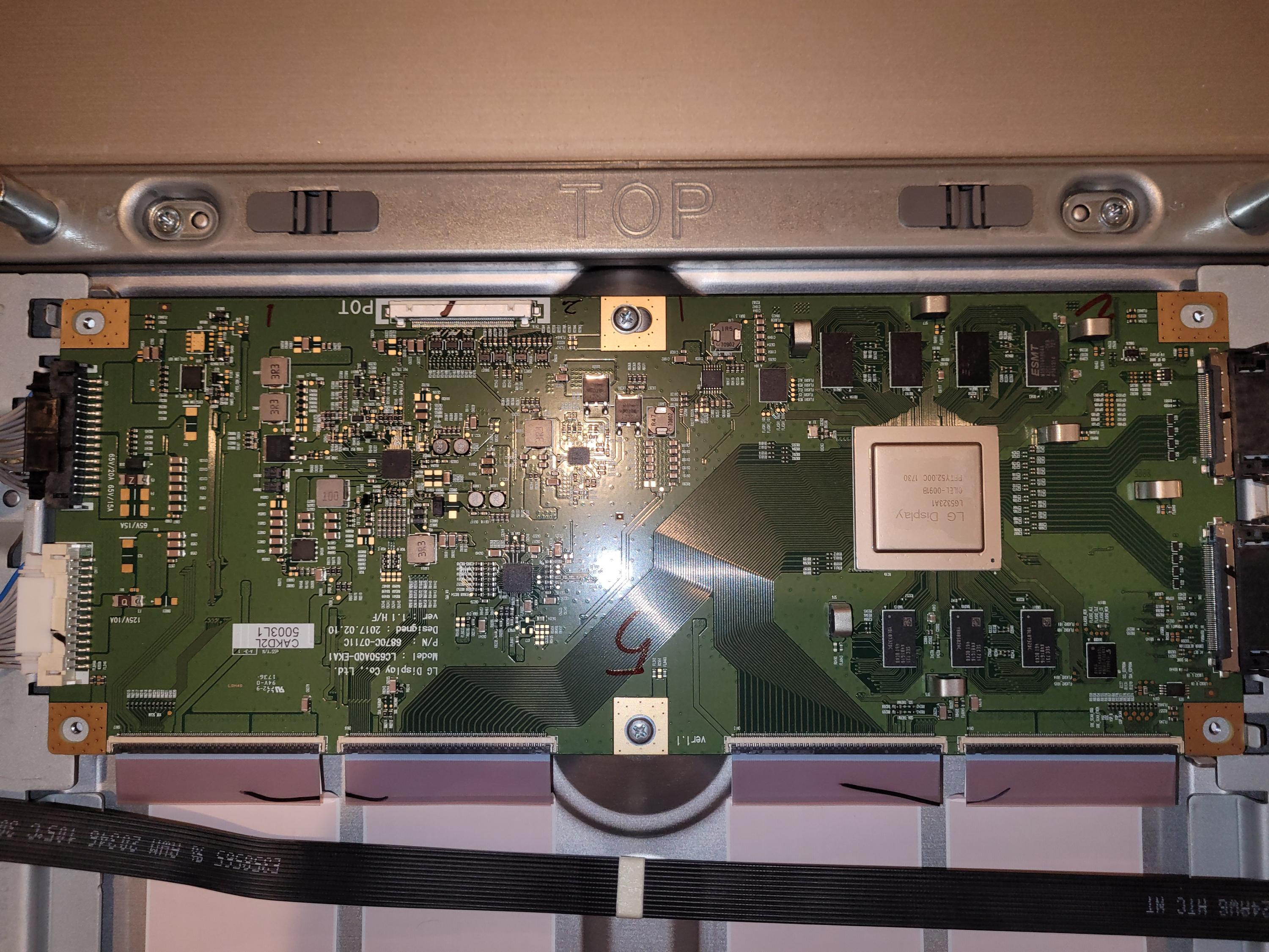

      Are there any cof chip attached on the panel? if yes put an hard shim of wood under it and try to reflow under the chip.. this apart i think you also have a semi short on the video board (i don't know the real name)

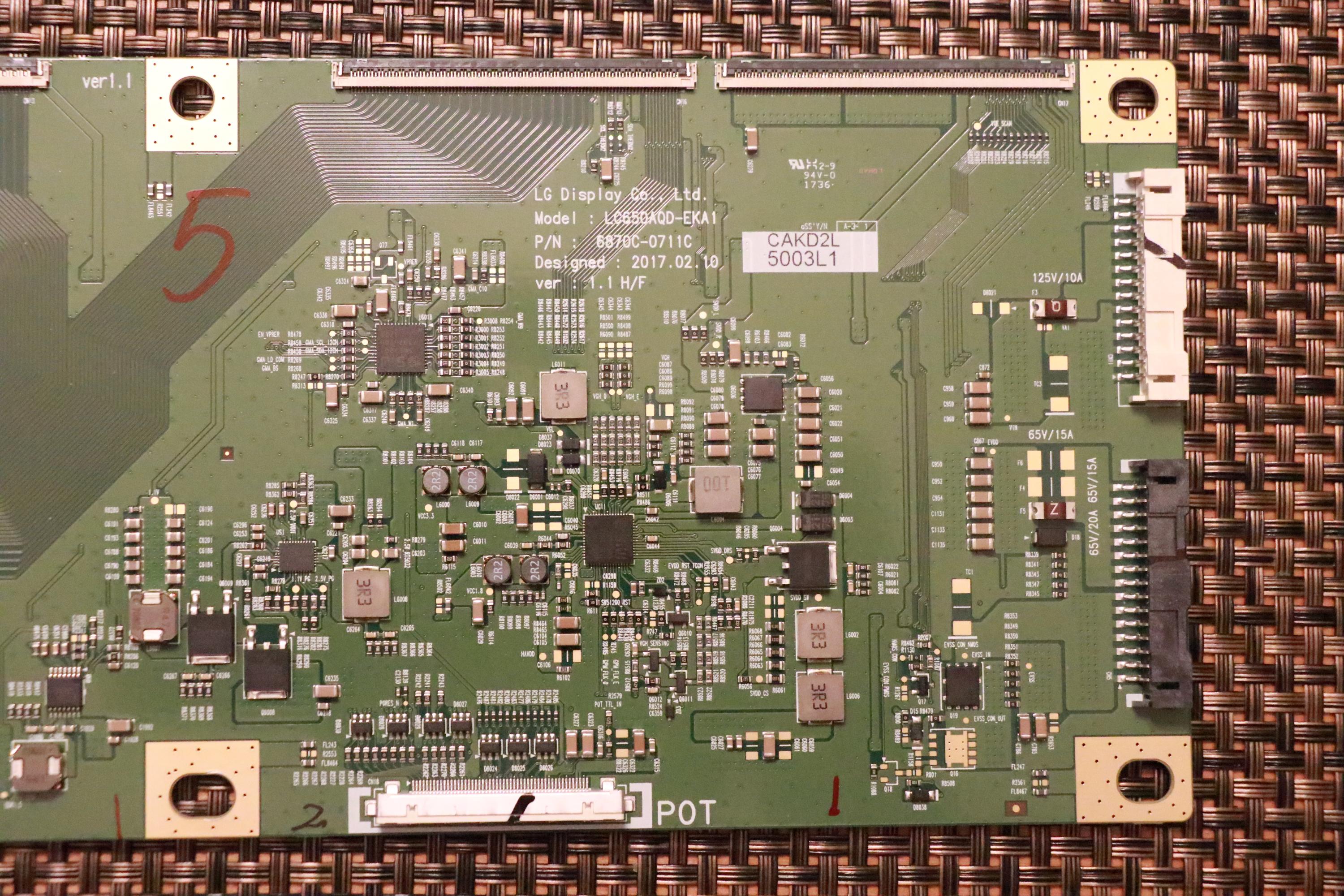

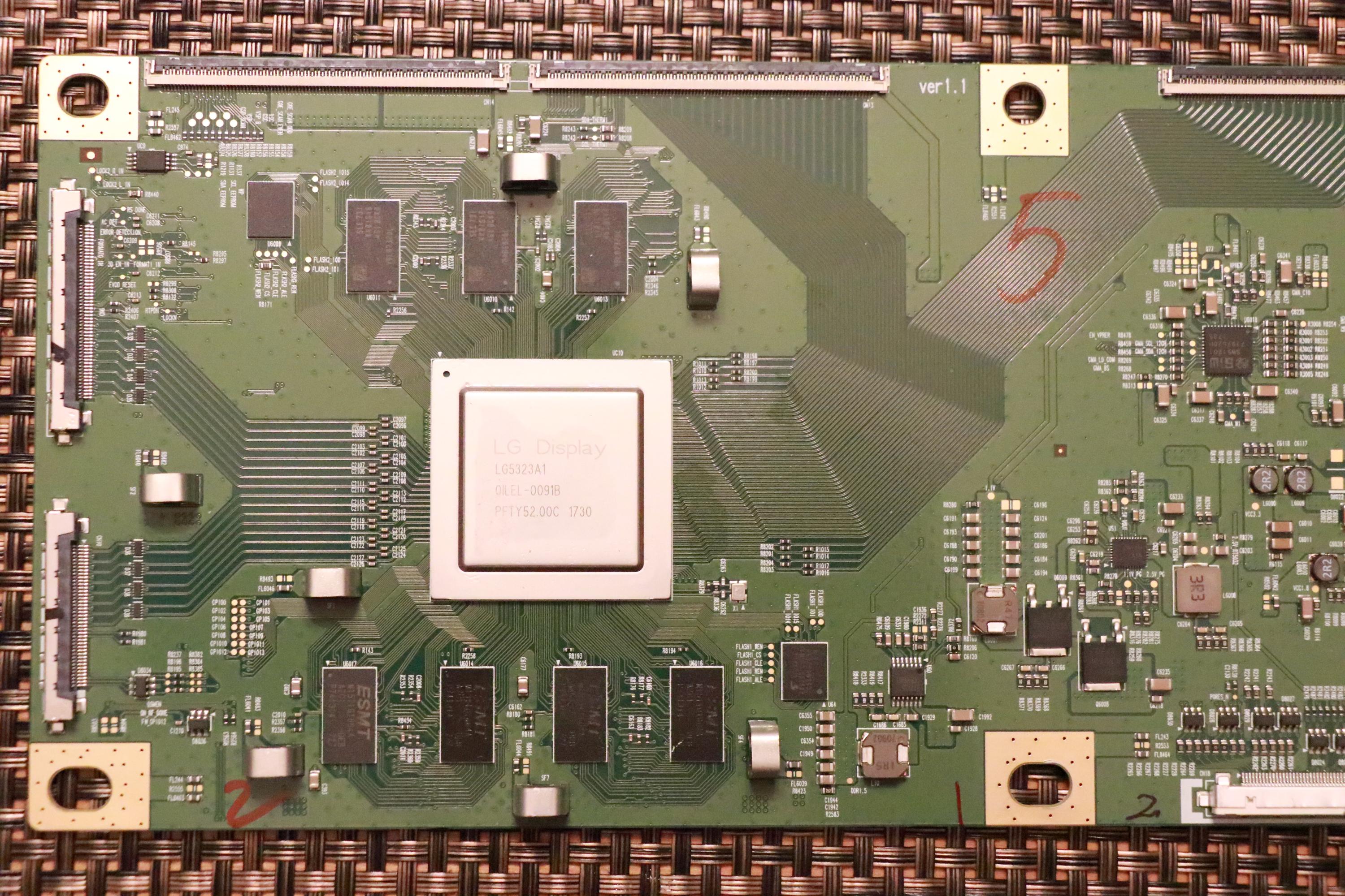

        can you make a better tcon picture at sun light with visible serigraphs?
          It's an Oled, there are no COF's visible and you can not reach them.
              1) T-Con: Here are the best pics I could get. Had to break it into 2 shots (left and right) to get enough clarity to read the serigraphs. (see attached)
              2) Panel Driver Board: That board is behind the stiff metal backing plate that is fused to the panel (you can see what I mean at the bottom of the picture of the back of the TV from my first post), so there's no access to that board for pictures or repair - unless I take an angle grinder and cut away some of the metal frame
              Let me know your thoughts...whether I should try a new T-Con or Main Board, or give up and scrap it. Thanks! --Dave
                If you want to fix all the tv i cannot help you, there's surely a cog or some cof due to the fact the output connectors counts much few lines than the screen columns, so there it is needed a reflow, for the shut off problem i think problem is the mosfet Q6004 on tcon board, it can be made some simple experiments to ensure that... finally, good pictures, i will save them for reference even if i will never touch an Oled i guess..

                • Daveleone
                  • Apr 2016
                  • 267
                  To follow up - I replaced the panel and all is well (t-con and main board work fine). Case closed.
