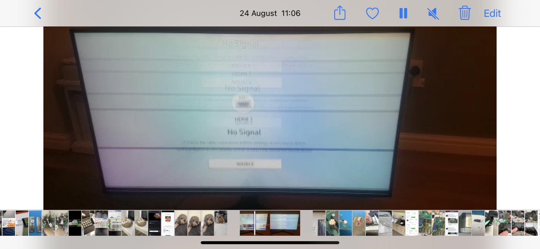

    Hi
    I’ve got a Samsung 50” with a flickering lines. I’ve done a reflow on the main processor but the issue was still there. I tested it the next day and the fault had gone and has not yet returned.
    Are there any common issues? The motherboard is a BN41-02635B
    Sorry for the bad picture, I had to screenshot the video I have of the fault.

    Re: Samsung UE50NU7400 with black lines
    Here is the video of the fault
    http://www.repairyourxbox.co.uk/word...46890ADC76.mov
