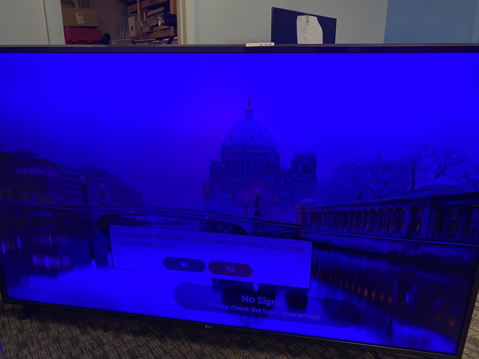

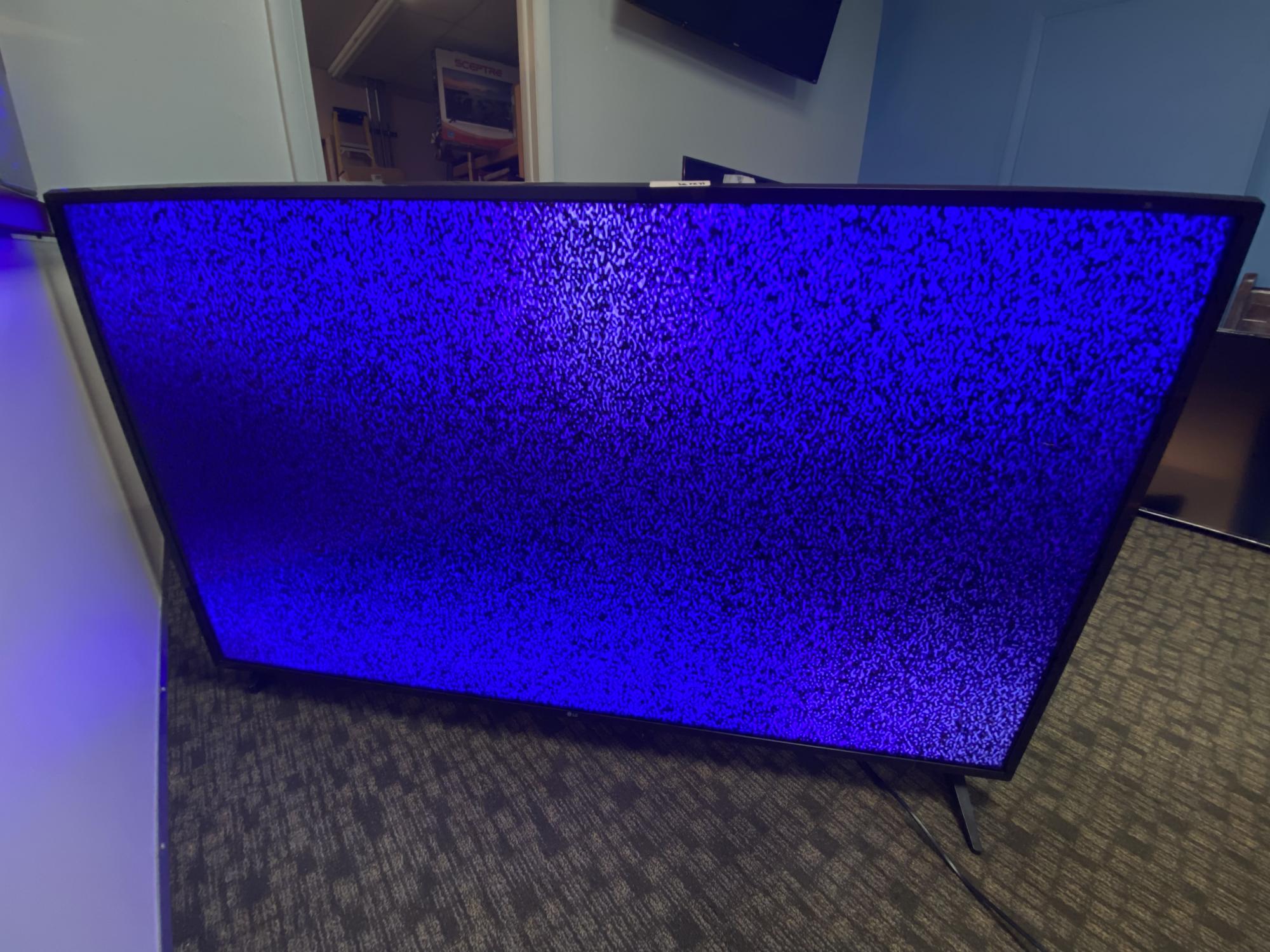

    I have a LG 65 inch tv. When i turn it on it has a blue haze and slightly noticeable white vertical lines. I am wondering if this is the t-con or the panel tabs?

    Dunno about the white lines but LGs (and others) have problems with the leds going blue instead of white.

      Re: LG 65UJ6300-UA has blue haze and small white vertical lines
      Ahhh I see.... the blue haze is from the bad backlights.
      I am guessing that the white vertical lines is most likely the panel.
        https://techhometravel.com/lg-49uj65...e-purple-tint/
          Thanks for linking that. Odd that it turns blue
              if you have a backlight tester or power supply you could try lighting them up .
              They are already lighting up except blue instead of white
                Can you post picture of lines, magnified eventually?
