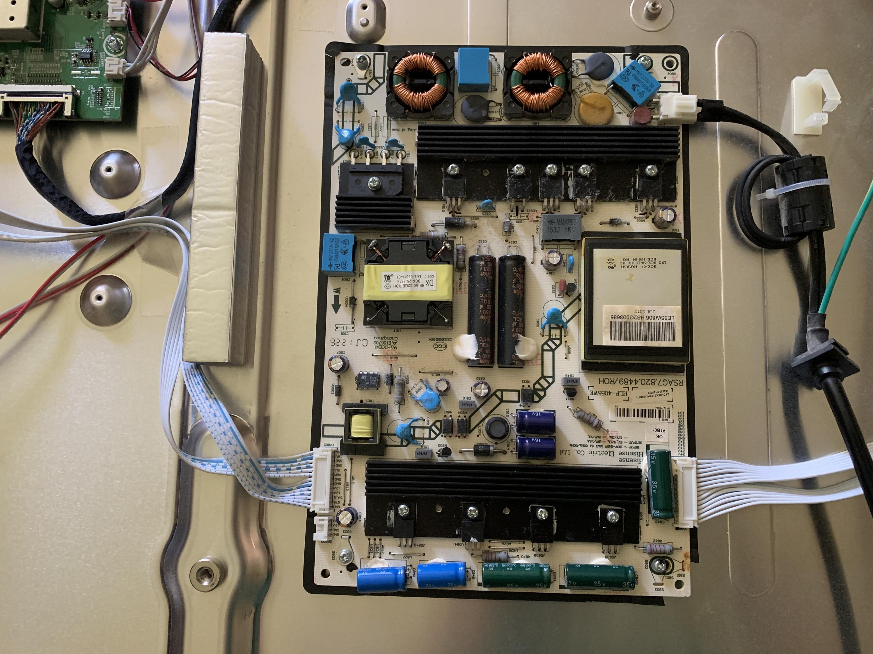

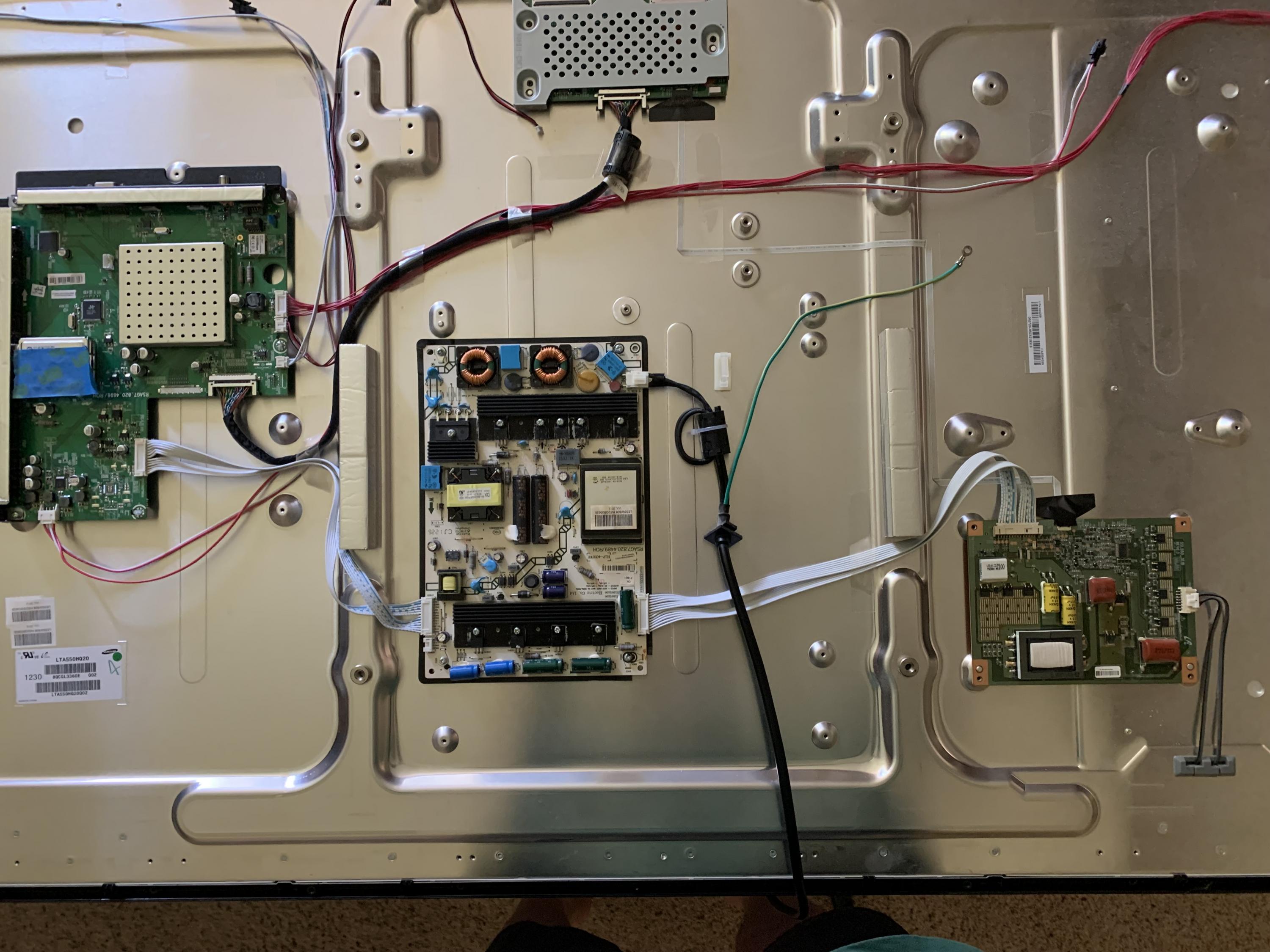

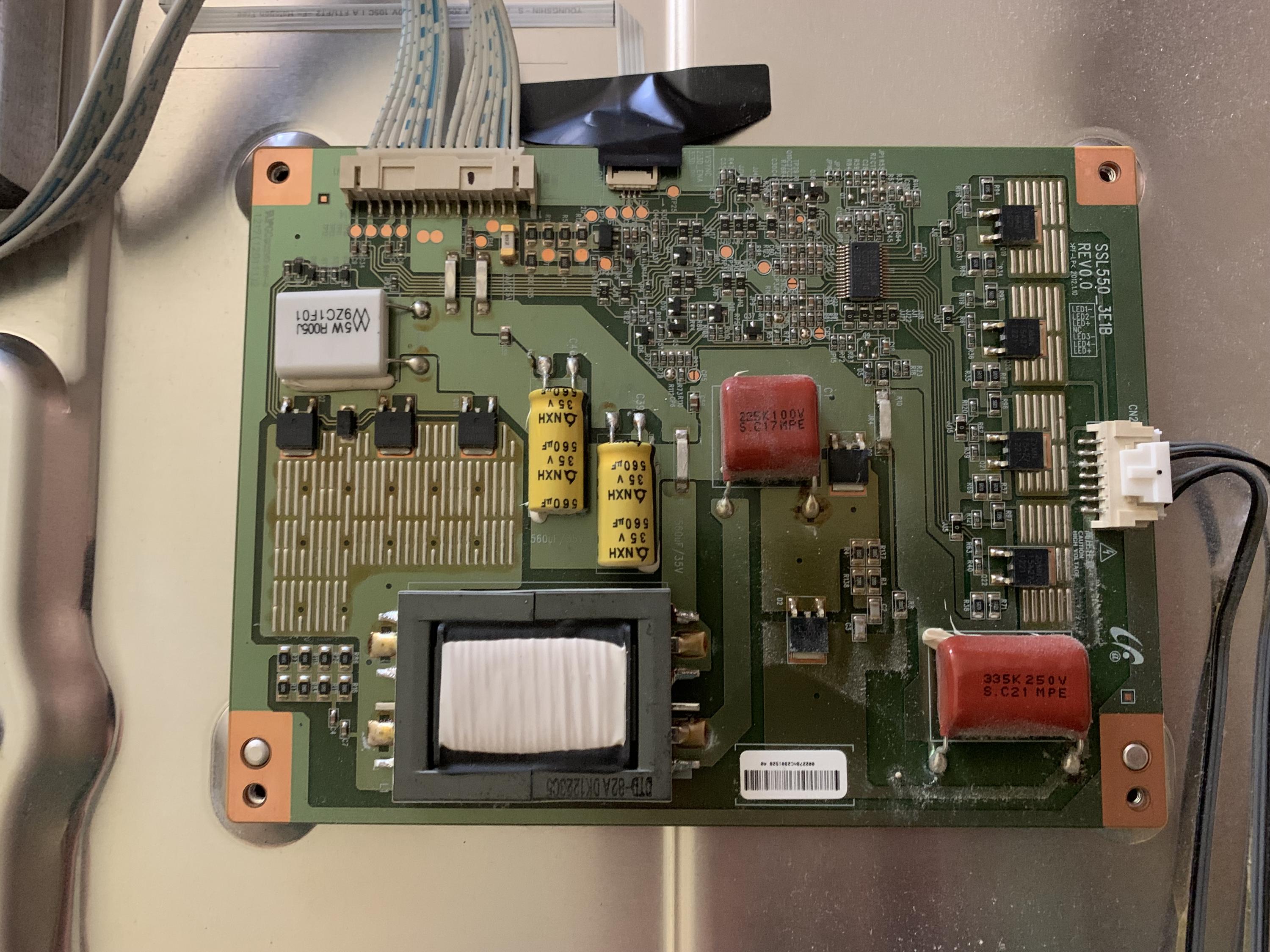

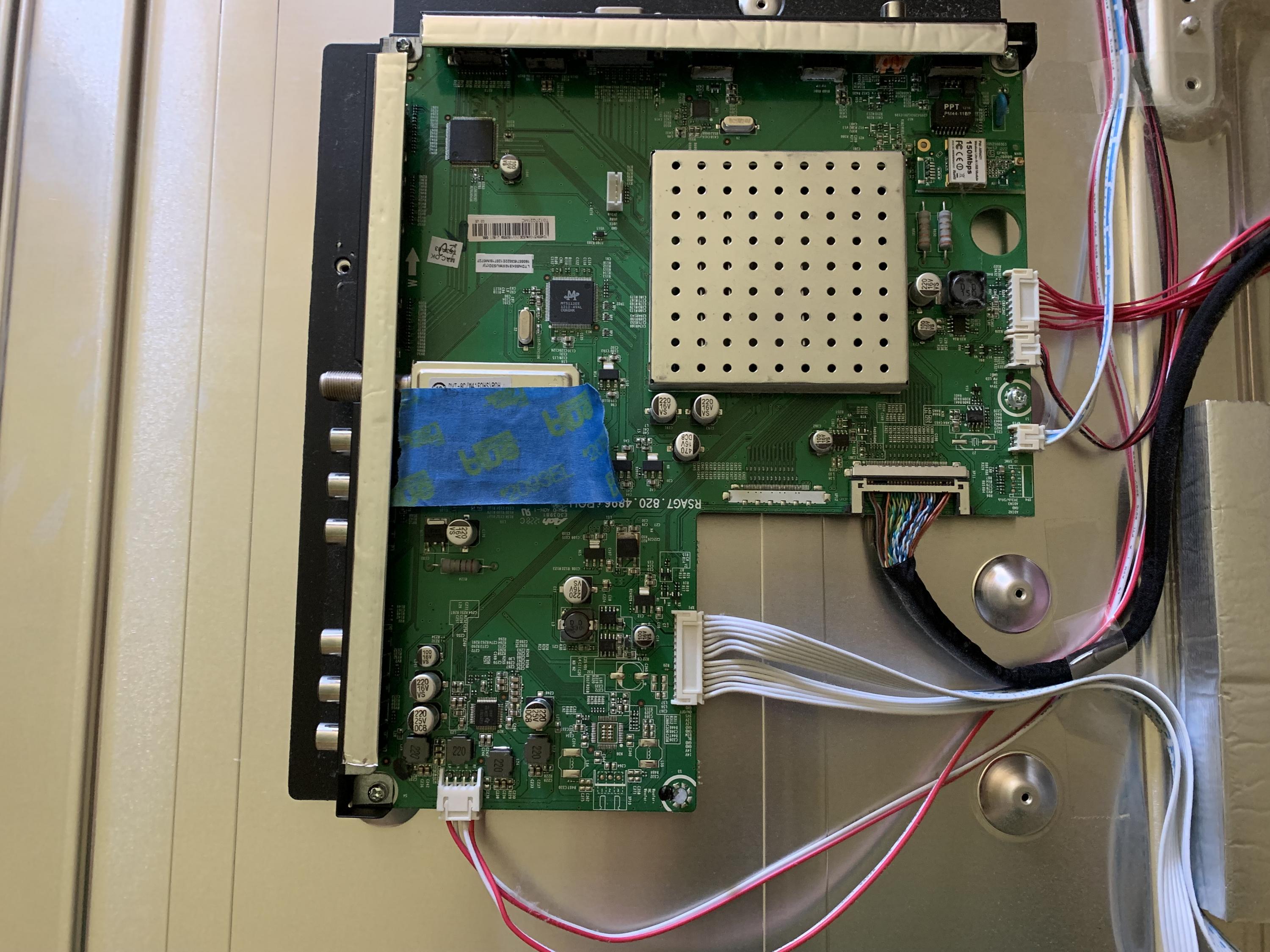

    I have a Hitachi LE55W806 tv that would show a quick flash when turned on, the the screen goes dark. Using a flashlight, I can see that the tv is on. Initially, I thought it was the backlight so I took the tv apart (that was quite the job) just to find out that the sole LED strip (edge lit tv) was working just fine. Could this be a main board problem or the LED driver board? Pictures of the boards are attached.
    I would have just replace the LED driver board, but nobody carries it. If problem is main board, I think I have seen it on ebay.

    How did you test the backlight to confirm the leds were fine?
    You photo also shows a cable disconnected from the Tcon board.

      I took it all apart to get to the LED strip, then tested with LED backlight tester. All LEDs lit and showed the same voltage (there were 4 segments of LEDs on one strip). As foe the loose wire, it is not for the tcon board. I think it goes to the wifi card.
