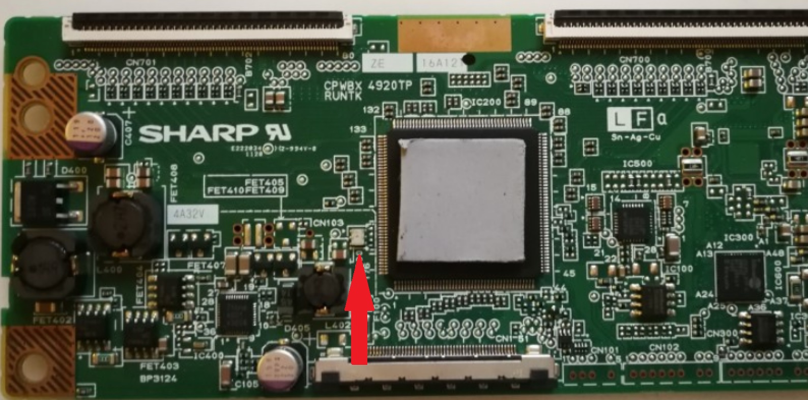

    Hi guys
    I ran into some trouble with my Phillips 46PFL9707 TV and isolated the problem down to the TCON board. I eventually saved up enough money to buy a replacement one from ICCFL.com but when it arrived and I inserted it, all I got was a black screen when I switched on the TV. Even the old broken one produced some type of screen distortions when it was there.
    Both of the TCON boards are CPWBK 4920TP RUNTK and look identical but they have a slightly different code written on them (ZE 118A127 is written on the old one) while the new one has ZH -something written in the same spot.
    I wanted to ask, if this is some type of region code that means the board does not work in European TVs or something?

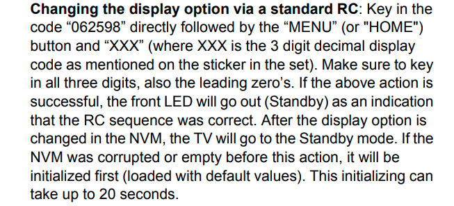

    Hello, maybe the new T-CON has been registered under a different display, try to put your display code.

      Why change a t-con when in 99% only the resonator has to be changed...
          Yes I tried this as you suggested. The tv shows no response. I think the issue may not be with the TCON board.

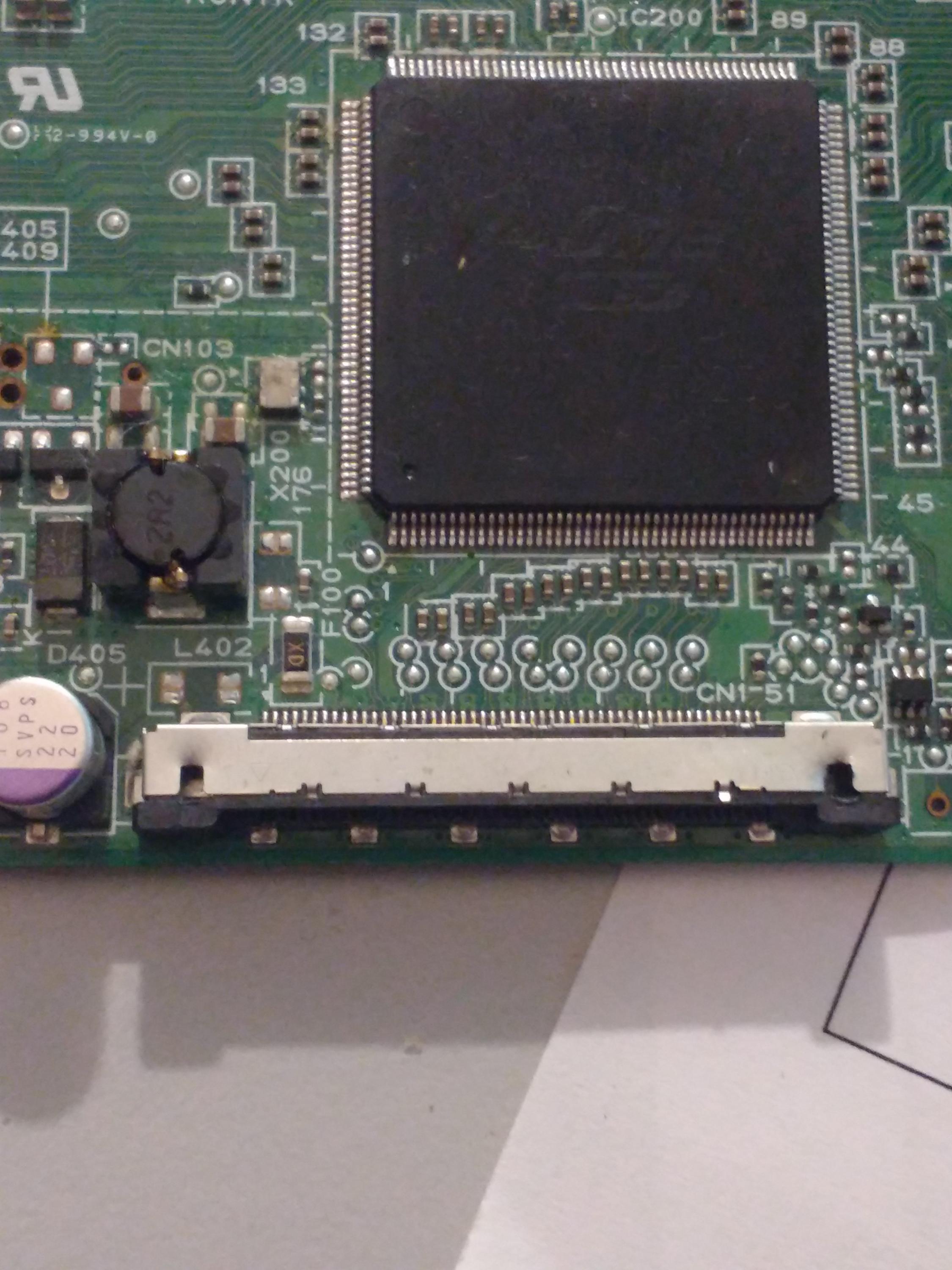

          When I disconnected the LVDS cables from the new board and reconnected them to the old one, the issue I could no longer reproduce the old artifact/garbled screen. The screen appeared black with only the ambient backlight appearing at the points of the screen where the logo and menu options would appear. The TCON board appears to not be connected at all now.
          How fragile are the LVDS cables? And how are they removed on the TV? I had to use considerable force to get them out of the TCON board

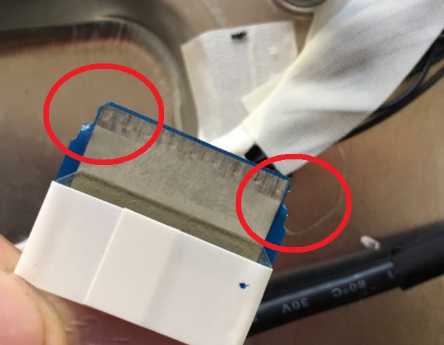

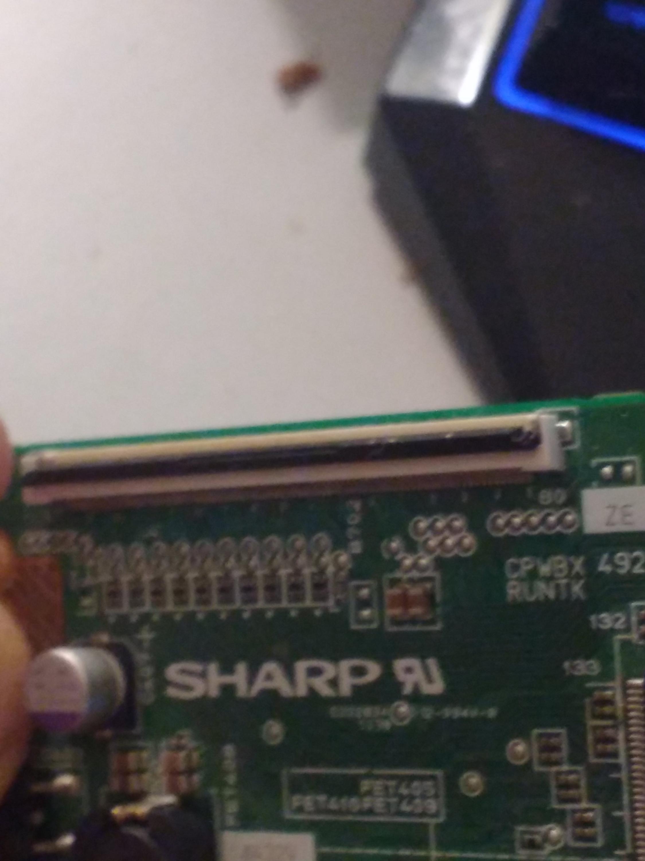

              Re: 46pfl9707 : TCON replacement Region specific or anything?
              Ah, these are not the flap variety where you lift it up to pull out the tab (first photo). I have never seen these ones before (photo 2 + 3). There is no obvious way to remove the cable besides force. I think it is likely I damaged them when remove them. I tried to unhook the black thing but I dont see how.

                Usually you need to press the latches on both sides and pull

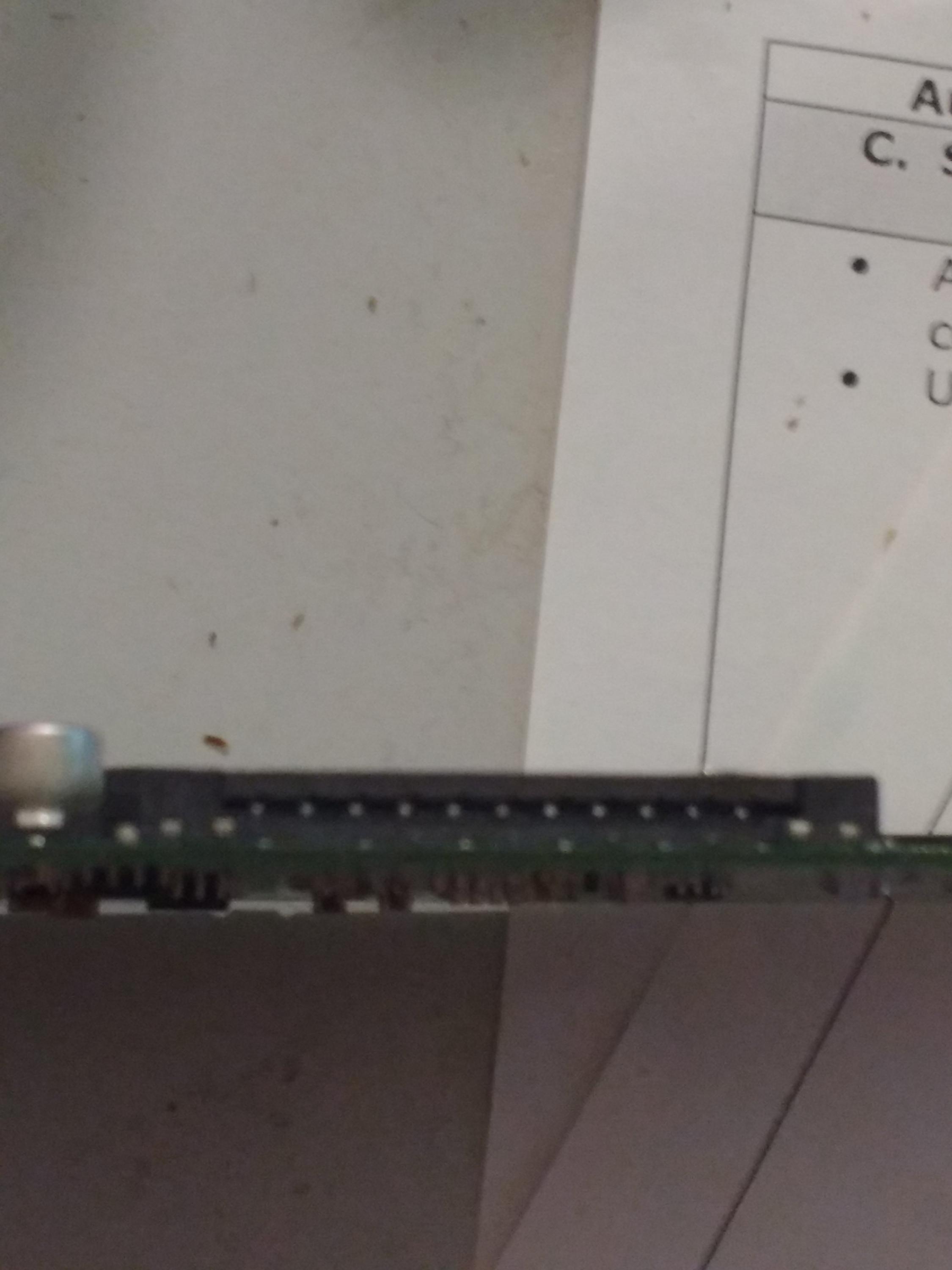

                  There are no latches on this one. It almost looks like it is clipped in like Ipods are
                    the black part pulls part way out by the looks of it.

                      And it is not necessary to change the resonator, it is enough to solder it carefully, the adjacent choke gets very hot and the soldering of this resonator degrades

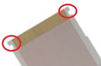

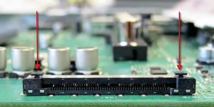

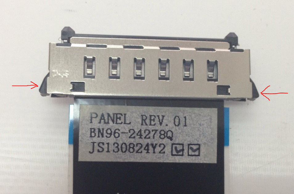

                        It looks like a faulty LVDS cable, there must be nodges like in the attached picture. In the second picture you can see two small buttons you must press in to release the cable, without those buttons you can only pull out the cable which will be damaged like the third picture, changing the cable will solve the problem.
                          After 2 hours of poking around, I finally figured it out. The holes on each side of where the cable fits in have springs in them. I had to insert a small metal rod to get them to loosen the black part....
                          Now I need to find new lvds cables as I likely torn the other ones
                            Ahhh they were missing from my old TCON board, likely because I broke them off when I had to repair the board a few years ago. I figure now that is why the new TCON board does not work.. thanks
