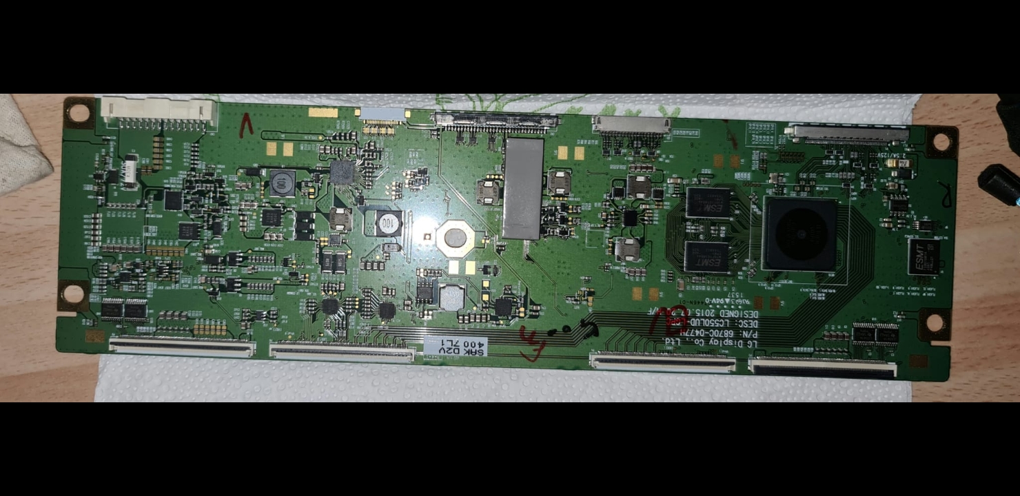

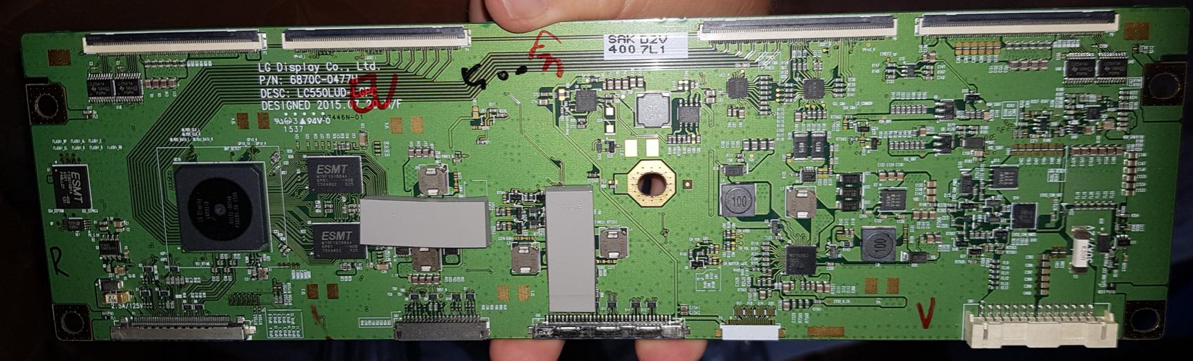

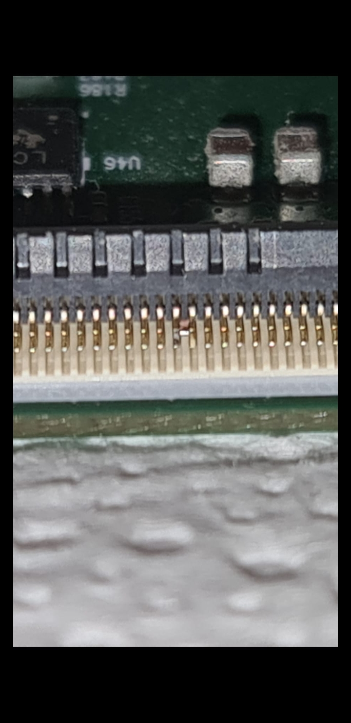

    the issue still persists, but i found on t-con two golden contacts that had together a connection, because the broken flex cable left a contant.
    and one connection was bend. fixed it, and now i'm getting a green image..
    right site has a vertical line, but this is sure because the connectors are now broken, or not creating complete contact.
    BUT, LVDS is connected and don't say the tv, to turn off, because panel is damaged.
    i think, this is a good sign.
    last time it turned off in 30 seconds already. once i got to manage it, to keep it running for 2 minutes, but then i turned it off, and wanted to boot into normal software. but NO, tv says instant, there is something wrong..
    I add pics, what i mean.
    i think, the really last problem is now the t-con.
    i'm not good repair man haha, but got at least a picture already on the tv.
    but tomorrow i will check again cable connection, but i think, it's not the problem now, that i didn't correctly insert a flex cable.
    if you see the t-con on your table, it was the right connector. and on this site i see now the small green vertical line.
    Then i have to get another t-con, if i can't get anything other out.

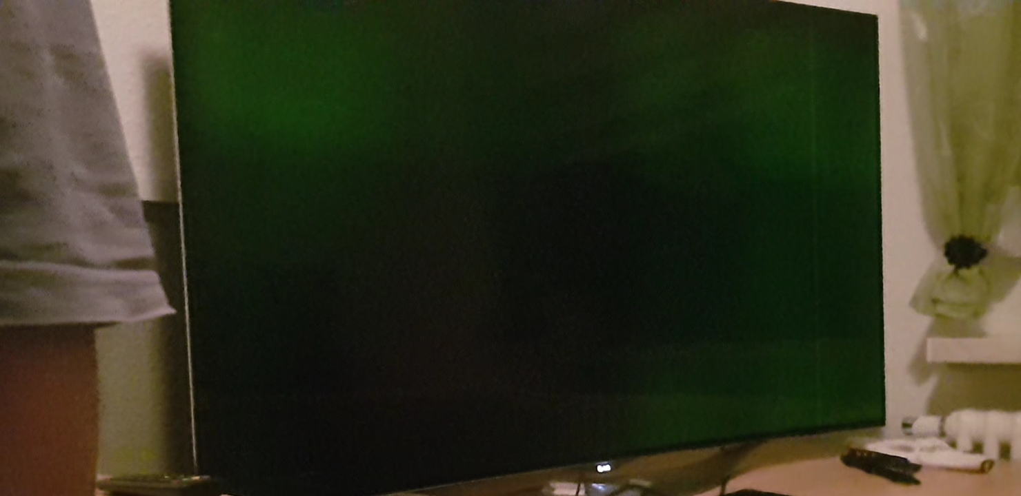

      And Once, before the tv went off after at the 6th try, i saw on white screen some black horizontal lines, then 2 minutes later it turned off. but was running for 8 minutes.

        Pics.

          Still not solved, trying to fix it...
          But i think it's t-con. but i didn't buy a t-con yet.
          And i asked LG for help, i said also that these Model breaks often because of a faulty Panel.
          But they said, it's too old. great.
          And 5 years later, if no one can get a replacement Panel, what will they do with them ? no one will buy it for 1600€. They get recycled i think.
          And i don't think there are warranty upgrades to 10 Years.
          I'm now at the point that i broke the t-con at the tests or maybe in the cold basement for months.
          I mean, why do i see green horizontal lines slowly comming when i remove LVDS?
          And i don't think panel is broken when i see this. It's slow going dark in Middle, you can only see a bit on both sides of the lines. Middle is completly black. But only after one Hour.
          It's brighter when i removed two flex cable (only one side active of panel)
          And it's not warm the panel. if there were a short then i would see that as an vertical line, but it's not.
          aaaand, if everything is plugged in, then i see at start often orange horizontal very fast flickering lines.
          then he comes sometimes on for few seconds or maybe not and is stopping to boot.
          And i got the TV last time to run again for 1 minute but i turned it off. i took the cable in my hands and used a bit force, drawn cable to me. the TV moved a little bit, i saw it at screen reflection. then turned on again, and boom it's working without issues. then suddenly two grey horizontal grey lines appeared on the right side, going to left side. but not complete to left side, a bit is complete white how is should be.
          Then after i turned it off, tried after a game in 30 minutes again and worked again. turned off and tried in evening again and went on and right side went dark with very fast flickering, then off.
          I should Upload some videos to youtube, and will post it here. then you know more.
          I think if it's panel problem then i would see also flickering in the green horizontal lines. but i don't know it is correct that there are horizontal lines when LVDS removed.
          sorry for my English, i'm german. It's a bit hard for me.

                          I think the PSU is ok, when the Panel is bright with the green Lines when LVDS removed. Or should then still test PSU with car bulb?
                          i uploaded the video, there you see a bit more of it. https://www.youtube.com/watch?v=YuA1Rjf5V0E

                              It's the LC550LUd-LGPC

                                          Another T-con is inside and TV Shows at boot White big line and the rest is bright Green. But this is not a panel issue ?!?!?!
                                          If i remove one flex cable, the white odd line disappears. But still dverything Green. Old t-con showed green odd line on right side. Then random the panel flickers with some colors and comes on maybe for 1 second.
                                          New t-con turns off the TV after 3 seconds. And if i remove LVDS, i see again These horizontal lines coming slowly. But now the complete screen looks like that. And is also very bright.
                                          I haven't found a bulb yet. Then i have to buy one. But could be this still a PSU problem ?? I think not but we can't be sure 100%.
                                          And if it's important for you, the panel is not warm after trying. Also checked temperatures.

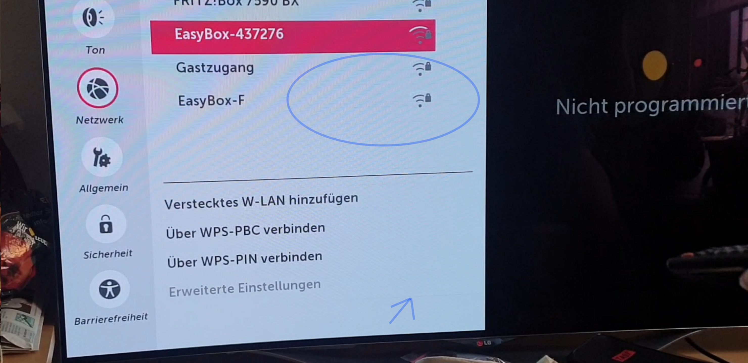

                                          Will add pictures. Sorry if i wrote something wrong, i'm writing from mobile.
