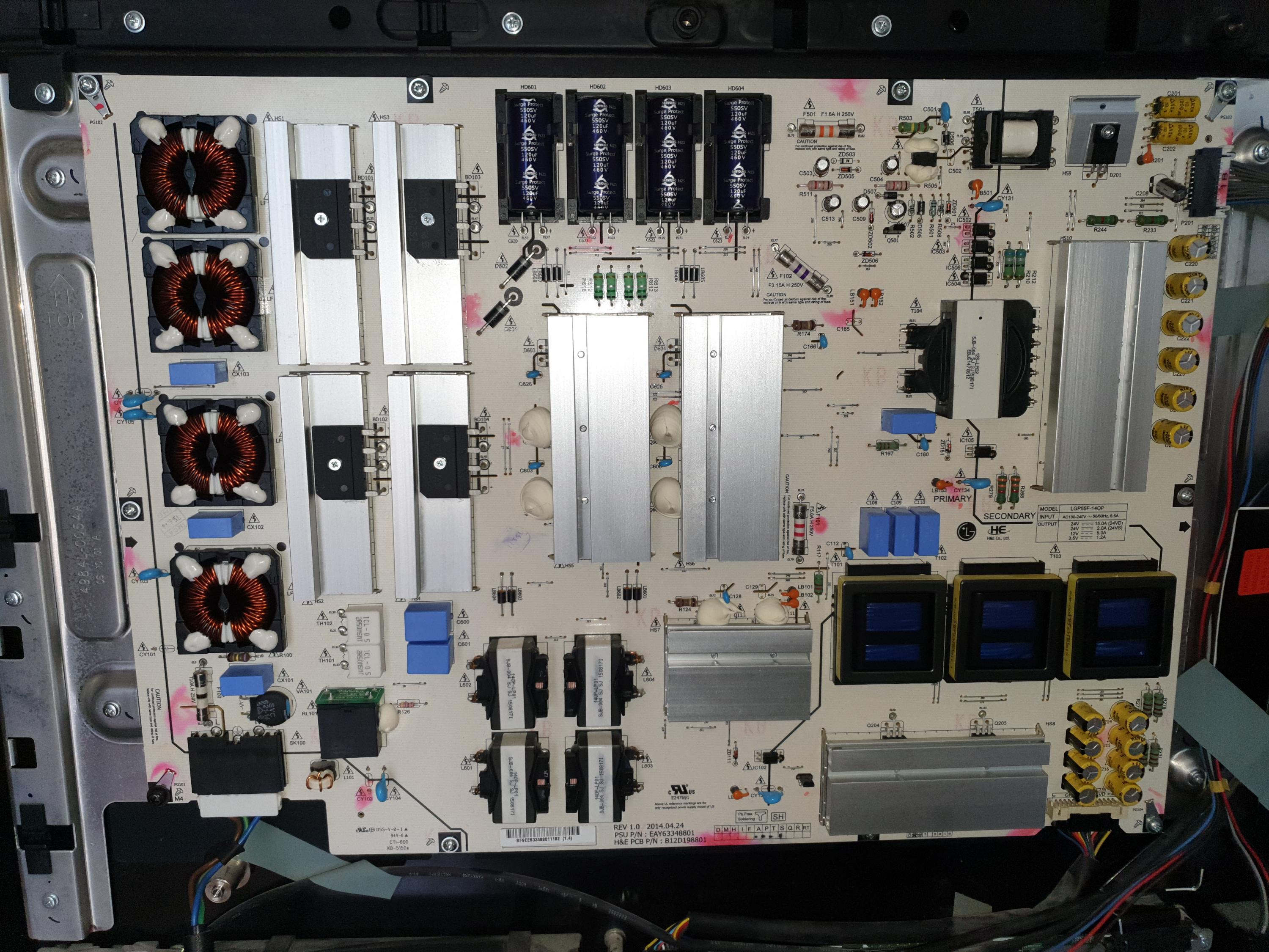

    Then we just opend the TV, and there was a lot dust inside.
    We cleaned, looked at the parts, and first look was ok.

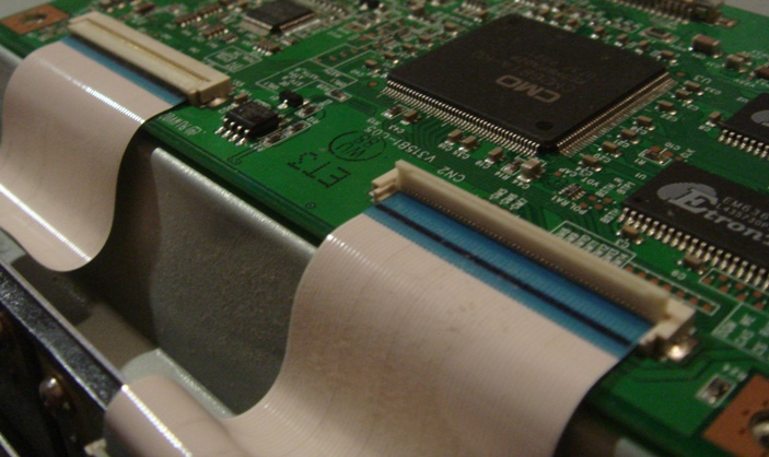

    Then removed the T-Con and looked at it.
    it was ok for me.

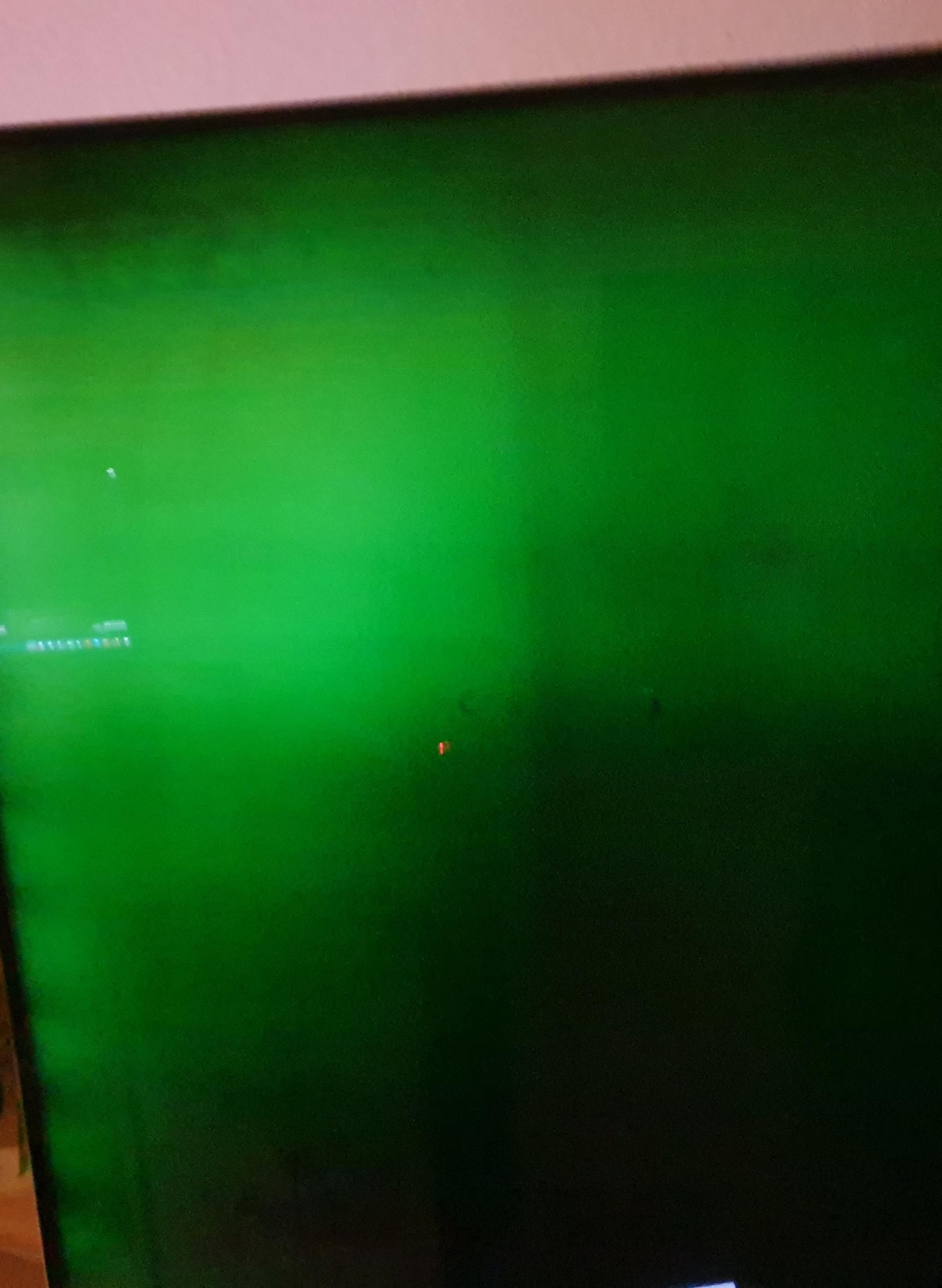

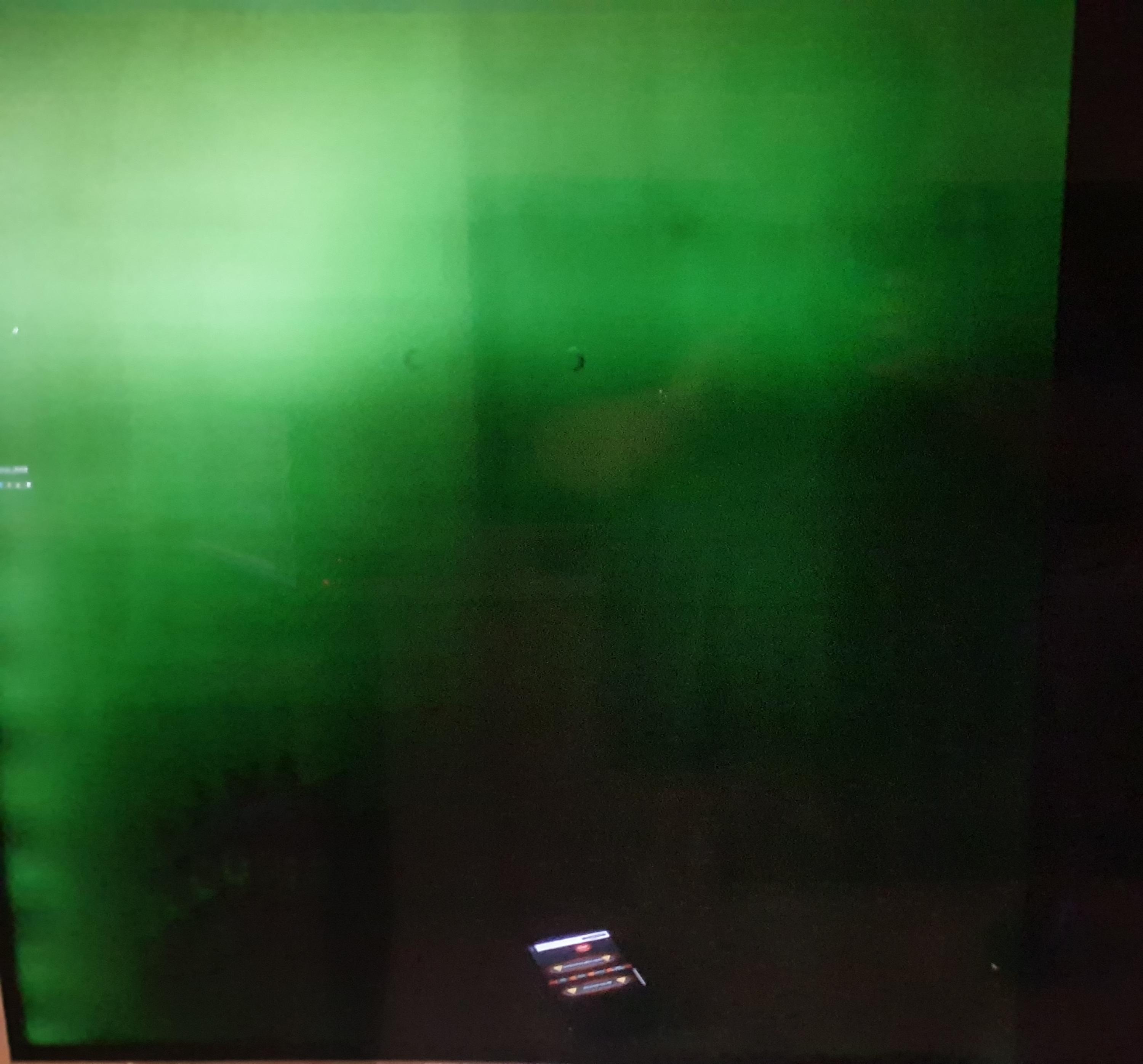

    Then i removed a cable from the T-Con and i got for 2 seconds a half dark screen, it was like grey, but in the camera you clearly see, it was green.
    Then i removed another cable from T-Con, and saw it very bright with green Color, and also burn in. Maybe because i removed the LVDS cable??
    I removed once all Cables from T-Con, and LVDS too, and it didn't came on. Used Power only on galaxy S5, and the LG remote.
    Then i removed completly the T-con, and tried it again, but same problem.
    But if one Cable was removed, then it took maybe 4-5 Seconds, until the tv clicks again after the first click.

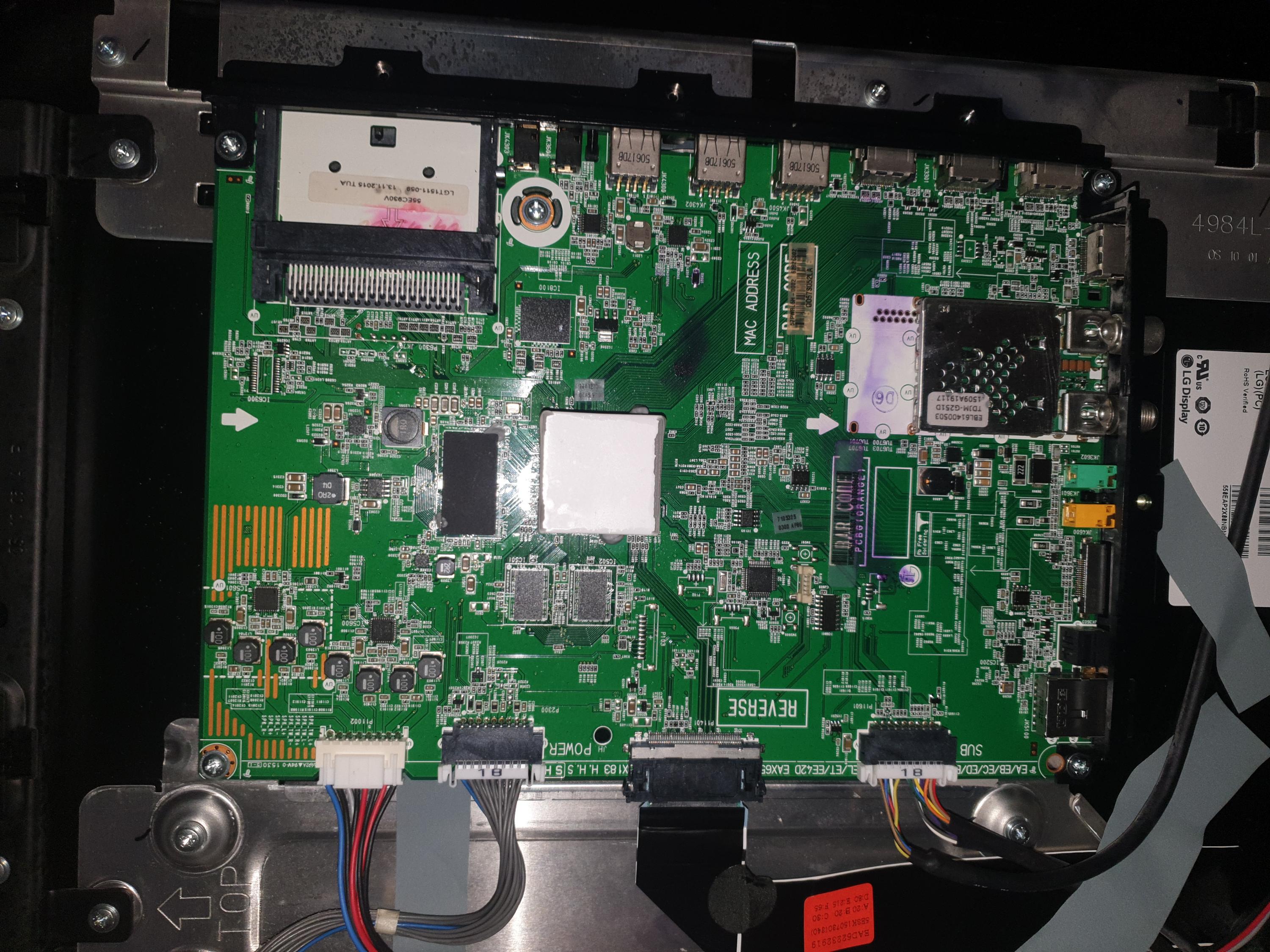

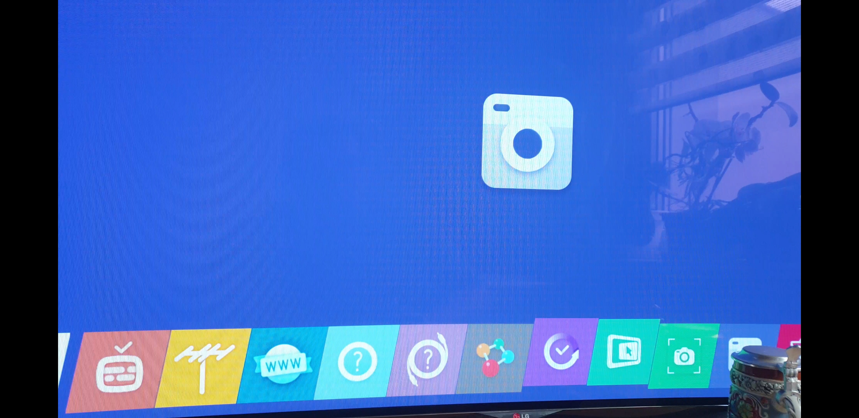

        New Board is inside, and the TV lives. Light if off and I get a IP. But still the same black screen with stripes. Will add images later when i'm home

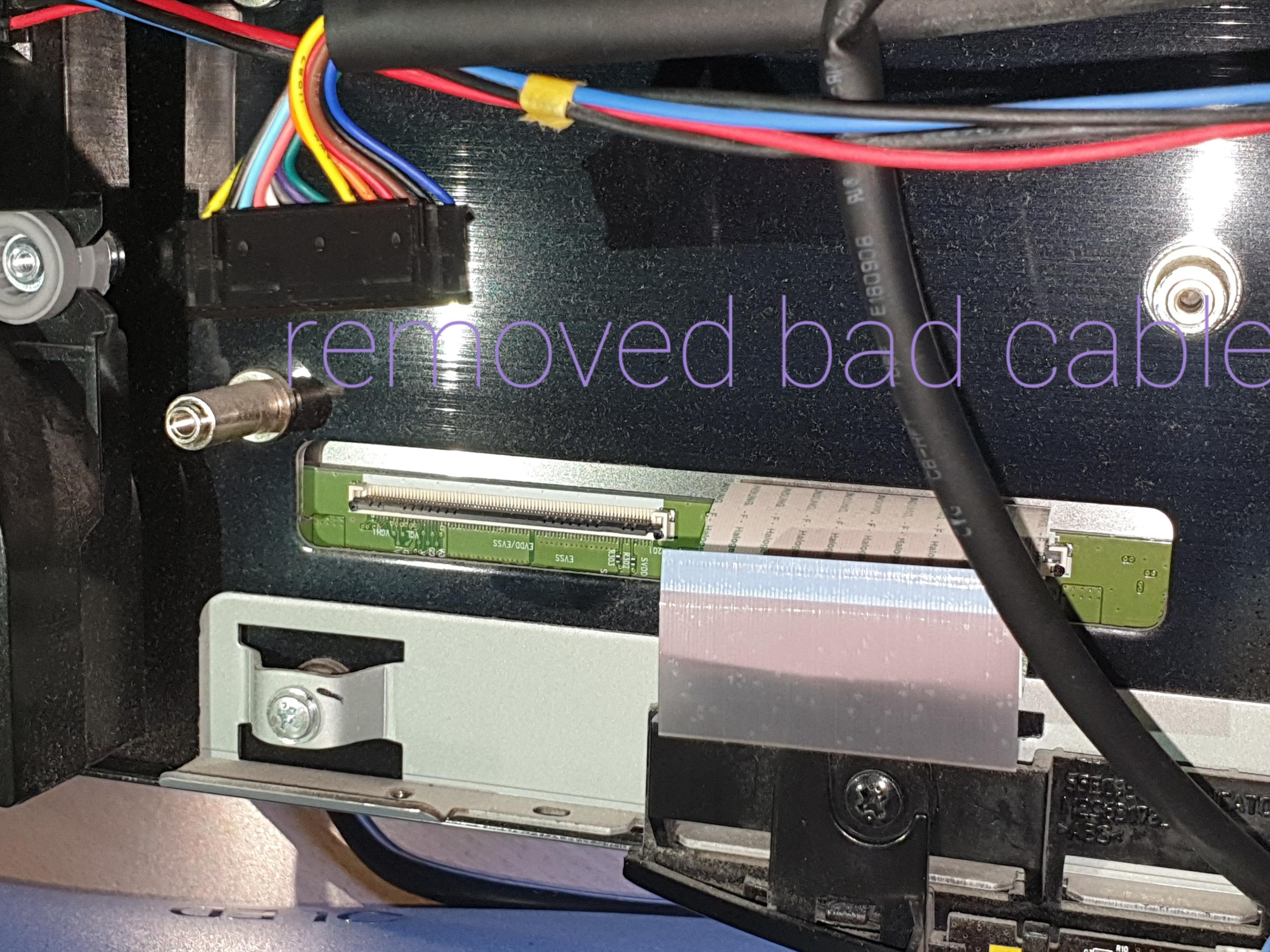

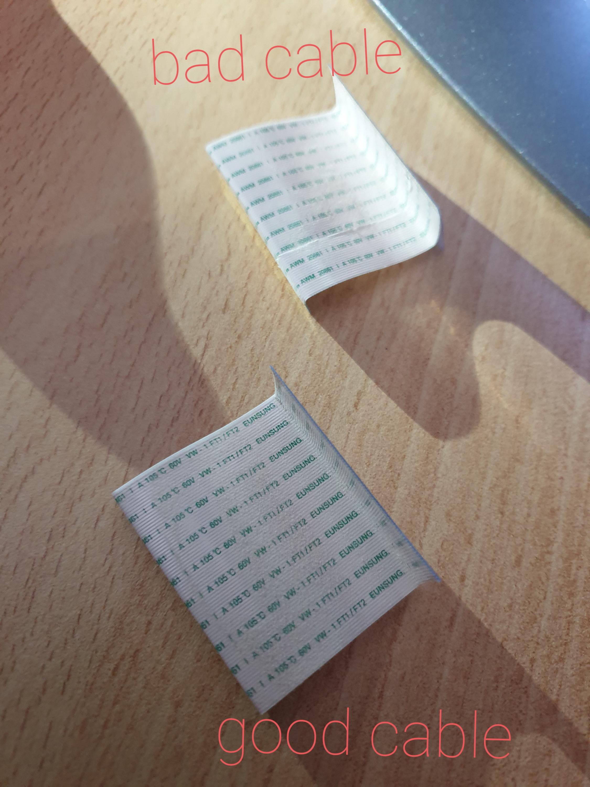

          I couldn't upload images but i saw, that i damaged before a flex ribbon cable from panel to t-con. And this is maybe the reason why i got over time with unplugging and plug in some grey stripes in left corner. with working mainboard it's getting complete over the screen, A LOT of stripes.
          3 pins are missing and complete cutted ribbon cable. i used also tape and clued over the damaged pins and screen was black, and now i need only new cables and tv will work again, hopefully. i mean, i can hear sound, the OS is working.
          also found the TV in my router and it was visible in LG ThinQ app and Youtube
          but i performed instop and i don't know how i did setup the tv, i pressed randomly on the remote, and then i got 10 minutes later again sound, where this black beanbird is on a seat. (normally, but i cant see it, because the cable is damaged.)
          The main problem was the mainboard i would say. Then i damaged the cable and this prevents me from seeing the screen.
          The old mainboard never turned on again after the 8 months, and that's it.

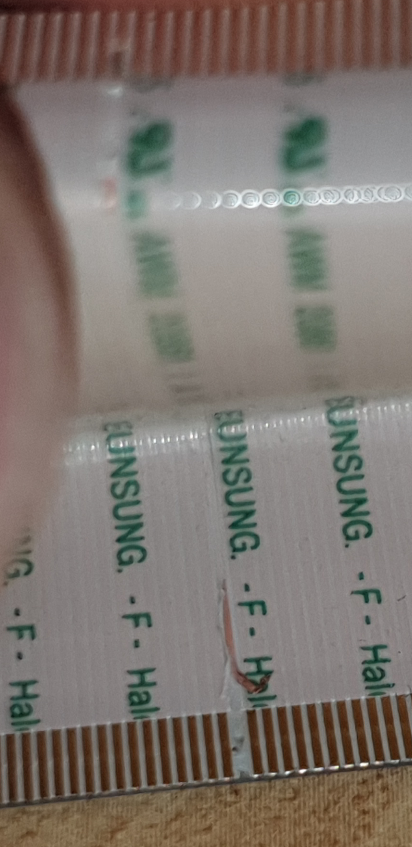

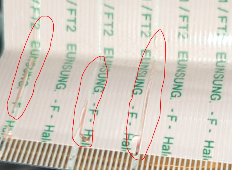

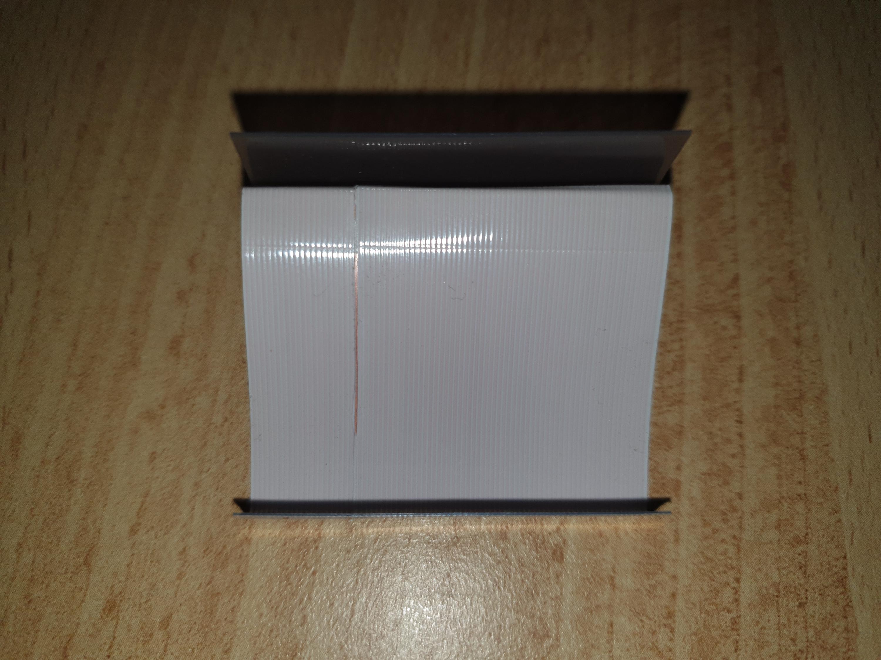

            Picture of Cable what i mean and the Problem what the cable causes

              Re: LG 55EC930v is not turning on, it's dead
              In my opinion, you simply did not correctly insert the cable (mirrored), usually the blue insert should be under the latch
              • mmartell
                • Oct 2013
                • 3189
                You are right the ribbon cable is no longer any good try to find a replacement.
                  And a large current passed along these paths that they even melted the insulation

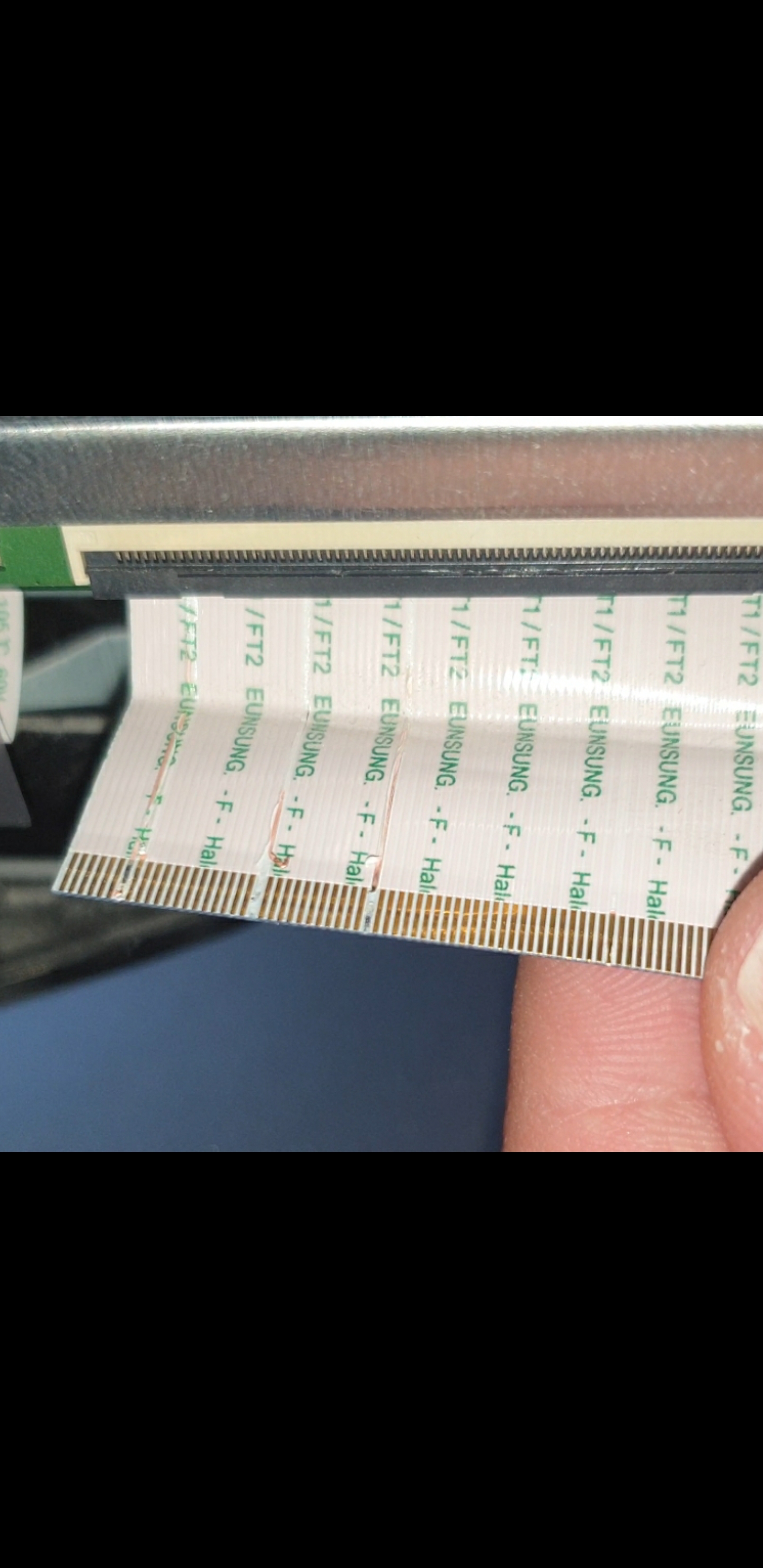

                    I bought a new cable yesterday but have to wait, until it arrives. Maybe One week..
                    @lotas, the blue part was not visible anymore when i connected the cable. or maybe a little bit, but i checked it again.
                    And i removed the cable sometimes, and i had to struggle to reinsert the cable. maybe it happend there. yes, the cable with the lost pins, for me it was looking like cracks, because it's from top to bottom.
                    I added better detailed images from the cable, and versus a good cable.
                    (a few days old these pictures, there was one pin lost. but now 3 pins.)

                      I don't know if you did or didn't but never plug and unplug those ribbon cables while power is applied.

                          Hi, got the cable today and i got the same screen. But i saw that the lvds cable is maybe broken, the connector is only half on the cable. Then i removed the comnector and there were
                          also two pins lost. this the final issue?
                          What does the lvds Do?
                          • TeslaMichael
                            • Oct 2020
                            • 102
                            Ah yes, now i see it, the LVDS gives the image of the MB (like HDMI, USB and it's own UI to tcon and this goes into panel. That makes sense. So i have to get this cable, and it will work again.

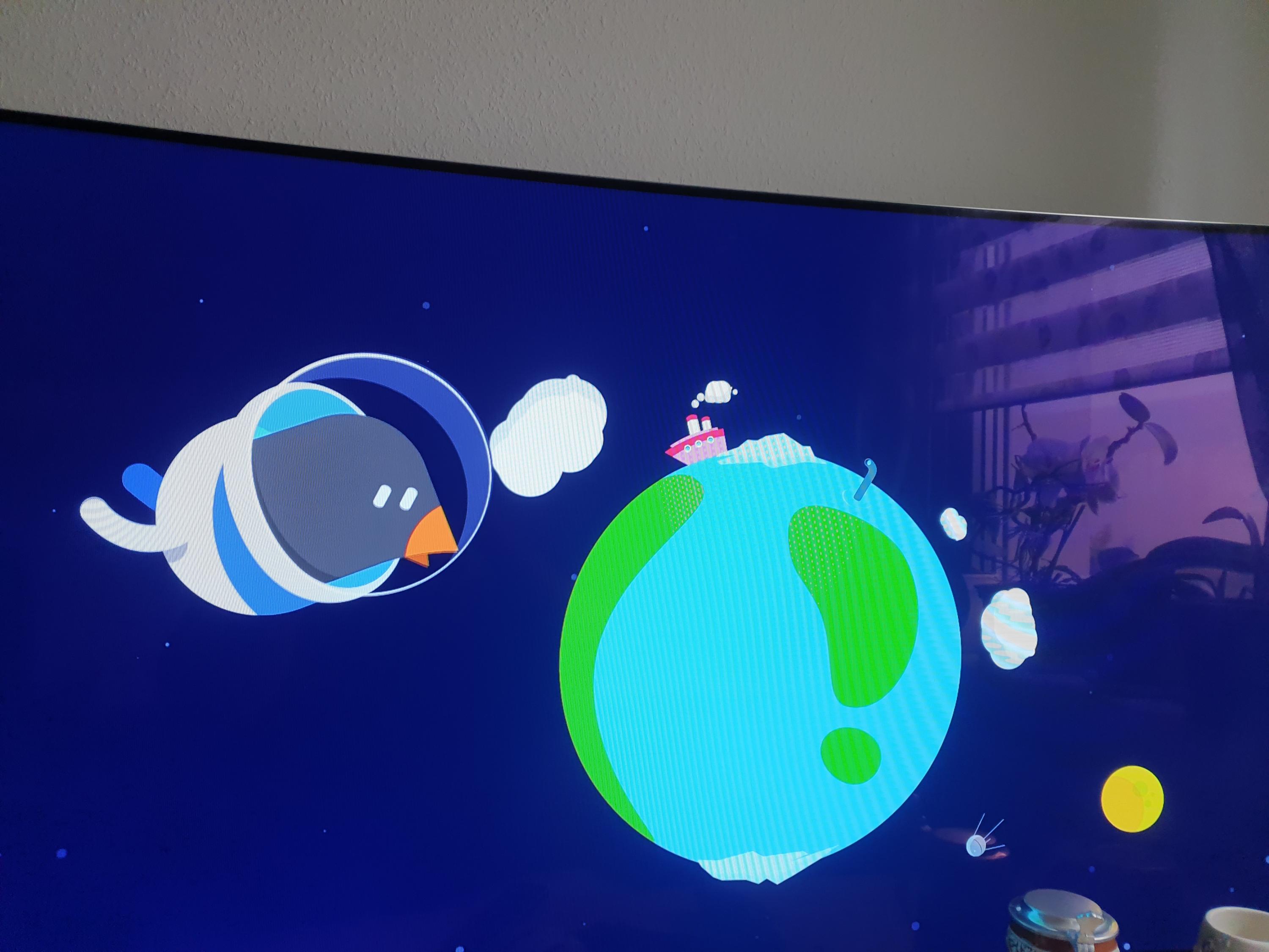

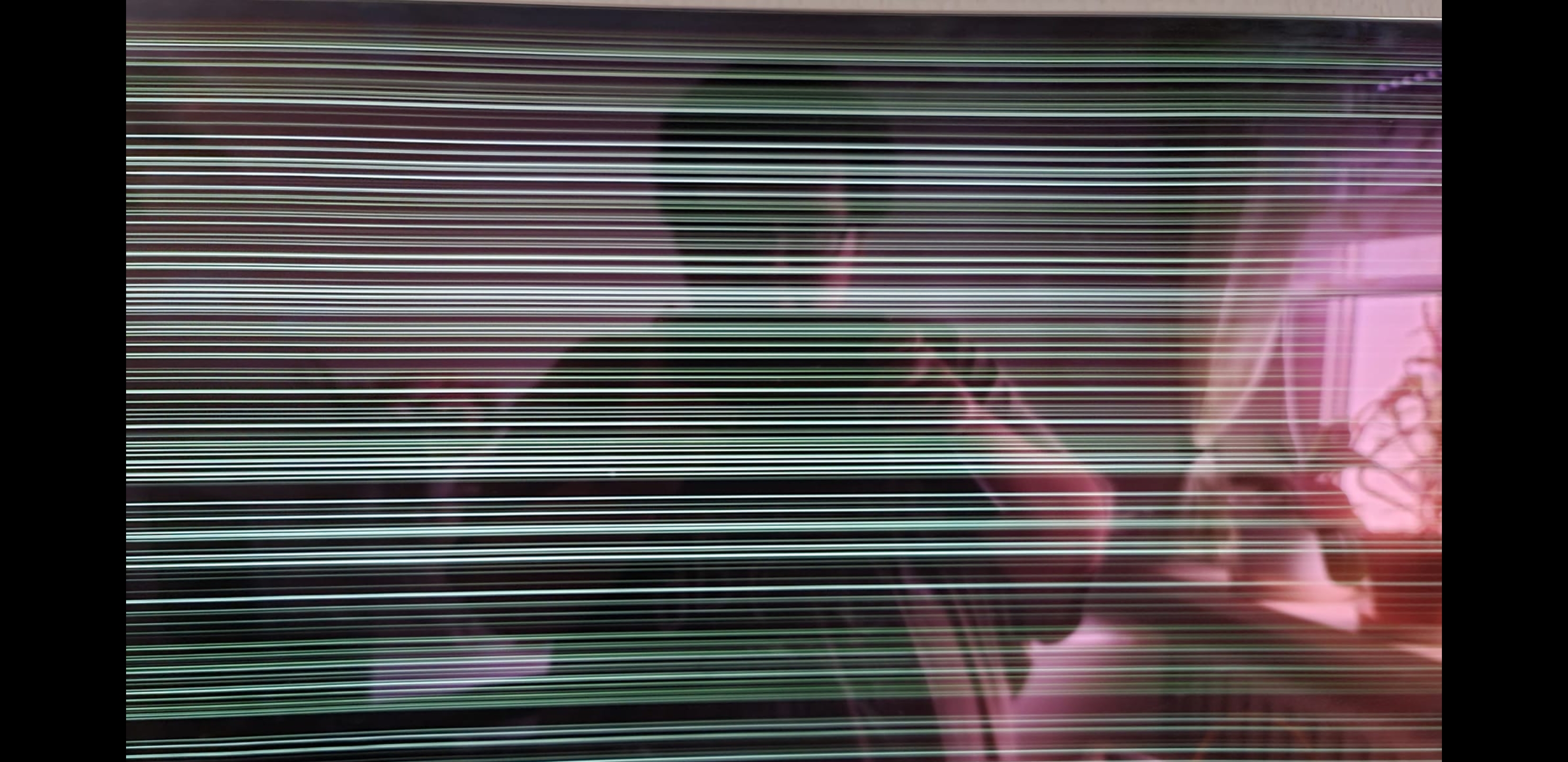

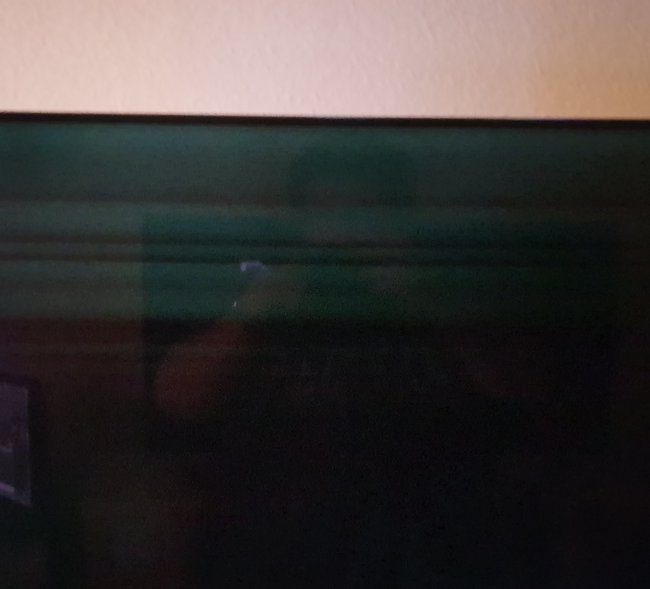

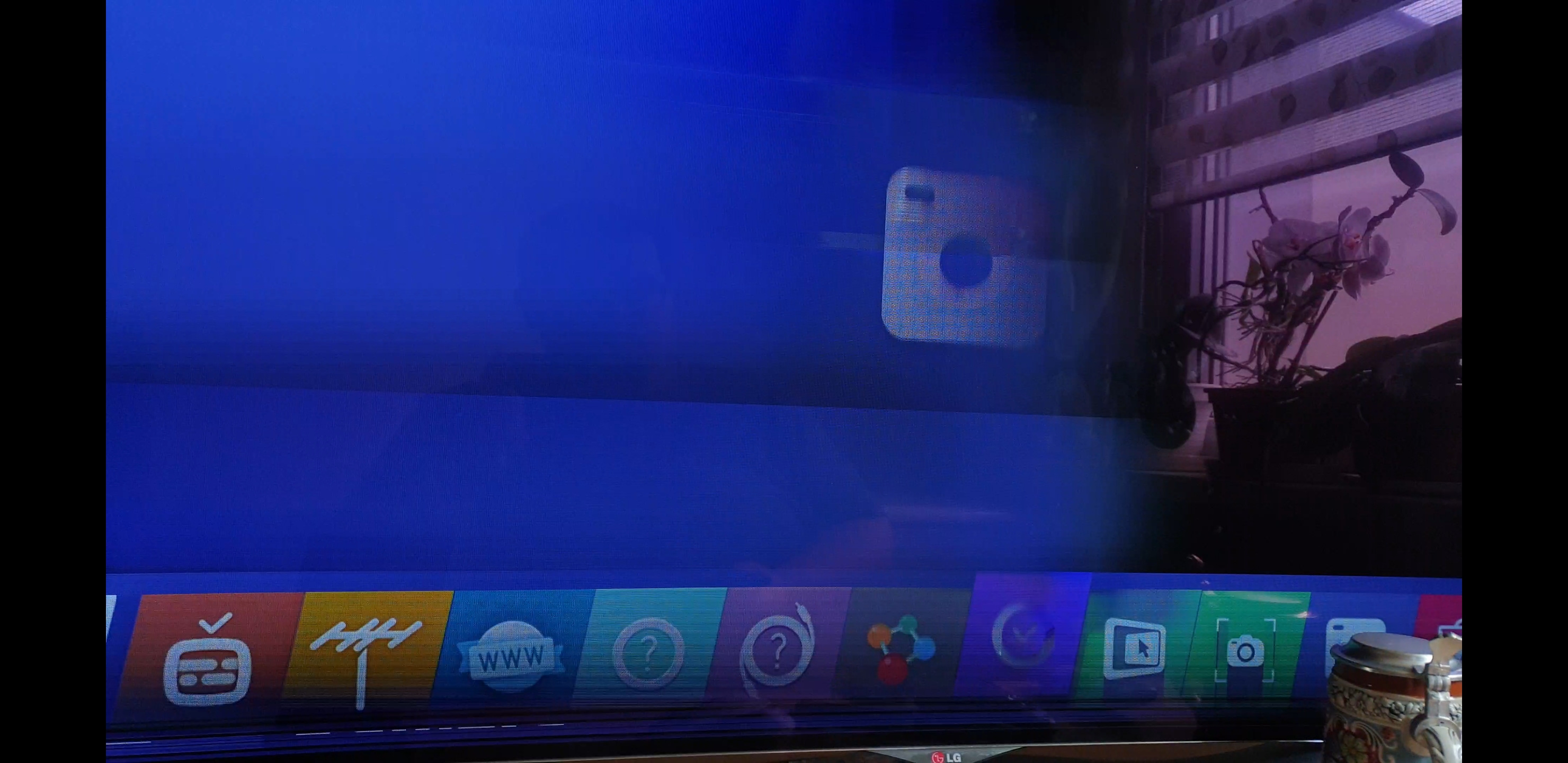

                              Hi, got good update and bad Update.
                              Got screen with the new lvds cable, looking good without problems. But after one minute it turned off, and then turned on again, and got again good screen
                              Then I saw a red big stripe 3-4cm and disappeared again, then few seconds came back and tv says off.
                              Maybe i should clean all the cables?

                                Btw. It is a horizontal bar, not vertical

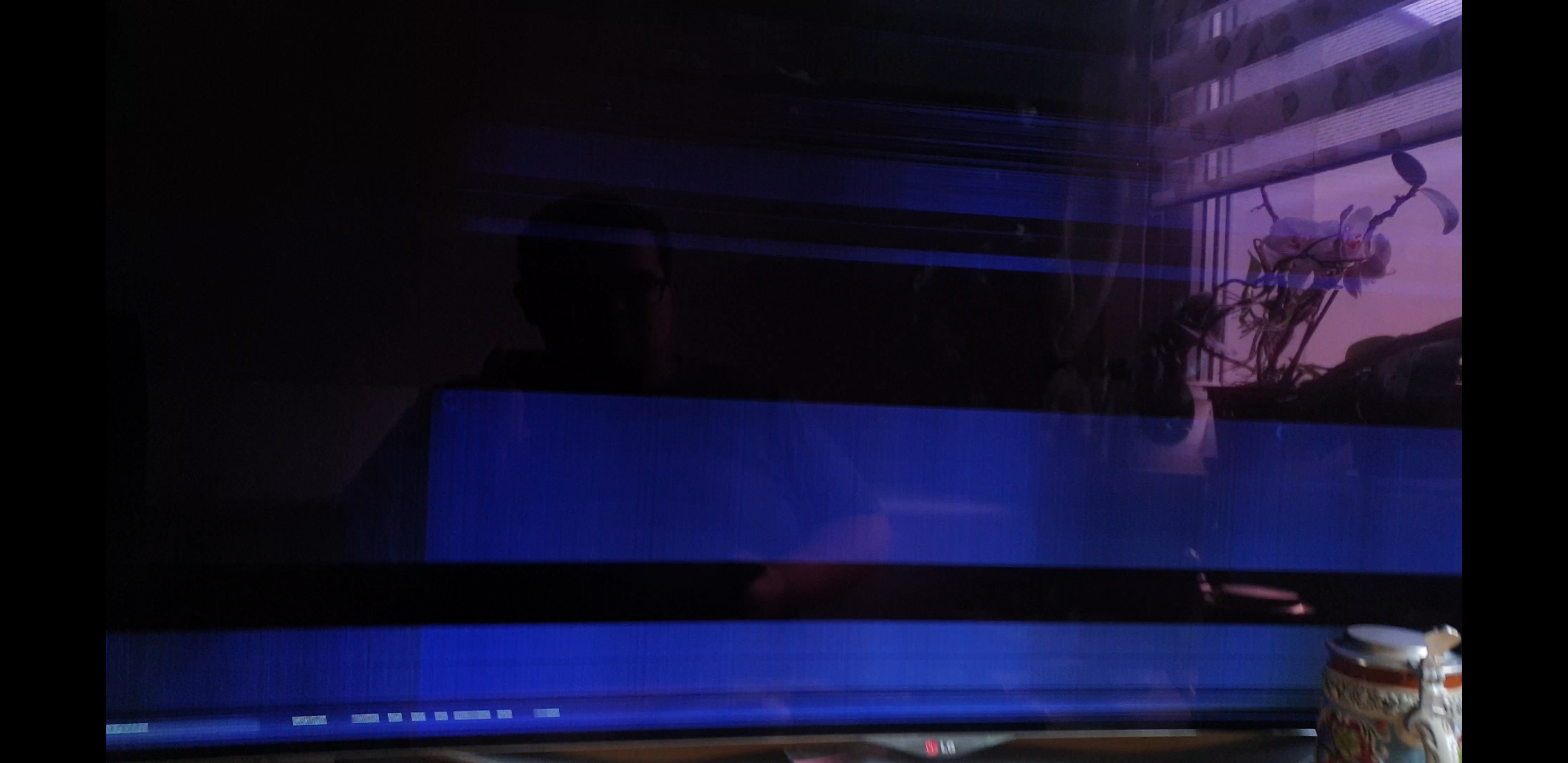

                                  Tv was running for 10 minutes and the screen went instant dark and the tv clicks
                                  When i'm home, i can add images.

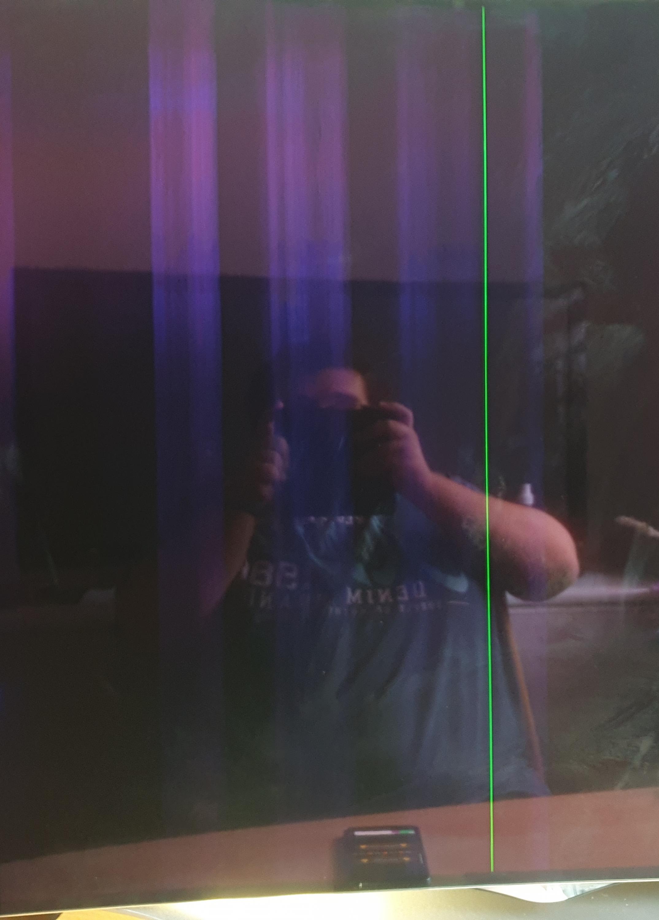

                                  • TeslaMichael
                                    • Oct 2020
                                    • 102
                                    Images, no issues when screen is working, no vertical or horizontal lines, but after the tv goes off with broken image, (1 second and then everything black, it's really fast, and then click. )
                                    After turn on again, i saw a orange colored horizontal stripe but i turned it off.
                                    I think if i try now again, the image will be good, but after 10 minutes it will happen again.
                                    Could it really be a problem if there is dust on flex ribbon cable? but i think, it's not that problem.
                                    I'm thinking, the PSU has a problem and killed the Mainboard, and then power goes away and screen goes dark.
