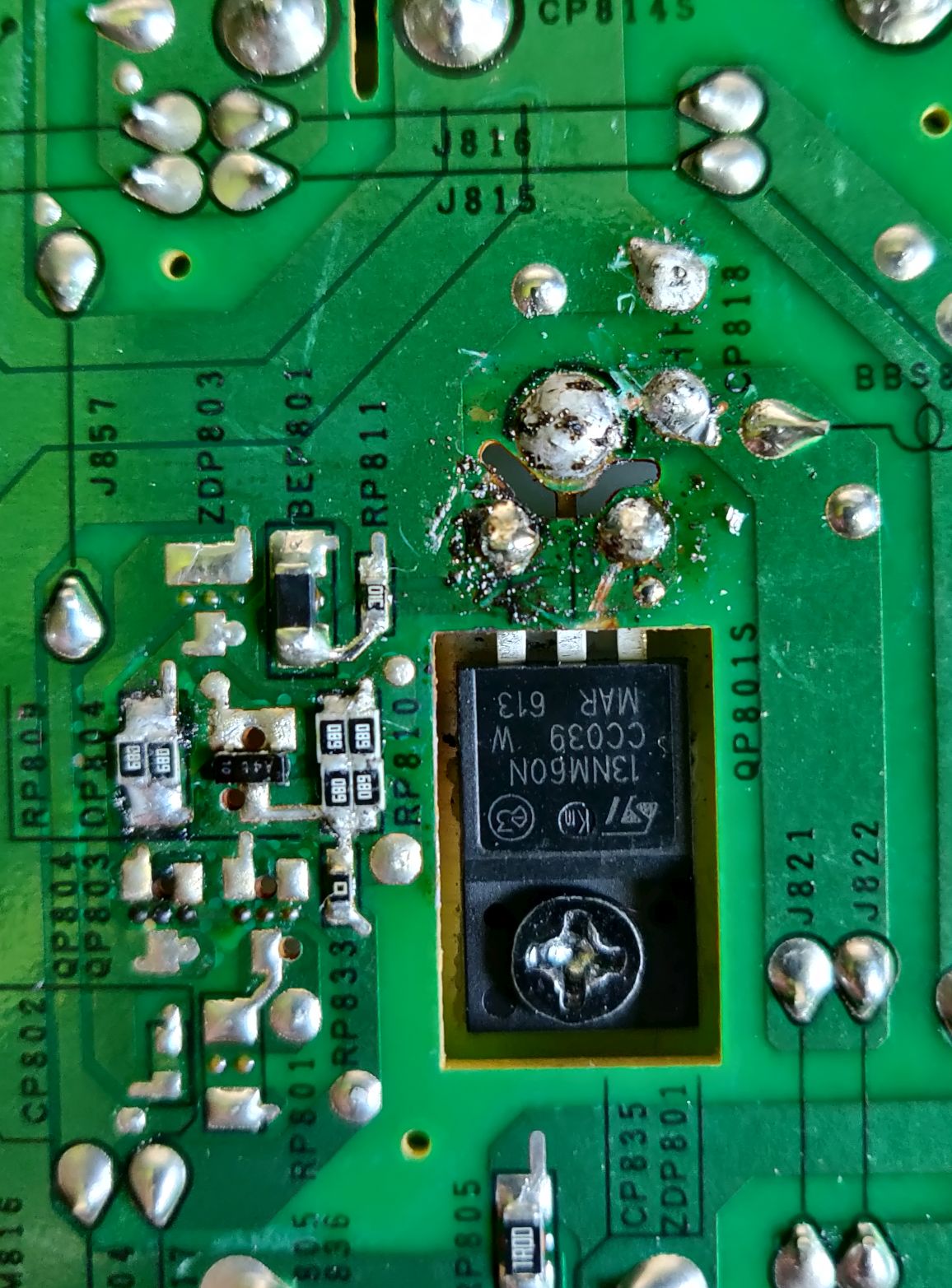

    Hello, got Samsung smart tv with bad power board BN44-00503A, diagnosed bad MOSFET F13NM60N (QP801S) and 5A fuse, after replacing both, replaced mosfet burned out immediately, fuse is ok, maybe somebody knows what can be checked prior trying one more?
  • xfox
    • Feb 2018
    • 84
    Re: Samsung smart tv bad power board BN44-0503A
    Looks like also burned two resistors one RP810 (68 Ohm) and RP809 (30 Ohm)

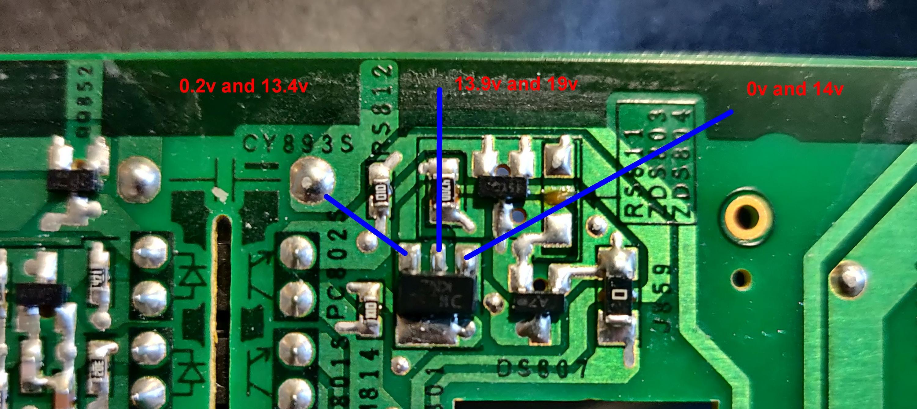

                            What are you using for ground when making these measurements ? 163v on QS801 is impossible. If this is the case ICP801S would be completely blown off the board! because the ic can only handle about 20v on it's vcc pin

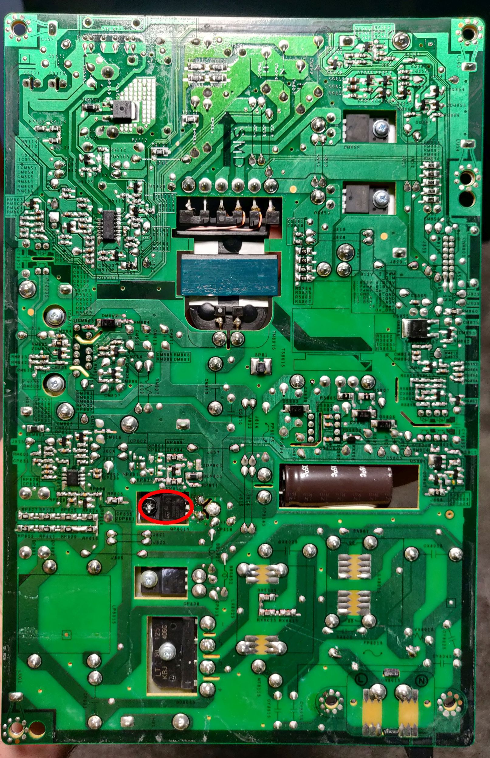

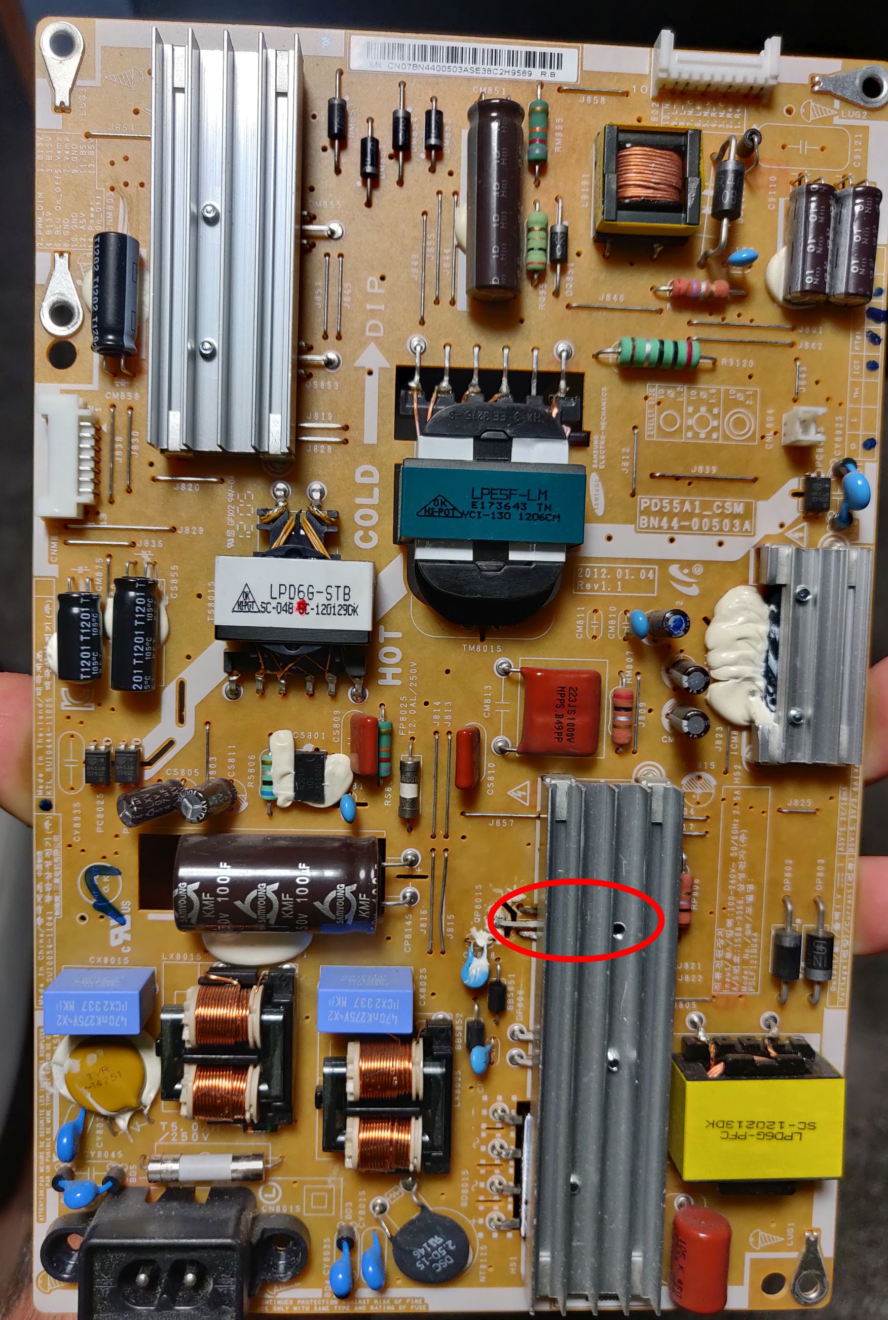

                            • xfox
                              • Feb 2018
                              • 84
                              Marked ground on attached photo with blue

                                You used the correct hot ground but you are checking the wrong transistor, Check QS801 NOT QP801

                                  Oh, sorry... So voltage is 13.25V without main board connected and switching from 13.25 to 19v with main board

                                    I only see one voltage reported, last time I looked these transistors have 3 pins, Emitter, Base & Collector

                                      Voltage on picture, so it's switching from one to another, looks like main board is trying to reset itself
