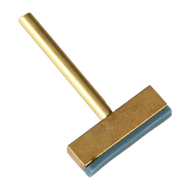

    I came across this item.
    I'd like to know if anybody used and if this is for real. Any opinions?
    https://www.aliexpress.com/item/1005002401881940.html
    30/40/60W Welding Head Soldering Electric T Shape Iron Tip Hot Pressing Strip Universal Albums Decor Car repair Tools
    Specifications:
    This T-type soldering iron tip is very suitable for repairing the LCD LCD screen with broken screen cable.
    The welding heads are available in different sizes of 30W, 40W and 60W to meet different needs.
    They are can be used for repairing soft lines, liquid crystal screen marking, breakage, etc.

    That tool is just for initially attaching the anisotropic conductive film (ACF) to the COF. From there you really need the bonding machine to complete the job.
    https://www.youtube.com/watch?v=mDxowmJvU8o
    The COF are cheap but you typically can't buy just one, the ACF seems to cost quite a bit and has an expiration date and is purposed for the COF specifications.
    I think a lot of us have given some thought to doing this as it seems a shame to trash a nice panel simply because one COF has failed, but I haven't read about any successful repairs. Maybe if you live in a country where the sets are manufactured you could actually get a panel repaired.

      Unuseful..
