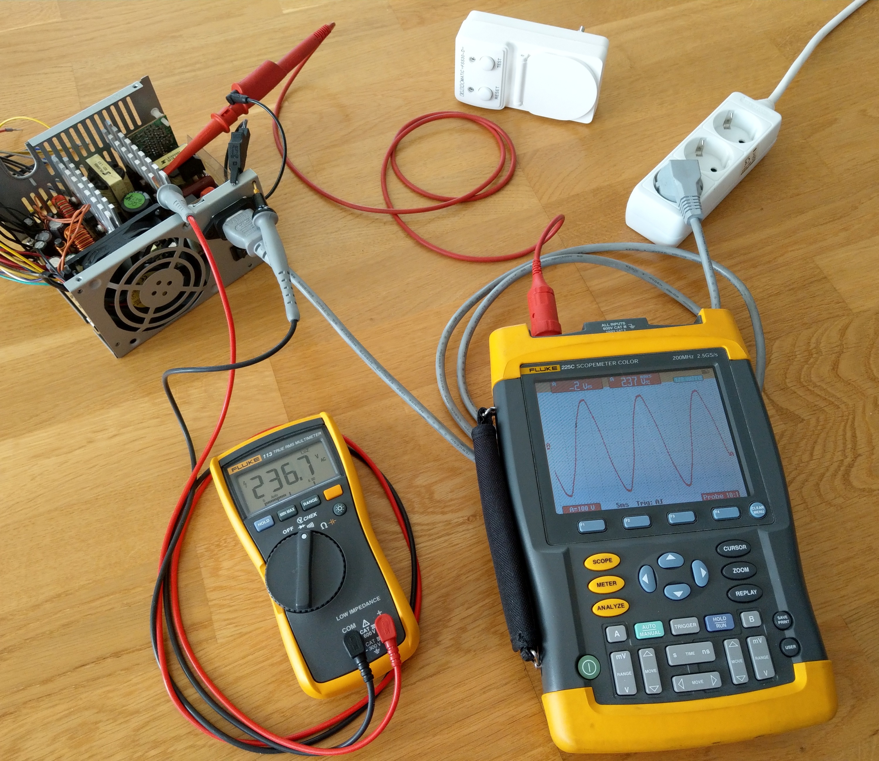

    In the following picture I show a Fluke 113 measuring the voltage, I'm using this as it has a 3KΩ measurement impedance, so it presents a quite heavy load to the circuit being measured.
    This is to allow you to understand that it is a real voltage we are speaking about and not a phantom floating voltage as you can sometimes see in house wiring.
    Indeed it is large enough that I can't use the 30mA RCD you also see in the picture: because it will trip!
    Then I also use a Fluke 225C Scopemeter to show the actual waveform.

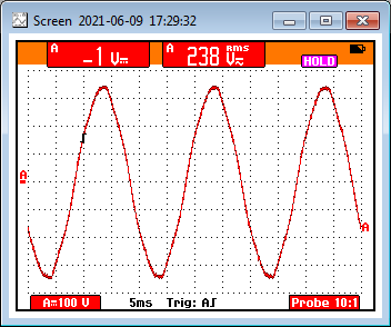

    Here is the voltage of the primary heatsink with relation to ground with the unit switched off on the single pole switch:
    As you can see we are reading 237VAC (our line voltage)

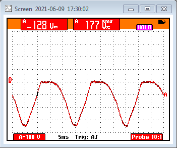

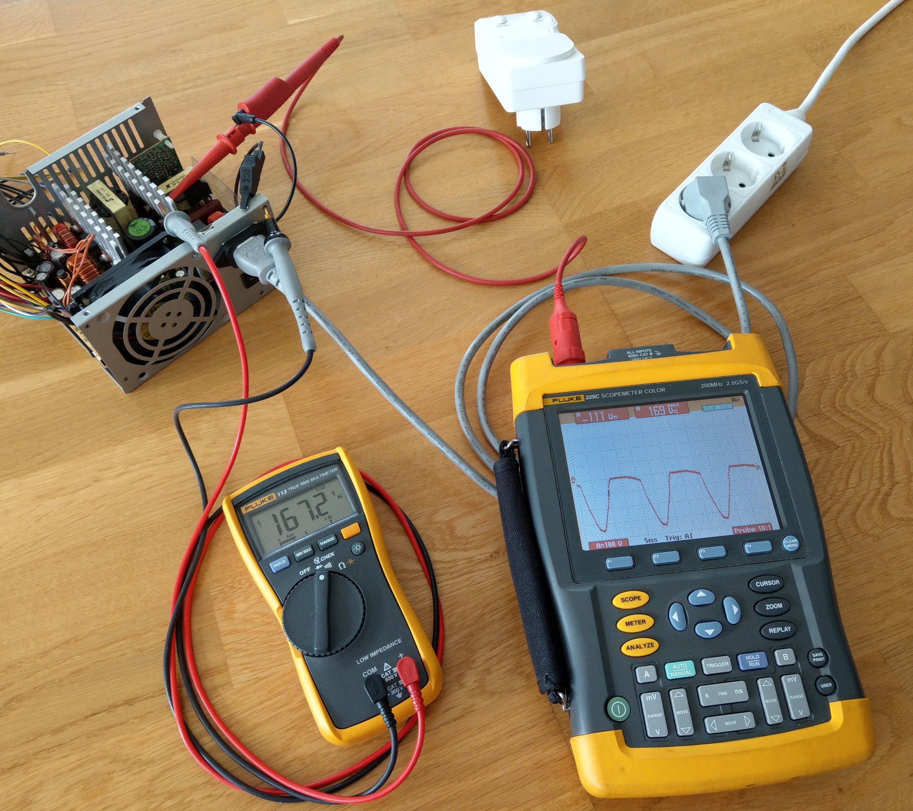

    And here is the voltage waveform of the primary heatsink with relation to ground with the unit switched on:
    (As you can see the meters show a voltage of roughly 167VAC but this is a RMS approximation that is not so useful).

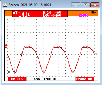

    The actual DC voltage is of course our rectified AC voltage that is close to 340VDC due to my slightly high line voltage (√2 x 240VAC = 339.4VDC)
    I've added some cursors here to better clarify what I mean:
    It is also extremely important to point out that the only safe way to measure on the primary side with an oscilloscope is using a differential probe or with a Scopemeter that is not referenced to mains ground.
    Because if we wanted to get a useful reading here we would need to clip the negative lead to the primary side heatsink since that is the negative of the primary side.
