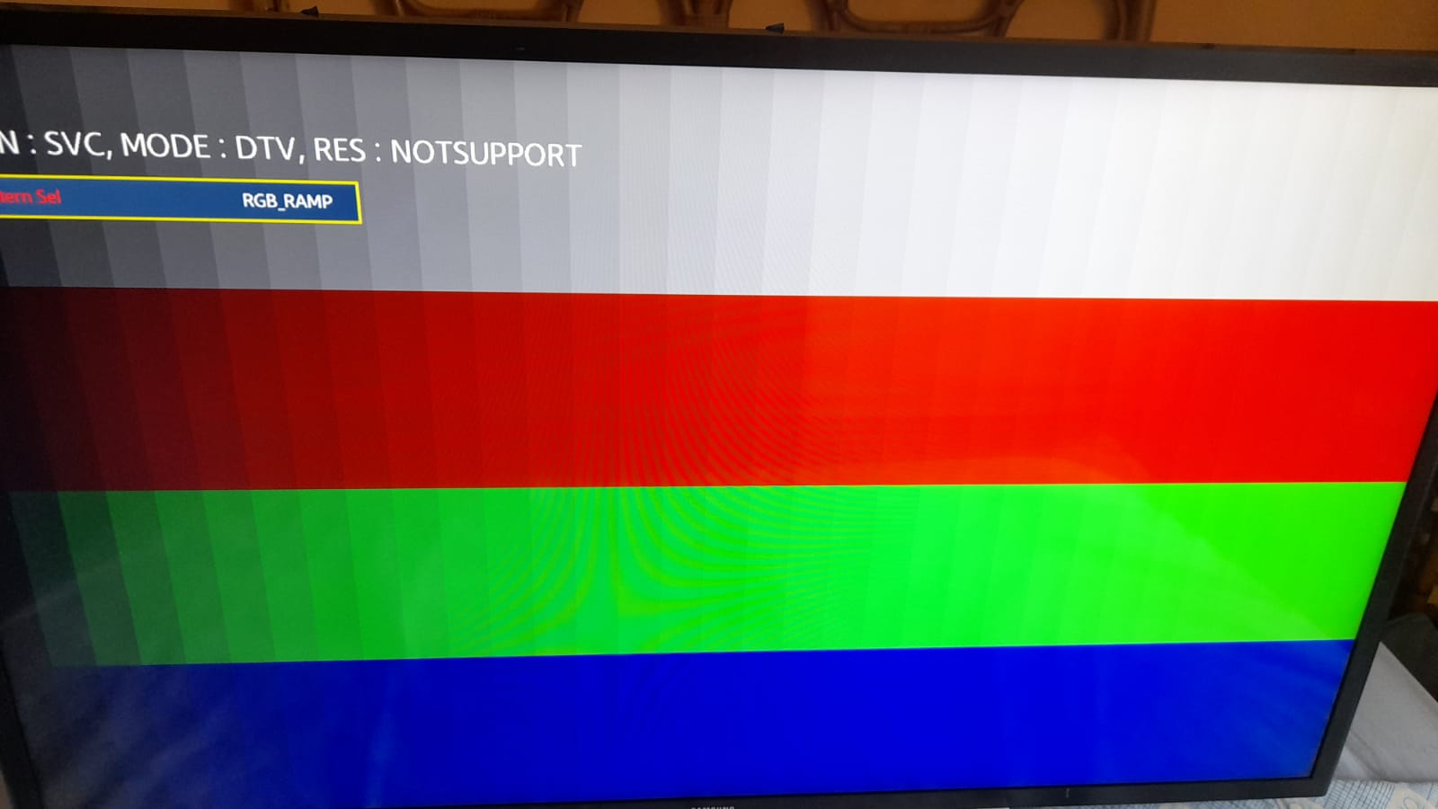

    R5_Gain is bad, change to 524. Hopefully this is the fix.
    Could be a bit flip in EEPROM. If it's stuck, may need to change EEPROM.

      First search for the option LVDS type and change to the otber values, if not ok change every type in option menu..

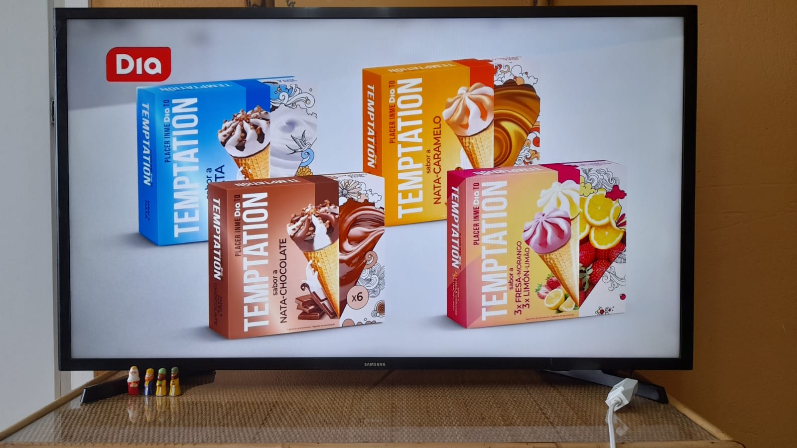

        Thank you so much alfatv, colour problem fixed
        I do wonder, how did it end up like that from normal use? Like... so weird.
        I did try changing LVDS type before the R5_GAIN, Davi.p, the menu went all kinds of wrong colour wise, and after changing R5, I'd say it's safe to say that was the issue. Thanks anyways for your input.
        Though I might've noticed one new issue, I'll confirm later (might just be the quality of the TV itself it is from a few years ago, even if not that many). For now, colour issue is fixed and looks perfectly nice to watch TV from bed.

          Re: Samsung UE40J5200AW red channel issues where luminosity changes (I believe)
          There is no second issue, it's just a combination of:
          1. when looking at a 40" screen from just about arms length, you notice imperfections easier (like YT not knowing how to deal with a black and bumpy surface or the low quality of some TV programs and ads) and
          2. the "Sharpness" option of the TV and the image of my laptop don't go along well. The more I increase it, the more the colours at the edges of some things (like the mouse pointer) "bleed" into each other, I just keep it a 0 now.
          Thank you so much alfatv, Davi.P and ReeceyBurger123 for helping out.
