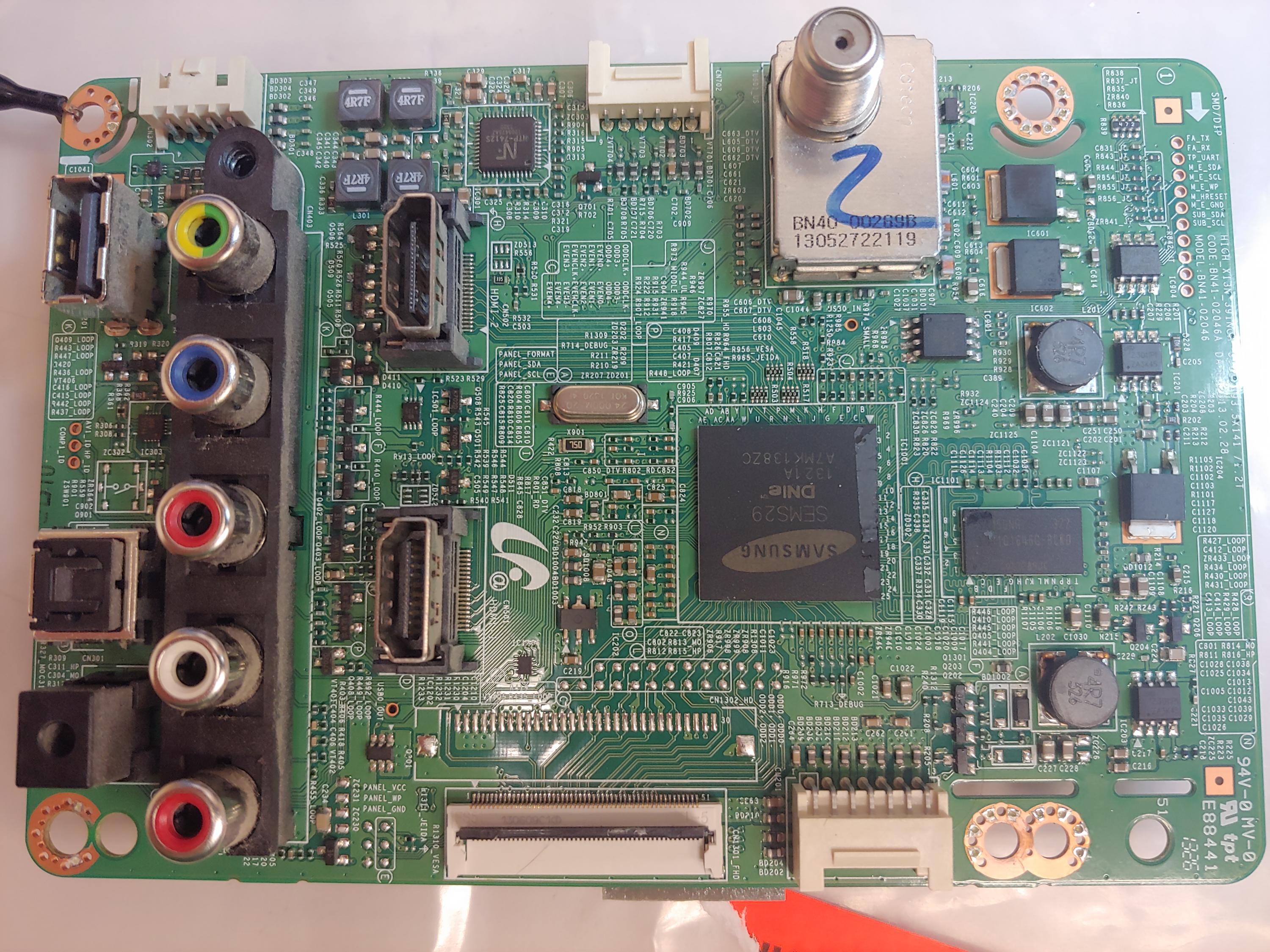

If i completely take the connector running to the main board off the leds will come on. If i leave the main board connected and disconnect the tcon board the led lights will not come on. If i take the bl wire loose the backlights will not come on. im getting no sound, no picture, no backlights accept when the cable from the pwr supply to mainboard is disconnected and no standby light if this tv has one.

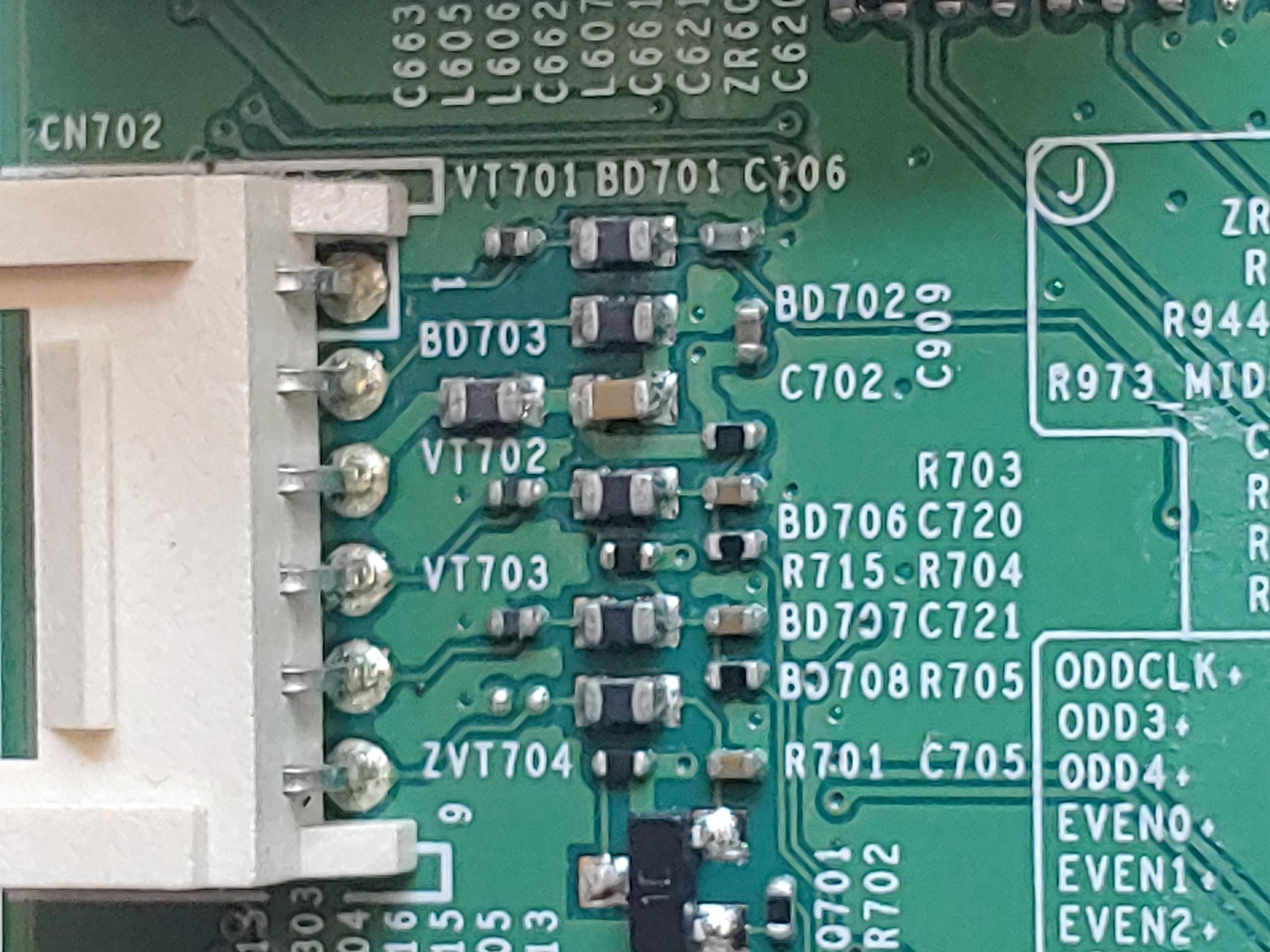

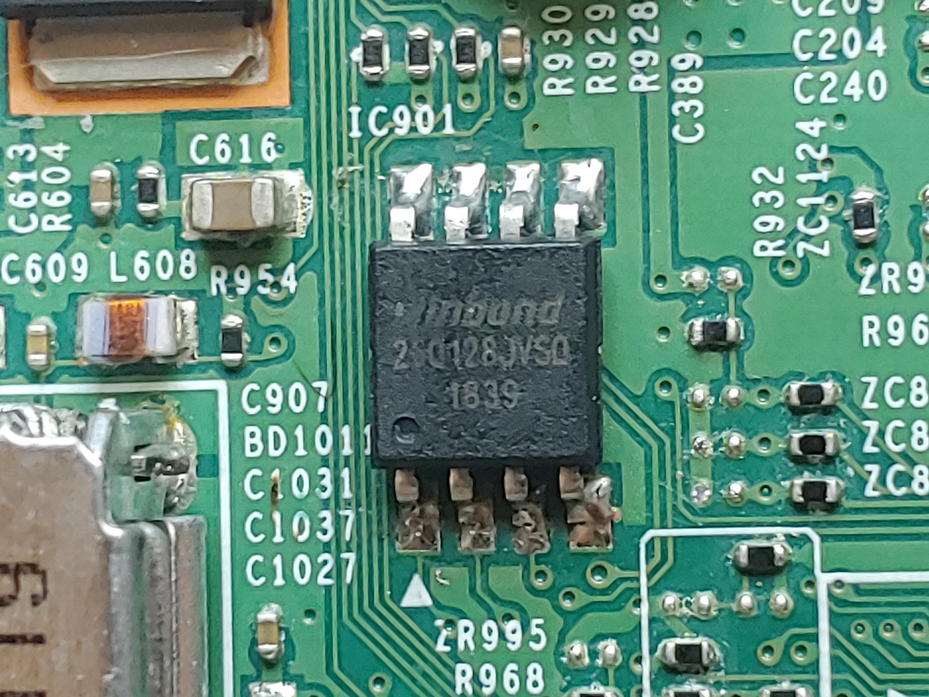

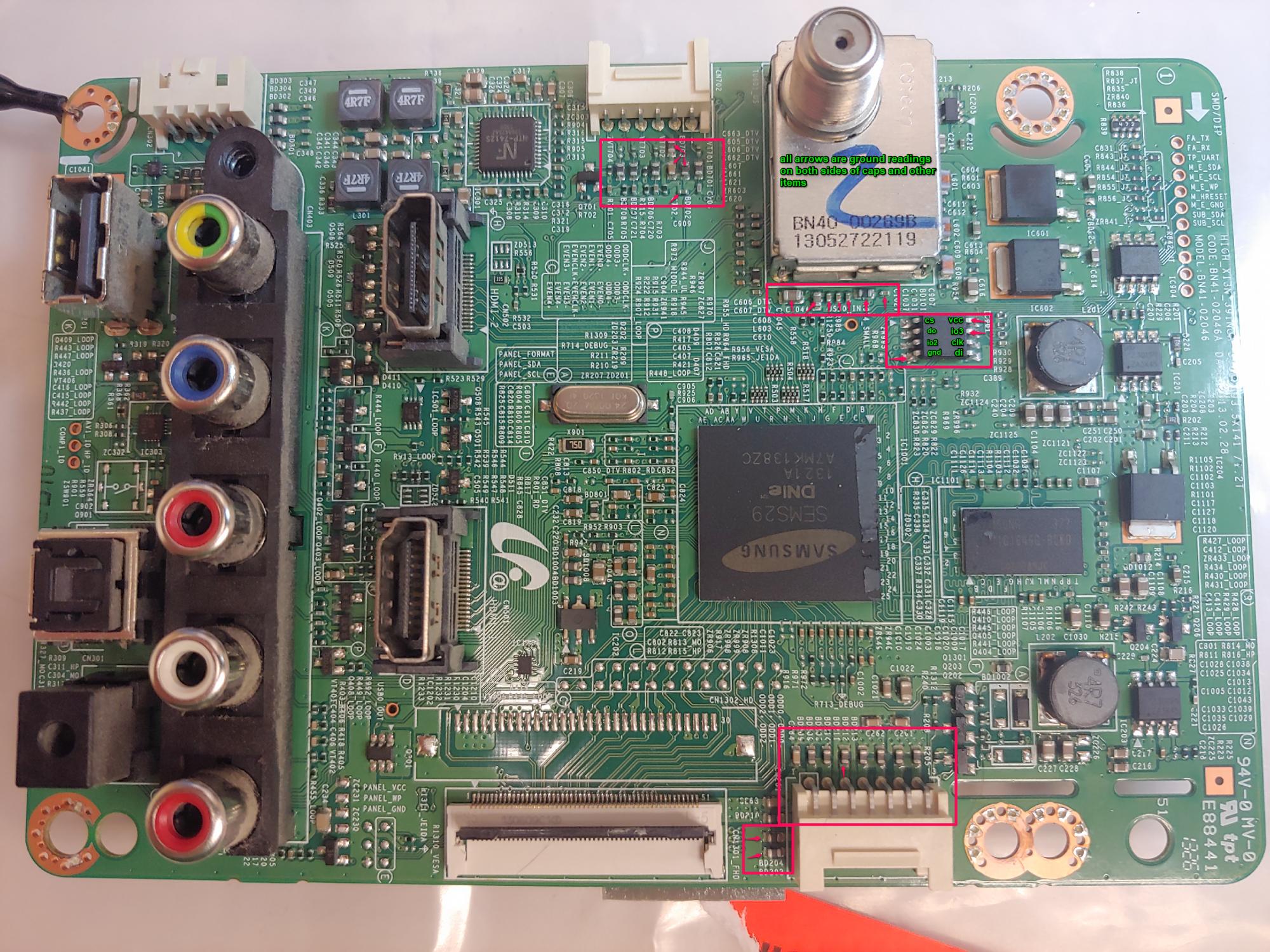

I have replace ic 901 on th main board from shopjimmy and it had no effect. I started checking for shorts to ground and found some. They are show in one of the pictures i have posted. the arrows point out all the caps and im sure other items that had ground readings on both sides. I found the ic i replaced had some connections to ground that i don't think there should be.
Is there a service manual to be had for this tv or some schematics of the main board so at least i can know the values of what might need to be replaced.
