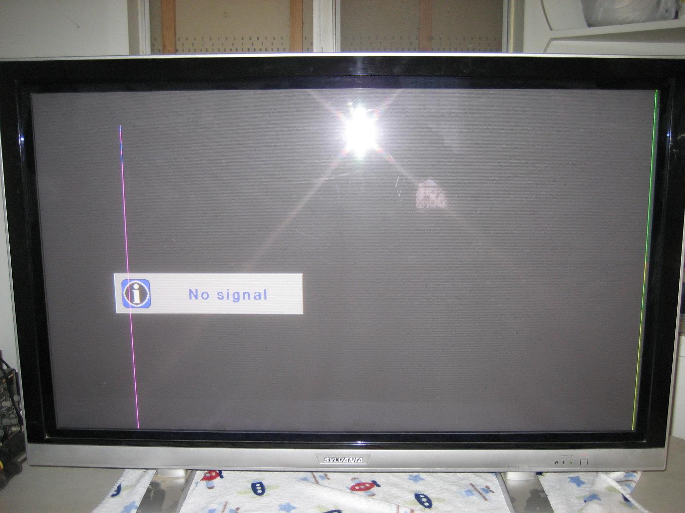

    Friend asked me to take a look at his 42" Plasma that had a couple of thin vertical lines on it.
    Attached is a picture of the display. I just wanted to get a professional opinion before I dive into this one - I am curious if this is likely panel failure or something fixable.

    My thoughts are it's either an X-driver or the control board. But that is REALLY only a guess. Wizard is the expert. The service manual for the panel is here:

      Panel is junk. The thin vertical lines is terminal.
      Reason is: the vertical lines is driven by the Z drivers (at bottom or both top and bottom depending on panels) and these chips is bonded to the panel itself. Same thing with vertical band as well.
      If the lines or bands across, it is fixable by changing Y or the X driver (the board on left, most of time or right side)

        Figured it was either a bad panel or a bad z driver or control board problem as plainbill was thinking.

          Who makes the pdp? Didn`t some of these drivers have solder problems for verticle line issues?

            No solder joints on Z-driver ICs. They are bonded to the panel itself.

              Just to be clear by bonded you mean the die itself is soldered to the board and encased in that black epoxy blob we're so used to seeing right?
